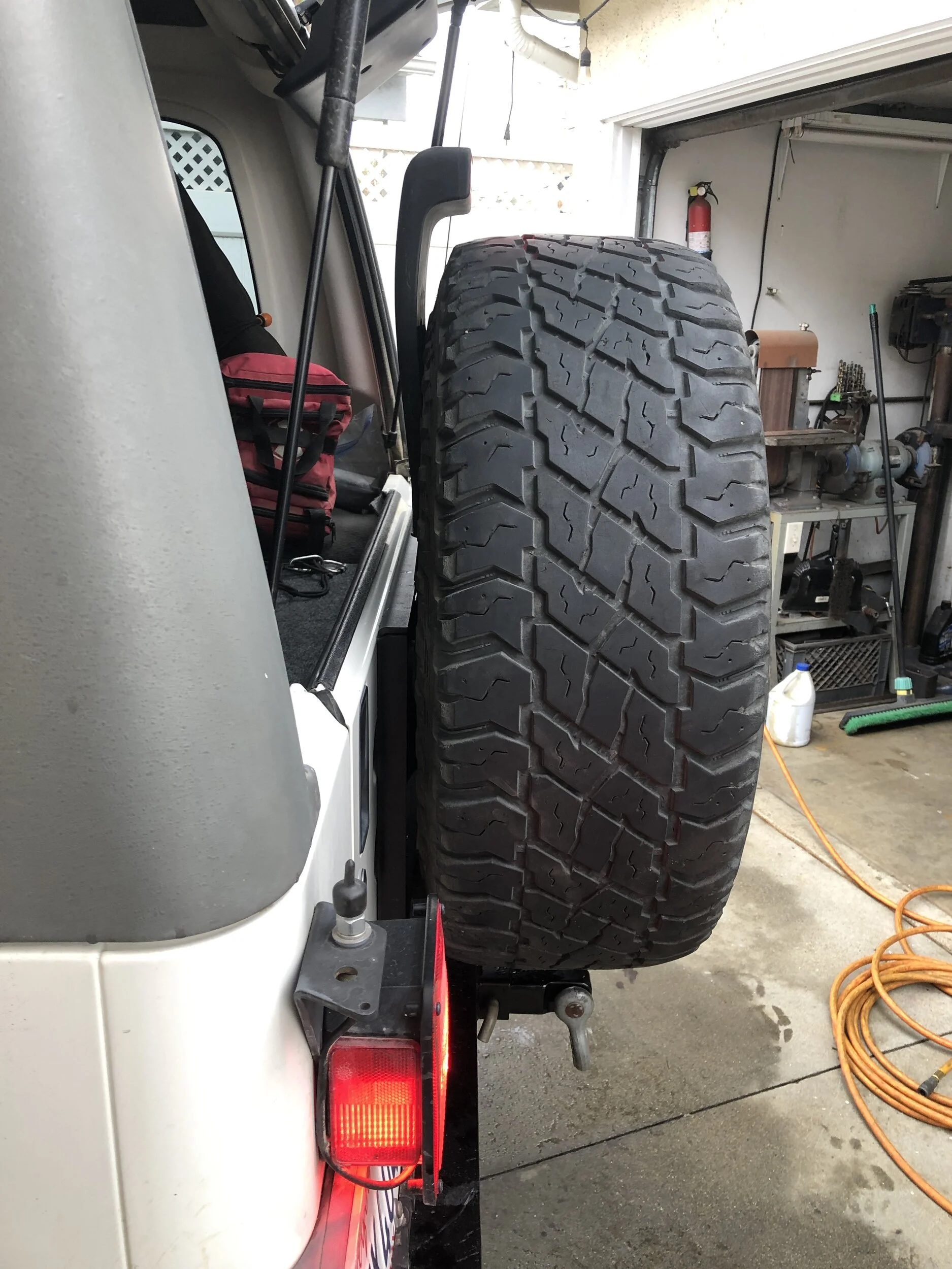

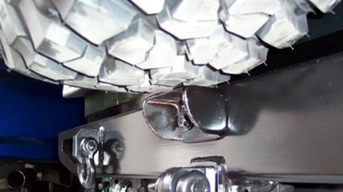

Take the weight off the tailgate hinges. My tailgate still works perfectly after nearly 8 years with a 35" spare and steel wheel. :cool:
