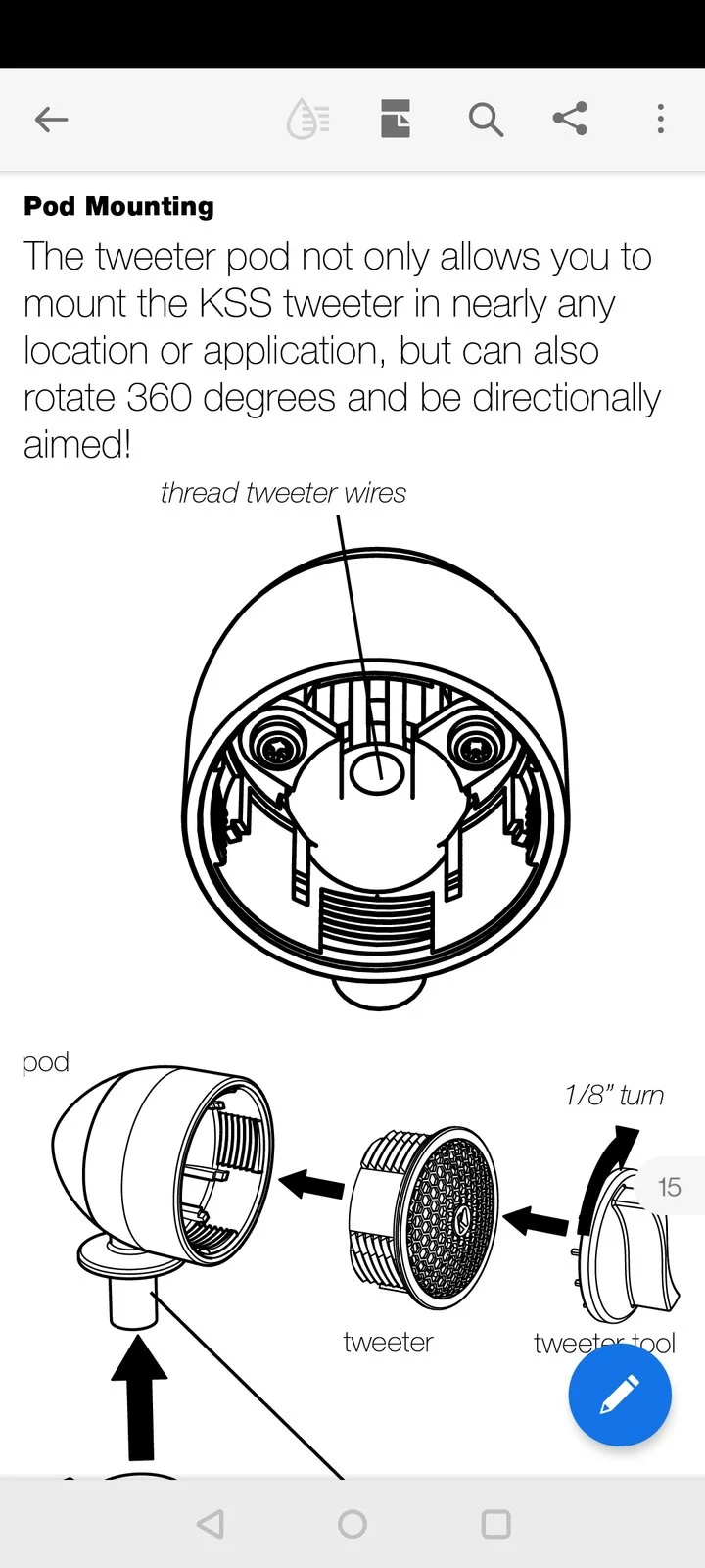

Those are a great add on, but money can be more wisely spent on relocating the tweeters to the dash. Kicker makes a set now that is perfect for our Wrangler.
https://www.crutchfield.com/p_20647KSS50/Kicker-47KSS504.html

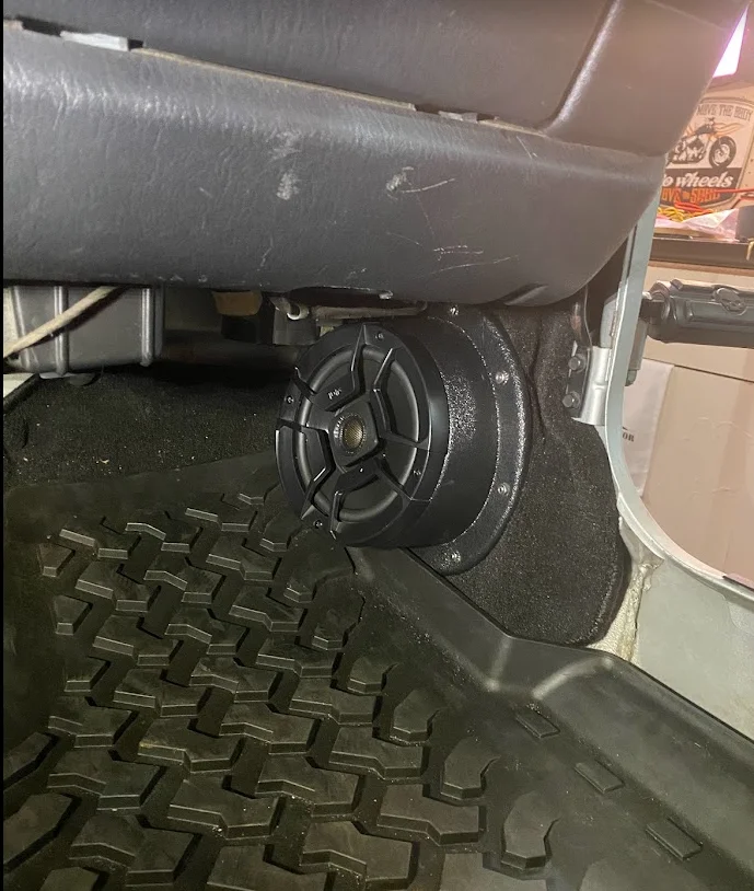

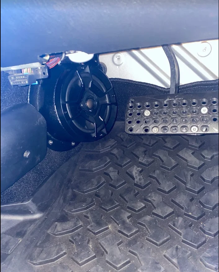

I went with the 5.25" in the stock dash locations, upgraded to 6.5" in the pods on the roll bar, added a set of the separate tweeters from Quadratec on the dash.
That still wasn't enough to hear with the doors and top off, so I added a small amp, an 8" powered sub under the driver's seat, and then made a pair of custom kick panel pods for a 2nd pair of 6.5" Polk Db's in the footwells.
It's not a competition-type installation, but it has full sound now that can be heard with the wind noise of no top or doors.
