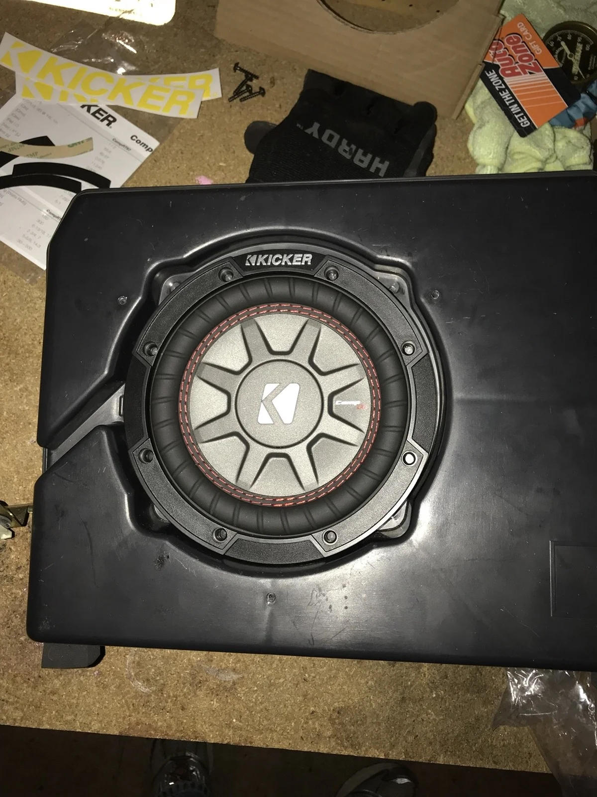

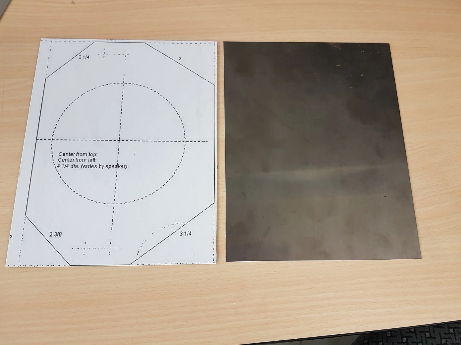

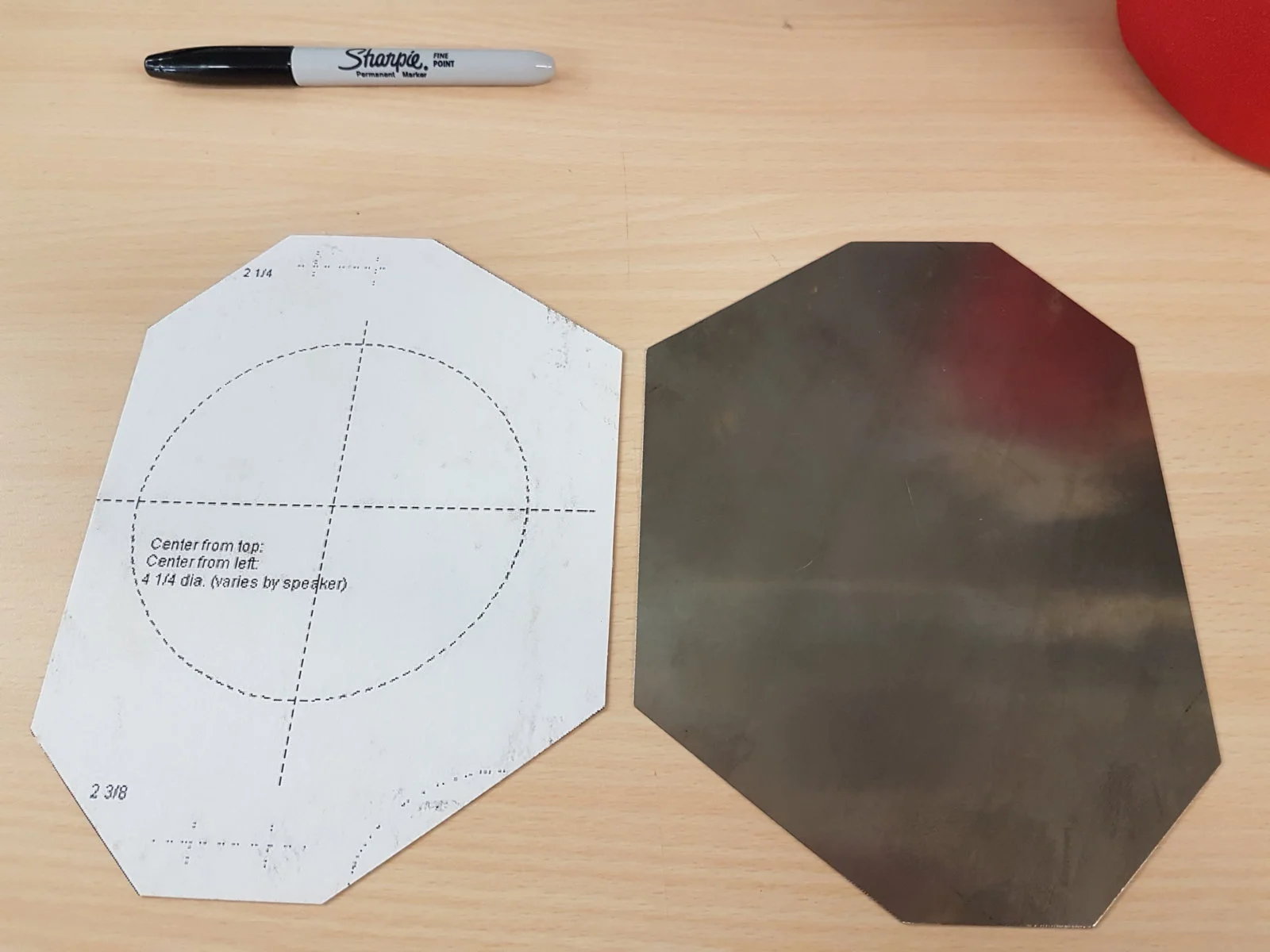

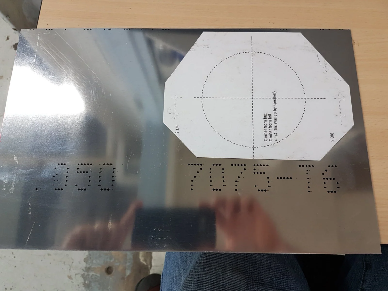

    I printed some templates off at work and made my own speaker adapters for the front. I made three sets, two out of aluminium with different thicknesses, and one out of titanium.
