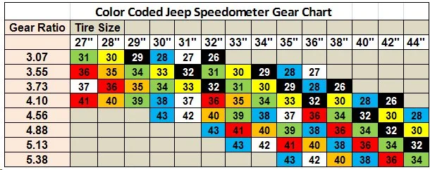

thekidwithquestions Acquiring Jeep funds... Supporting Member Joined Feb 25, 2021 Messages 1,489 Location NC, Wake Forest Jul 27, 2021 #1 I have a 4.0 liter ax-15 with 33s and 4.56 gears what speedometer gear do I need?
TheBoogieman Jeepaholic Supporting Member Joined Jan 1, 2019 Messages 11,193 Location CharlottesHELL, VA Jul 27, 2021 #2 thekidwithquestions said: I have a 4.0 liter ax-15 with 33s and 4.56 gears what speedometer gear do I need? Click to expand... Did you see my accurate chart in another thread? (39 tooth)Time to change your screen name to Thekidwith2manyquestions.(JK) Last edited: Jul 27, 2021
