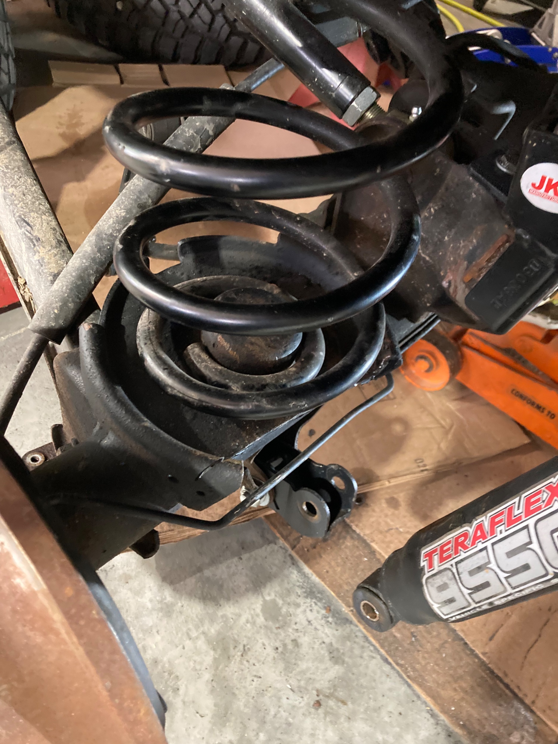

Whatever the shock needs to fit properly. Mine is outboarded all around, so cutting the lower spring seats is something I wouldn't think twice about.
You are right. I tried them first but they made my shocks the wrong length. Pictures were taken during process of removing brackets and notching buckets
Thanks,
Are you running a tummy tuck? Was this amount of cutting enough to eliminate contact?
