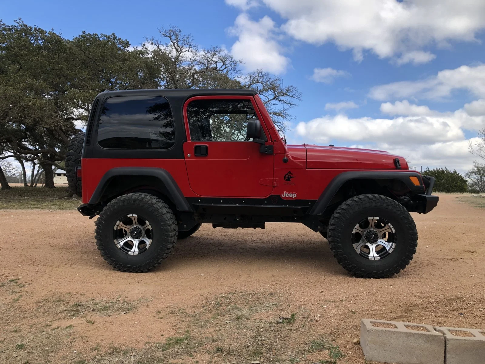

2” OME (2933 and 2942 or 2941 if you wanted the Jeep to sit a little more level)
Rancho 5000x shocks (55239 and 55241)
Rear trackbar relocation bracket
Adjustable front trackbar
Should net you 2.5”, which is good for these Rancho shocks which run a little long
Mine has that setup, plus a body lift, so I’m running 33’s, but it looked great on 31’svwith that setup.
