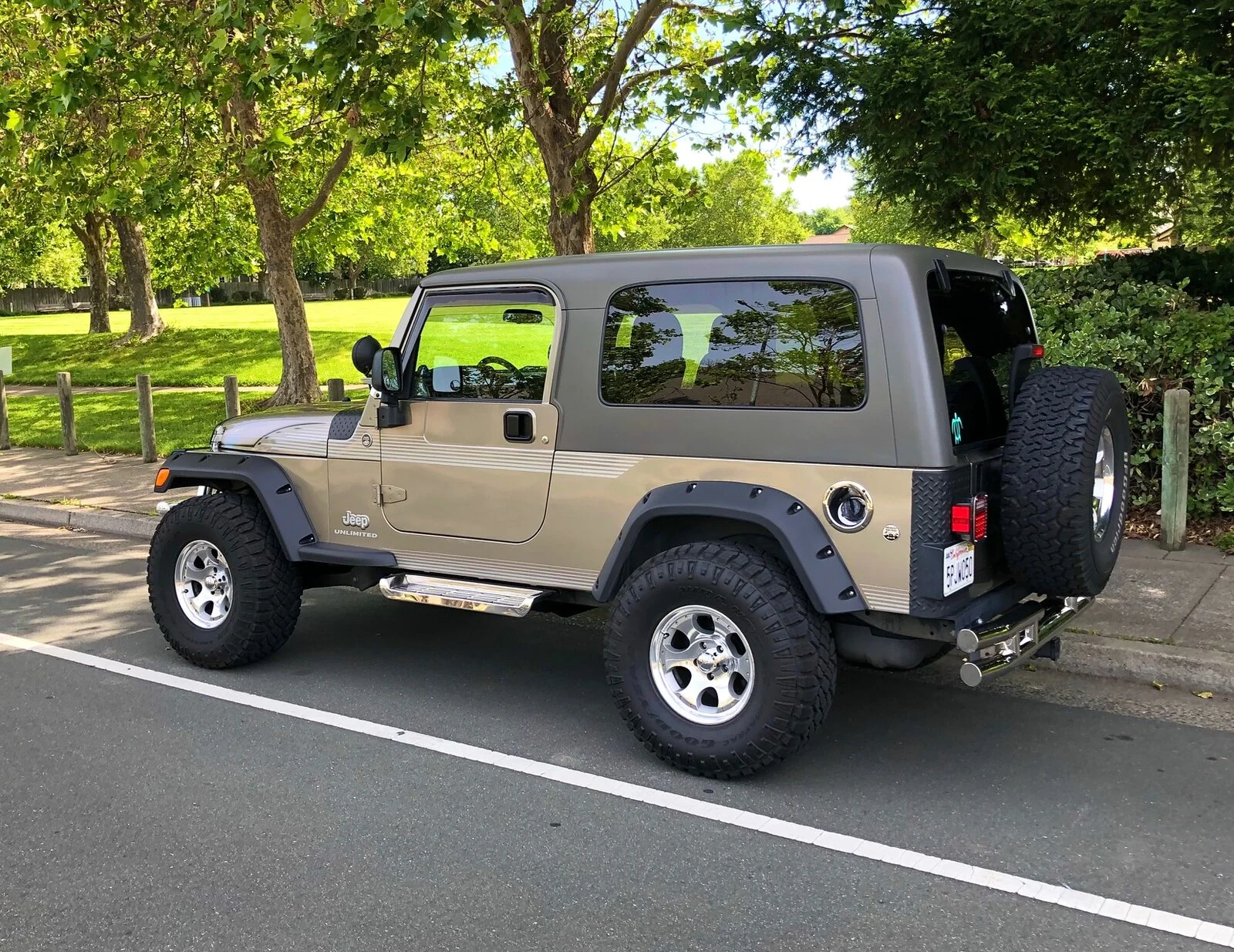

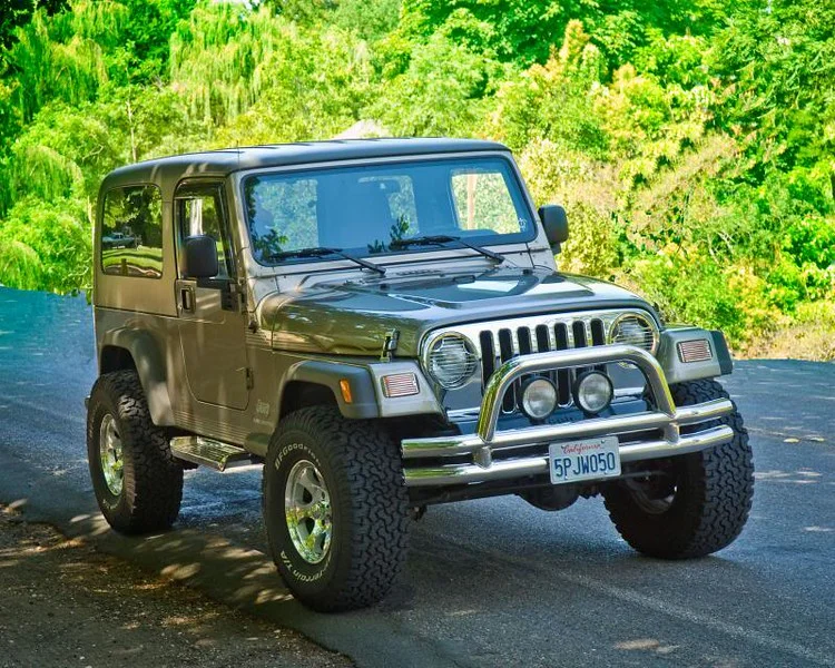

Just as a reference the first picture was taken back in 2005. The second a year or so ago. But the first picture has the stock fender flares, so it's kind of hard to judge.

Just as a reference this picture was taken back in 2005. But it has the stock fender flares, so it's kind of hard to judge.
