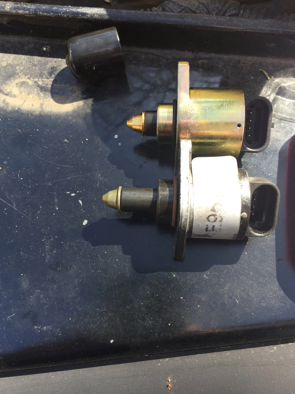

Took it apart, cleaned it up pretty damn good. Housing and everything. Took for a test drive. Idle drops like it wants to stall. Doesn't stall but almost.

Ordered a new Iac. Wrong size?
