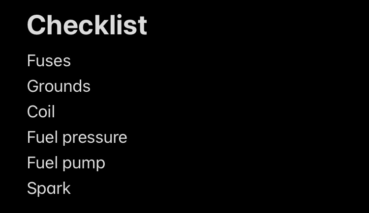

Here’s a checklist I think I should start with
for the fuel pump my Jeep has always started right away never had to try to crank it over for awhile doesn’t seem to bog out at all unless the fuel pump just gave me no warnings and broke.

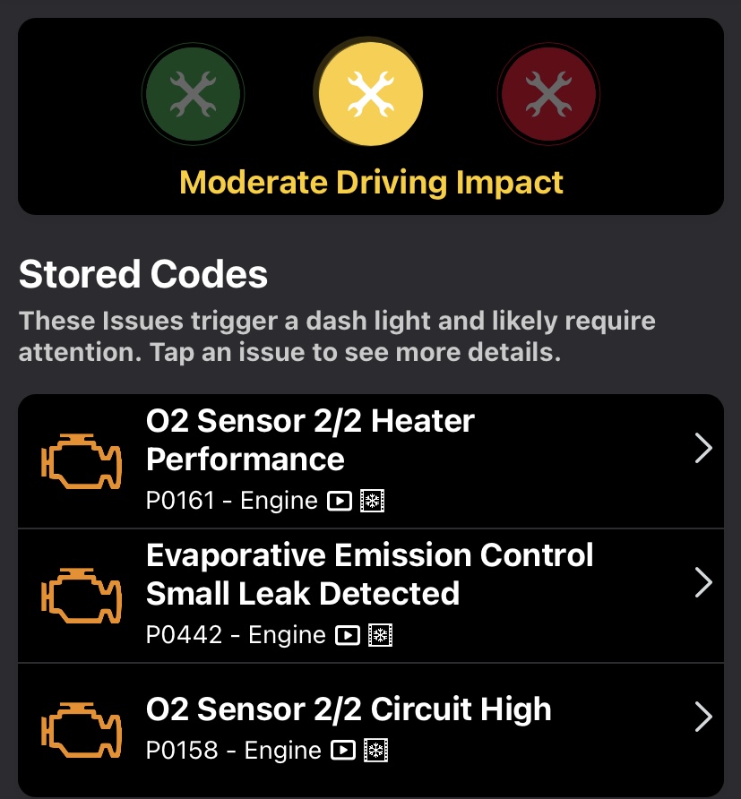

Here’s codes I’ have, had them for awhile
