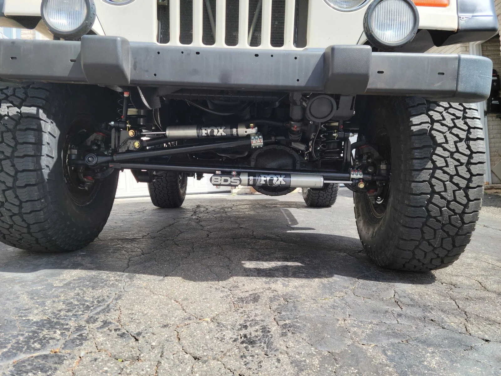

I have a 98 tj with a new BDS 4 1/2 lift. Steering is just not right. Jeep drifts from left to right.like driving on ice. There are 2 steering g stabilizers to control the bump steer. What else is needed to keep it going down the highway straight.

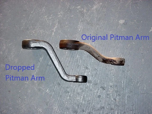

True bump steer is caused solely by bad steering geometry which is caused by having installed something that screwed up the geometry like a dropped Pitman arm or a dropped track bar mount. It's neither cured nor even helped by installing a new or additional steering damper/stabilizer.
First, did you install a dropped Pitman arm or a dropped track bar mount? Next, did you adjust your toe-in after installing the suspension lift? Suspension lifts affect the toe-in so it needs to be readjusted after they're installed. It's probably not from a caster issue, that size suspension lift isn't likely to have decreased the caster angle. Plus bigger tires don't require as much caster angle as smaller tires do so I really doubt it's your caster angle that's causing the problem.
This shows the difference between the factory Pitman arm and a dropped Pitman arm.

which part # lift? We need a picture from the front of the steering and trackbar mounts.

BDS Suspension# 1047H

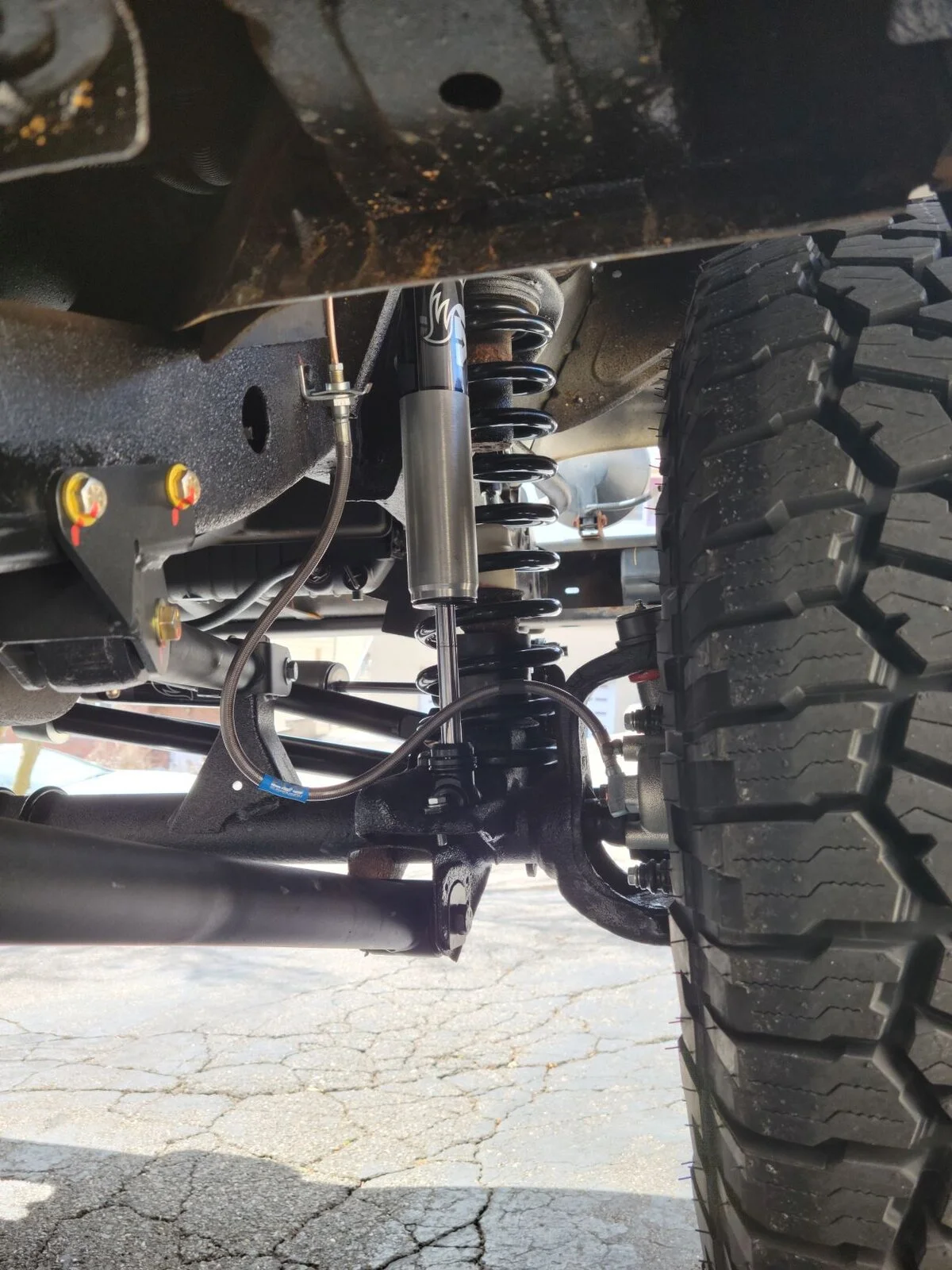

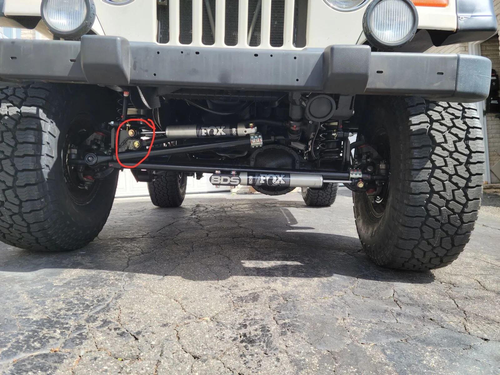

That doesn’t look like the stock track bar Mount location. To me, but I could be wrong. Just doesn’t look like mine, which I’m confident is stock.
It looks like it’s raised up higher to me.
I can’t tell if that’s a drop pitman arm either.
My TJ has 4” Currie Lift and 35” BFG’s, and I don’t have 2 Fox High End stabilizers, not even 1. Whew, those look expensive, and two is 1 too many in my opinion.

It's been mentioned before, but try a drive without the steering stabilizers and see what that difference makes.
It looks like your brake lines are WAY too long, you may want to correct those before they get tangled up in something.
I Left SE Florida a couple years ago, but did my own work on Jeeps... I know there is a Jeep club in the Ft Lauderdale area, and they have a facebook page... they could help with mechanic recommendations.
Better pics would help. We need to see underneath the bumper. All the connections there are important. Something is wonky.
