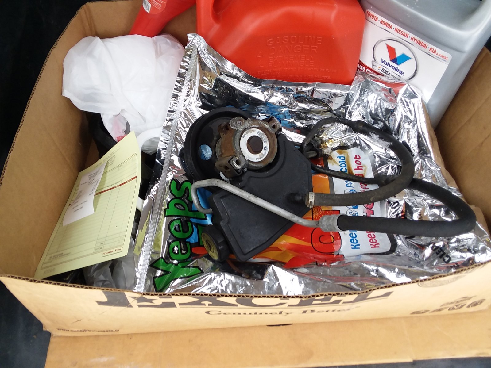

I ended up heading to Daveys Jeeps and picked up a good working pump with hoses for $40. I am thinking my pump is bad and is the reason it is hard to turn so I will toss this one on and see what happens. I did not notice this before but the raised edge of the pully that holds the belt on has chipped off in places. I believe the impact with the deer pushed the e-fan into the pulley and broke it and apparently damaged the pump.
