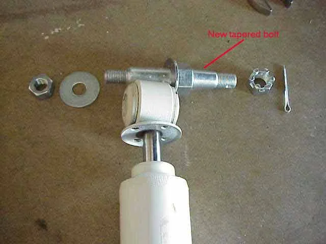

Make sure the steering damper (aka stabilizer) kit you buy has this threaded stud in the kit which is required by the TJ. The kit Chris linked to just above includes it. Not all steering damper kits come with it.
