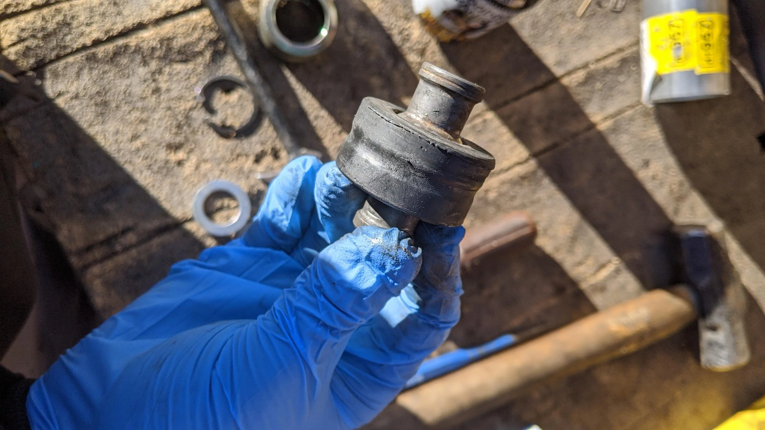

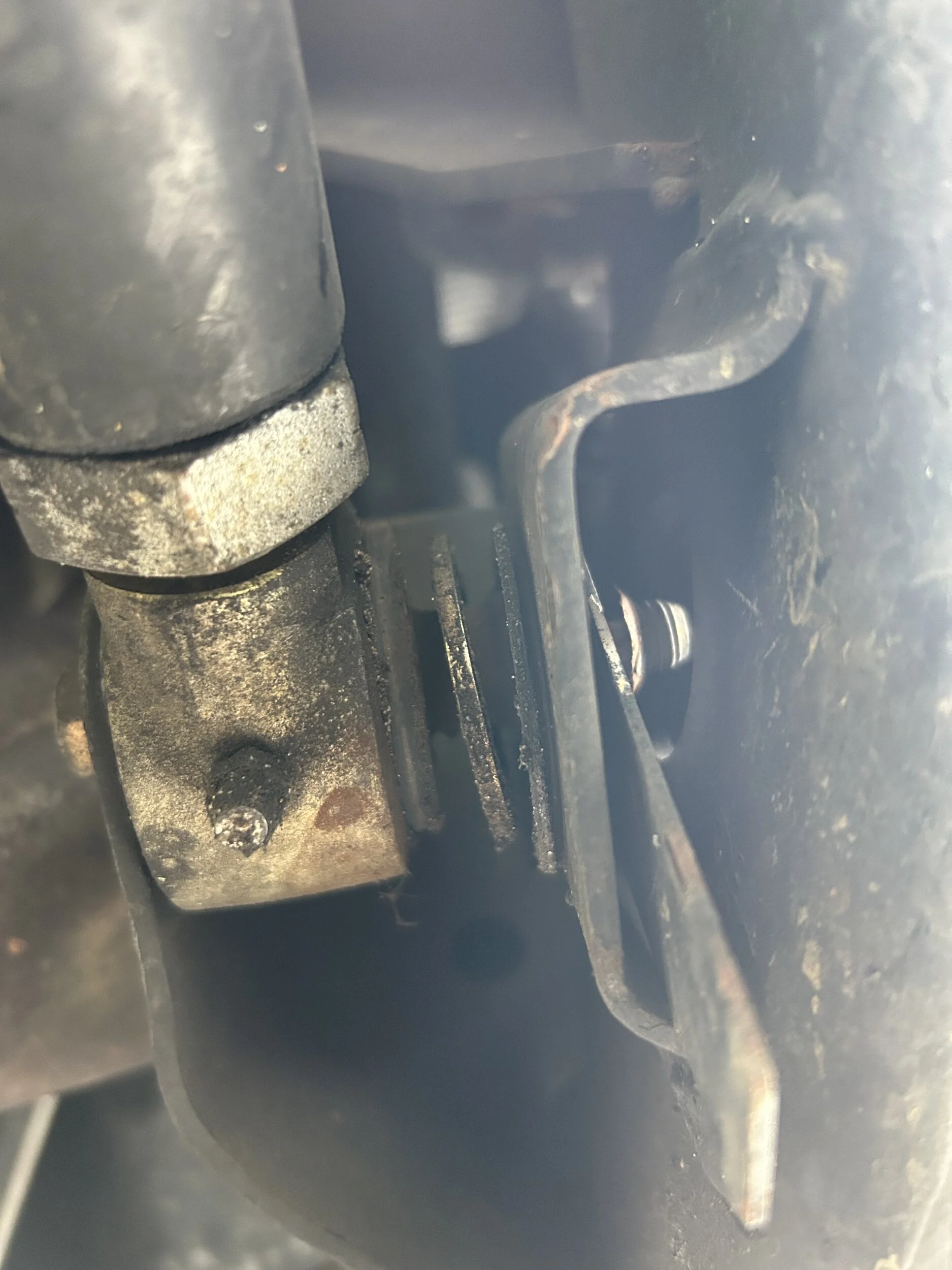

Ill have to wait for the lady to come home to try again. While digging around I did see where one of my JJ on the driver upper control arm frame end came apart. Took some videos focusing on that joint but the joint did not really move any more when the pops are happening. Regardless ill get it fixed and try again. Conveniently stopped again so cannot get more videos. Now its mostly happening when turning wheel to passenger side.

I noticed the Johnny Joint race on that side popped out of the housing a little. I replaced that whole arm since I had a spare and no more noise. So my only guess was the spontaneously disassembled joint.

Ahhh I was thinking that was it. Mine had the same exact failure mode.
I think my issue is I forced my artriculation on some pretty dry joints. Though for only being a year old it should have not been that bad, but that East Coast mud really wrecks havoc on these joints.

Interesting. I didn't figure out what caused mine - they were only a few months old and had been on only 1 trail harder than a dirt road. They do use a 2" narrow johnny joint, which isn't the same design as the "full size" ones:
People smarter than me speculated it was due to the joint chosen, RockJock doesn't use that joint in TJ upper arms and they make 'em.
