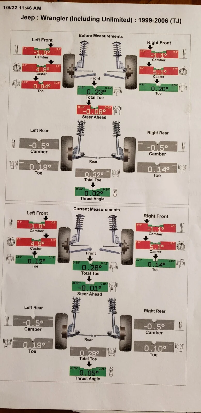

So got an alignment because the steering was all over the place, including not really returning to center. Now that its done the steering is mostly straight, but still not returning to center.
Is my caster too low? Based on other threads I thought around 5* would be enough? If it's too low, would the change from 5* to 6* be significant enough to make my steering return to center post-turn? I've just heard if its too high when lifted ill get driveline vibrations.

@Jerry Bransford do you think increasing my caster from 4.9*/5.1* left/right (photo in original post) to closer to 6* each side would make the LJ RTC better? Or is that change not big enough to notice, ie something else is hindering my RTC? Appreciate your insight.
it's worth a shot. If you like how it drives after the adjustment, leave it. If it vibrates, back off a little.
