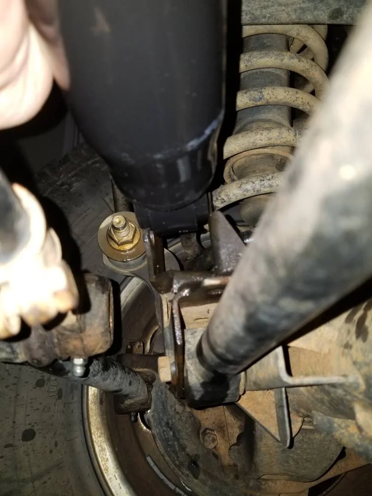

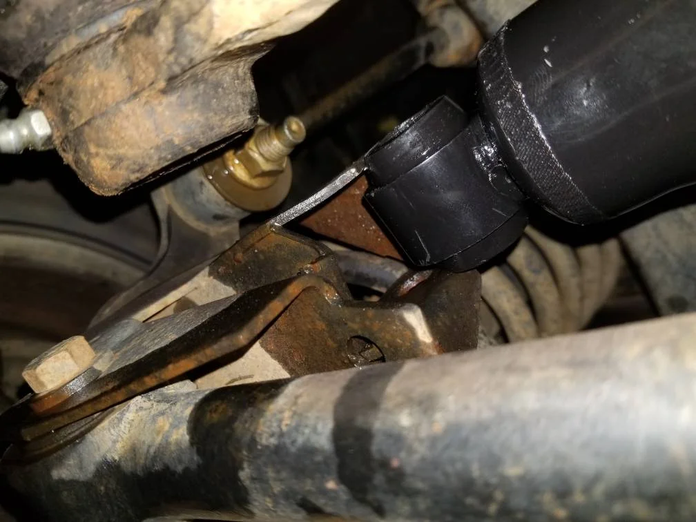

Hello my name is Benjamin. I am new here. I own a 04 Wrangler X tj. I am looking to replace the oem steering stabilizer with a heavy duty one. I bought the skyjacker black max HD OEM replacement from extreme terrain, but when I went to install it the polyurethane bushings are far too wide to fit into the frame side mount. Any suggestions for a stabilizer that fits right on?

... the polyurethane bushings are far too wide to fit into the frame side mount.
cut them down until they fit
