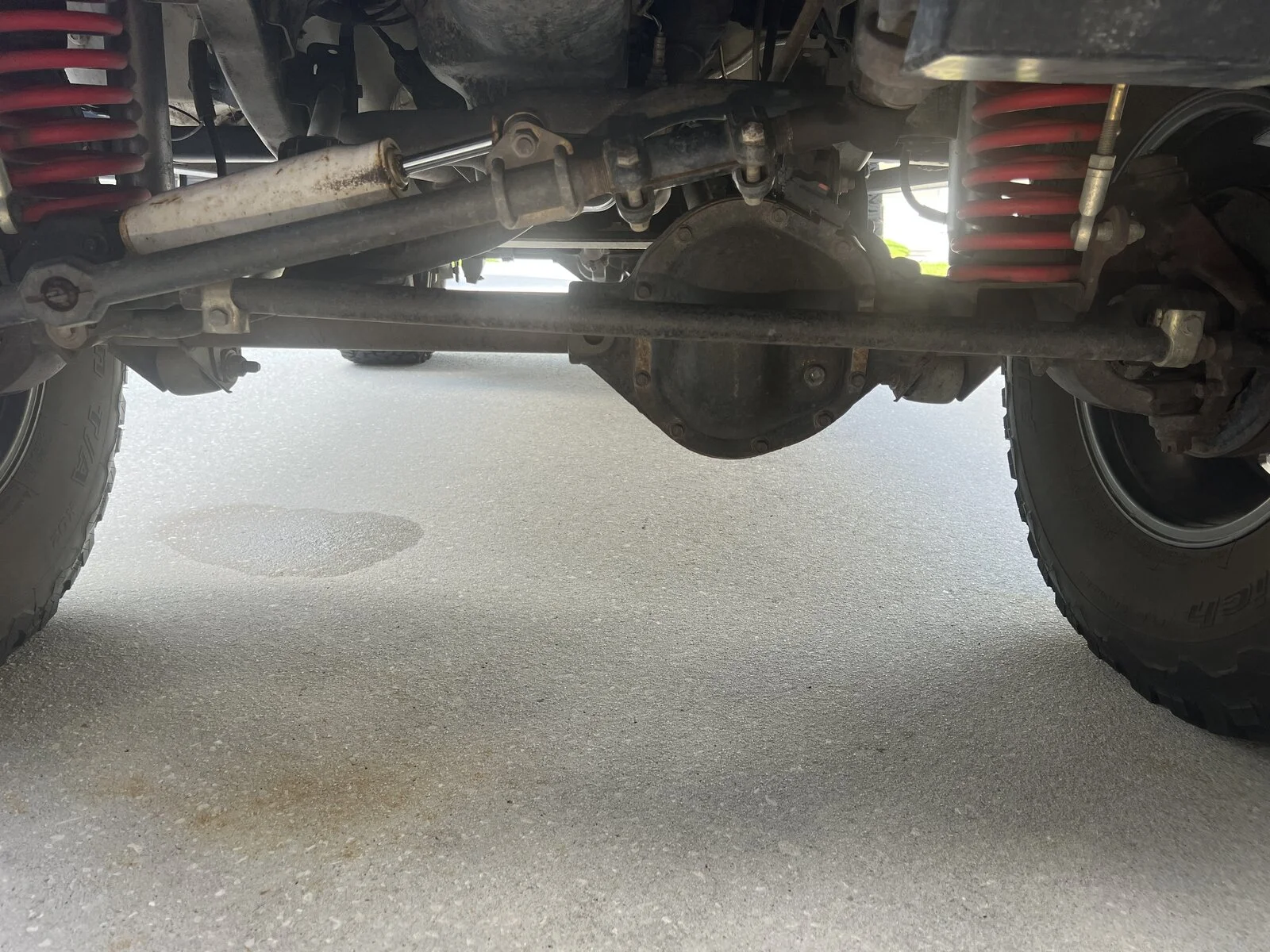

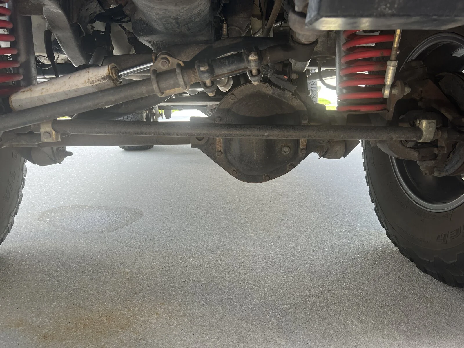

Now that I have my front end shake smoothed out with good tire balancing I am ready to get a new steering stabilizer. I think I have Currie steering. Can anyone confirm that and recommend a steering stabilizer?
Thanks!
Looks like Currie steering.
Monroe is typical recommendation. You might paint it when it arrives so it doesn't rust. Their paint job is suck.
I got a Rubicon Express just to avoid having to re-paint it. It was only about $10 more at the time.
You need nothing more there than a house brand hydraulic steering stabilizer/damper. Monroe is good but they don't include the tapered bolt that is required after removing the factory stabilizer which has the mounting bolt welded to it.
The Currie steering system needs nothing unusual, any made for a TJ will work fine.
This Rancho RS5000 hydraulic stabilizer is as good as any and includes the required tapered mounting bolt. This will work fine... https://www.gorancho.com/products/s...zer/rancho-rs5000-steering-damper-rs5407.html
It's available at Amazon... https://www.amazon.com/dp/B000CB42O2/?tag=wranglerorg-20
