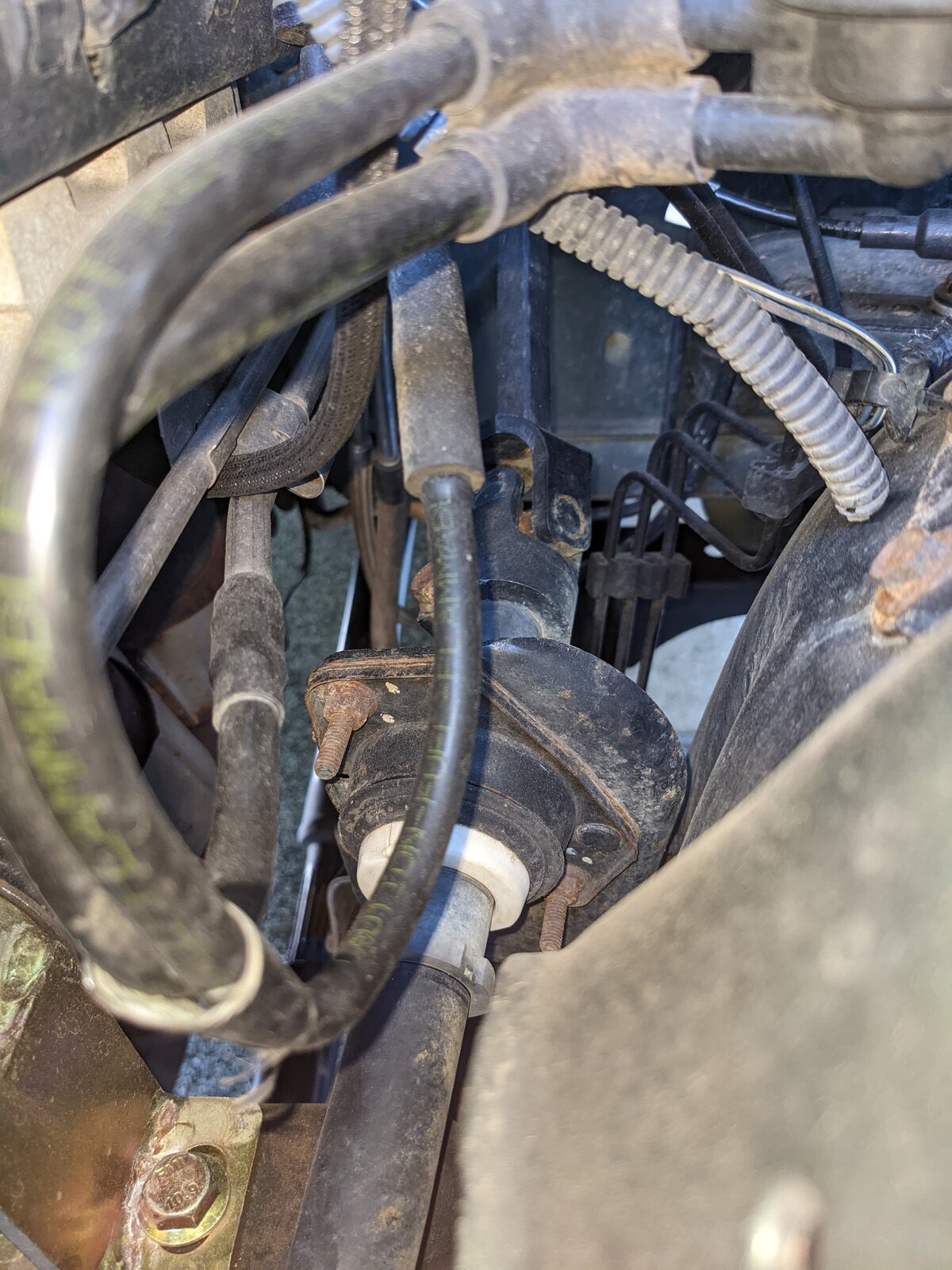

Hi i just bought my Wrangler TJ 4.0 from 2006 and now i recognized that my Steeringwheel and the attached Upper steering shaft moves in and out. It is Not really loose - it doesn‘t wiggle around. It just slides in and out.
the Upper steering shaft slides Here (See picture).

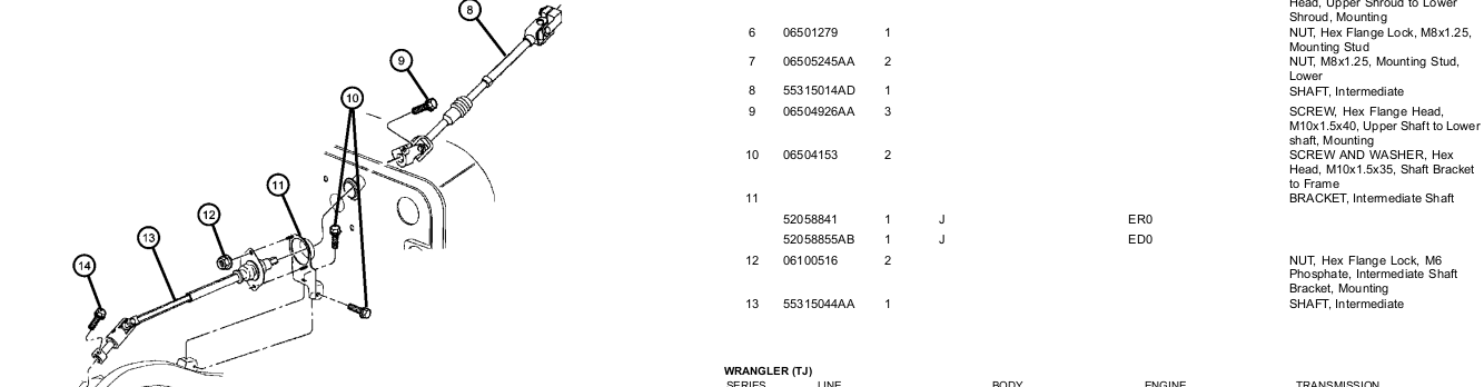

Your Jeep is missing a bracket for a shaft (#11). In your photo upper shaft with white collar, that will bolt to a bracket.
#52058855AB
It is attaches by two m10x1.5x35 bolts and nuts. Manual calls for length of 35, but as you can see in my photo there is no reason to have bolts that long.

Your jeep is missing a bracket for a shaft (#11). In your photo upper shaft with white collar, that will bolt to a bracket.
#52058855AB
Two m10x1.5x35 bolts and nuts

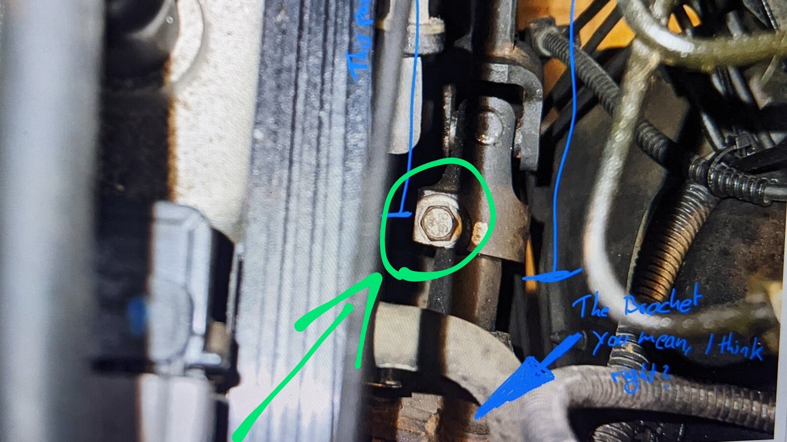

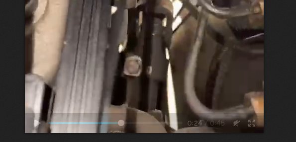

Sorry I rushed with my assumption. Another option is this silver bolt at 24 second mark of your video, make sure it is tight.
Bracket prevents lower shaft from moving toward steering wheel, bolt connects upper and lower shafts together.
Grab the shafts from engine compartment and try to slide it, you will be able to see where issue is.
If only upper moves - tighten the bolt.
#52058855AB

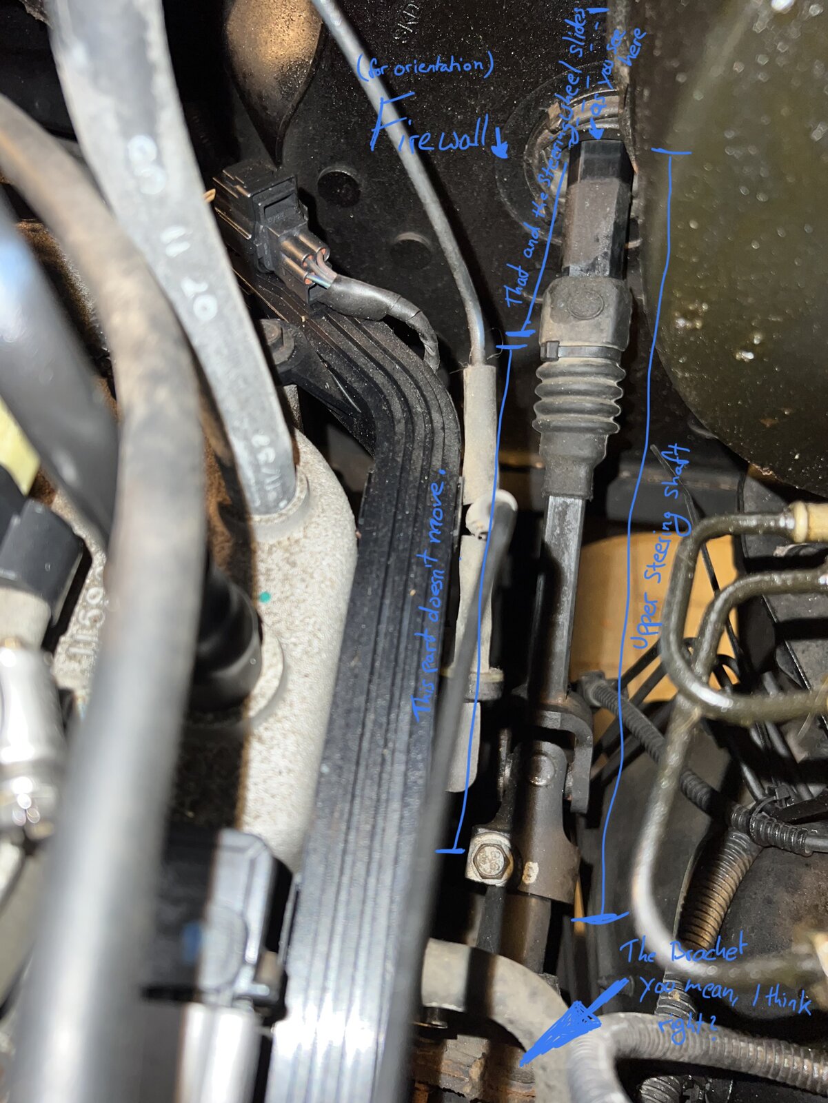

I could Not wait until tomorrow :D so i went to the garage to have a look.
I case I got it right what you meant, it has to be something else…
Because (unfortunately) I have that bracket and everything sits tight.

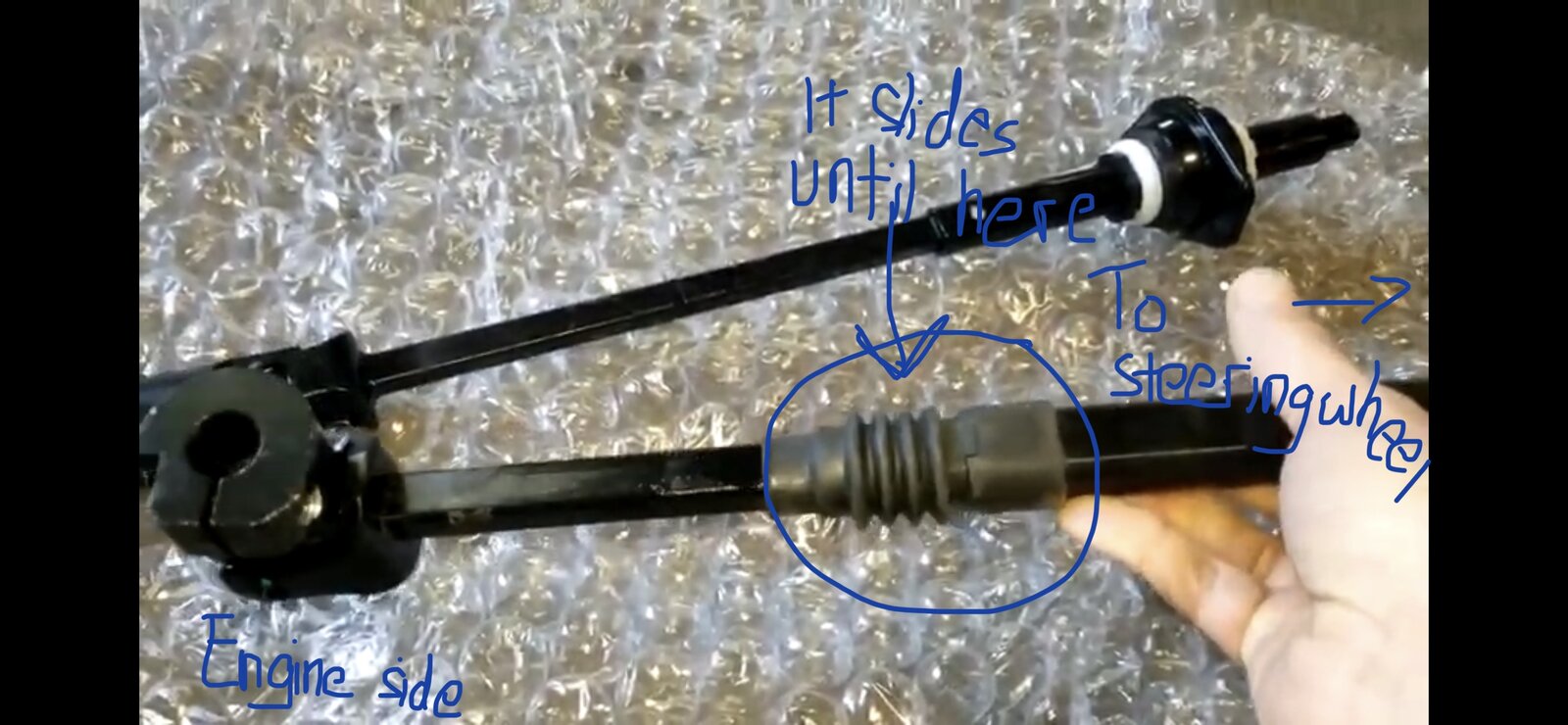

the issue is that Not the hole upper shaft moves, it’s just the upper part of the upper shaft. Like the upper or outer part of that telescope mechanism.
I attach another picture with a sketch.
Oh thank you! You’re answering so fast! Haha
Yes that’s exactly whats happening. When I look from the engine compartment and slide the steeringwheel in and out just the upper part of the upper shaft slides. The rest is tight and doesn’t move.
But I don’t know which bolt I have to tighten. Could you explain again or mark it in the picture. I’m sorry

Bolt is marked, that should take care of it.

Oh you mean that bolt, okay.
Could you have another look on my picture with my sketch?
Because the bolt you mean now is to connect the upper and the lower shaft, right?
But in my sketch you can see that only one part of the upper shaft is moving.
My issue is all about the upper part of the upper shaft or maybe the steering column.
The upper shaft is build like a telescope so the shaft has one part that goes to the steeringwheel and one part that goes to the lower shaft. These two parts have a different Diameter. So the part that goes to the lower shaft can slide into the part that goes to the steeringwheel. So the hole upper shaft is made by these two parts and can slide - like a telescope.
That is my issue. Because I think that should not slide when it is installed.
In my picture I tried to explain with the sketch. Maybe you could have another look. I’m so sorry!! I’m so glad you’re helping so much!

cut the zip tie and slide the boot out of the way and look at it.
it's not slopping at the riser that is beyond what you videoed anyways, it's not the u joint it's whatever is under that boot is that looks to be wonky.
Your English is fine, i have made an assumption and quickly jumped to a conclusion without fully analyzing what you have said and sketched.
I know there is two more bolts that are holding steering column it is right above the pedals, if they are unbolted everything will move (entire steering column), including turning and wiper switches. But you only have steering wheel movement, as if there is extra adjustment option.

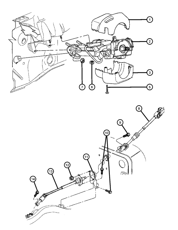

I wonder if European version allows in and out adjustment?
Looking at the diagram, there is a nut (#6) that i don't remember what it does. If no one else has any clues, i will crawl in there in the morning to have a look.

The shaft has a sliding joint on it. It’s made to move in and out like that.

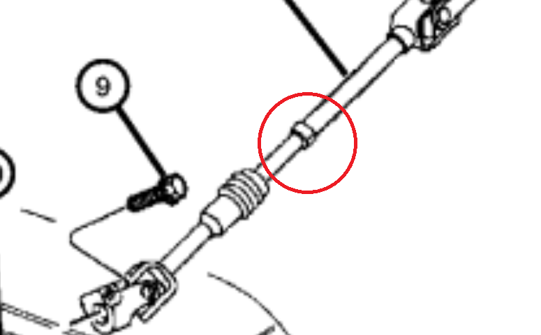

the witness says #8, that shine on that stick is witness to movement at that point, no?
what's under the boot?

That’s a quick video of my old shaft that I replaced. Still had it in a pile of scrap parts out back so I ran out and looked at it for educational purposes lol

You are missing or it came loose the lower bearing retainer for the steering column. The column should not move up and down. The intermediate shafts do not hold the column shaft in place. I took a picture of mine. It appears this retainer should be in a groove on the shaft. It would probably be best to pull the column but you will need to be careful of the clockspring for the airbag. Center the steering ( wheels straight ahead) disconnect battery, remove airbag and steering wheel. Remove the clockspring from the column. Do not turn the clockspring while off. Remove column and repair lower bearing retainer. Reinstall in reverse of removal.

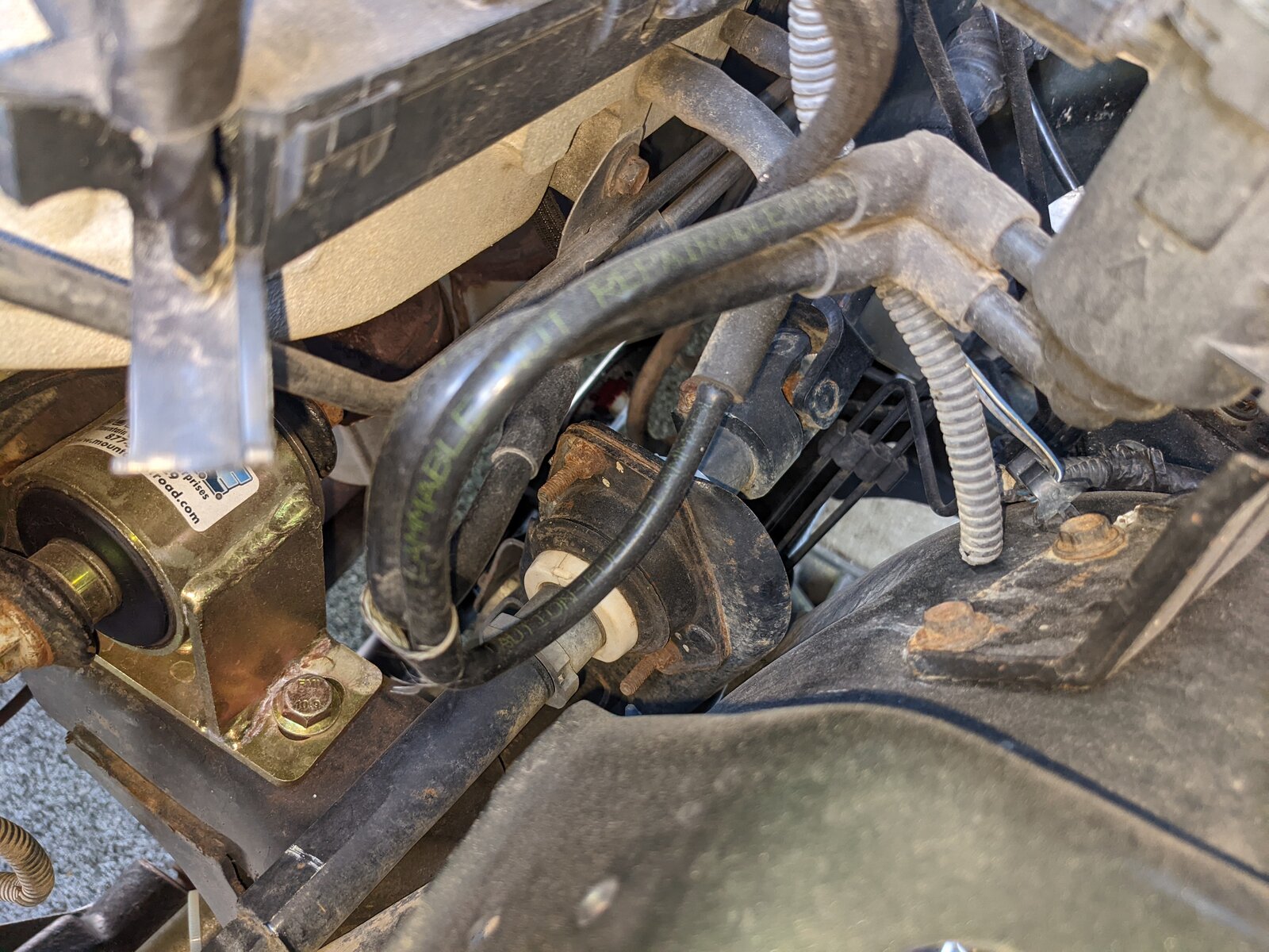

There is something different between your and mine column at the connection to the upper shaft.
The metal ring you marked red is in my case not at the position it has to be, right? (See video)
I can see a spring that is there and under the spring I think there is the metal ring.
The spring is also not on tension. So I can slide the spring a little bit up and down. And that is not the purpose of a spring haha
Could that be the issue? And how could I fix that? Do I have to strip down the hole steering wheel, column, shaft?

Yours looks a little different. If you can pull that lower shaft off by removing the bolt and slide it off. (Just don’t turn the wheel around while disconnected) all the parts may be on the shaft.there should be a snap ring or some kind of retainer to keep the spring under tension against the lower bearing.
