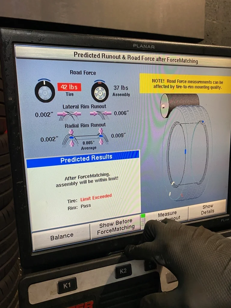

I was a bit too optimistic about the tire pressure resolving the shakes. The lower tire pressure helped but the wobble never went away. I already had the tires balanced 3 times but still decided to have them checked with a road force balancer. Turned out that the brand new Duratrac front right tire was so out of spec that it could not be balanced at all. So road force balancing is really worth it - and yes, I got the Duratrac replaced for free.

@Fire814 I googled for a small local shop which advertised road force balancing on their website. The large chain, which balanced my tires 3 times incorrectly, actually had a road force machine, but nobody used it.
