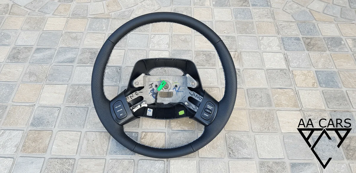

This video from Australia shows a WJ steering wheel, reconditioned in Poland and ordered on eBay, being installed in a TJ. Looks awesome.
Unfortunately, I have a '97 with no cruise control. I think the '97 looks exactly like an XJ wheel. As posted above, I'm sure the WJ wheel will work on my TJ, but I'm reluctant to have steering wheel buttons that don't work.
Same seller on eBay (yeah, the one in Poland) has this XJ wheel that looks great, and looks exactly like my '97 TJ wheel except I don't have cruise so my airbag wouldn't work.
Seller say to contact him for special orders - I think I will do that.
