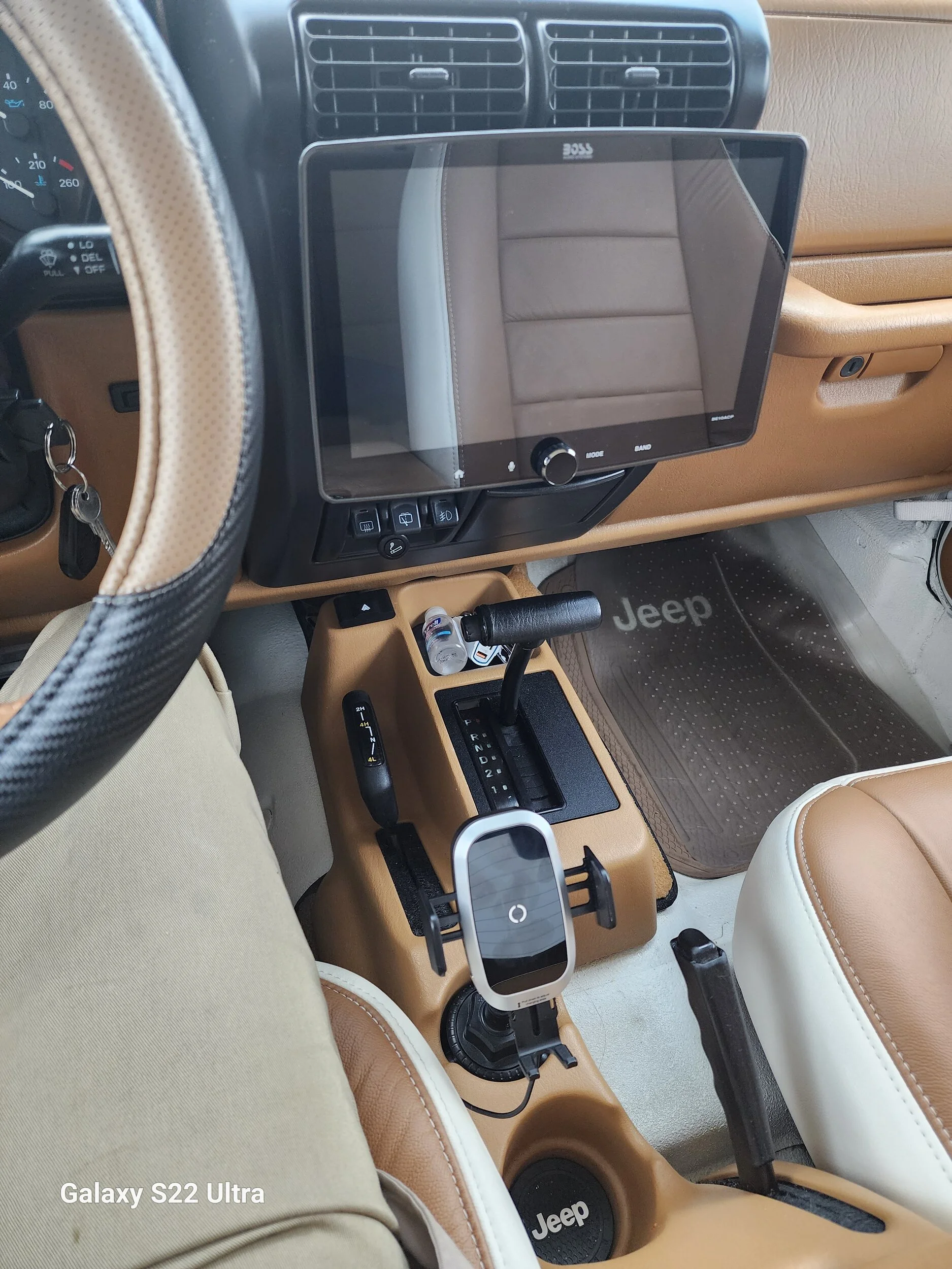

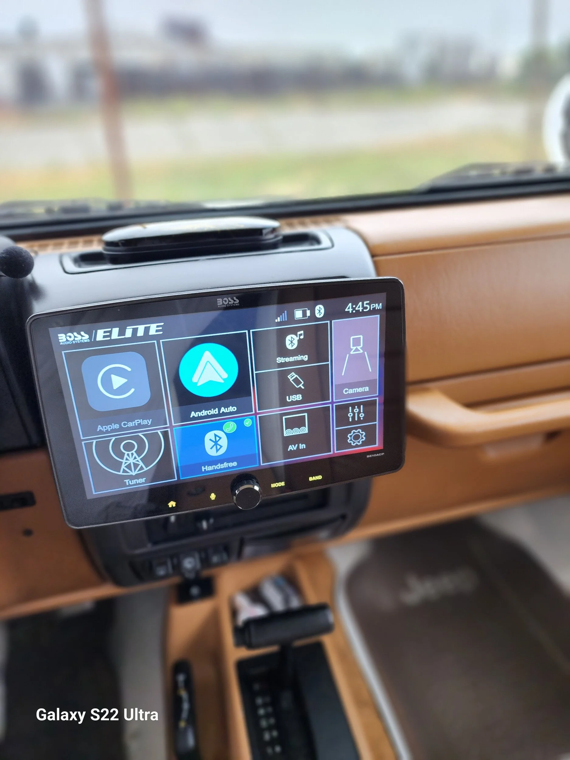

You can also go with a single din with all the bells and whistles, using a single din installation kit into your 1-1/2 din that will look totally professional, and have a larger screen that will move out of the way, and almost be flush, like mine, and, you don't have to cut up your original dash. Replacing those parts when the double din fails, can cost hundreds and hundreds of dollars now. My screen is also removable for theft prevention. You normally can't do that with a double din.

It is awesome. If you are in an area where you worry about your stereo, just take the screen with you. I brought a padded shoulder bag for $20 to carry mine. No thief will steal a stereo without a face or screen. There is no profit in it. No one will buy a stereo without a screen or face to control it. A thief won't steal it, because no one will buy it, and the thief won't waste his time and money trying to acquire a screen for $100 plus. A stolen stereo is only worth that much maximum alone. So, there is zero profit for the car stereo thieves drug fix. In my life, I've suffered at least 4 attempts to steal my car stereo. Two were successful. In one of them, I found bullets and a crack pipe left in my car(before I got my Jeep). My knowledge has led to no car stereo thefts in my Jeep. *the dog has spoken*. lol.
