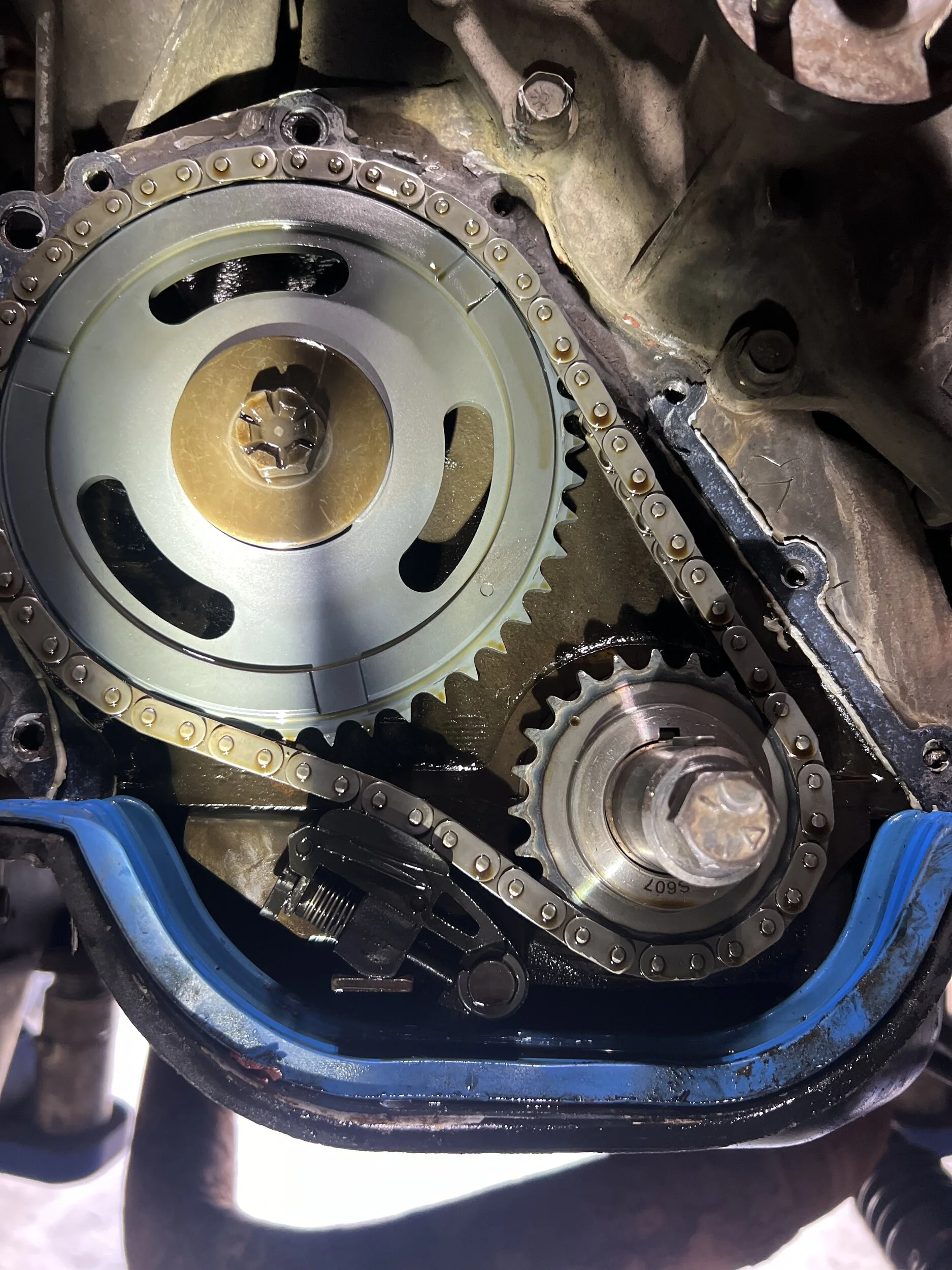

Ok. So little did I know the PO had done a timing kit and got the timing 1 tooth off on the set up. It cause all of my issues.
