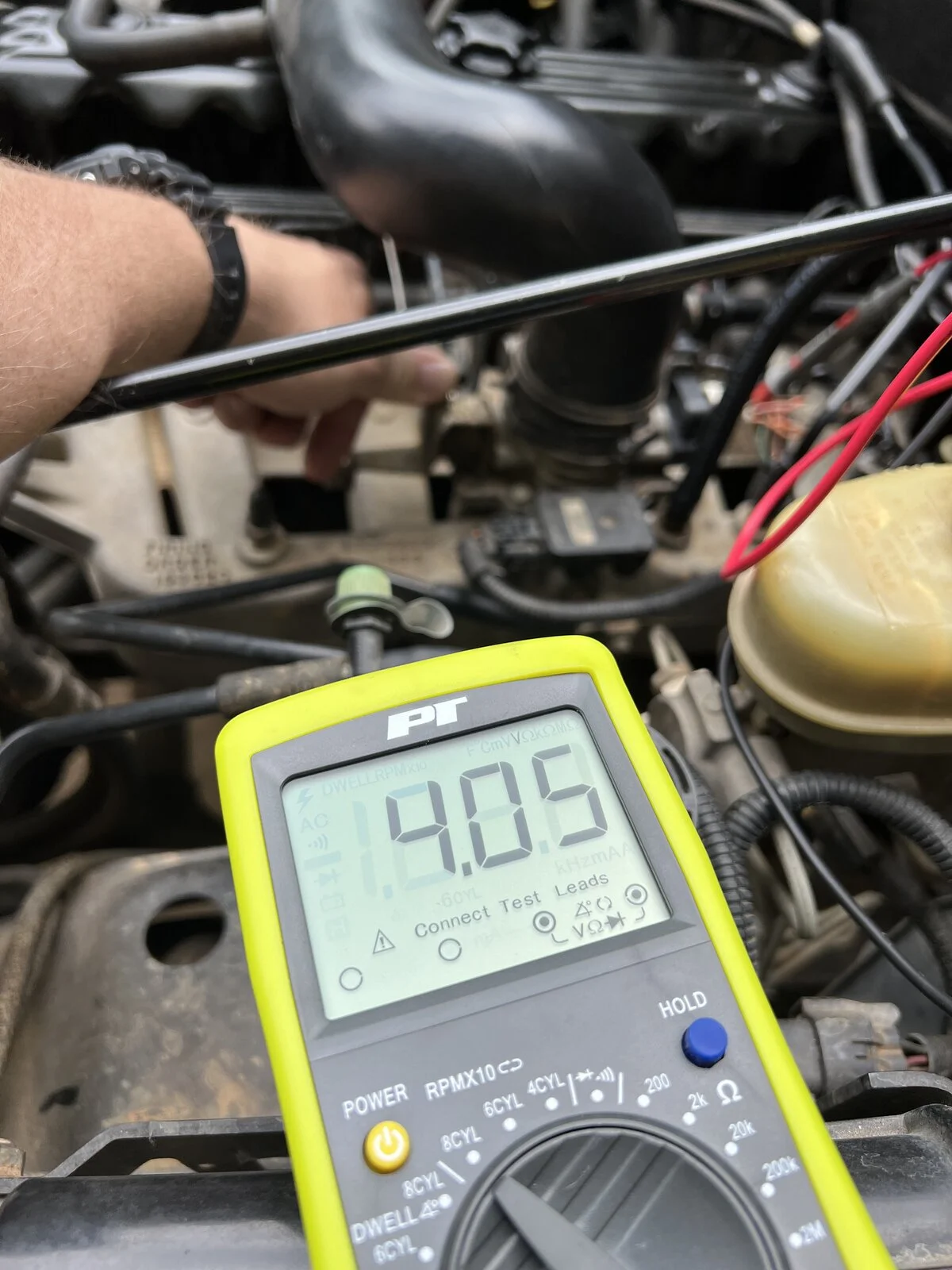

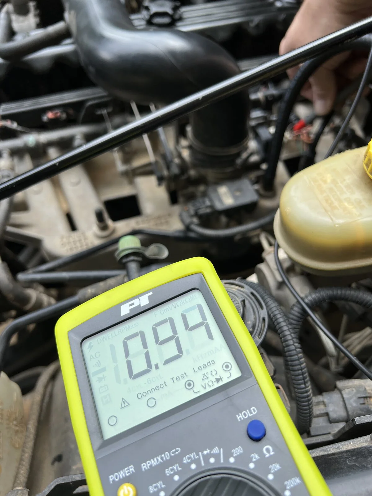

1998 jeep wrangler TJ with a 4.0 manual five speed. I am idling too high and running rough. (asked about similar issue, trying to whittle it down) This happened overnight. I have replaced the OEM TPS with another Mopar OEM tps. Still getting P0123 error
Ground is good voltages 5.14 which is good, but the idle signal is running high 0.94, should be 0.86?.
Wide open, 4.05
Any thoughts?

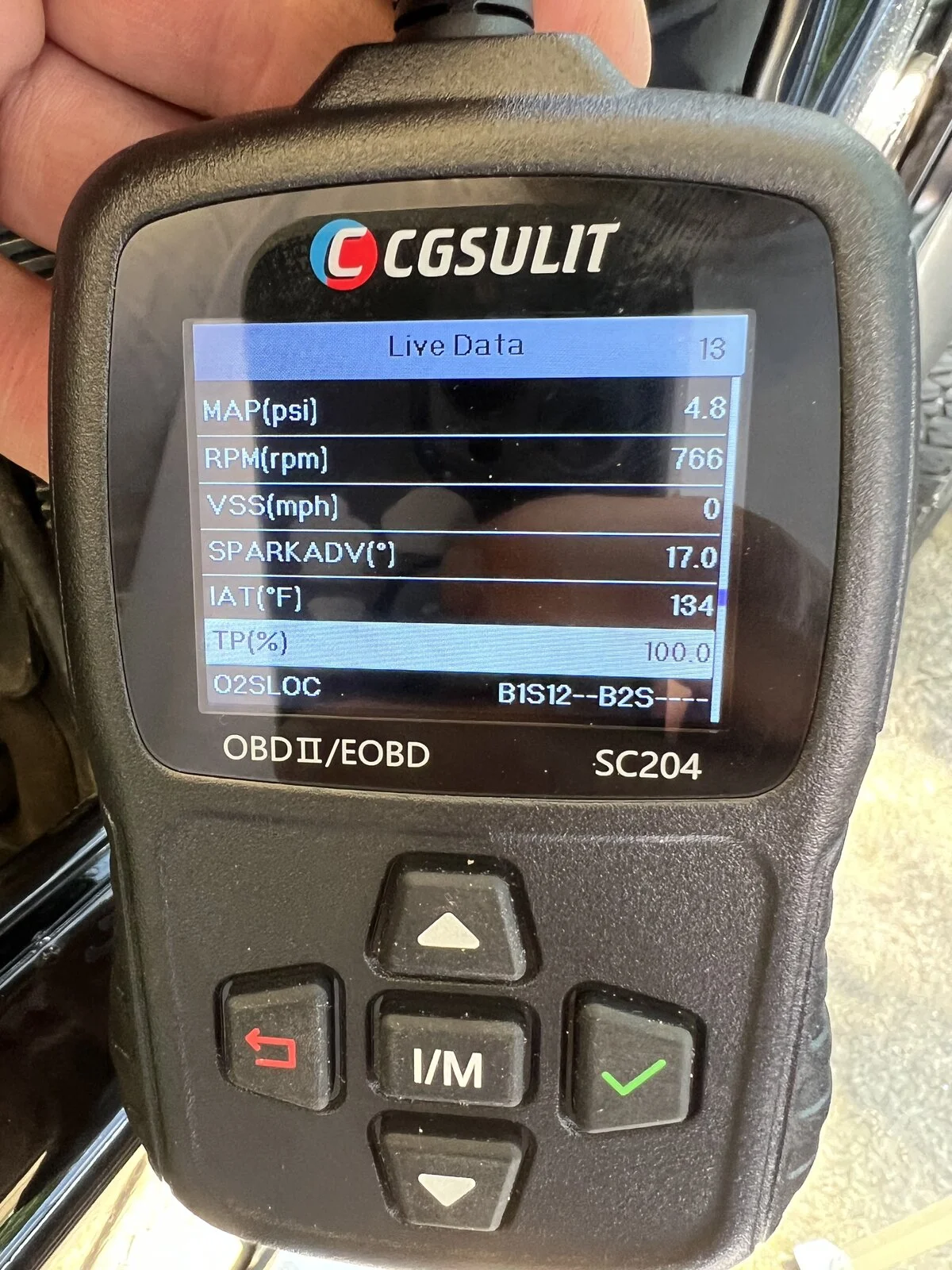

I went through an entire can of carbon, choke cleaner, through all the vacuum schematics, and I can say that I have tested all vacuum connections…
I still have the primary issue which is electrical and nature because I can unplug the TPS and have RPMs in the 770s. They do not move very much.
