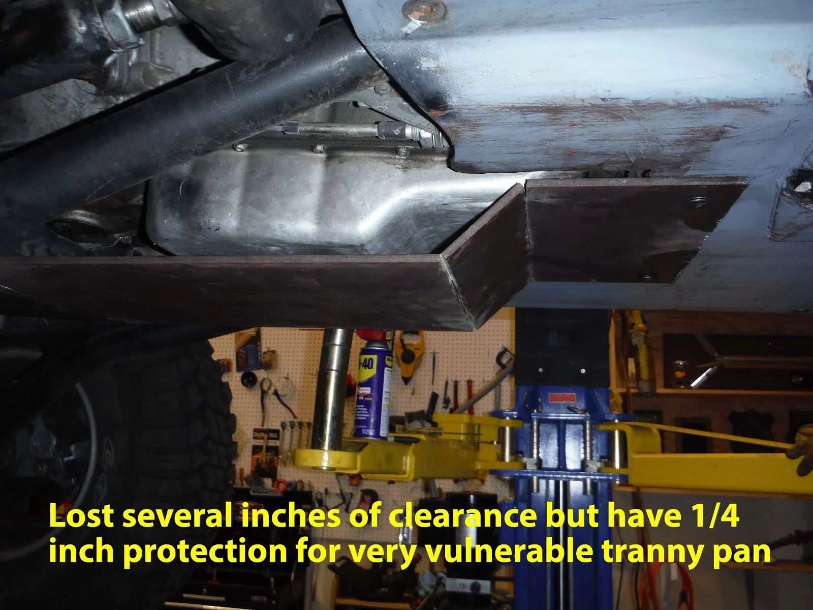

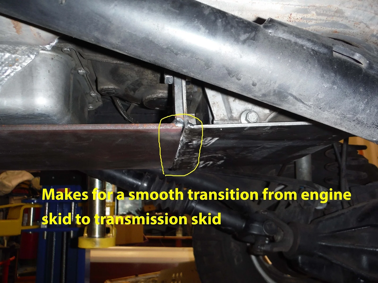

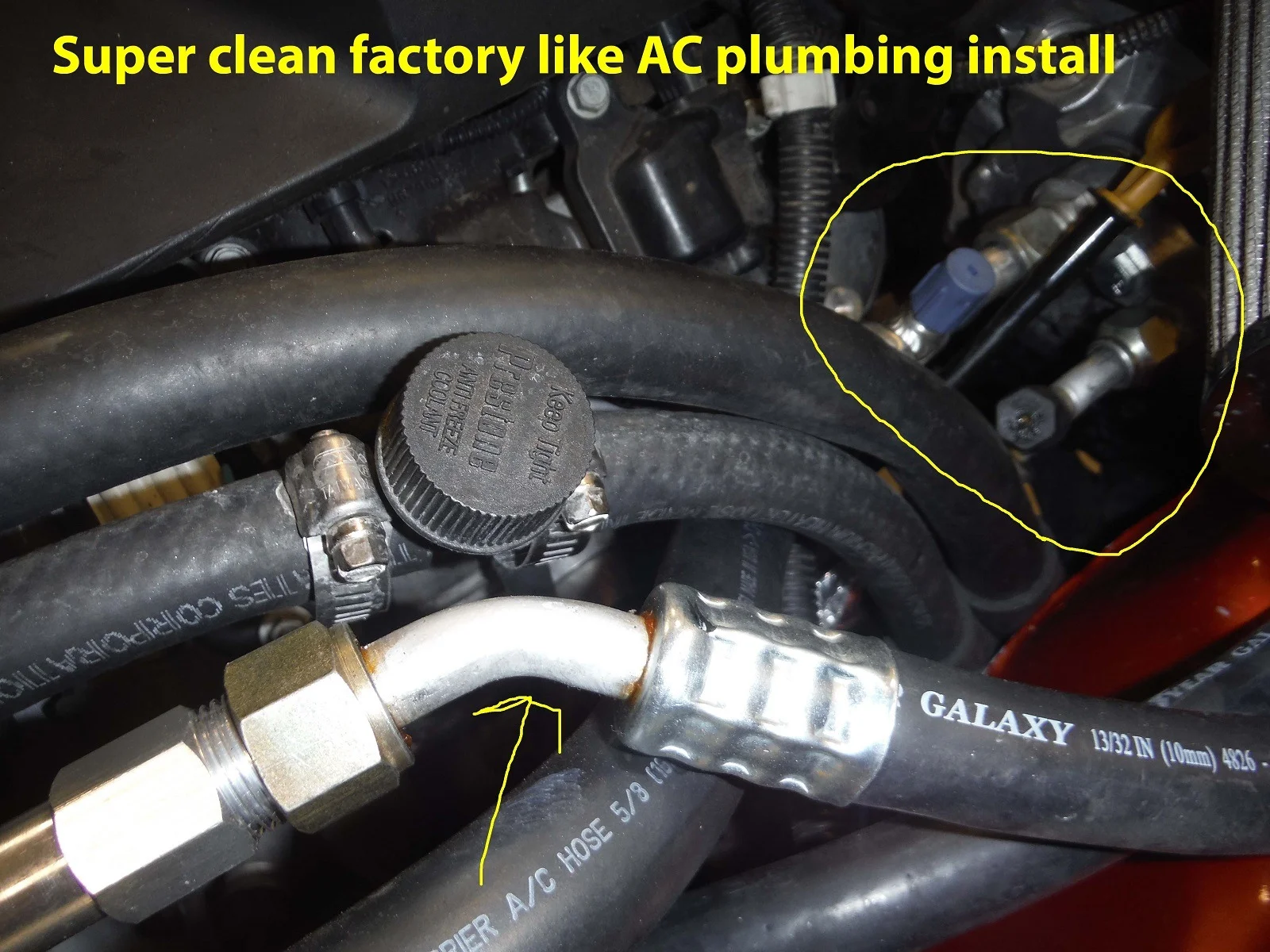

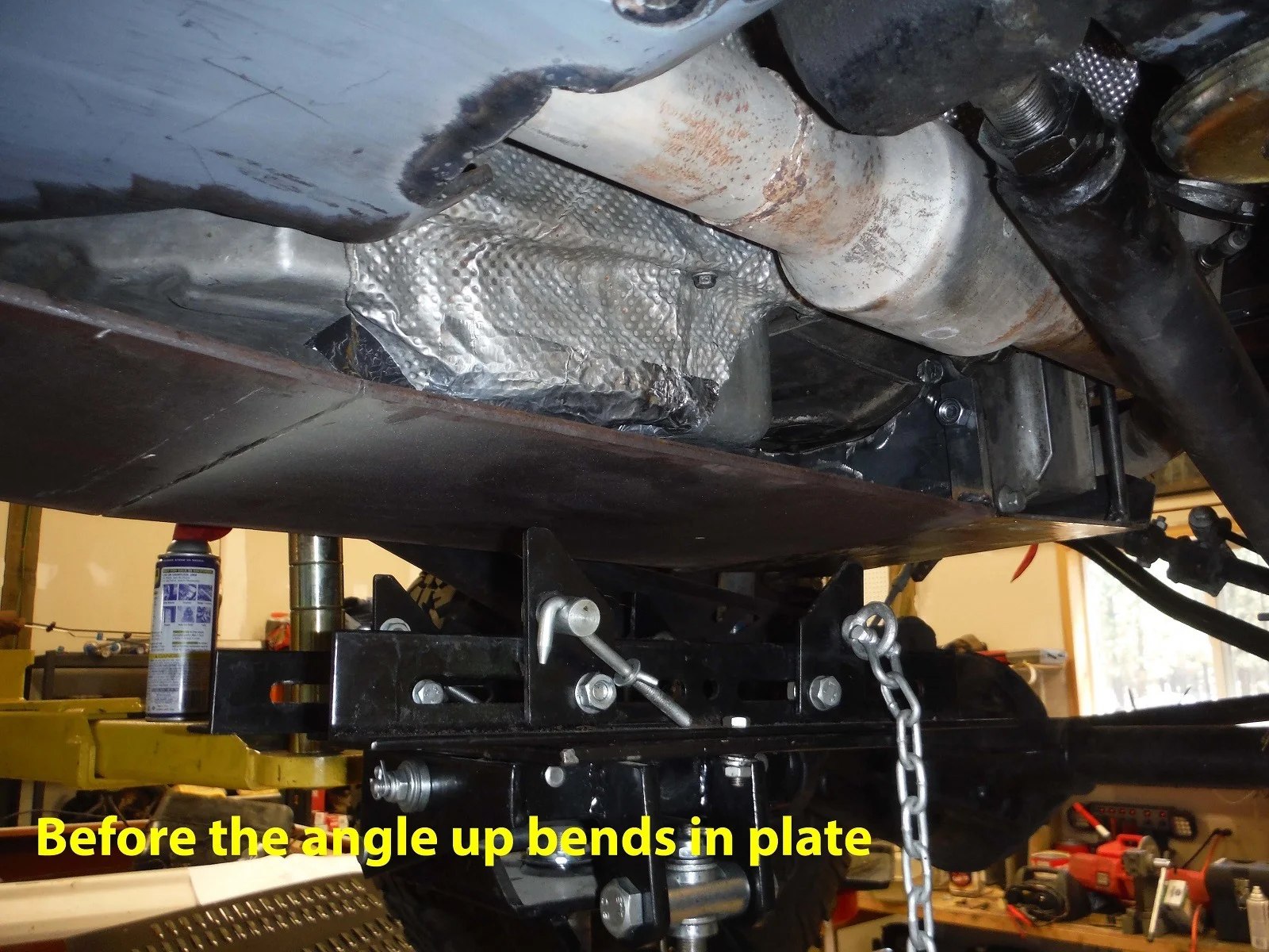

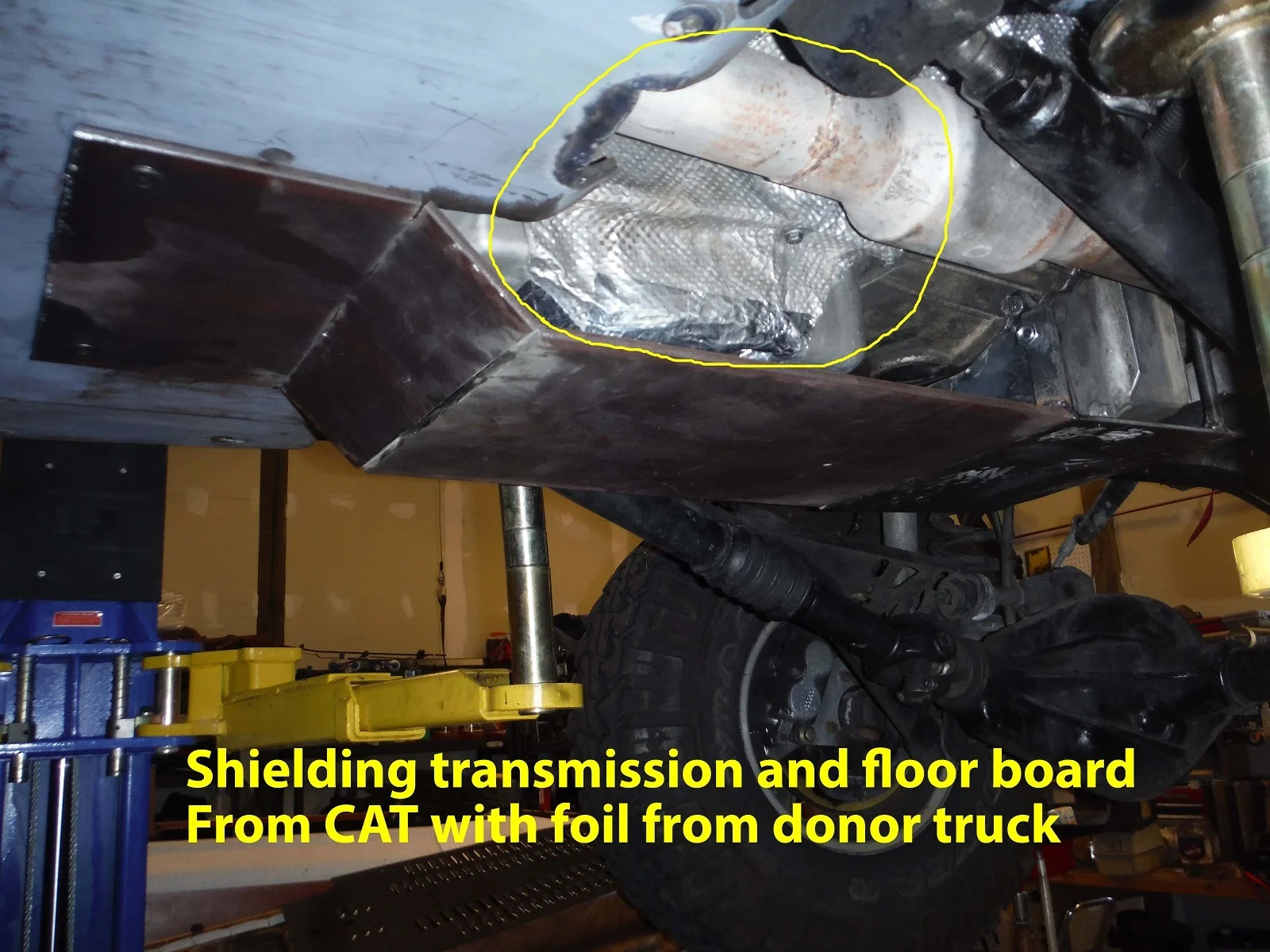

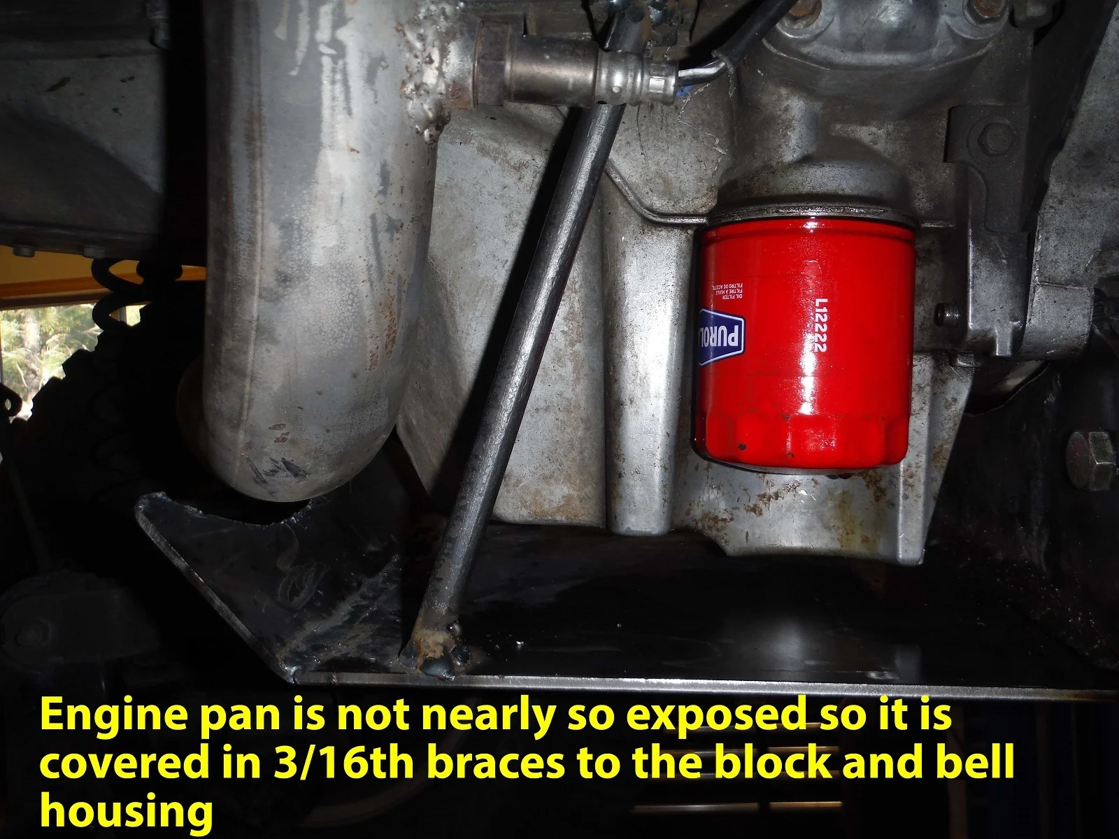

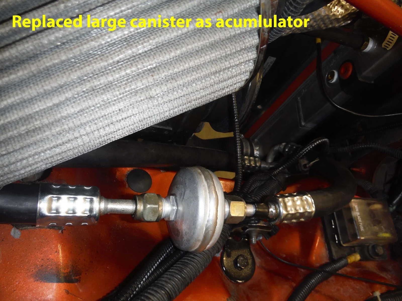

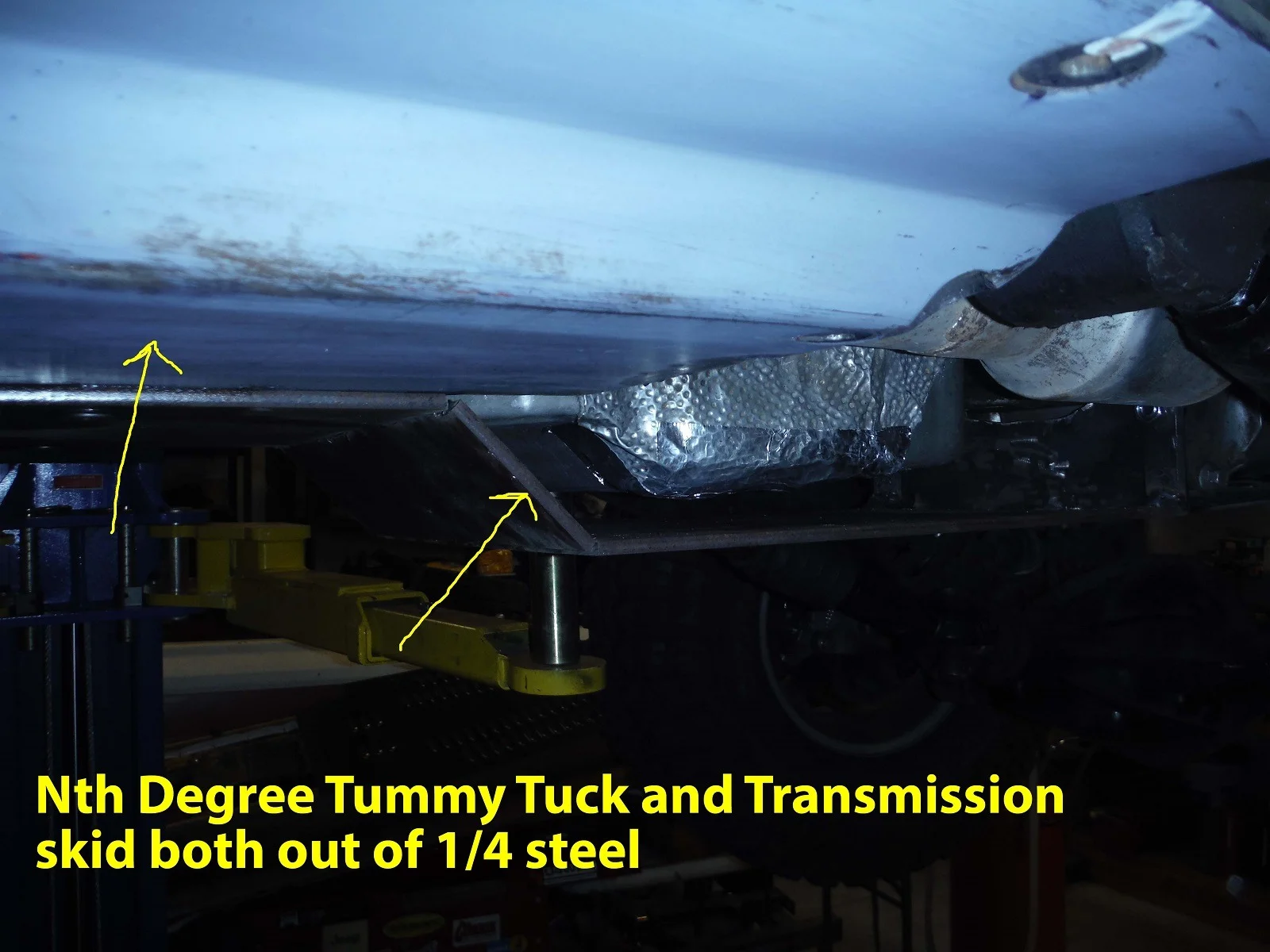

Finally got the AC plumbed and charged. Almost done fabing new skid plates for engine oil pan and LARGE EXPOSE transmission pan. Sacrificed a couple of inches of ground clearance for more smooth lines of the plates in an attempt to less potential hang up problems.

Wow, I really like what you've got going on underneath there! How is the engine running these days? Got all the little bugs worked out?
Chris the engine is running great. It is showing a bit hot with the AC on and if I can find a way Ill put a pusher in front of the radiator to supplement the puller behind the rad. I just got the hood louver yesterday and ill get it installed in a couple of days. That should help--I hope!
