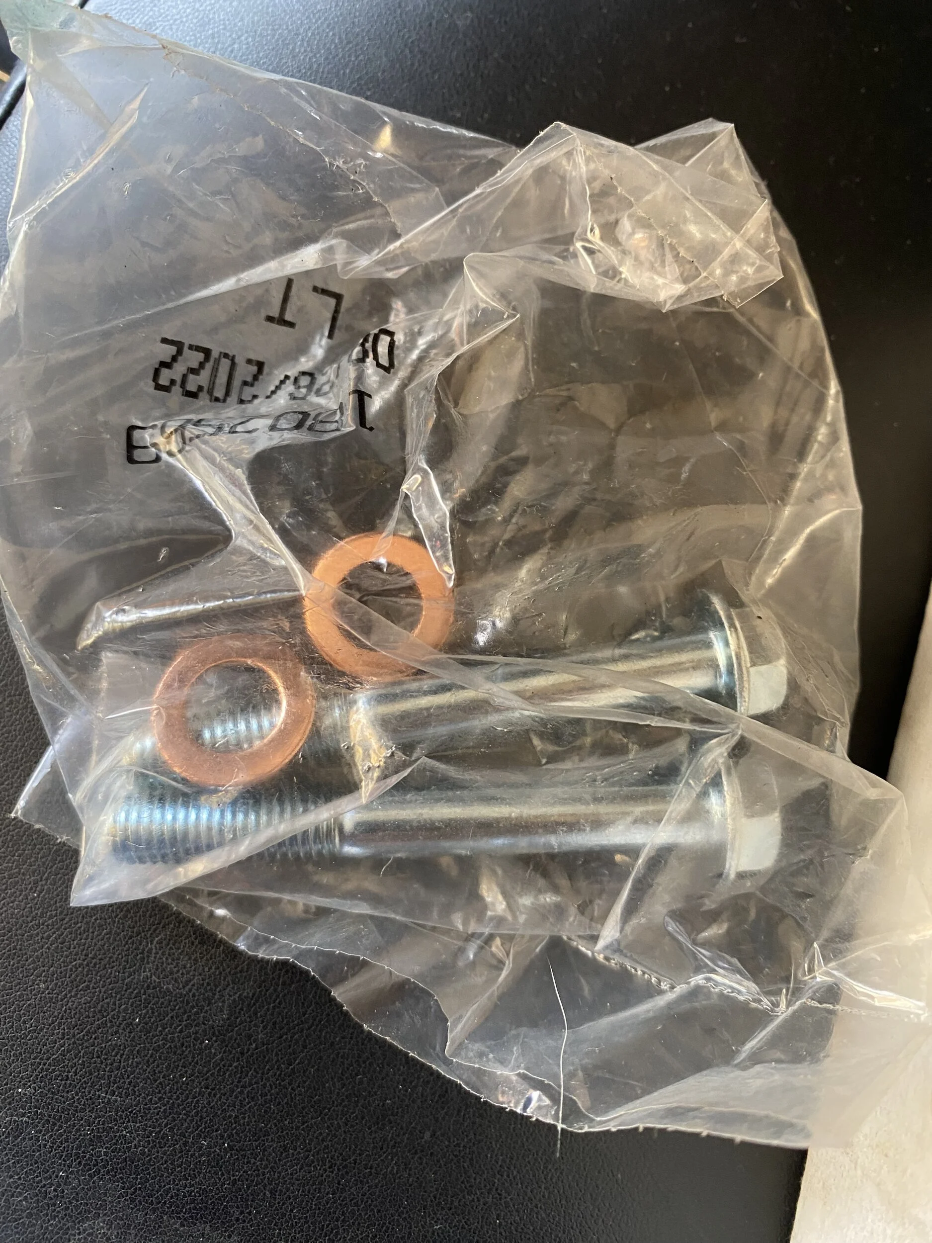

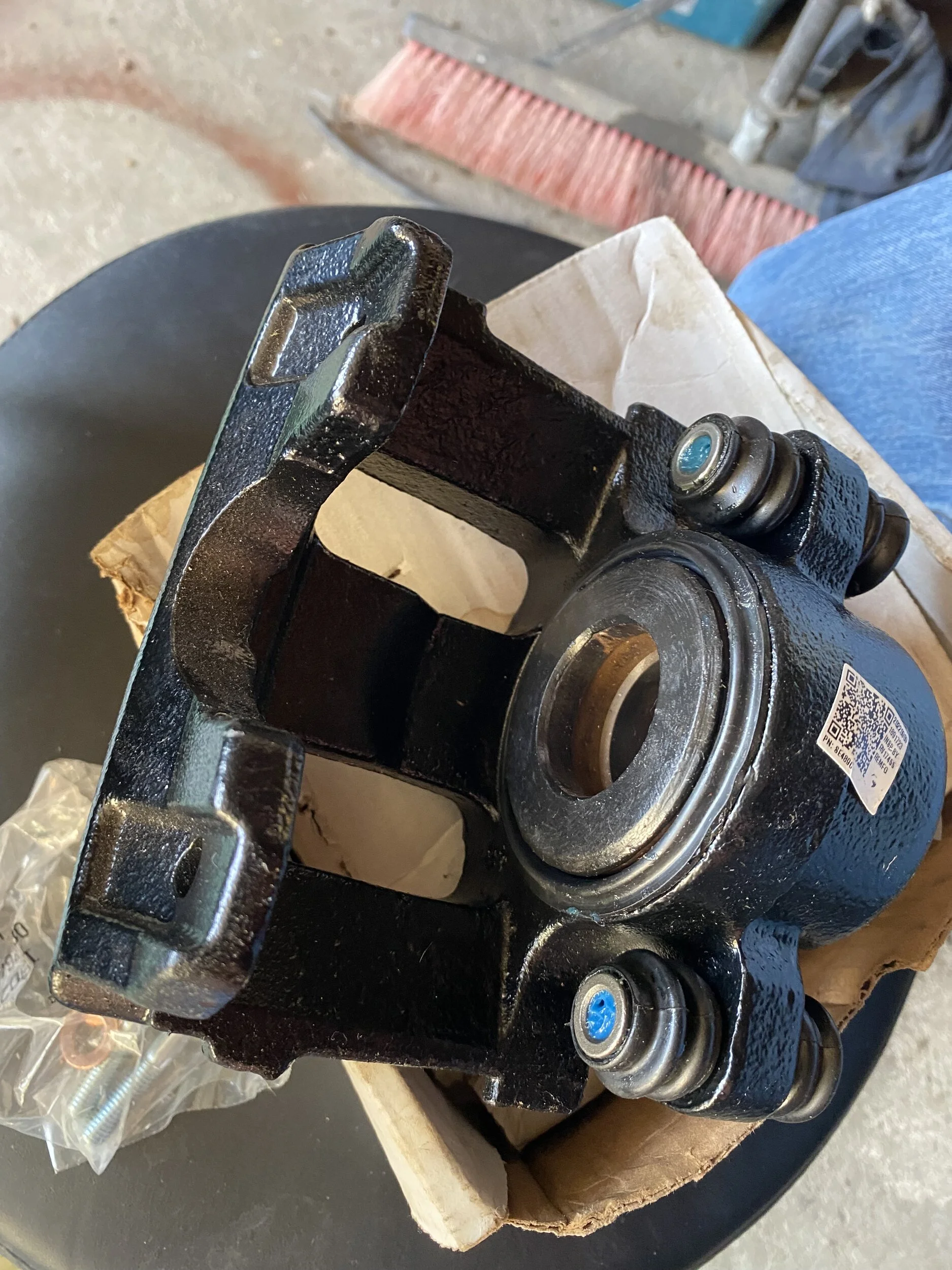

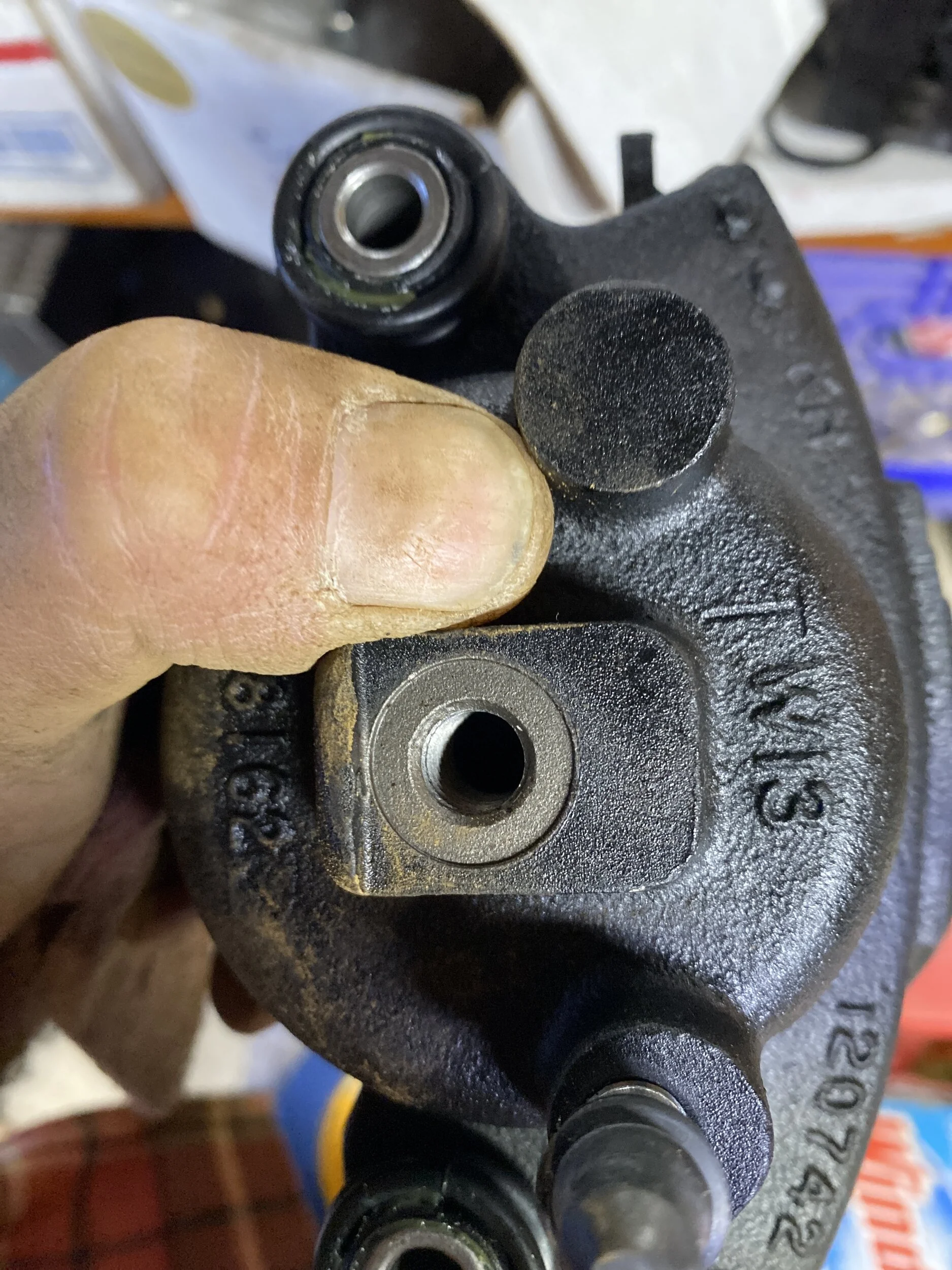

Well here it is.
New banjo bolt. New crush washers. New mounting bolts. Slides are greased and mobile. Coating has good coverage and $32 each.
The YJ got the Zinc calipers it’s garaged all winter.
Bens Sahara got the Zinc it lived in Virginia.
For my all season mud and rock LJ I’m going to give these a try.
Already have a set of BMB pads and rotors ready to go.
Passenger side has been hanging up so these are the replacement.
I really want new calipers instead of reman but I’m gonna give these a try. I’ll keep a close eye on them.
They won’t be installed just yet, I’ll keep y’all updated.
See pics

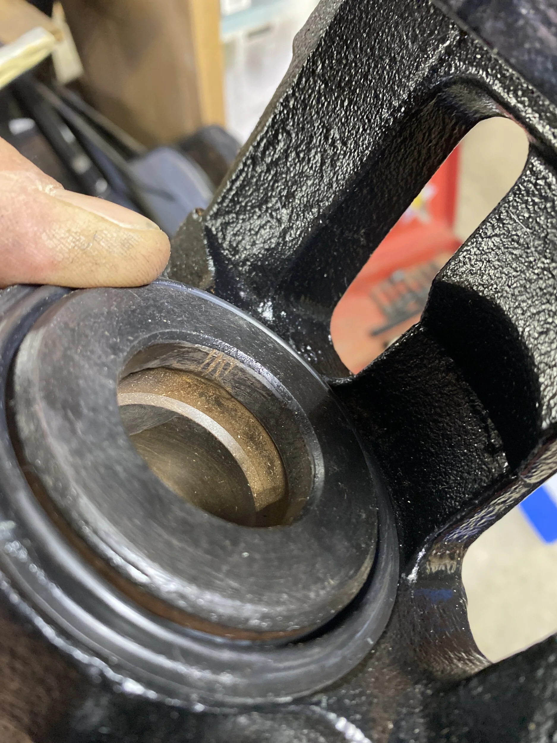

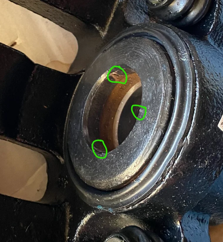

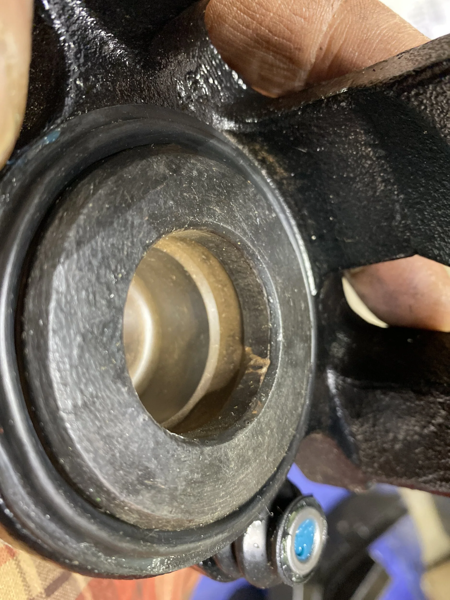

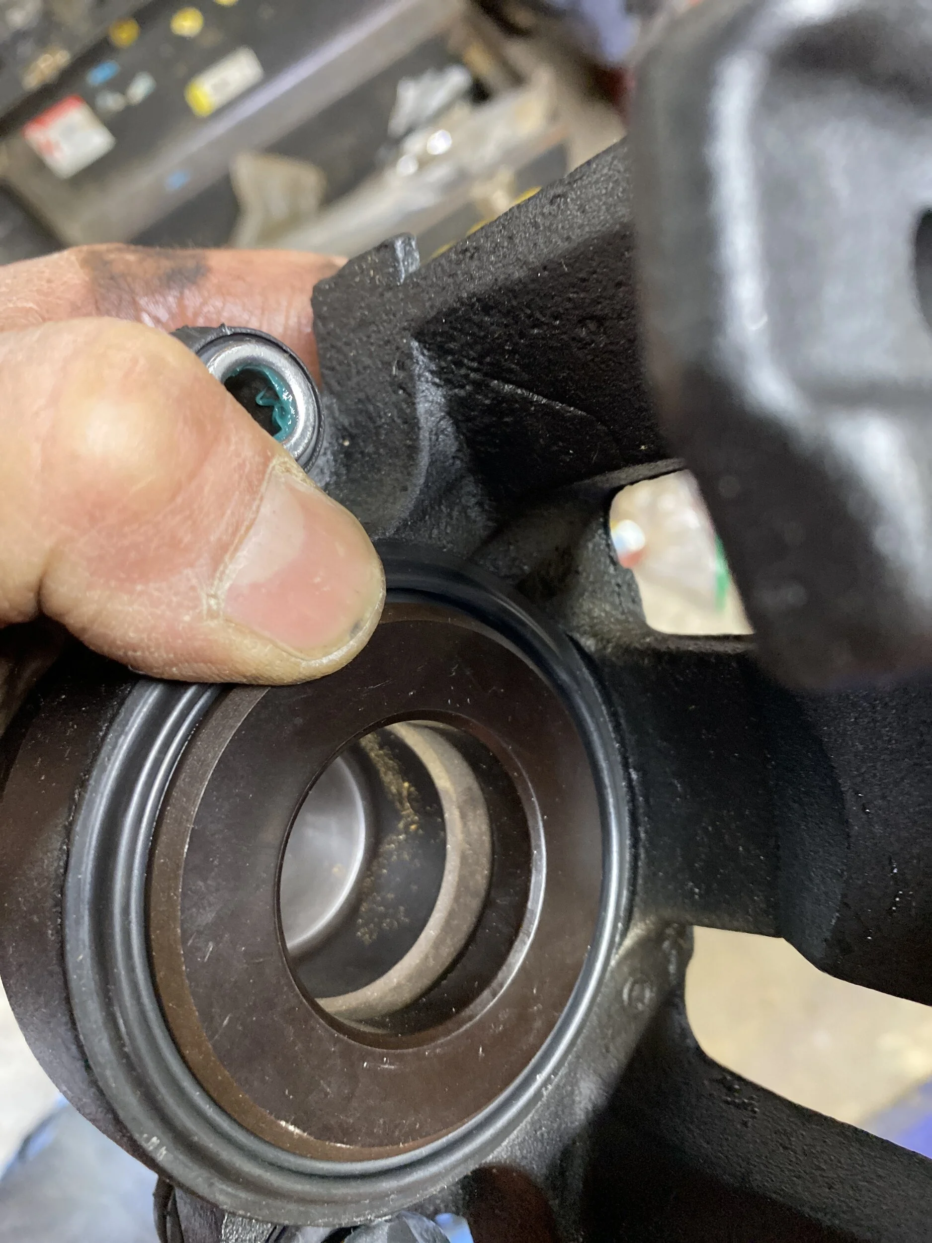

Those marks look suspiciously like what the rose clip on a brake pad causes when you install it. New pistons should not have any marks in that area.
Reactions: John Cooper

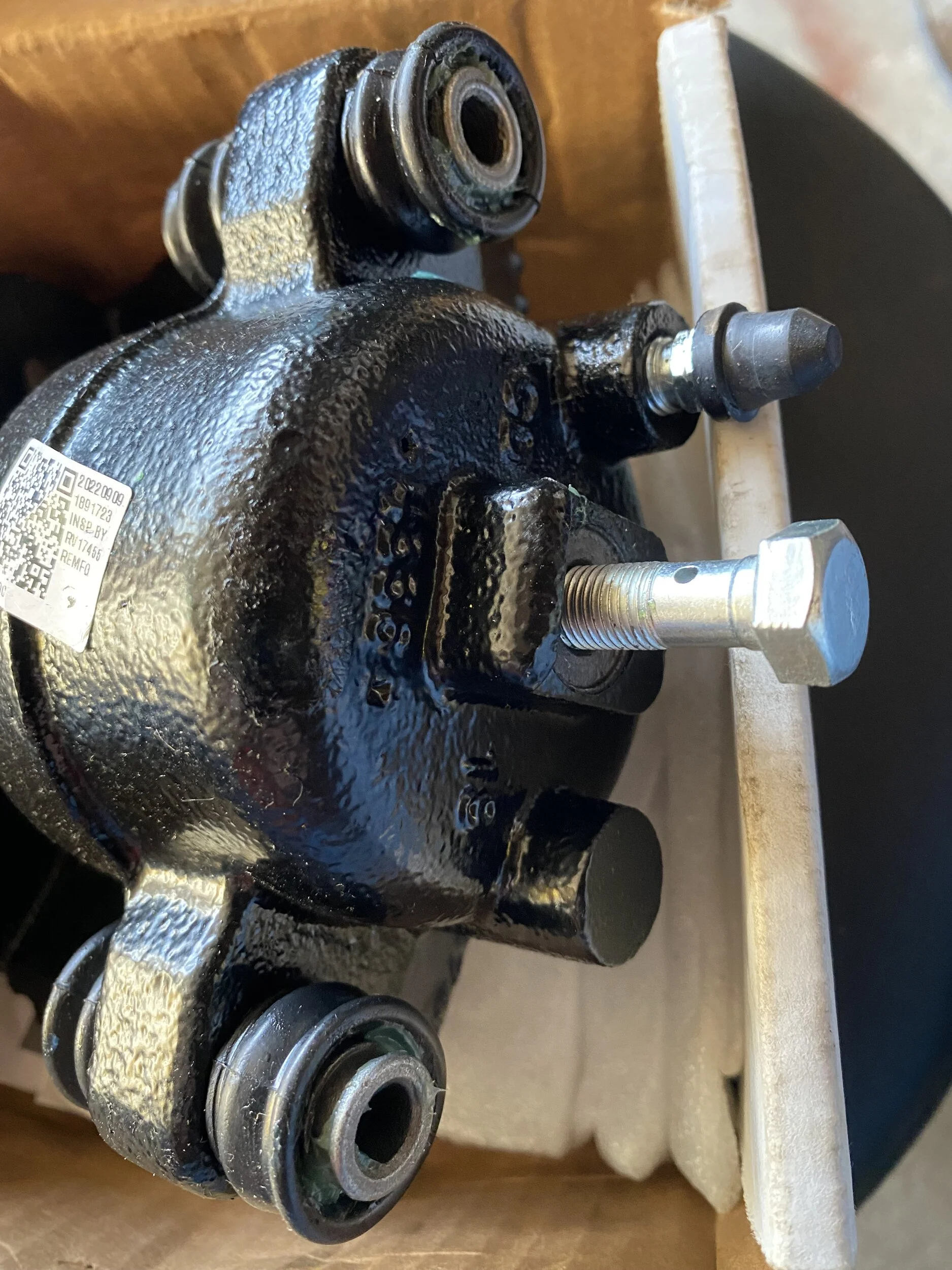

Ok. I see what you see. That one was the opened box. The first two photos here are of that caliber. Third photo is of the box I just opened. It does seem someone fit a pad in there in the open box but not the other.
Maybe that’s why the box was open

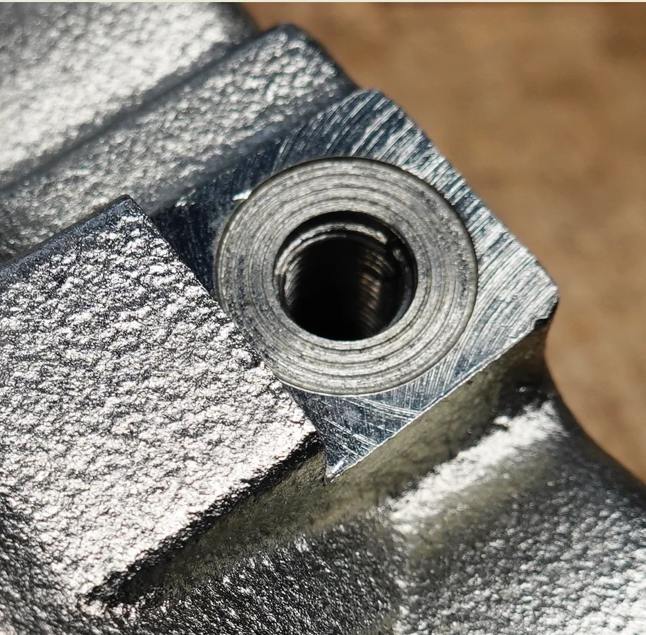

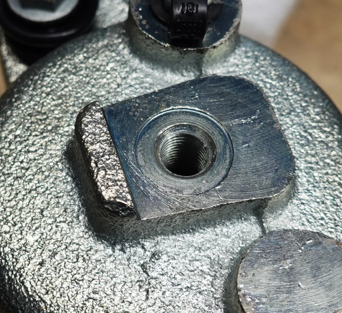

Ideally, you want the sealing area for the crush washers to be clean and flat. The further they are from that, the more you have to tighten the banjo bolt.
Or this, either works.

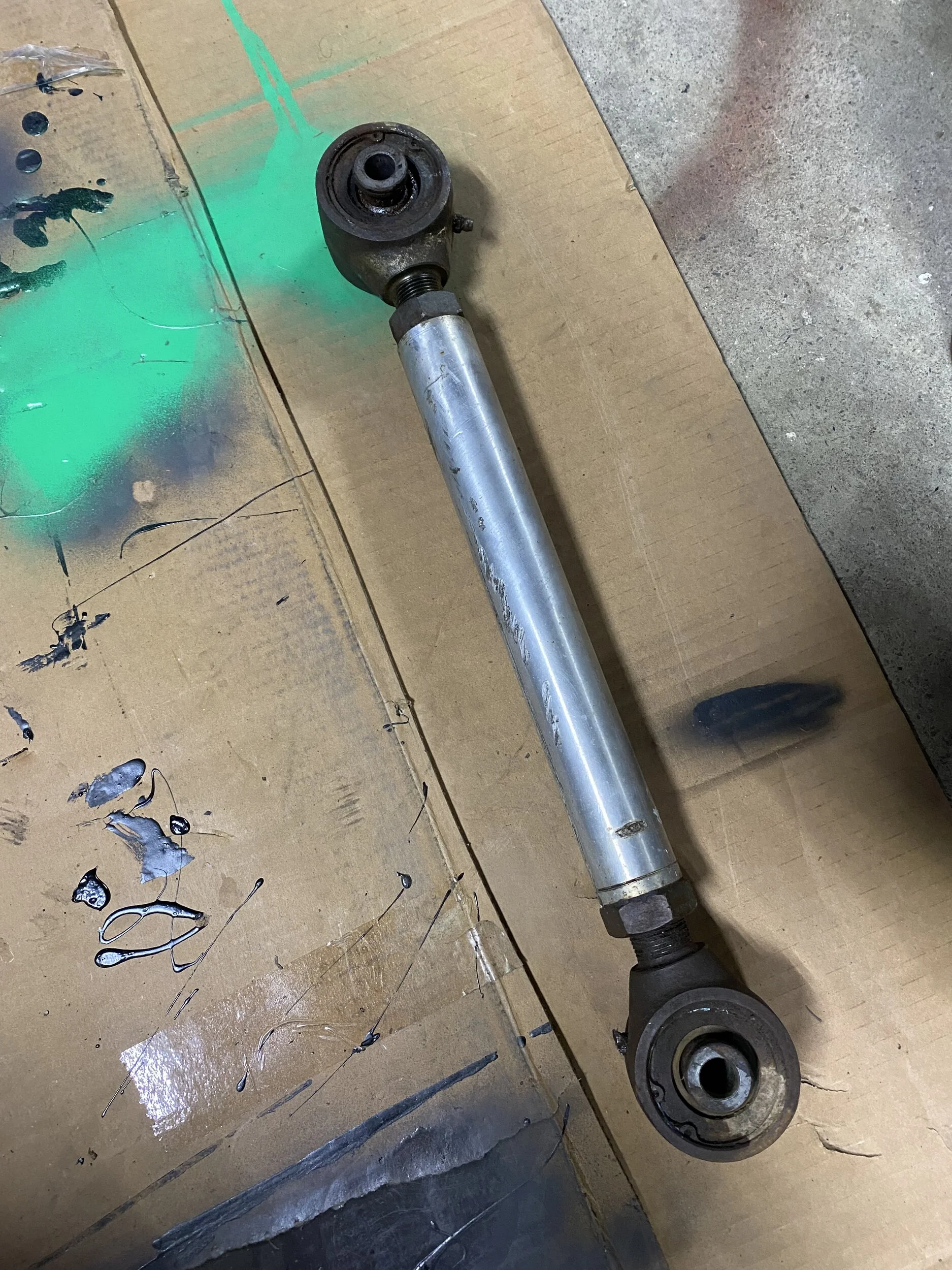

Some things like brakes you doo’t go cheap. Unless you plan on selling soon.

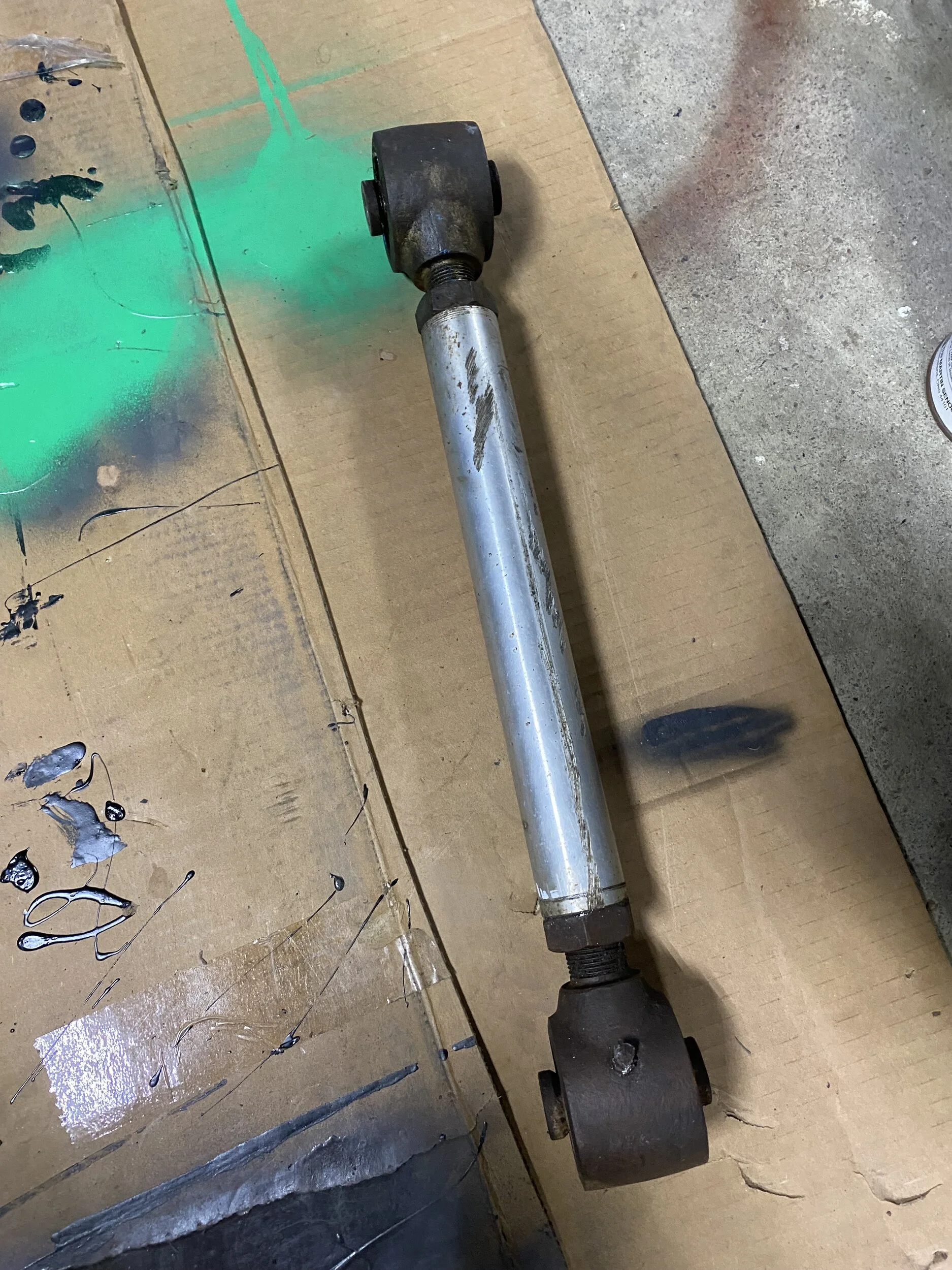

For example this is Johnny Joints after 3 years. I clean the shit out of the undercarriage of this Jeep
Edit: I didn’t want to paint the Johnny Joints but I should have.
Now it’s 2x the work.
He isn't trying to be cheap, he is trying to find a coating that lasts longer than zinc plating.
Exactly.
