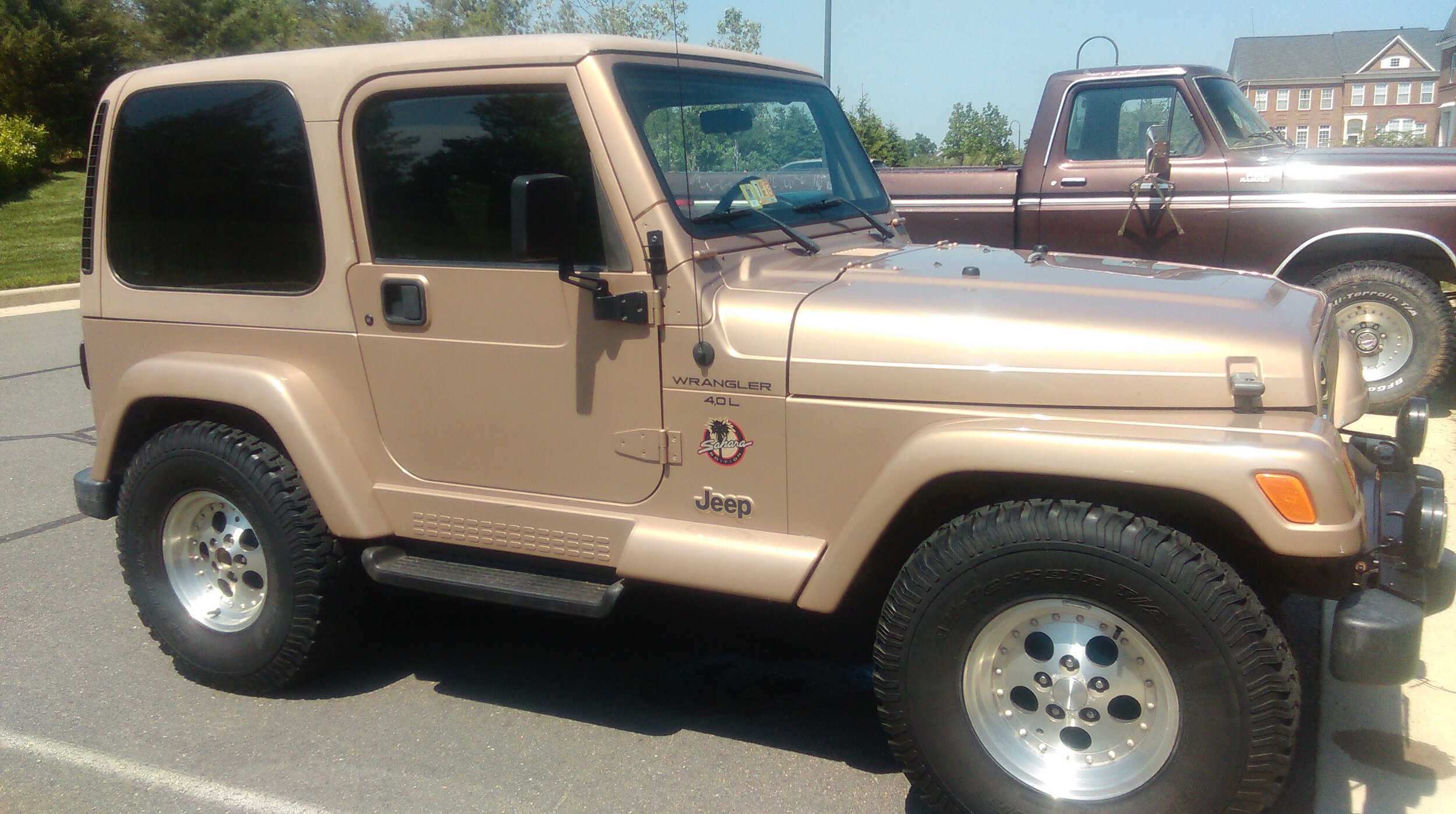

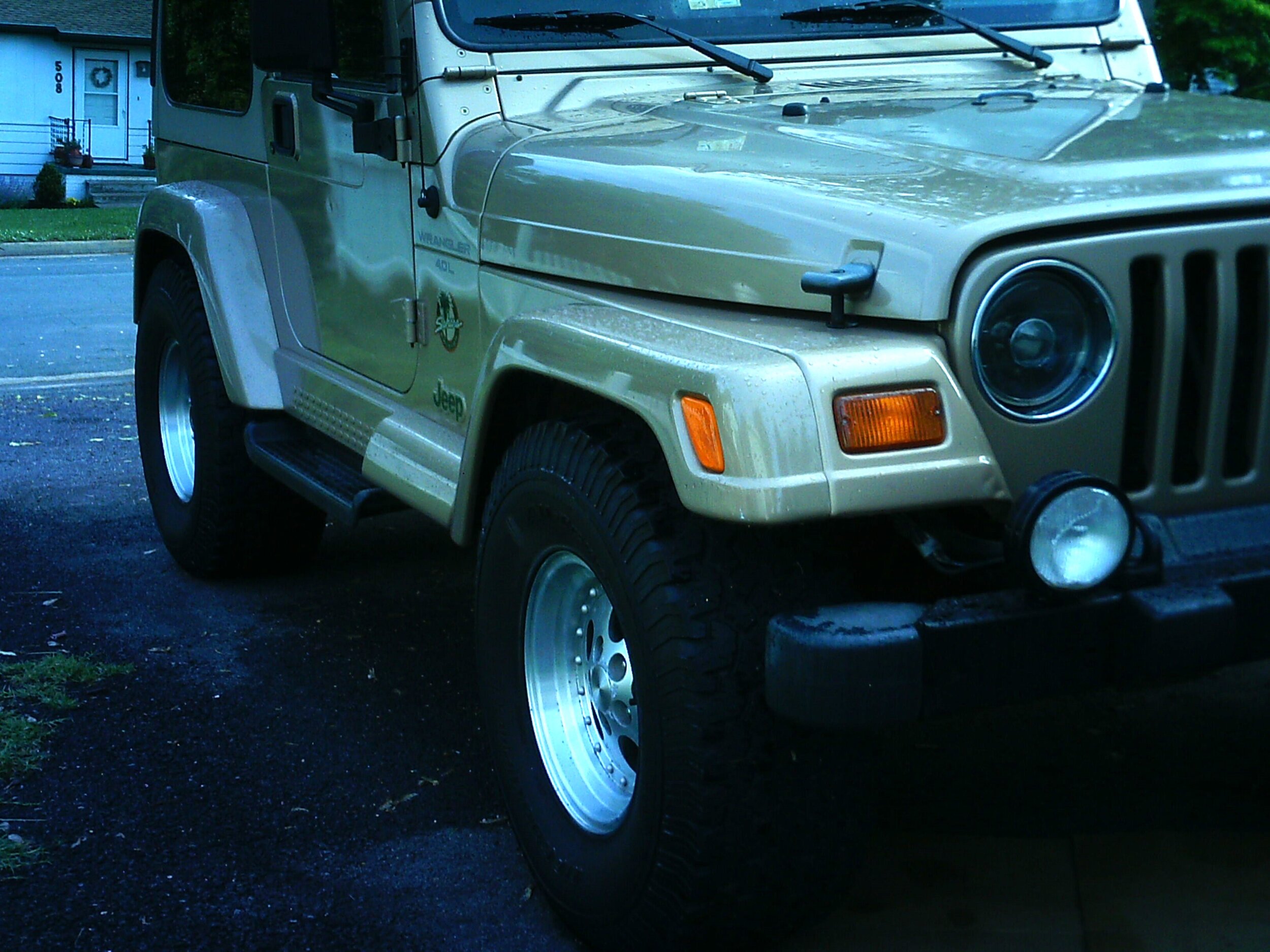

31x10.50" tires won't stick out with stock wheels.
@JMT old Jeep pic.
33x12.50" tires on stock 8" wheels didn't stick out on my old Jeep.
@JMT old Jeep pic.

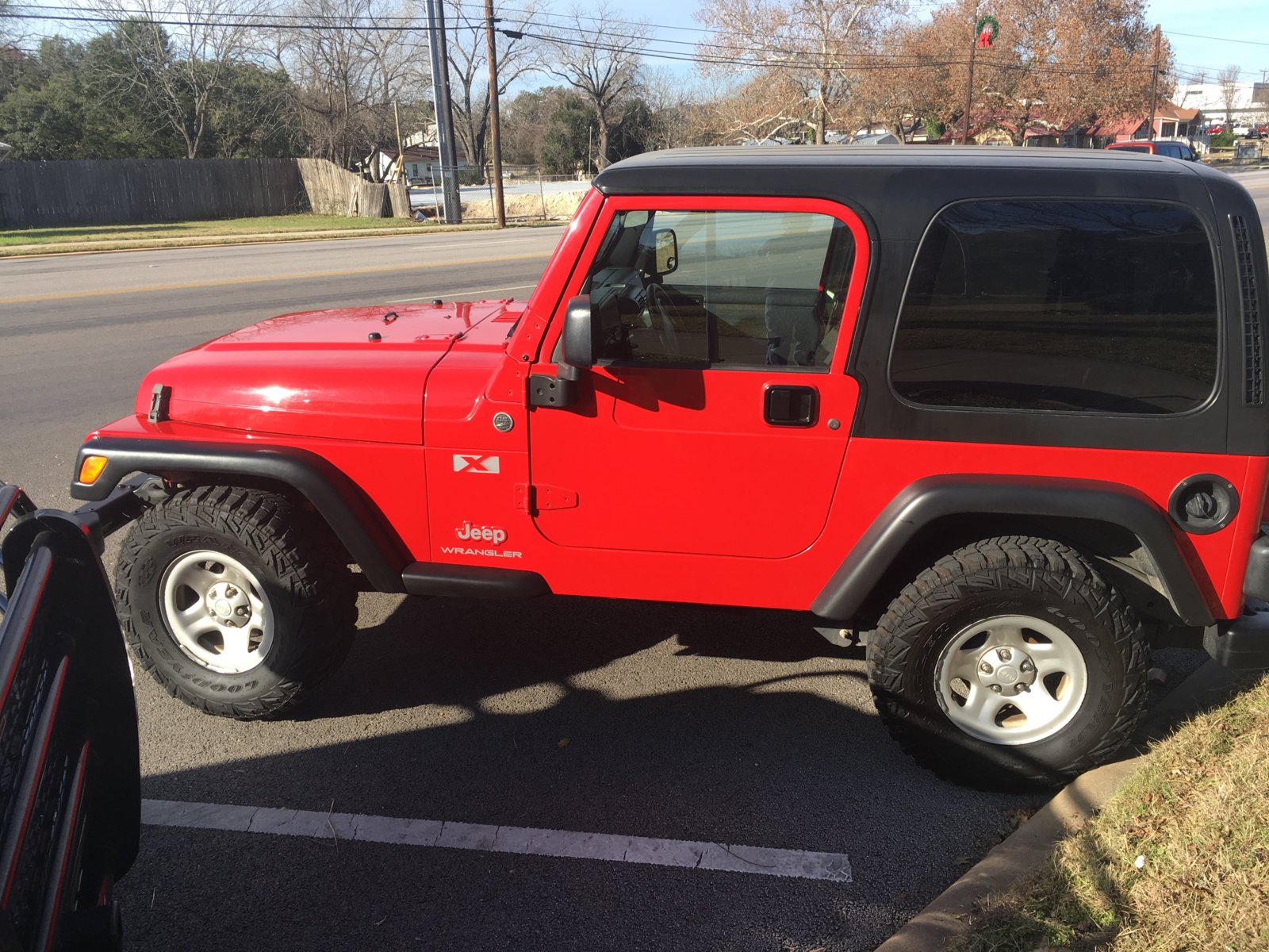

your Red X
I have the same rims, was yours a 4.0L auto? how was your gas mileage?
did it strain yr tranny any? (I think my BFG T/A 33's are killing my tranny)
Ive got the soft top on mine
what tires are on it? I see "goodyear"
did you have pro's and con's with that size tire? on those rims
your Red X

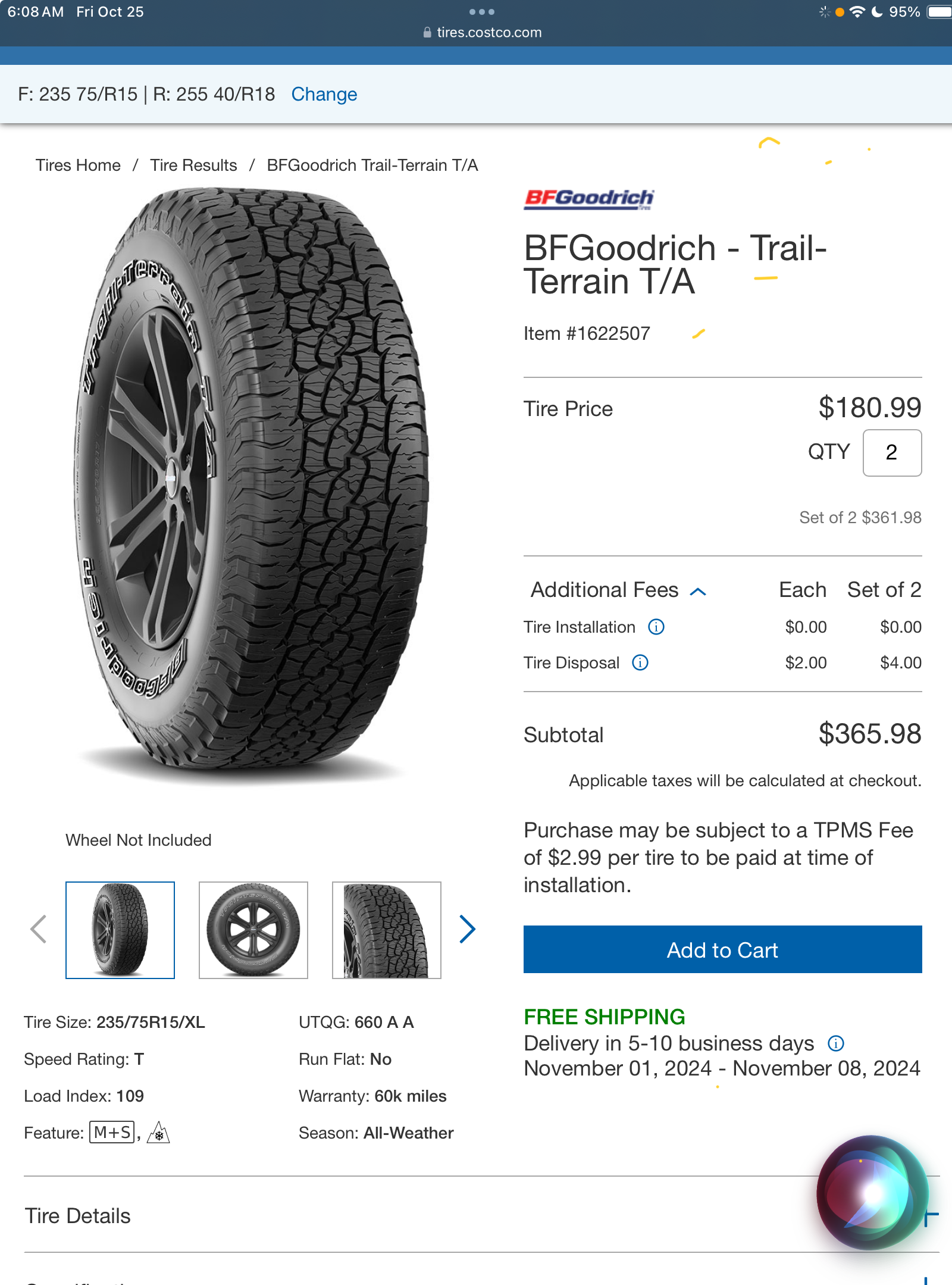

2nd point- I am not hearing you wanting a tire a for it’s off road capabilities consider something like this tire. It’s really a passenger rated tire so it’s light for better mpg, soft side walls for better ride, 3peak for good all around tire that sees winter snow. Comes stock on a Toyota Tacoma as an example.
Other brands to choose from this was just handy as an example. .

your Red X
That was minutes before I bought the Jeep in Dec. 2016.
4.0L with the NSG370
Gas mileage was about 13mpg.
No, didn’t strain my tranny.
Goodyear MTR with Kevlar
Tires were too small. 🤣
