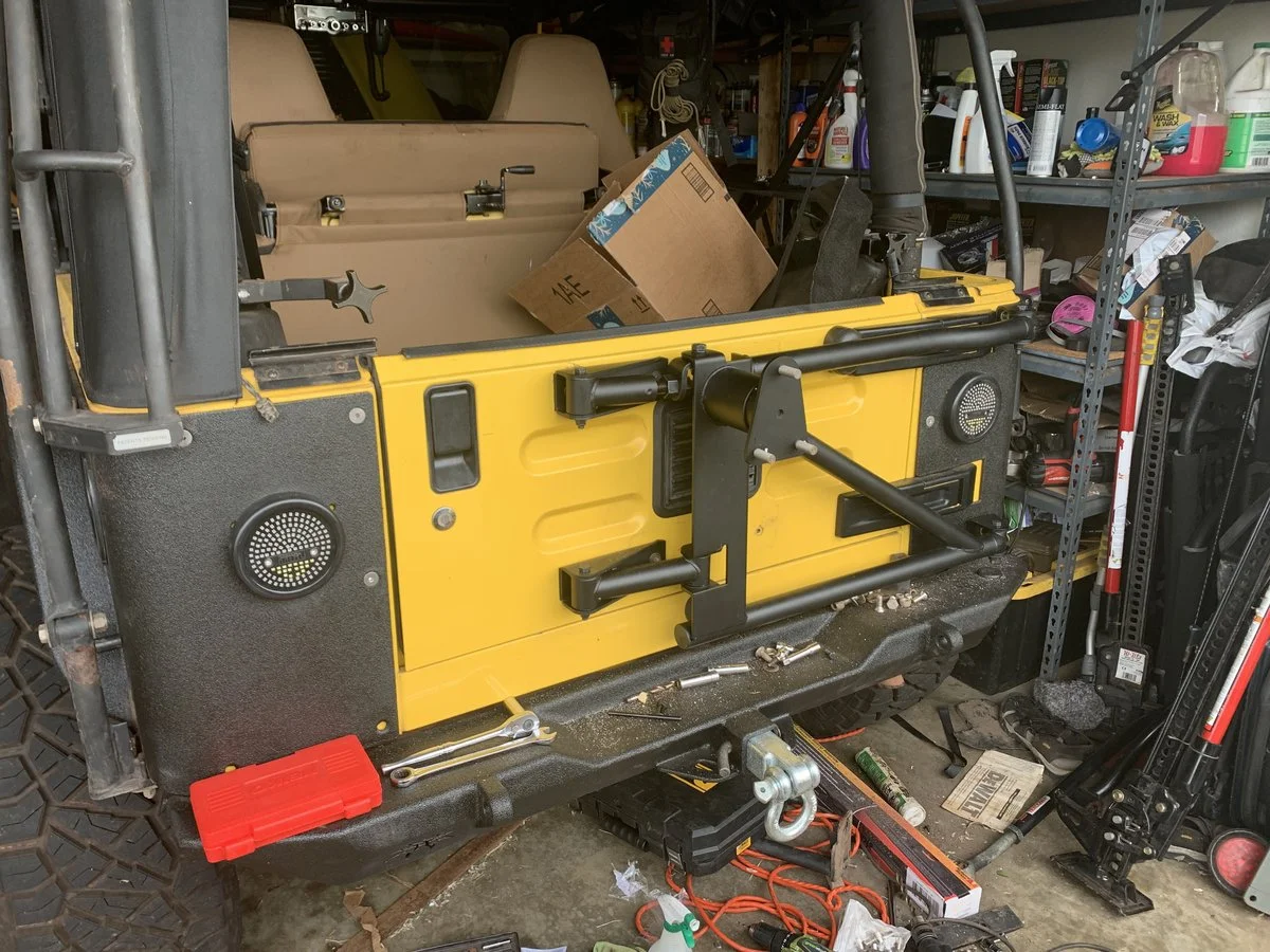

Took advantage of an amazing sale through Bestop and bought their HD Tire Carrier.
Installation was nearly a breeze for the exception of breaking a jamnut and a trip to the hardware store for longer bolts due to the corner armor being too thick from what Bestop supplies. The third brake light/bracket isn’t pictured. Now to just buy the spare Beadlocks and matching tire before my first rotation with the new tires.

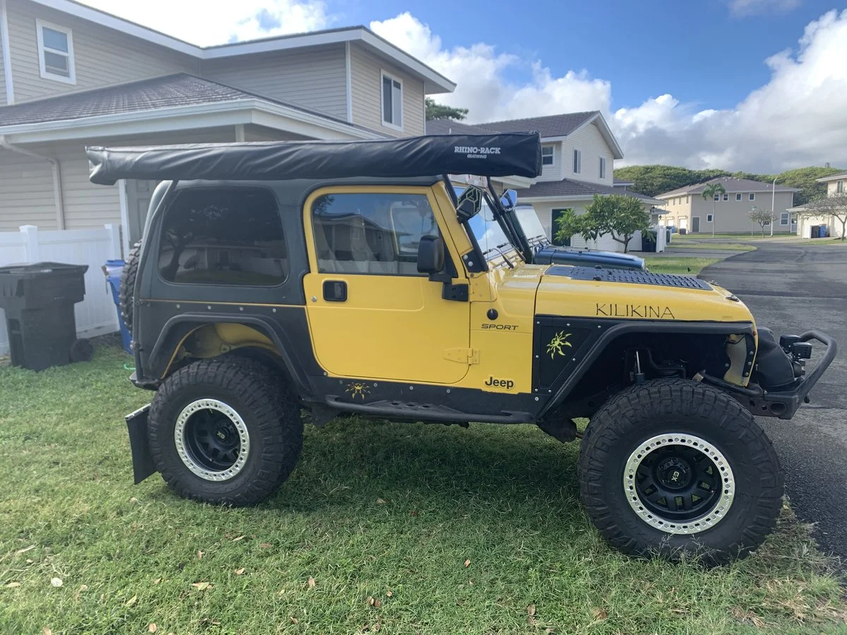

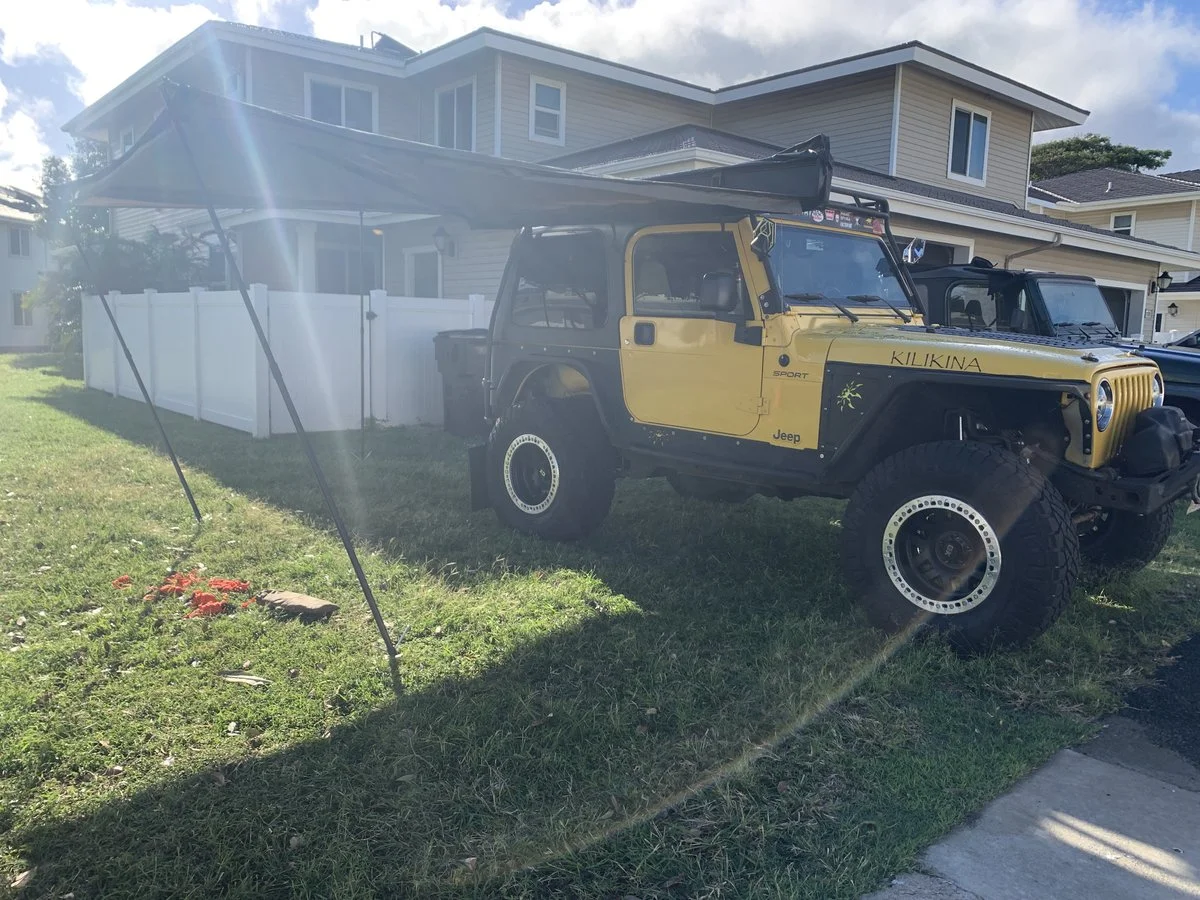

Before leaving though I received one hell of a deal for a brand new Rhino Rack Batwing Awning from a friend (almost as a departing gift at the price I paid). My friend ordered it for the wrong side thus costing too much to ship it back from this island. He even helped me fab up small brackets welded to my Gobi Rack for the Awning.

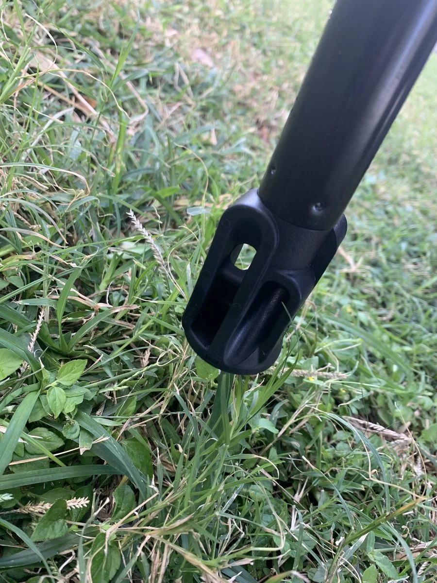

Here’s a few photos of it on, the way they set this up is perfect. Very well thought out to make it quick to set up and pack up as a one man operation. I likely would never pay for this at full price but for those that do I would say it’s worth it. They even make these nice notches/groves on the feet to put the stakes at an angle. There’s zippers attached all around the ends of the awnings to add extensions and even a tent that the company sells (all pretty steep prices).

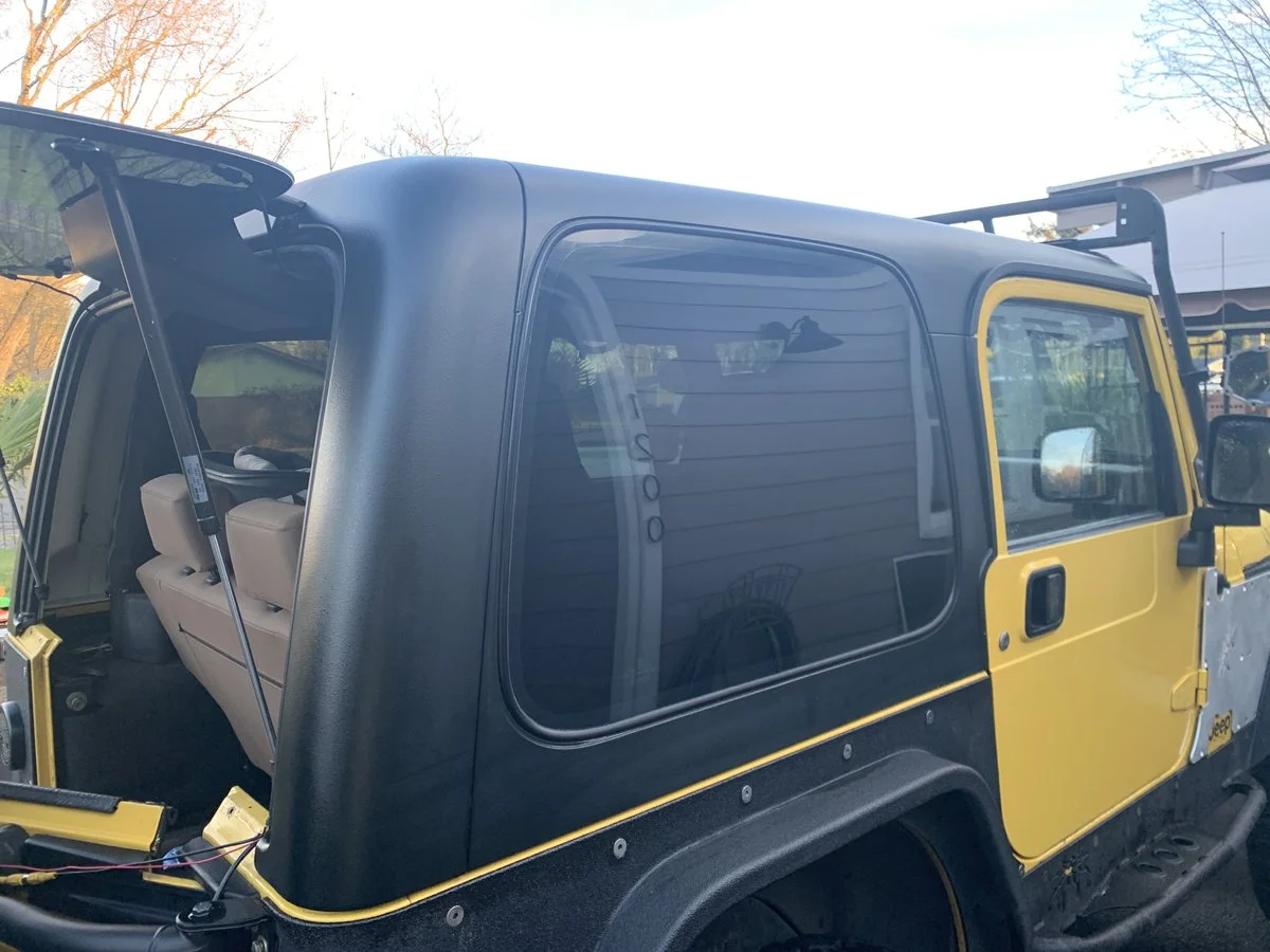

Also found a recommendation about “Flood Penetrol” through the forums to revive my worn hardtop. After having it laying in my lanai exposed to the Hawaii sun a few years really faded the top. Well, spent a few hours from washing the top with degreaser, waiting for it to dry and rubbing the product with a microfiber towel and buffing it with another. 6 passes later and the hardtop looks brand new!

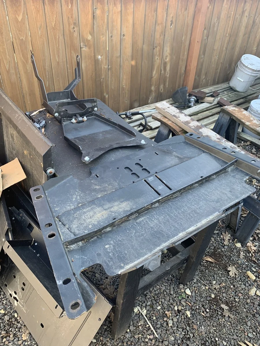

Well, family came through and dropped these beautiful items off to me from Southern California today.

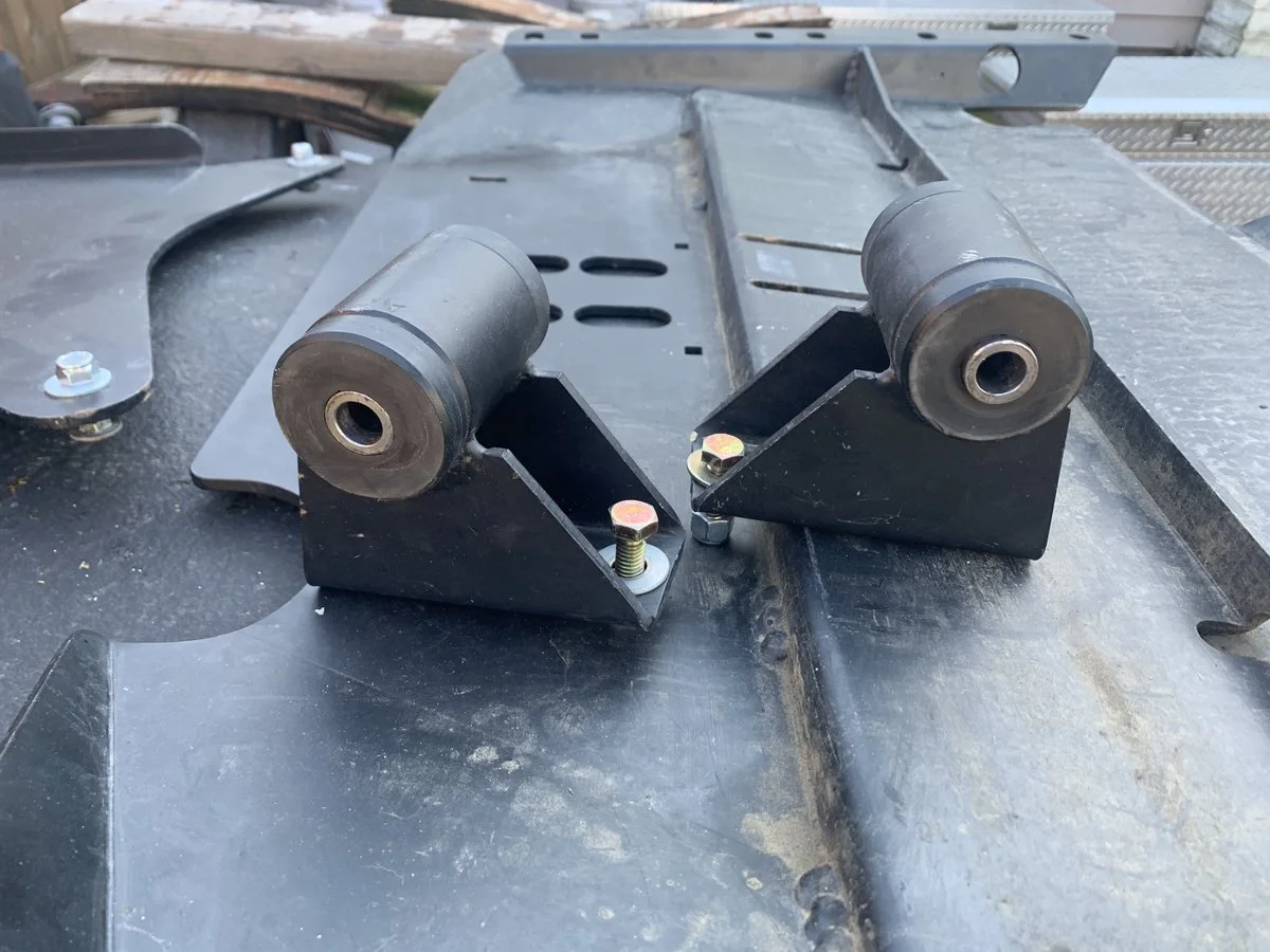

Used Terraflex Tummy Tuck with Oil and Trans Skid Plates to include a 1” Currie MML. Picked it up for only $500 from a fellow member here on the forum!
Already have the 1” MOORE Body Lift with me and will only need a the Savvy Transfer Case Cable. Hopefully I won’t need a longer driveshaft once it’s all put together since I’m already running an Adams with SYE.

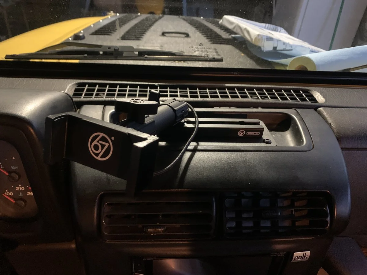

Also I spent a quick 30 minutes out of my evening adding the 67 Design Jeep TJ Gen 2 Kit on the rig!
Should easily hold up to my daily driving not to mention off-road adventures..! I’ll be adding more arms in the future for my Go Pro and Ram Mount for an iPad Mini.

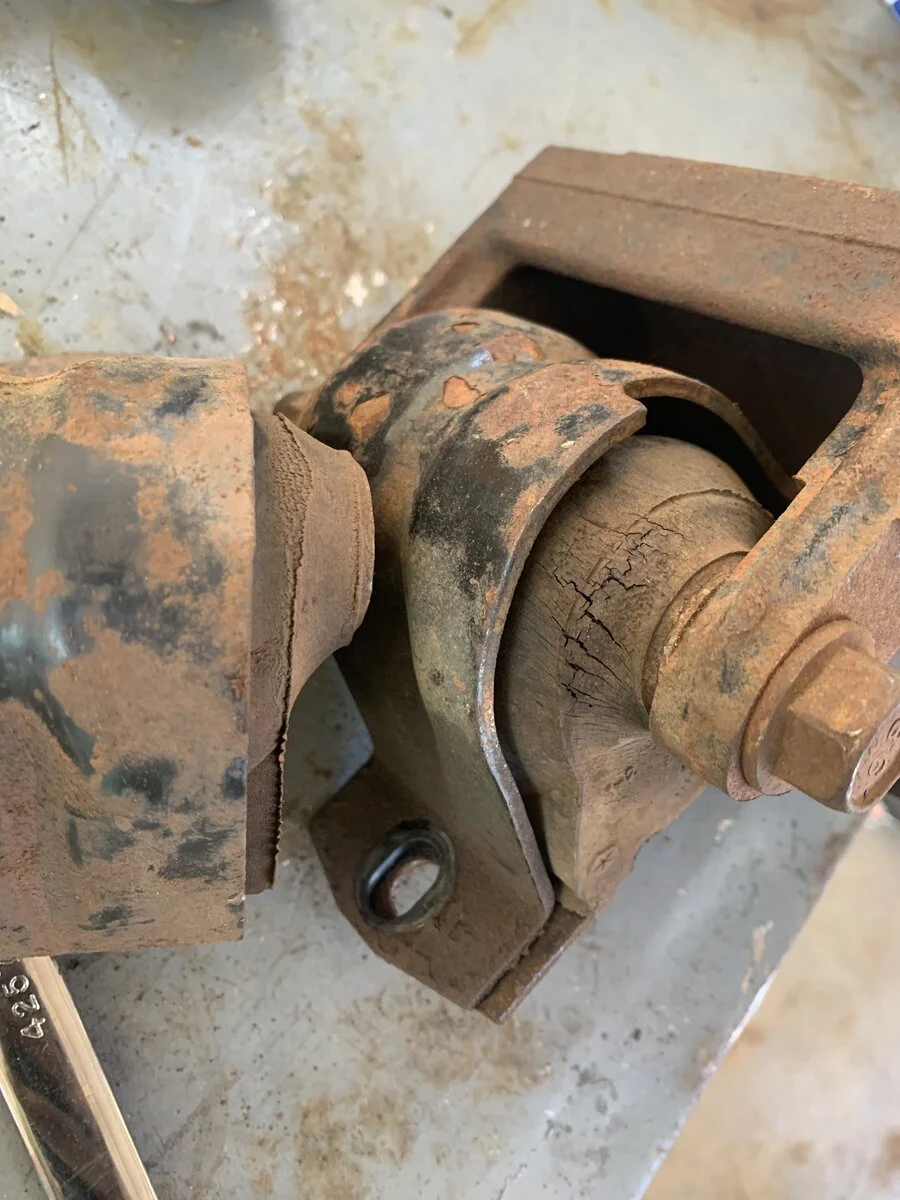

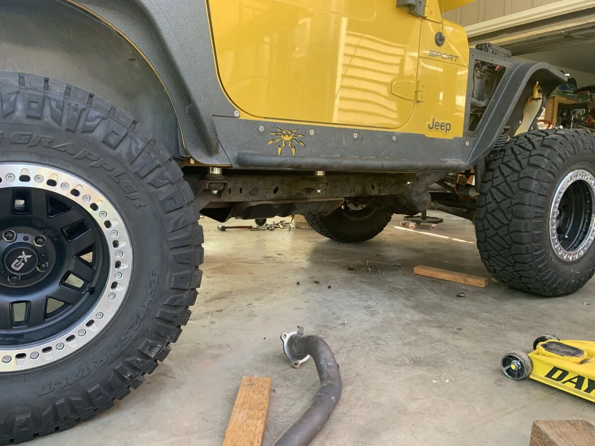

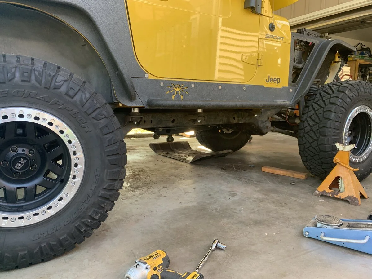

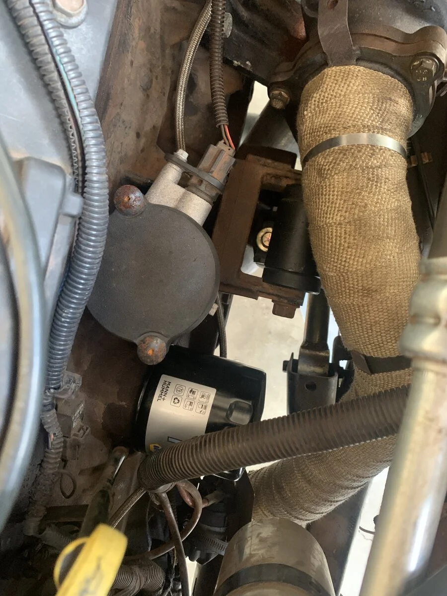

Took a few days out of the weekend to finally knock out the 1” MORE Body Lift and 1” Currie Motor Mount Lift all to add the Terraflex Belly Up Skid. Job was overall pretty straight forward other than removing the entire motor mount bracket due to my a/c compressor and turbo (on the other side) being in the way of the cross bolt. I didn’t have to modify the exhaust hanger, even my Banks Turbo didn’t have issues working with the BL/MML regarding the exhaust pieces they provide to work with my stock. I did find out the exhaust banks provides was actually drying my stock motor mount bushing. So I took some exhaust wrap and went to work on that one piece. My current SYE and Adams D/S is working well after adjusting the Pinion angle slightly.
Such a huge advantage to having that 1” BL on. Putting parts back in place I was able to reach in areas that were difficult more comfortably compared to doing it prior to the Body Lift.
Only real issues I’ll have to tackle soon is replacing the transfer case cable with Savvy’s. I can’t change the transfer case without muscling it and don’t want to throw in the drop bracket MORE provides. So I’ll just use it as an excuse to upgrade without the wife nagging 😉
The other issue I did note is my muffler hitting every now and again. Not a big deal to me at the moment since down the road I’ll be replacing it with a slimmer aftermarket set to give the rig a throatier noise.
