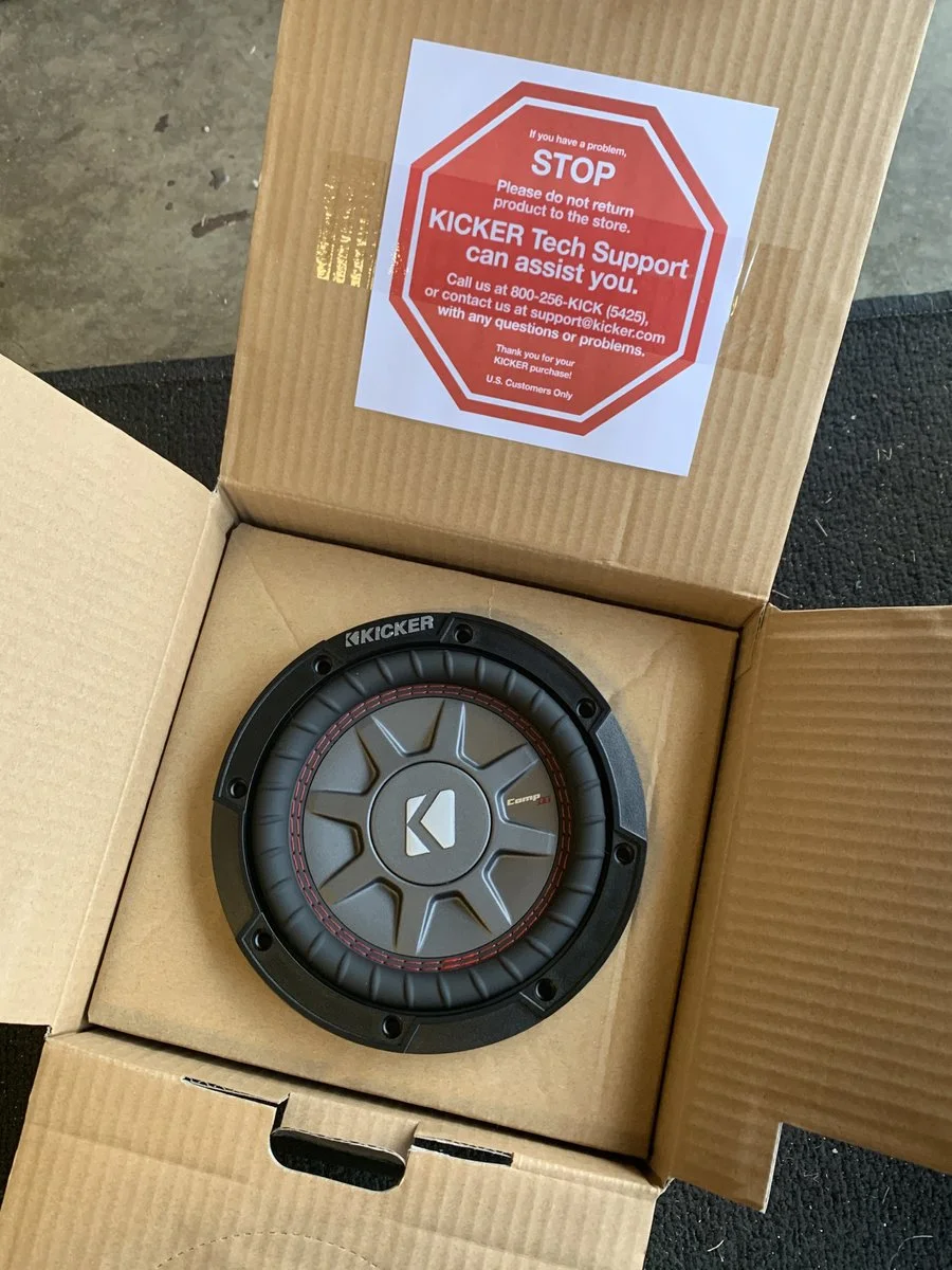

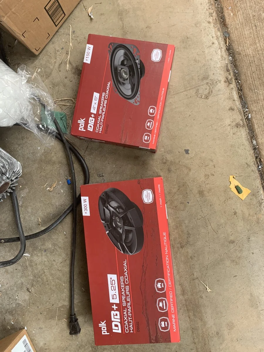

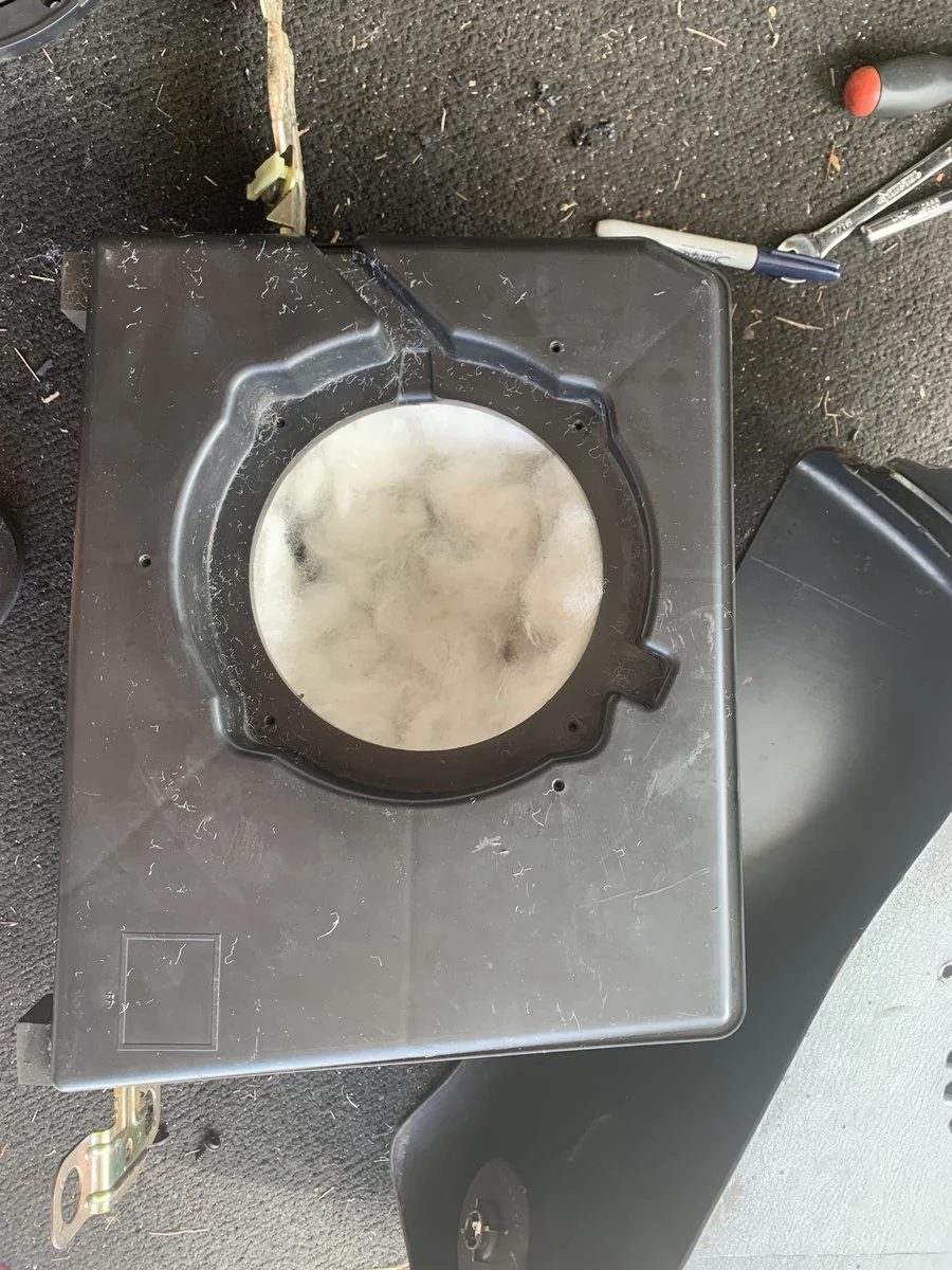

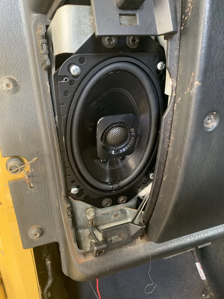

After quite a bit of research and a huge thanks to @Chris post. I went with Polk DB462 for the front and Polk DB522 for the tower speakers and the Kicker 6.75” Comp RT with a mono kicker amp to replace my stock center console sub giving my space back from the rear from my 10" Sub/Box.

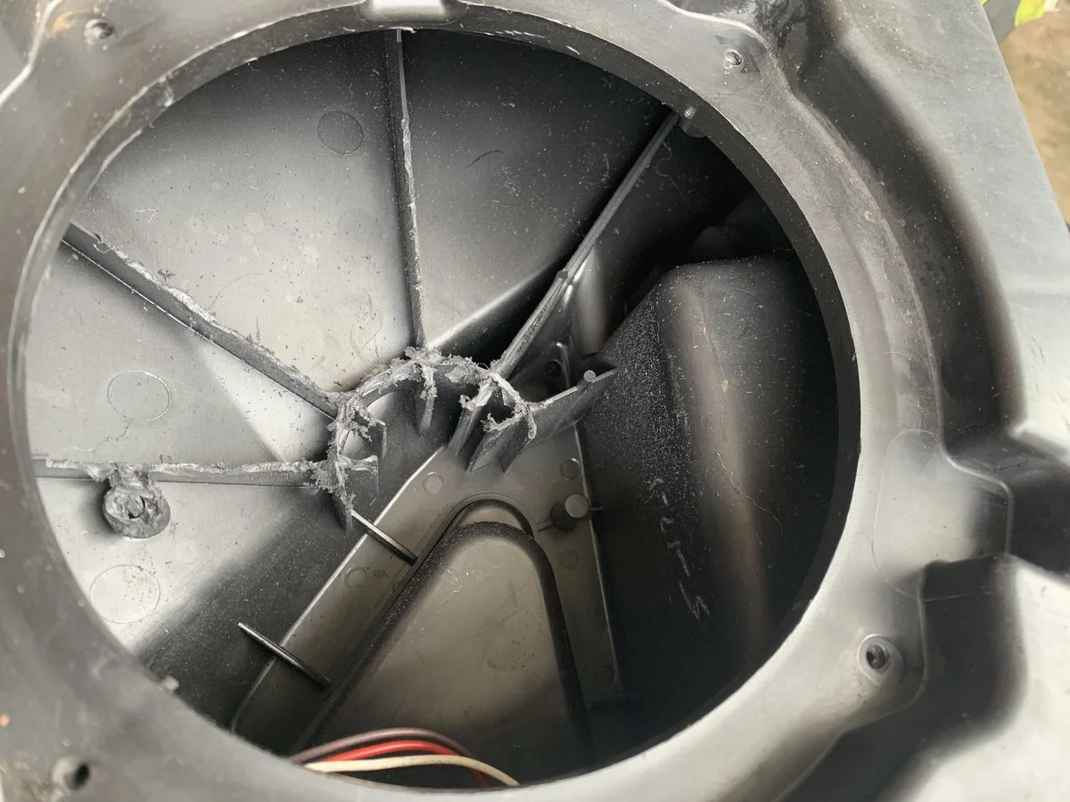

The work to accomplish it was all nearly plug and play when I ordered the correct plate to fit the 4x6 front speakers and correct wires to plug right into my stock wiring. One part that required the use of a dremel was grinding down the plastic within the sub box to have the sub itself sit flush. If you look at the photos closely I had to take material off the center and fins within the box. After maybe a few hours everything is put together and sounds 100x better. I’m currently waiting on my amp before the sub is running but I know it’ll be just as good if not even better compared to the 10” sub I had in the back.

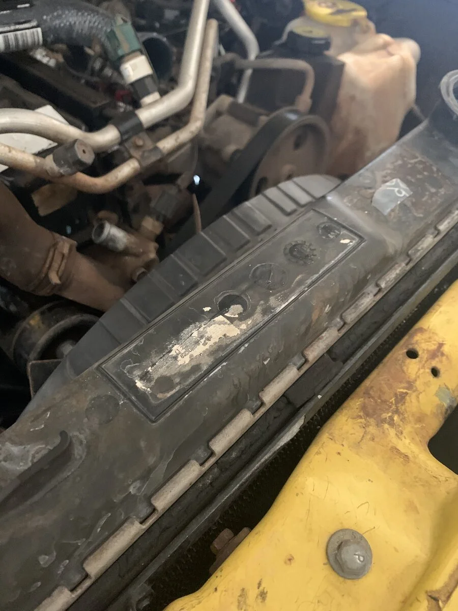

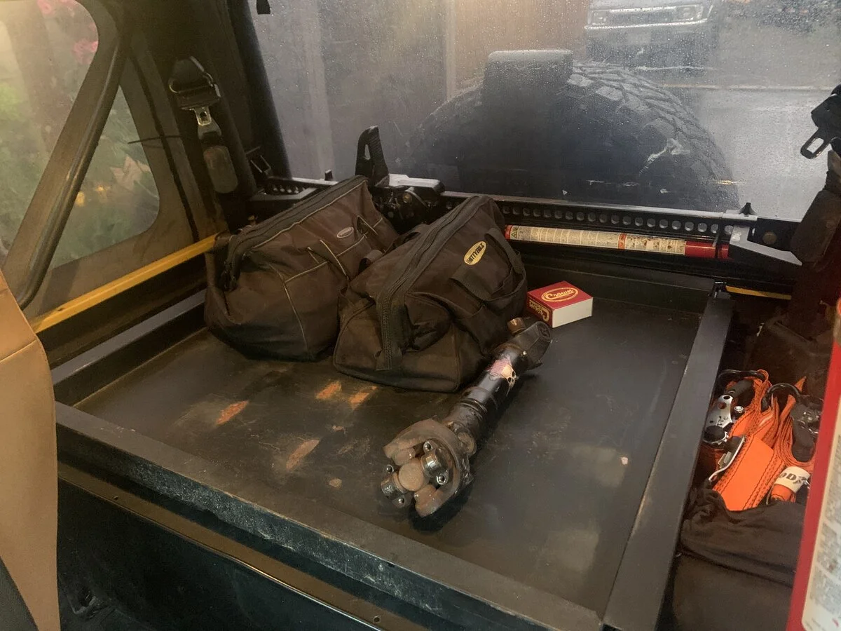

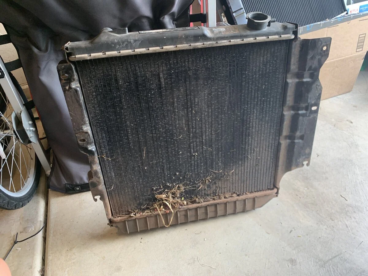

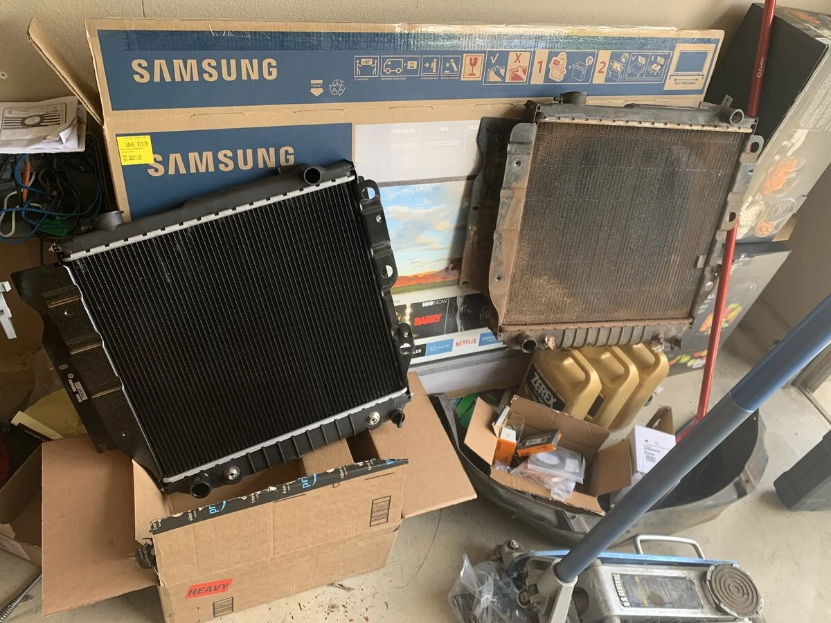

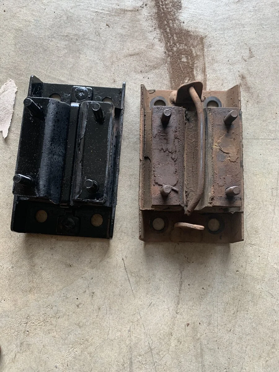

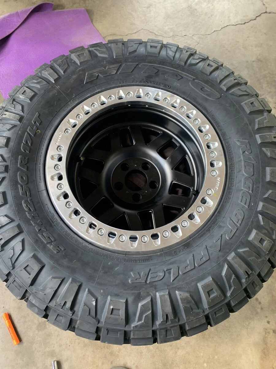

Well the last few weeks have been interesting. My speedo gear housing was stolen and within the same week my radiator cracked (no surprise since it’s the original). While waiting for parts to arrive I got around to putting my full size spare Beadlock together and on the rig. When I finally got around to swapping the radiator I followed the cooling system overhaul that’s written out on this forum. Some sediment was found throughout the system but surprisingly not as bad as I thought. While digging into it realized my fan shroud was broken. After looking around the area after speaking with some friends I went out and picked up a replacement for cheap. Finished off the day by replacing the trans mount.

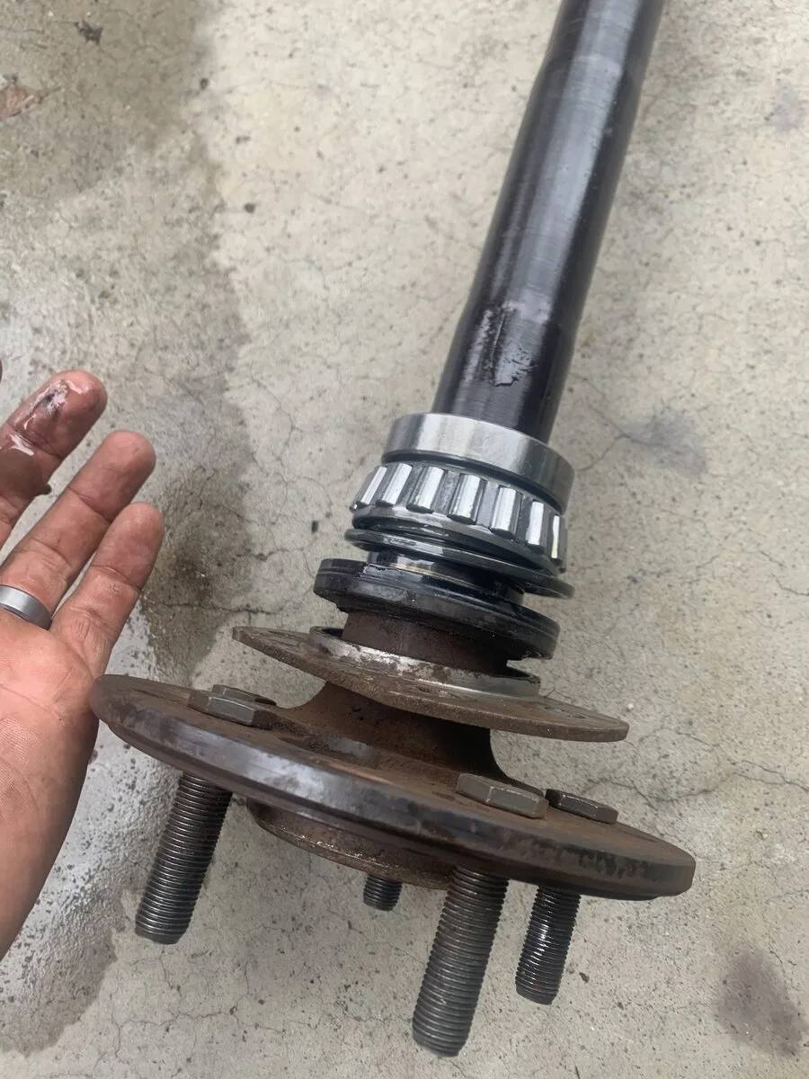

Tomorrow I’ll be replacing the outer seal on my slip yoke and prepping my replacement 33 spline axle shafts since one of the flanges were bent and leaking diff fluid.

Managed to find the time to knock out two more leaks. Guess I bent an axle shaft flange back in Hawaii (would explain a loud noise I heard that I never found the issue to...😂) the diff fluid was coming out of the d/s axle shaft and noted the tire wobbled a bit while driving. G2 hooked it up with a complete set free of charge.
Also had atf leaking out of my SYE Housing. When I recently did the tummy tuck I didn’t adjust the driveline accordingly and had vibrations going 60-65mph. Going to assume the vibes just killed the seal, once replaced no more leaks but plan on adjusting the rear driveshaft early tomorrow morning.

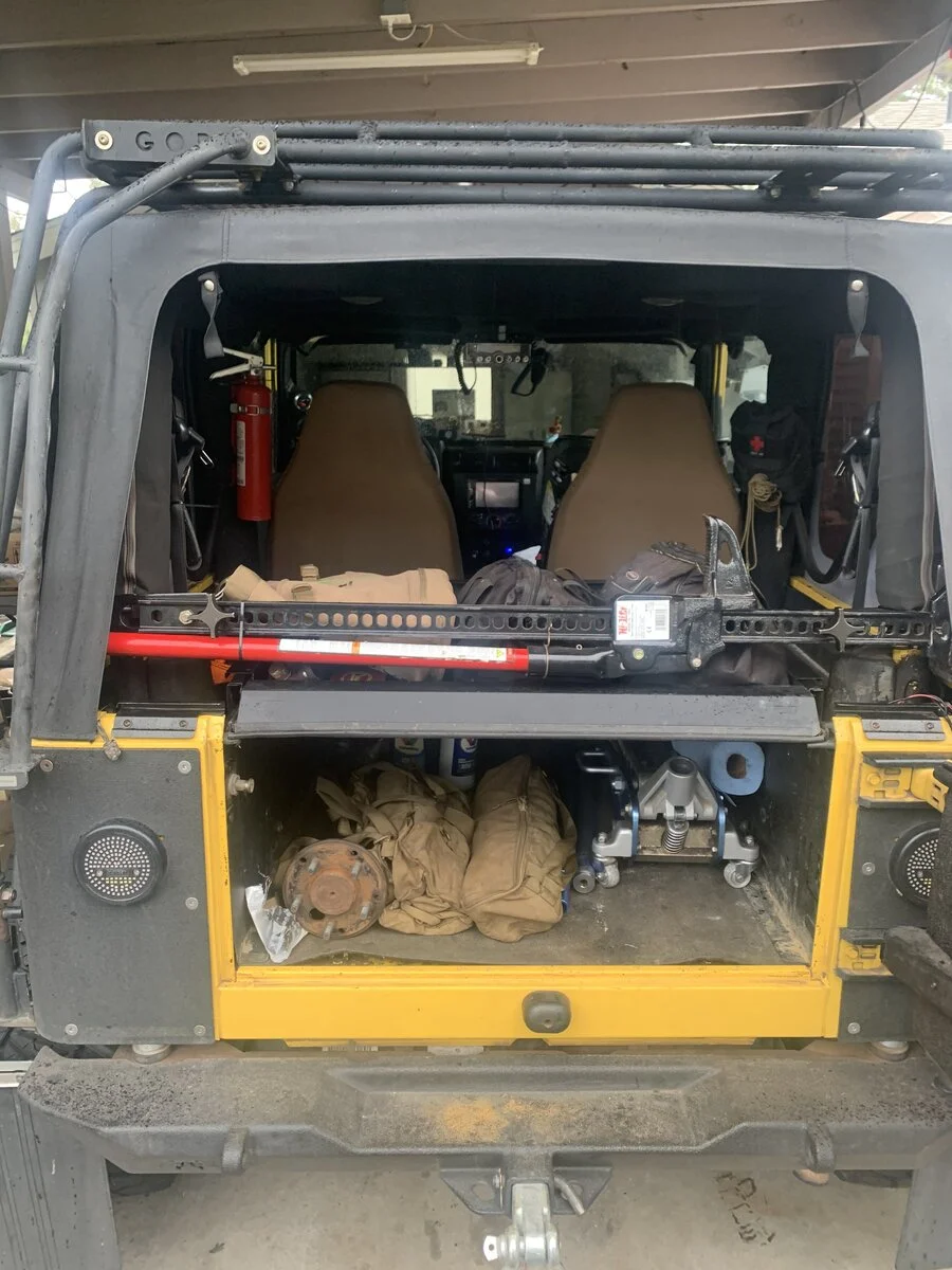

As I prep to leave for Salem, OR this Sunday the next 3 weeks for work, I thought I’d take advantage of not having the kids tagging along by finally adding the tuffy security enclosure to the rear. Especially since I plan on taking advantage of being a short drive away from Tillamook’s FireBreak 5 and Cedar Tree #13 (Currently have a post in the regional forums if anyone in the area wants to join!).
So much room for activities now that the rear bench is gone! Love how simple it was to install the Tuffy Enclosure and for only paying $140 it was hard to pass this up.

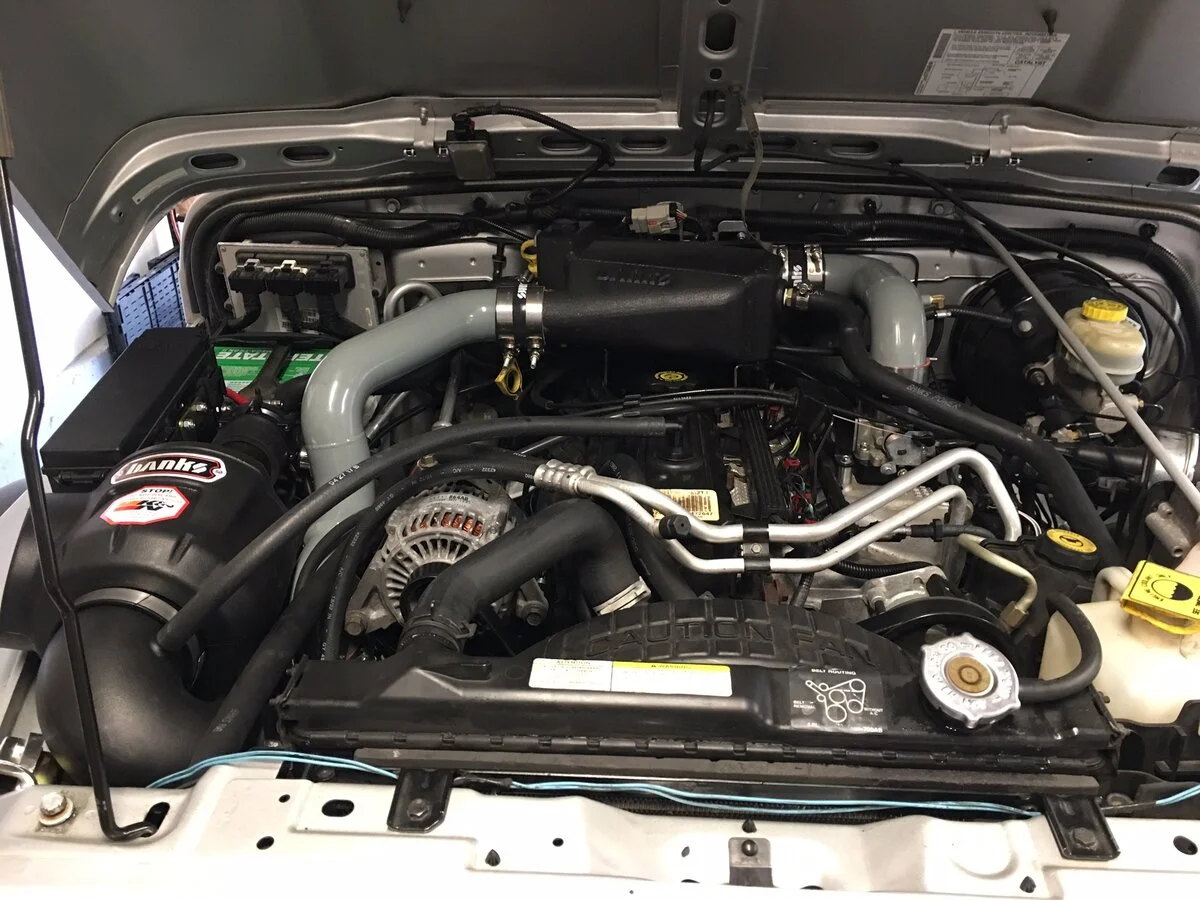

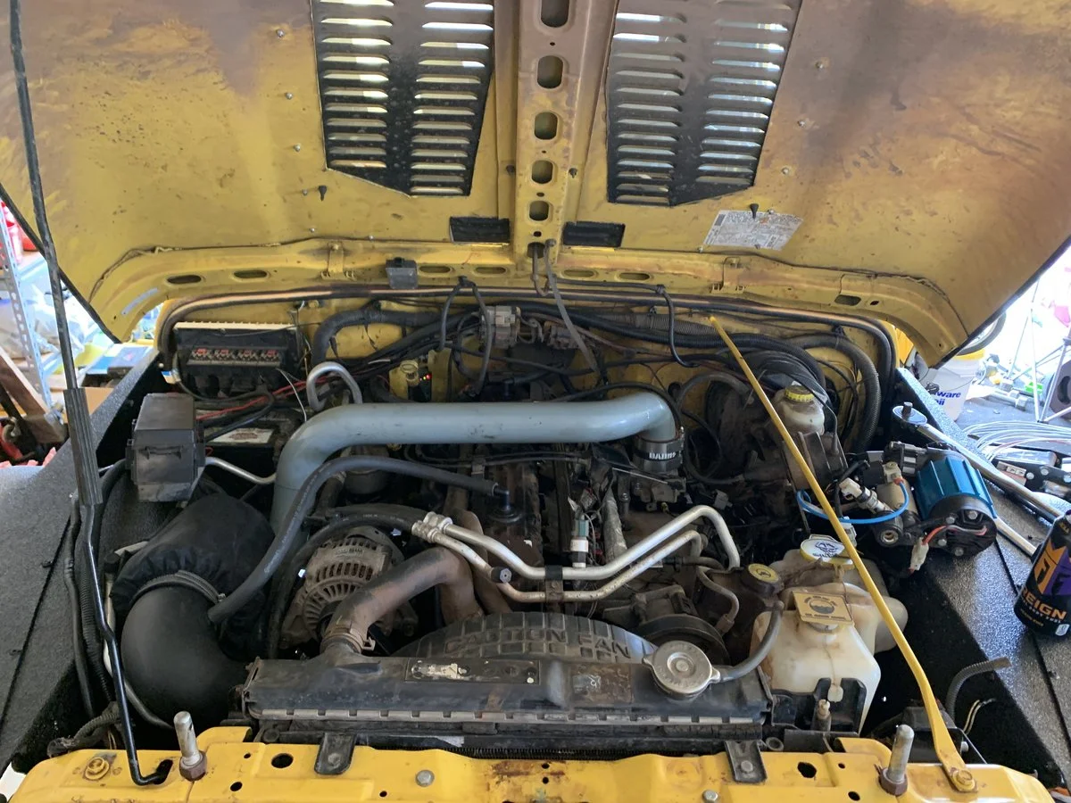

I finished installing the Banks Sidewinder Turbo system on my Jeep Wrangler about a month ago maybe a bit more. After settling a few minor issues it’s ran great thus far! I opted without the intercooler due to finding a post a while back of another owner putting together their own for less than half the cost. So at some point will look into that! Left things a little cramped due to my Poison Spyder Hi-Lines. Currently needing to modify the air box to fit in the tight space to cover the air filter. I bought a pre filter temporarily while I figure out a way to make it work.
I went with the intercooler so I wouldn’t have problems tuning it with something that was not designed to go with it. Mine has been in for 3 years now with now problems. View attachment 170177
Nice! I couldn’t justify spending the extra $$$ at the moment but when I do the intercooler I plan on going through HP Tuners.
