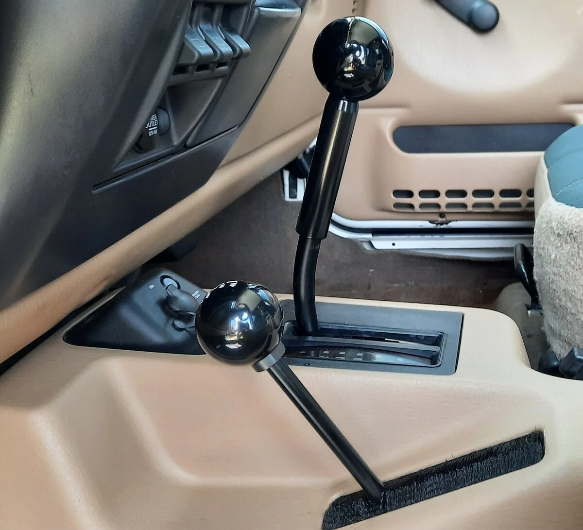

3rd pic shows what you need to know. Instead of the t-case lever pointing forward and being down and out of the way, it now points straight up. It is very happy to see you.

This what you want?

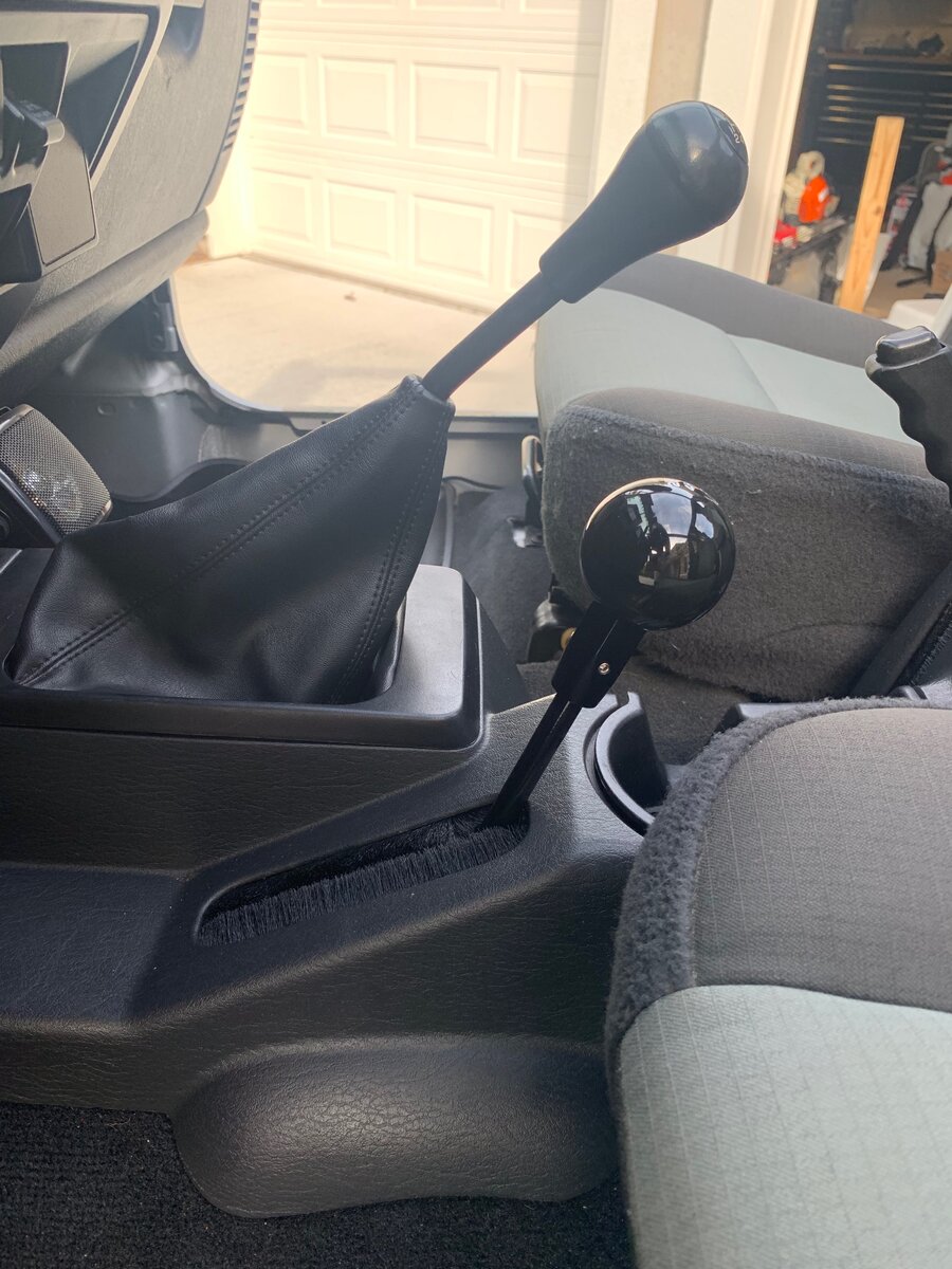

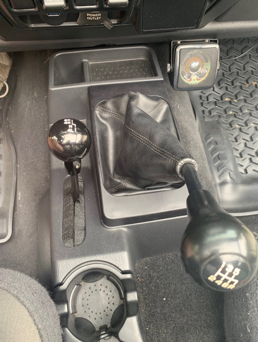

Mine would pop out of 4L sometimes as it contacted the console. Pic is in 2H. I took it out of the TJ and when I get around to putting it in the LJ I will just bend it some to stay away from the console in 4L.
Reactions: hear

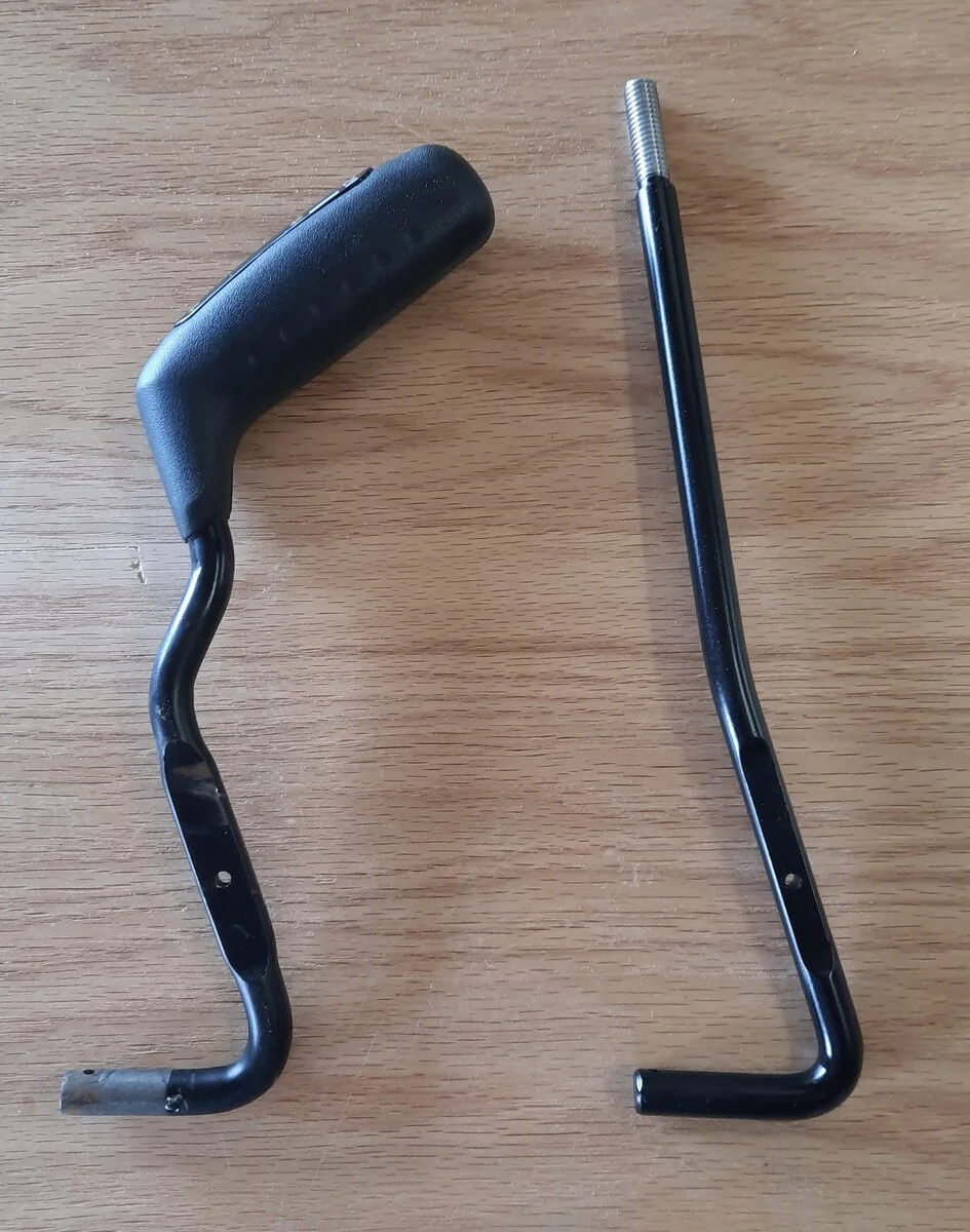

did you weld the rod to an existing shift lever?
No i turned the end on a lathe and hand threaded it with a die. Used a torch to heat the other end and bent it by hand in a vise to match the factory V shape. Milled flats into it on a mill and then drilled the holes.
It hit the back of the console when it was just straight so I had to heat it up and bend it forward a little bit.
