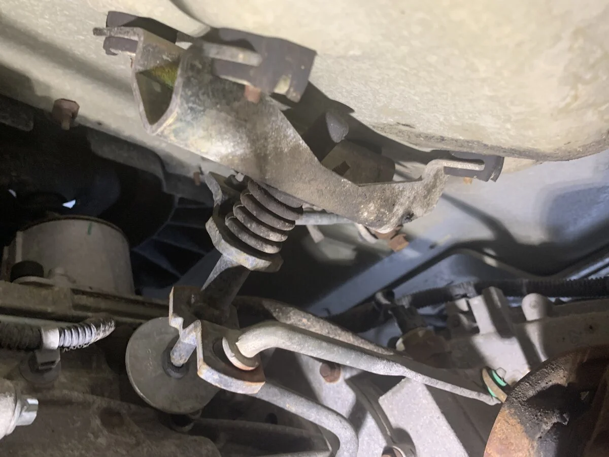

The transfer case could be stuck in neutral. You might check the transfer case linkage that goes from the transfer case lever in your cab down to the transfer case that is mounted behind your transmission. It may have broken. If the transfer case is stuck in neutral then no matter what gear you put your manual transmission in you won't go anywhere.
My bet is the transfer case linkage slipped out of adjustment and the transfer case is now in Neutral. A pair of pliers could be used to rotate the tab on the side of the transfer case the linkage attaches to. Rotate it one way to go into 4lo, the other way to get into 4Hi then into 2hi.

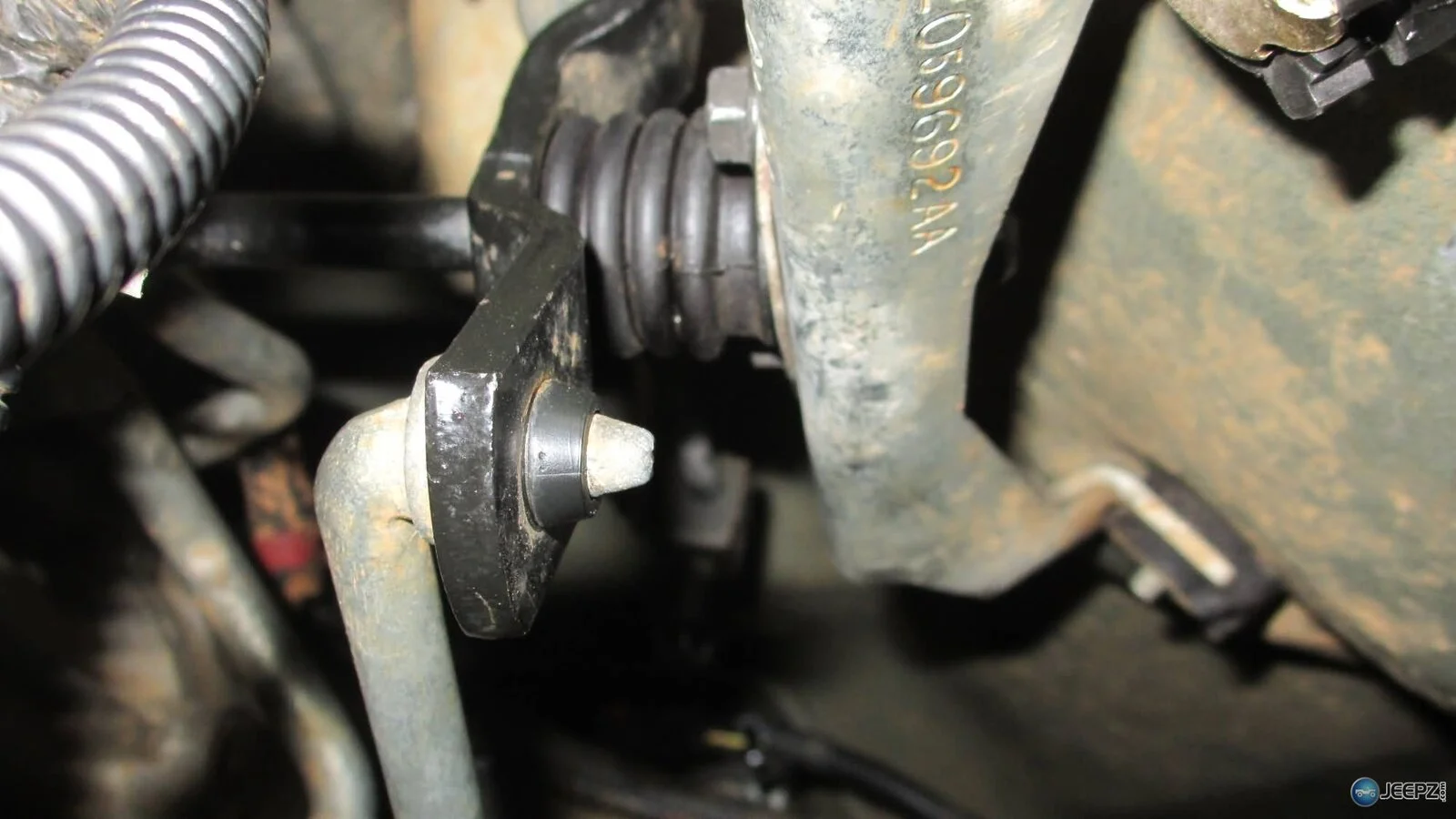

I had a similar issue on my XJ. The linkage broke free from a dry rotted bushing.
Reactions: Jerry Bransford

Definitely sounds like its stuck in neutral. So even if the linkage is broke I can get in there and change it with some pliers manually? to at least get the jeep outta there and home?
Yes, but take a big set of lock pliers (8-10”), that way when you lock it on you’ll have some leverage to shift it.
