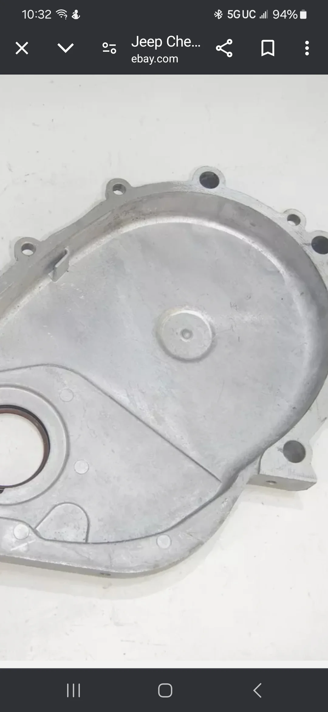

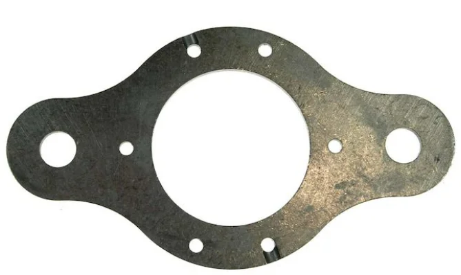

If there wasn't a pin and spring, there should have been a thrust plate holding the cam in .
Mac, What does that pin ride against to hold the camshaft in position ? Hopefully not the Aluminum cover.
Been a long time since I did it. I do in fact think it rides on the cover...and I think I used a piece of aluminum...but it was before I started YouTubin everything...let me search my pictures.
YES!!! That was definitely there. Alright, I feel better.
Yes, it rides on the cover.

Rides the cover? I don't follow.
My 97 has the spring and snubber...the spring rides on the timing cover.
You've got the thrust plate...no timing cover contact.
