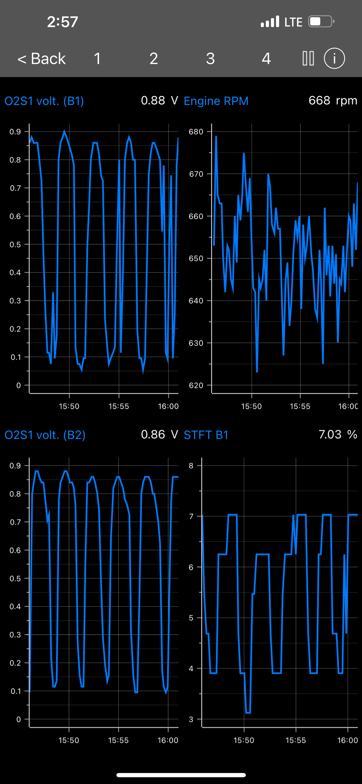

I’ve tried to spend a bunch of time to see what I can monitor that would help troubleshoot the problem. I attached some pictures showing the RPM dips and some other readouts. What I’ve seen/paid attention to:
  • RPM – visible drop in RPM when the stutter occurs
  • O2 voltage – from what I can research and my limited knowledge they appear to be behaving as they should. I’ve really only been paying attention to the upstream sensors
  • MAP – I’ve been looking to see if this has strange signals since it’s a sensor I haven’t replaced it. When I get a BAD stutter, the MAP signal does change
  • When a major stutter occurs photos show examples):
    • MAP will increase (for example 40 to 42-43)
    • O2 voltage changes (seemingly reacting to the issue)?
    • The timing advance changes (expected, right?)

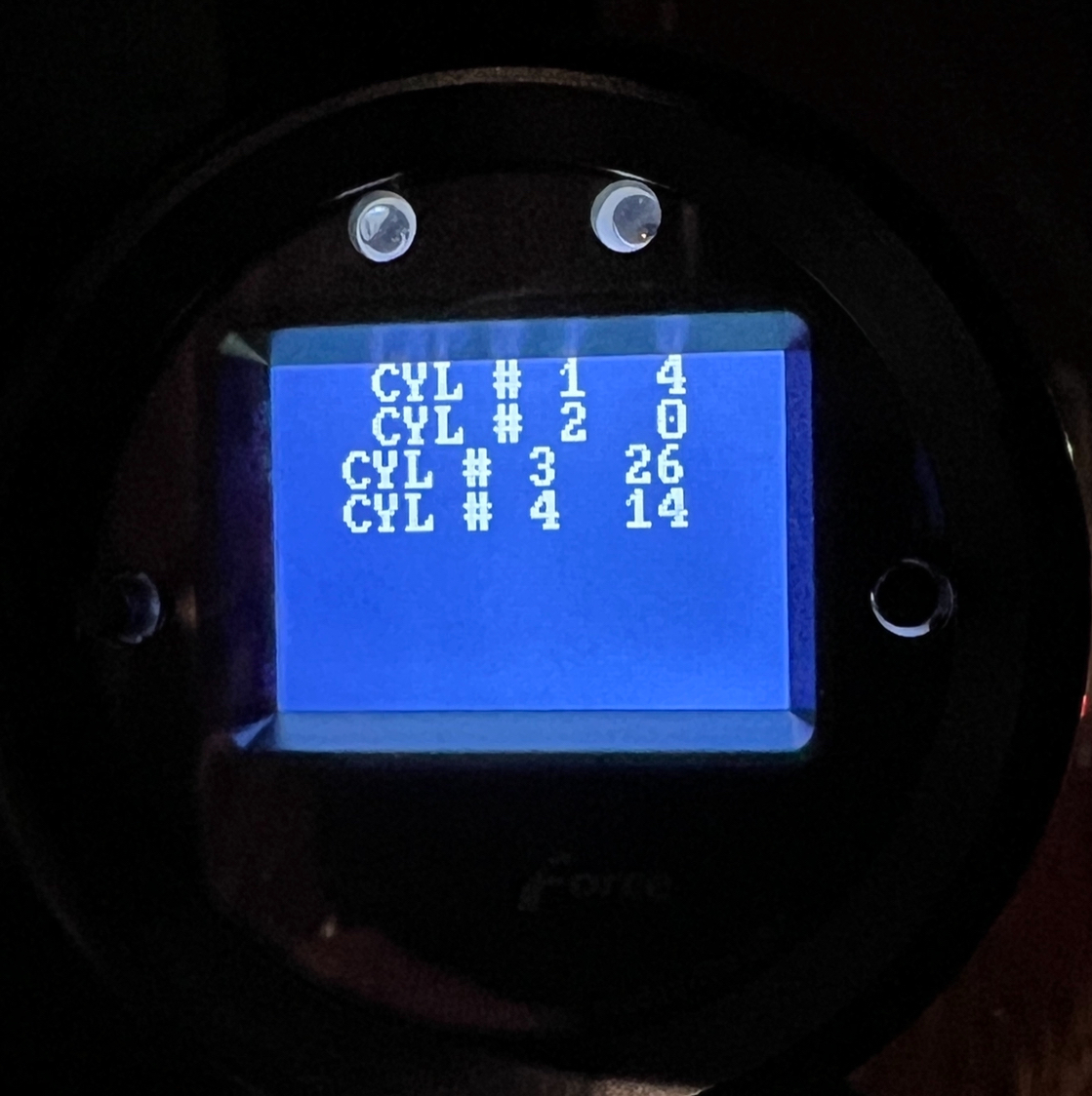

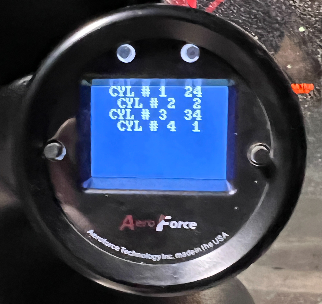

I’d try a @Wranglerfix ecm…my pcm acted up and Mark’s PCM fixed it when I was trying to fix a transmission issue.
I had a ton of misfires reading on my aeroforce OBD 2 gauge (that I found online; it only works for the 05/06 models). Keep in mind that I read those misfires without 0300 codes being reported from the PCM. You can have a sizable amount of misfires that won’t pop a CEL if there aren’t enough misfires in x amount of time. I only know this from experience. My misfire issues were typically only in idle or near idle while the engine was hot. It wasn’t a heat soak issue with the fuel like I thought.
I’d rather confirm it is or isn’t the ECM now rather than find out it’s the issue during the trip or after you cancel. Just my $.02
Reactions: Wranglerfix
Here’s some of the misfires I’d see without popping a code.
The device only reports cylinders 1-4 because it was provided for the Neon SRT folks (per AF’s response to my inquiry).

That O2S1 Bank 2 volt dropping out to virtually 0 volts (stuck lean) screams a chafed signal wire to ground. Especially being that Bank 1 seems to function perfectly fine, it runs fine in open loop, and it's intermittent.
If you ever see it go lean like that again (0 volts), graph both upstream O2's at the same time, floor it in WOT mode and see if you can drive the signal rich.
