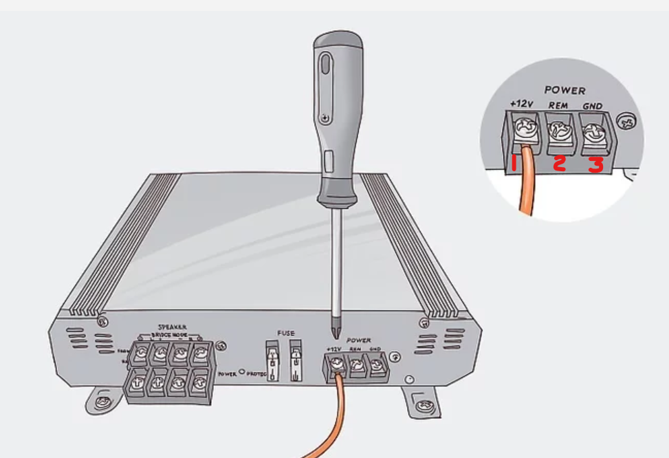

There are typically 2 places for +12V connections on an amp; the larger, main power (fused-power from the battery), and another much smaller wire (often blue) which is the +12V trigger signal from the head unit. Both inputs require power for the amp to switch on.
USING THE IMAGE BELOW FOR REFERENCE:
- Measure for voltage between TERMINAL #1 & THE CHASSIS.
This confirms your high-current power is present at the terminal.
- Measure for voltage between terminal #1 & terminal #3.
This confirms that your amp is grounded.
- With the head unit powered on, measure for voltage between terminal #2 & the chassis.
If you are concerned about doing this w/ the head unit powered on, then jump a wire from #1 to #2 and see if the light comes on.
