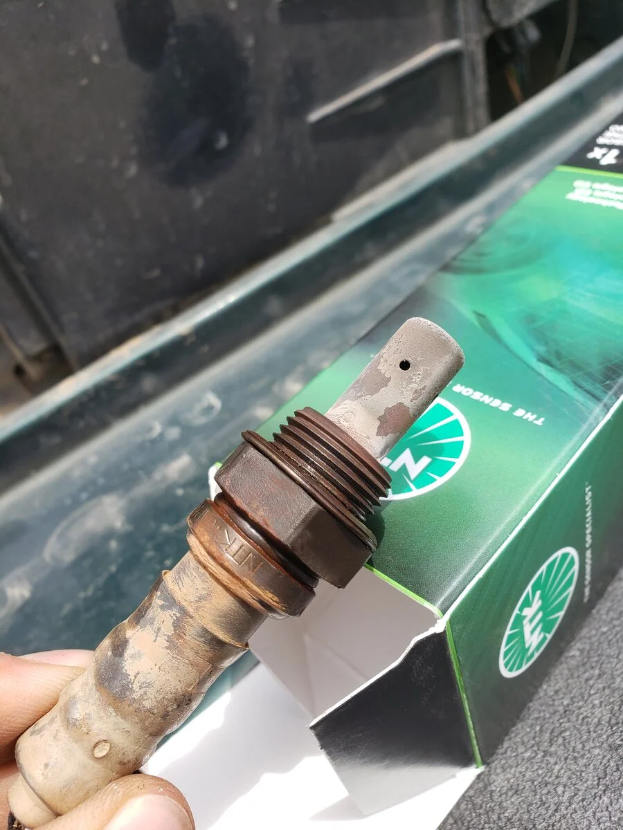

Just got the new O2 sensor in today and did the replacement. Lucky the old one wasn't seized in and took about 5 seconds to replace. I also disconnected my battery to reset the electronics and when I reconnected everything I had no CEL so I'll see this Sunday on one of my longer trips if this fixes the issue. Thank you for the advice

Here was my old O2 sensor. I don't think it looks that old
