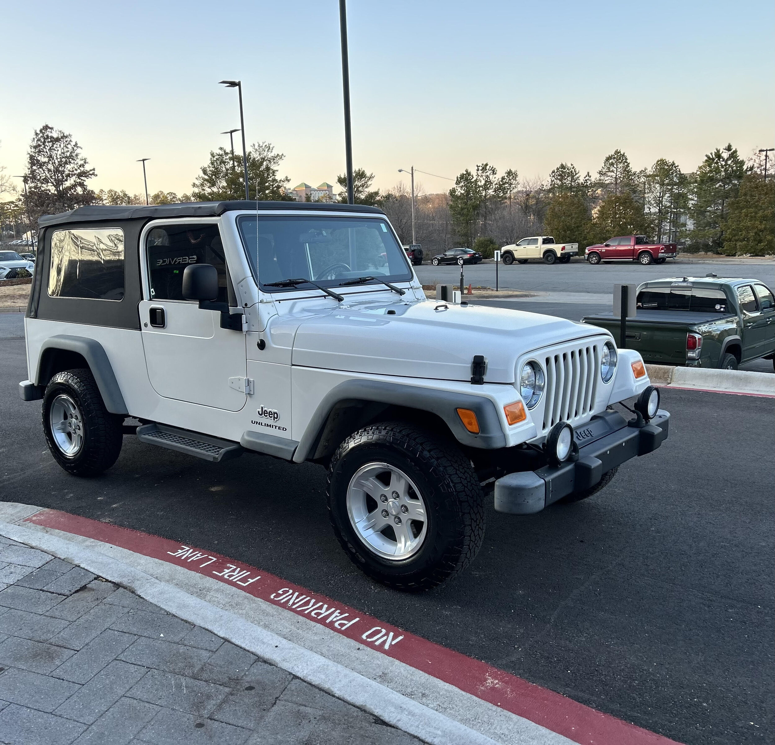

Around December of 2023 i found a listing on AutoTrader a couple hours after it was posted. the listing had no pictures but it was for a white 2004 LJ with 45k miles, one owner, and a clean Carfax.
i immediately reached out to the dealership and the salesman sent me this video.
I knew i had to act fast but unfortunately the dealership was 1200 miles away in little rock Arkansas.
I then did something stupid that i don't ever recommend anyone to do. I trusted a salesman's word and purchased the jeep sight unseen for $13,000 and paid $750 to have it shipped to South Florida.
I was sent this picture right before it was loaded on to the trailer.

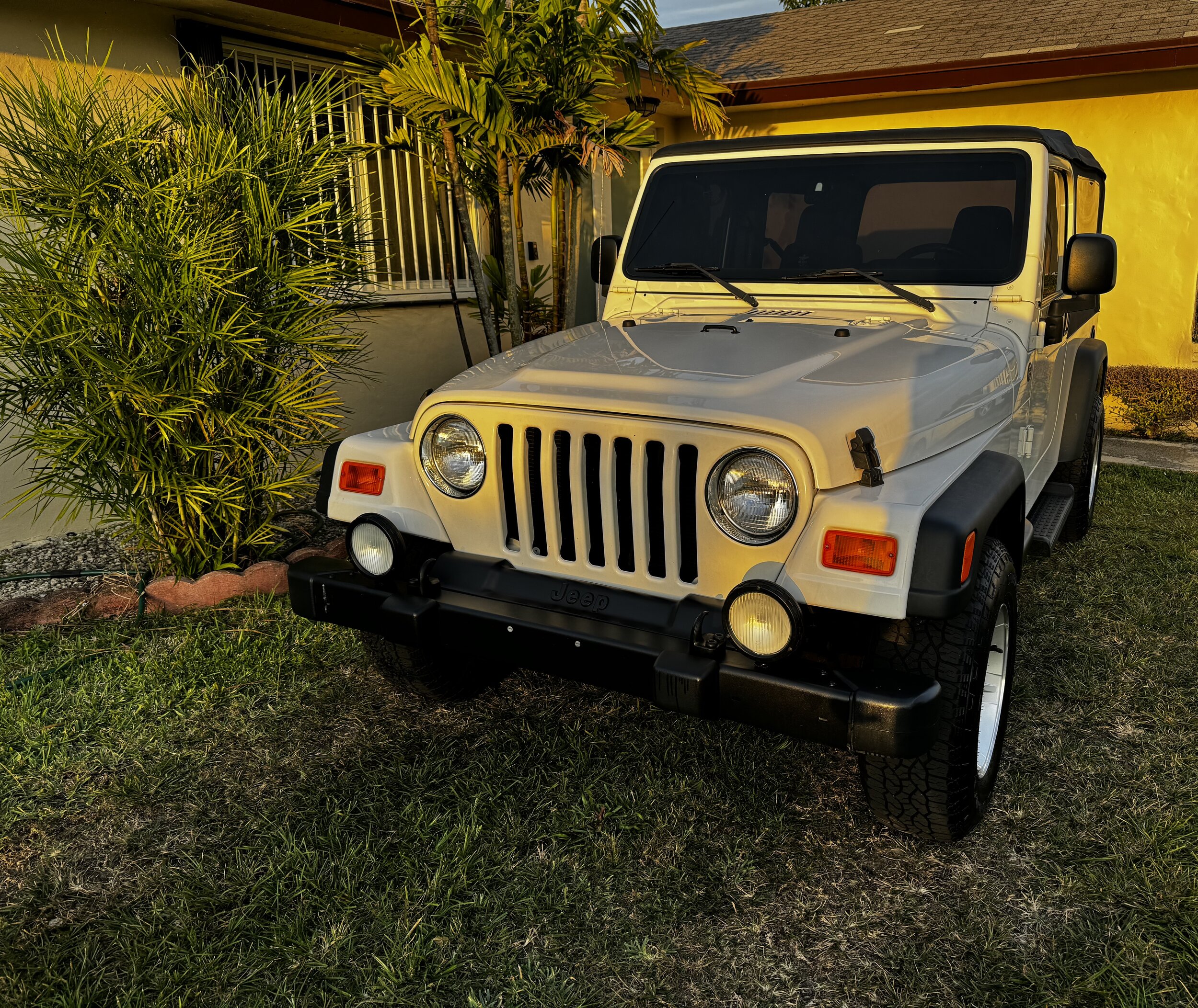

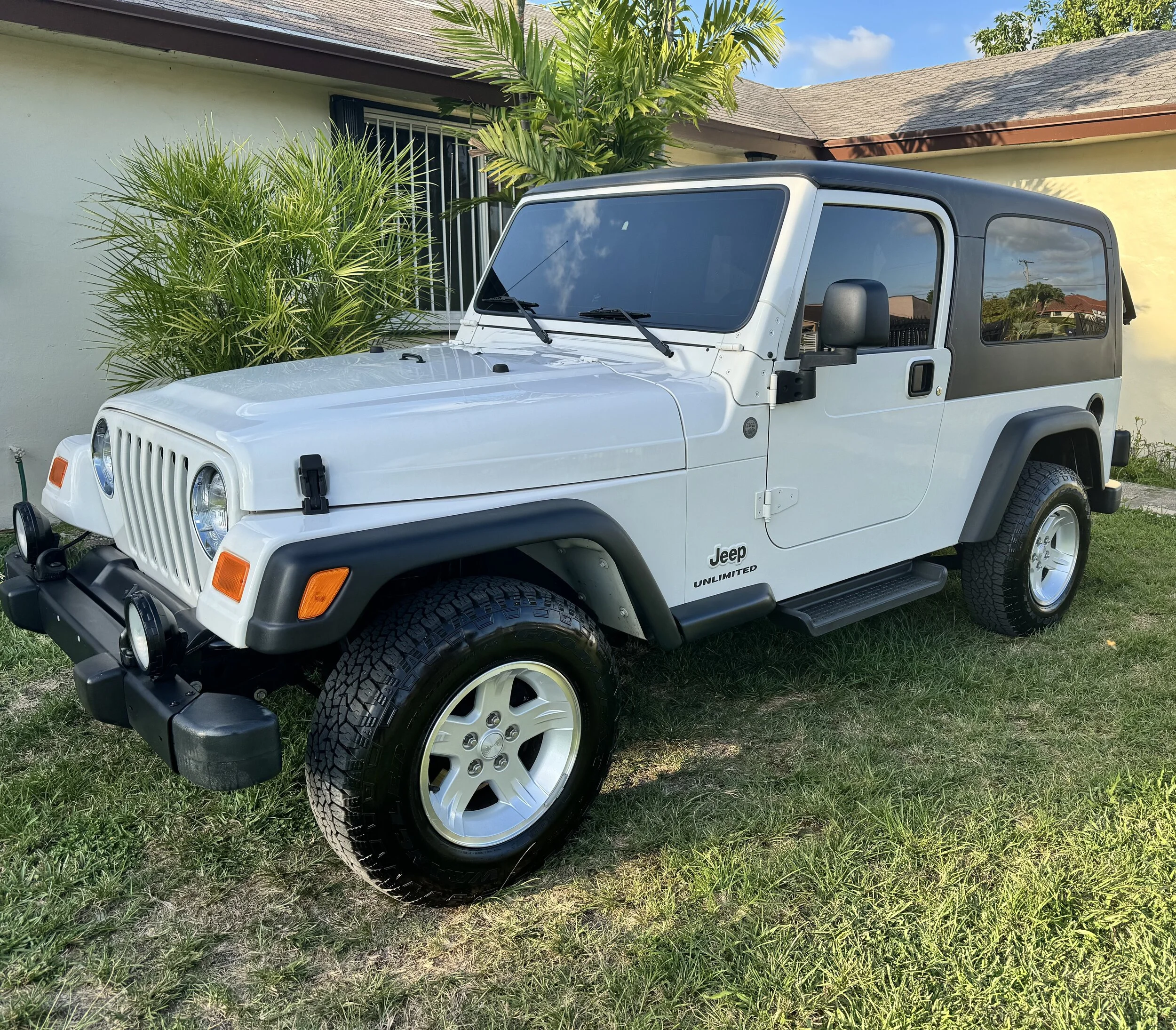

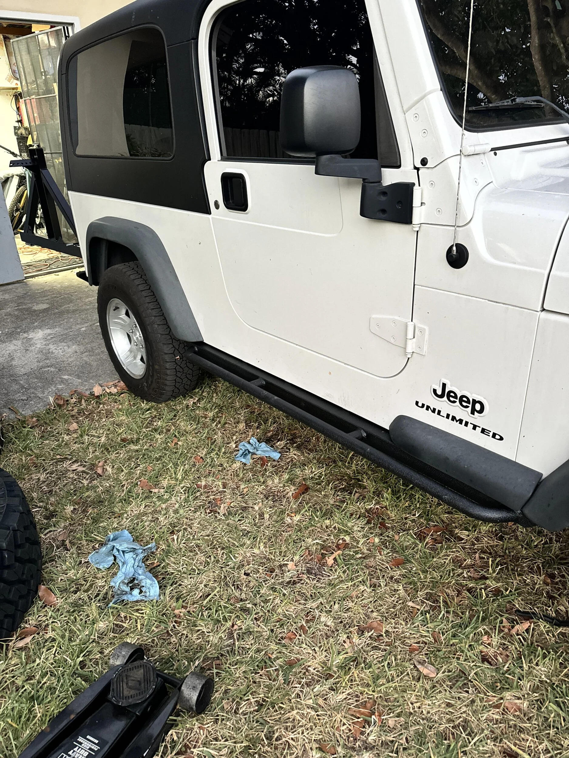

When the jeep finally arrived it was in better condition that i could have ever hoped for. i went through the whole jeep and couldn't find a single flaw.
judging from how good of condition the 20 year old factory soft top was in, i wouldn't doubt if it was garaged for most of its life.
Reactions: L J

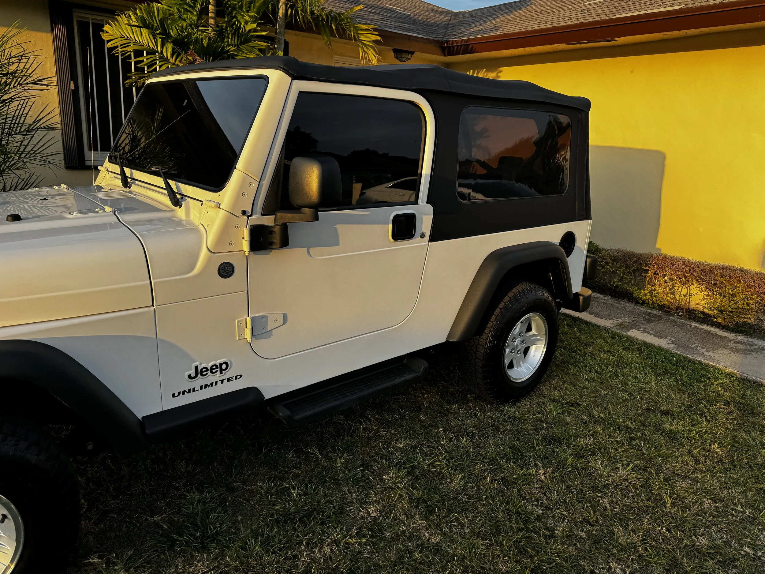

So that's how i enjoyed it for a long while. i had to financially recover a little bit after spending $14,000 on a 20 year old jeep. I did some simple things like tints, a dash cover, bartac seat covers,WeatherTech floor mats, and found a dude who was willing to trade his hardtop for my old soft top and a bit of cash.

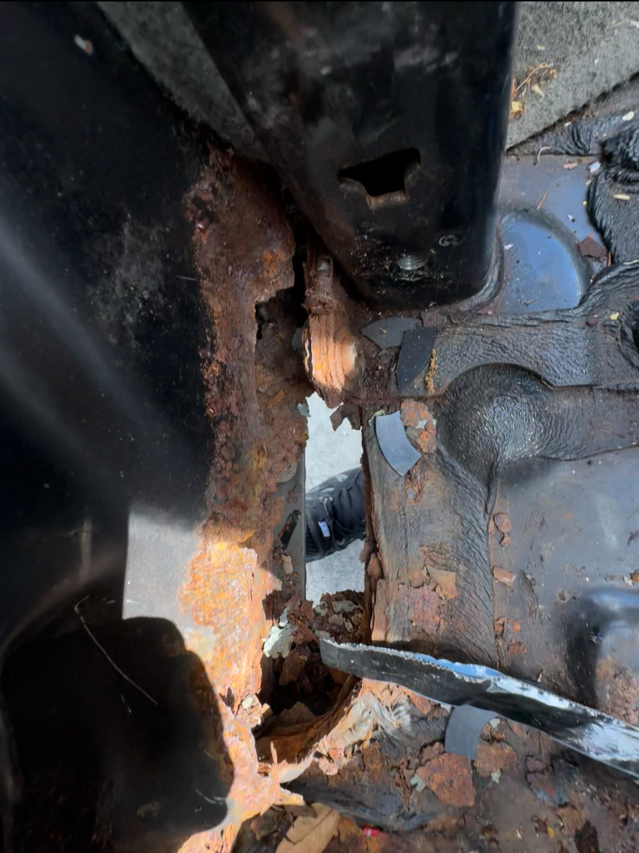

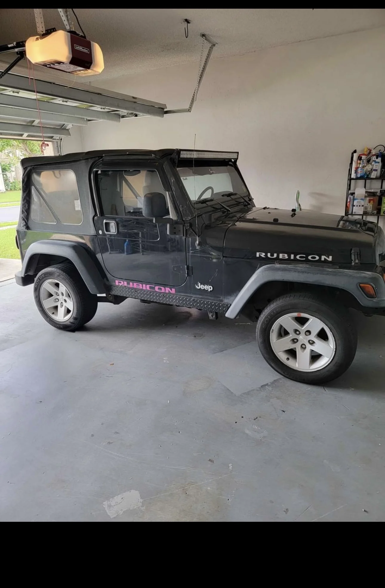

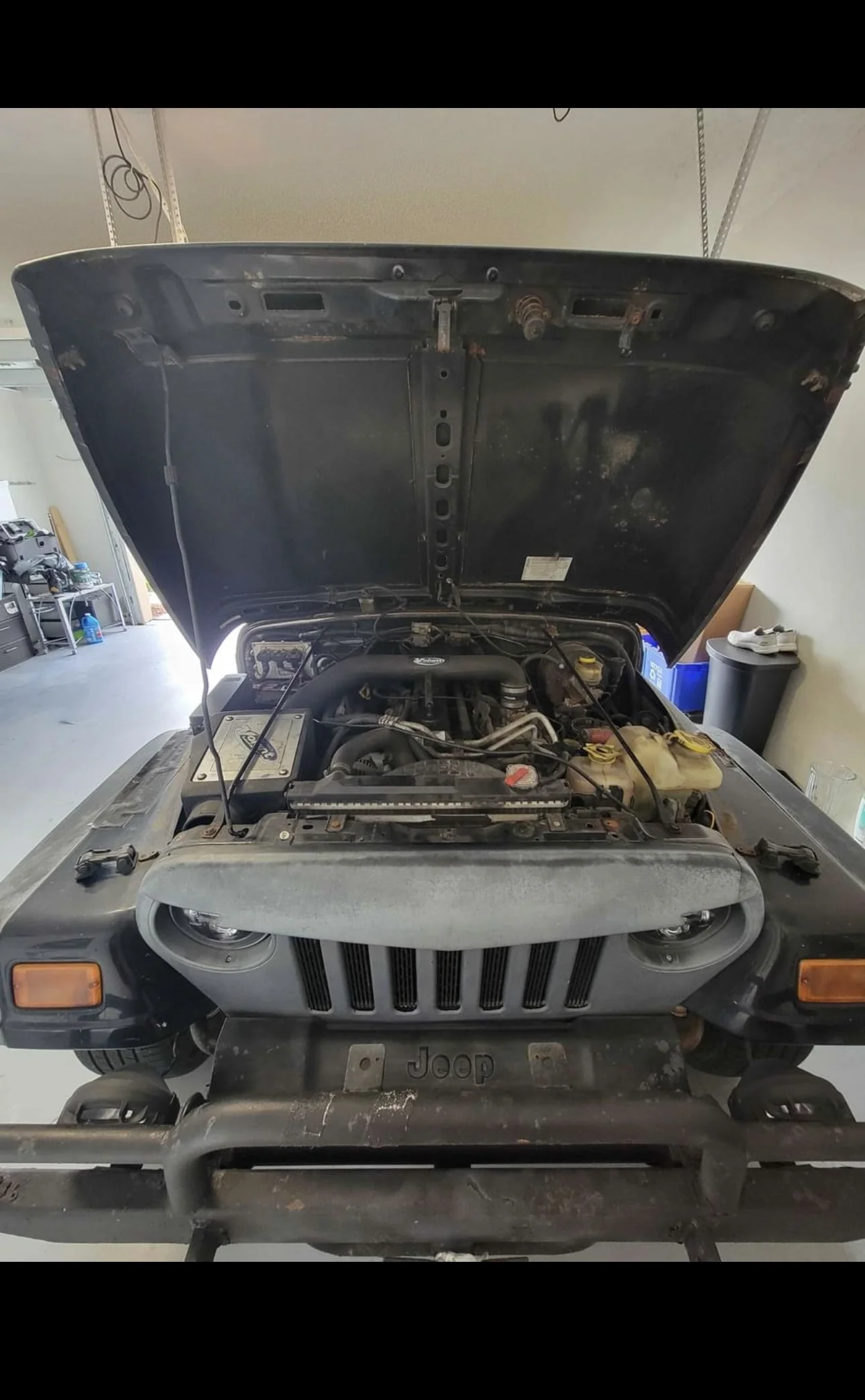

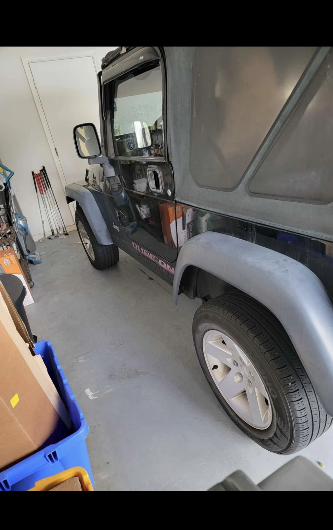

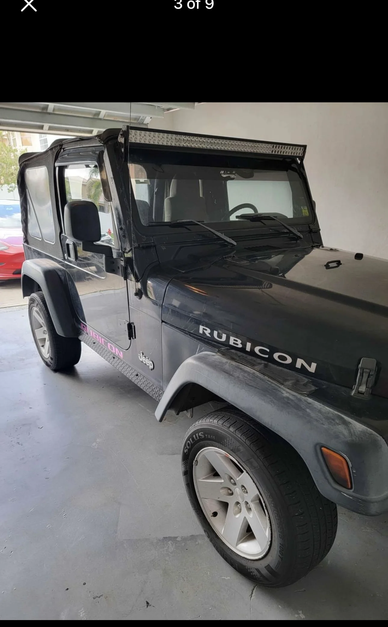

Then around august of 2024 i found this poor abomination of a TJR listed for sale at $3500. The frame rust was so bad there were portions of it that you could crumble with your hand. It had 240k on the odometer and said “ odometer exempt” on the title so who knows how many miles it really had.
knowing what the components are worth, i went and picked it up hoping i could at least make a bit of my money back parting out the interior which was in surprisingly good condition.

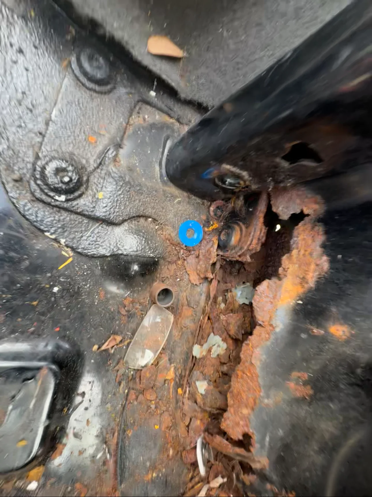

once i got it home i started to part out the jeep on Facebook marketplace and discovered some more rust in the tub. There was no saving this thing unfortunately.

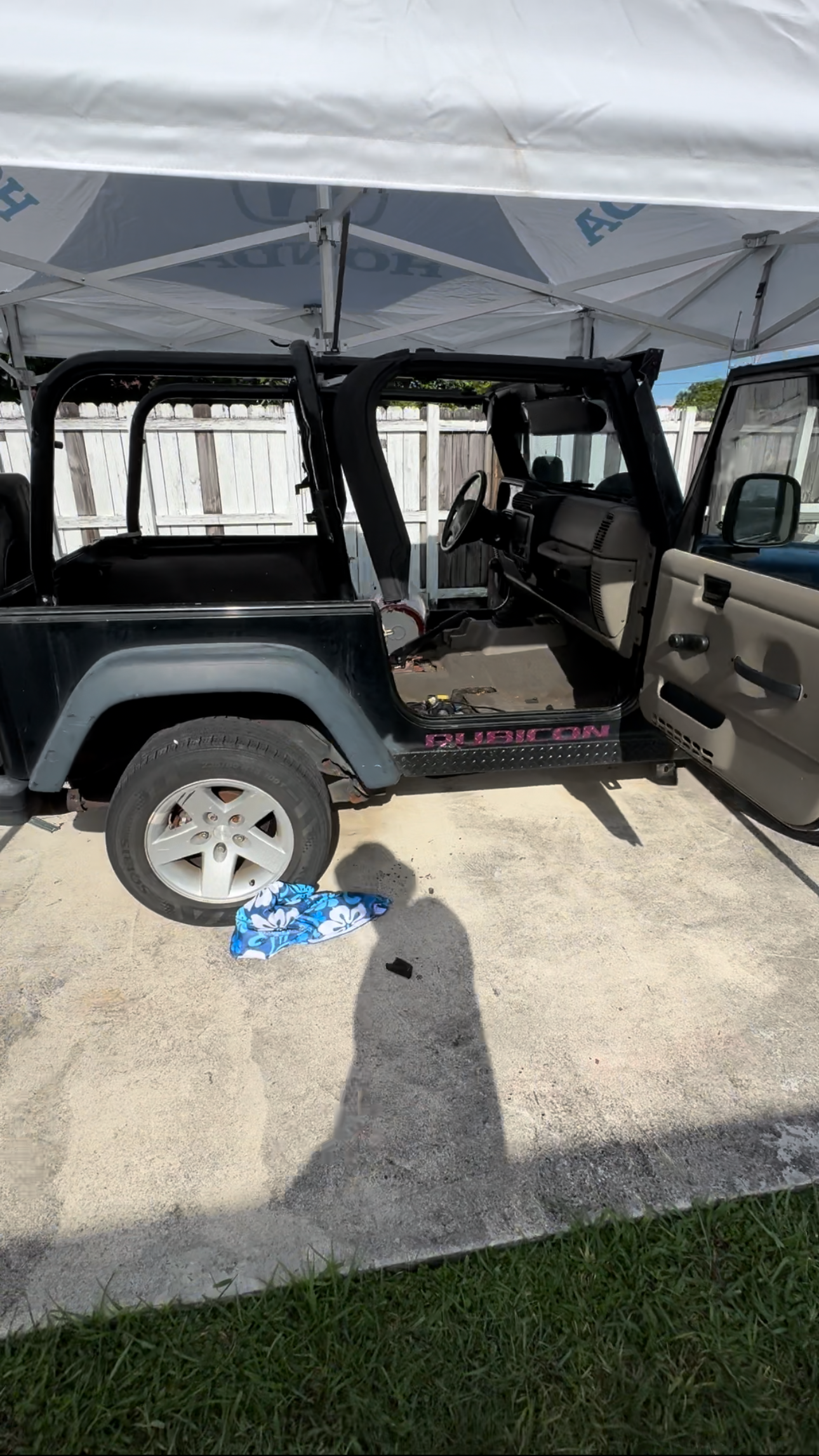

After about a month i had made back about $1700. All i had left was the Tub (with the doors), Engine (sold the tranny), transfer case, and the two axles under the jeep.
Until a guy reached out on marketplace offering to buy just the tub and the engine for $1600. When i asked him why he was so interested in buying a rusted out out tub he told me he plans on cutting this TJ tub in half, shipping it to Cuba, and having his friend over there weld it back together and drop it on a 50s jeep frame he has.
Now this doesn't make much sense to me but i wasn't about to argue with the guy who is paying me this much money on something i was gonna have pay to get hauled out of my yard.
I pushed the jeep on to a uhaul trailer and drove it to the guys house were he helped me pull the axles and left the remainder of the jeep on wooden blocks. The only regret I have after all this was not being able to swap my sport flares for the Rubi flares to due time constraints.

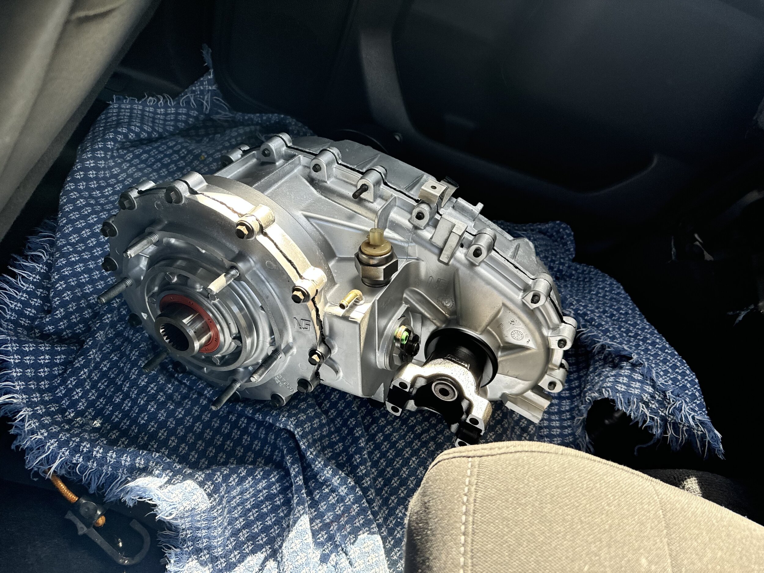

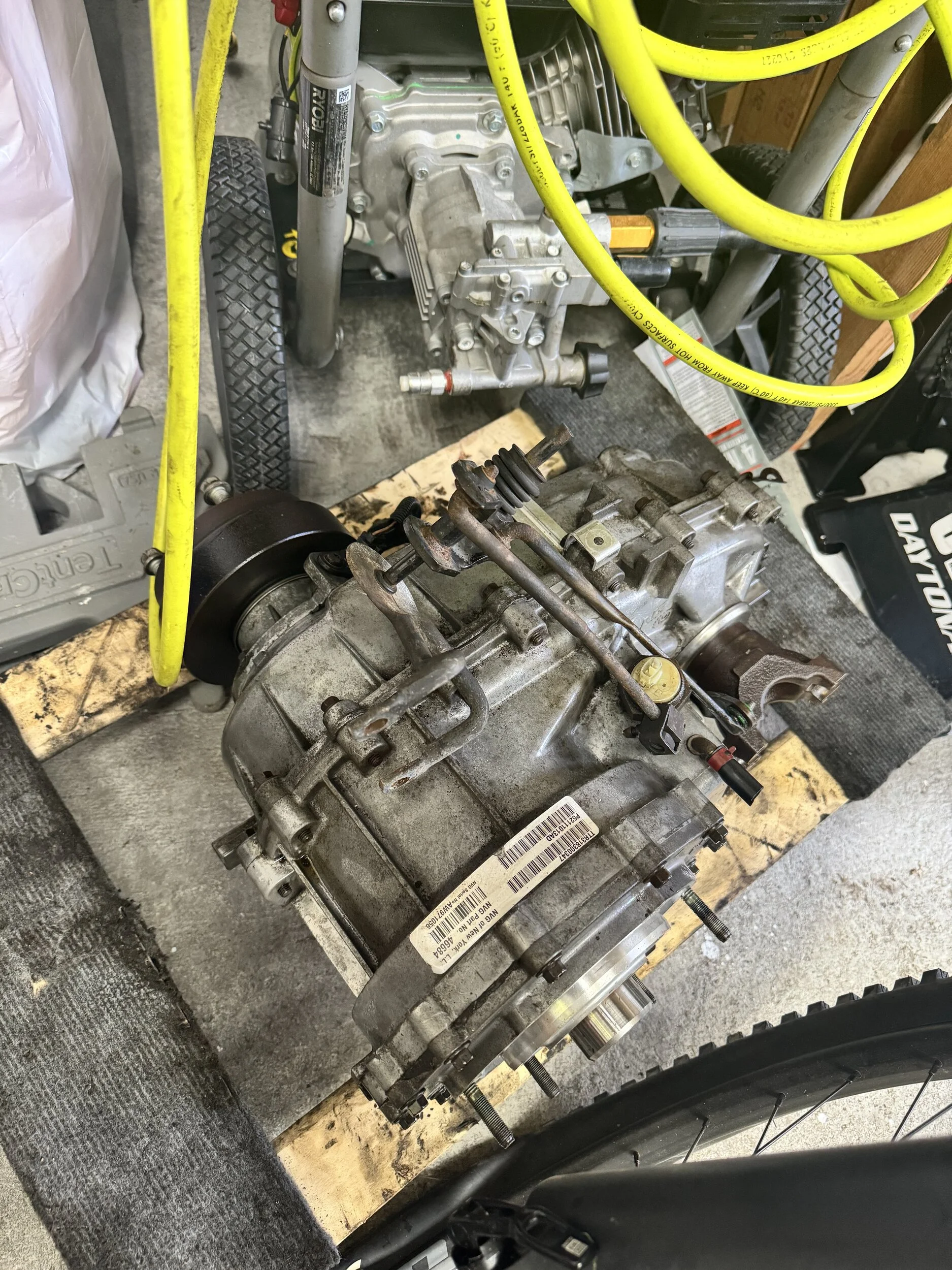

With 240k on the odometer and "odometer exempt" on the title i wanted to have the transfer case rebuilt for peace of mind.
I was fortunate enough to find a gentleman who worked for NPG for 25 years before they moved to mexico to completely rebuild the transfer case. A true professional and all around great person who did it for a very fair price.
He's semi-retired and told me he didn't want an online presence since he's only a one man show and doesn't want too big of a work load.
I don't want to gate keep either but i won't post his info out of respect to him, if you need your transfer case serviced and are in the central Florida area PM me and ill pass you the info. Here's a before and after.

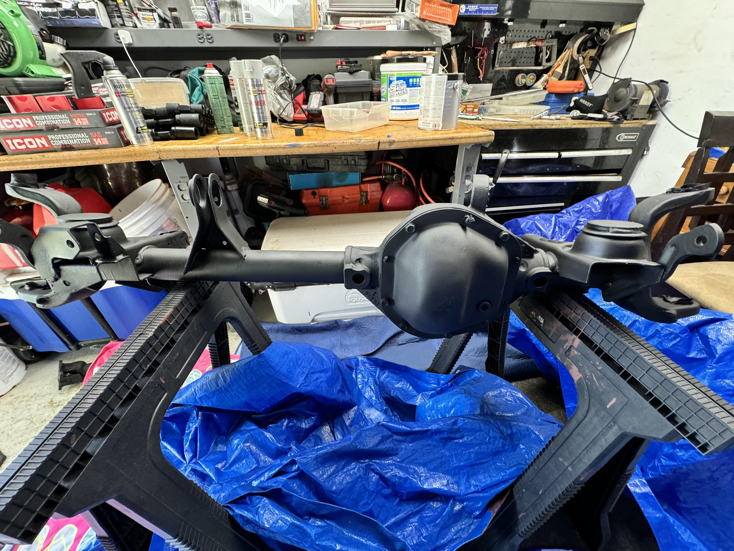

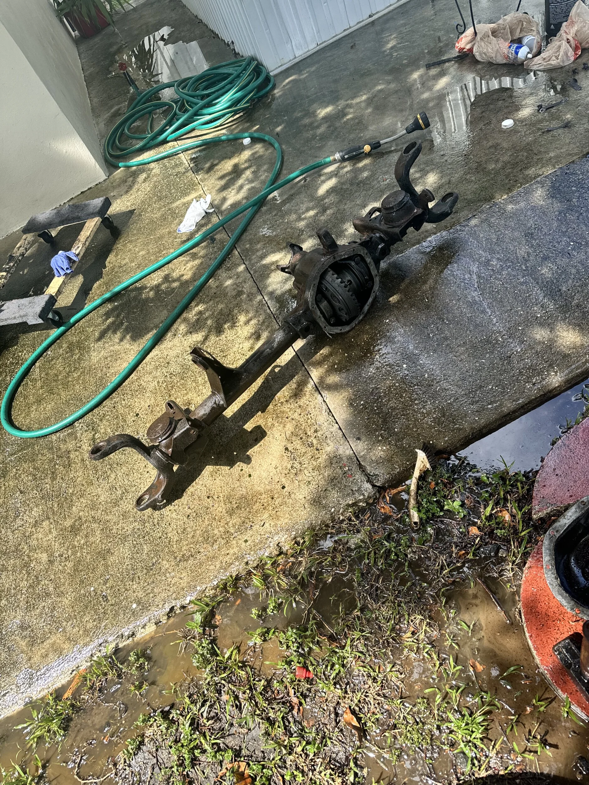

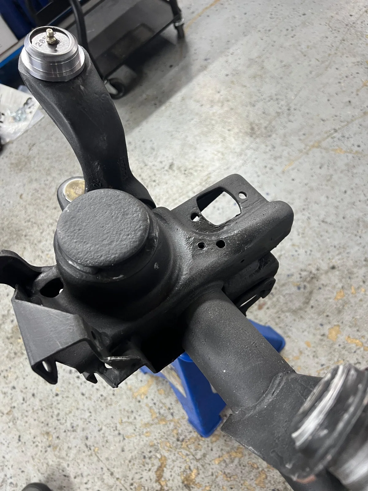

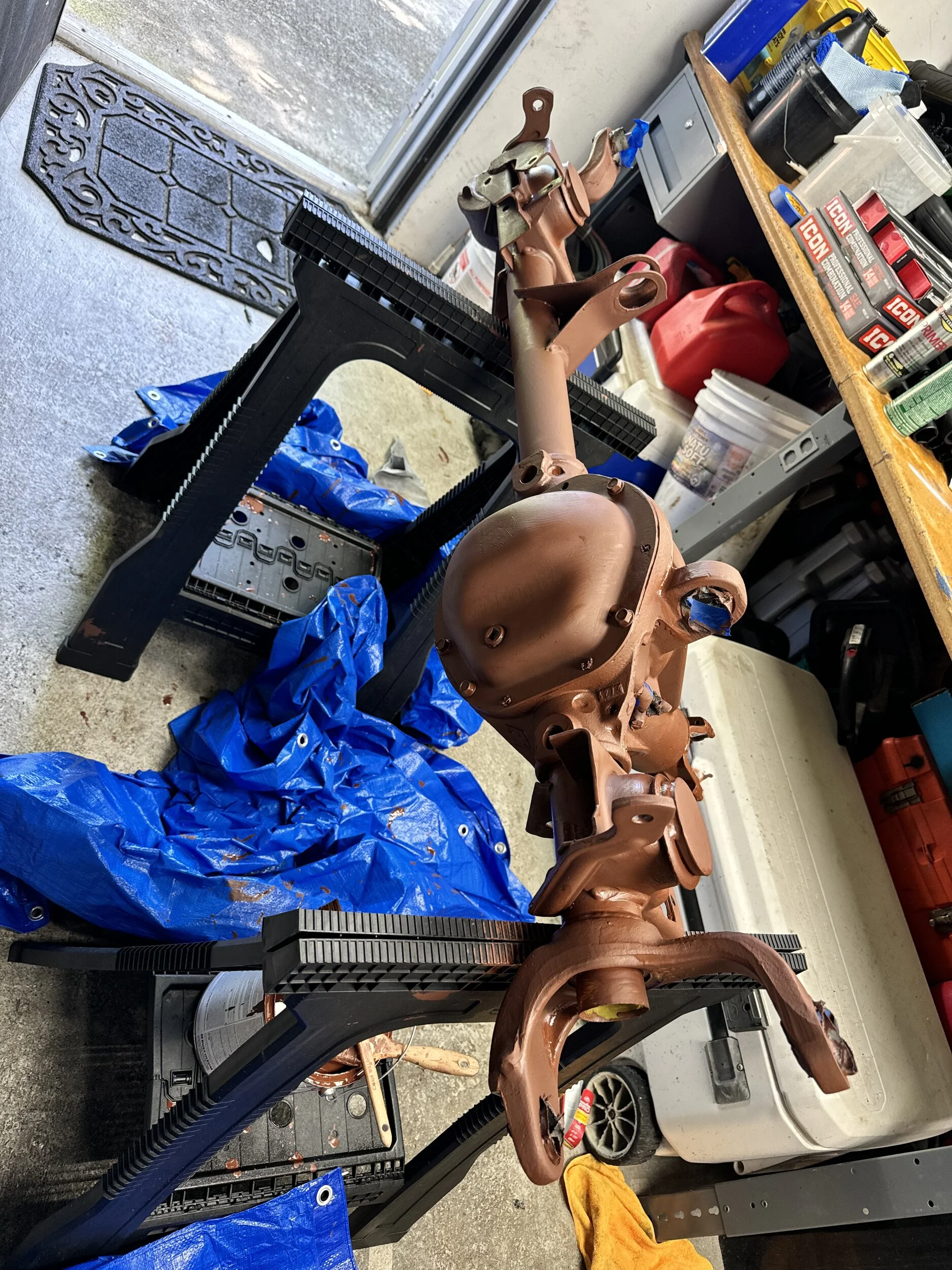

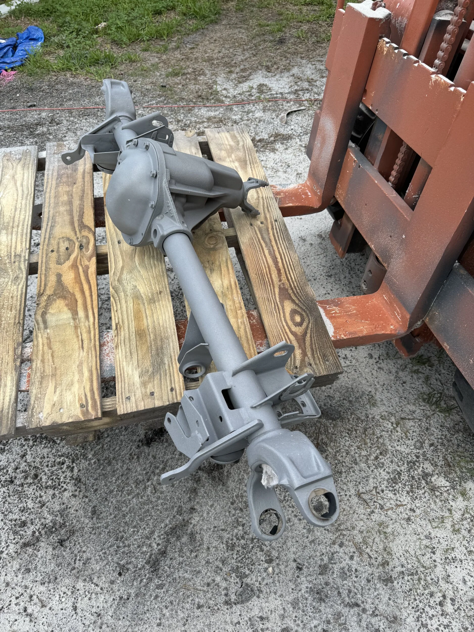

The front axle had so much random oil caked on it that i guess it saved it from the rust the rest of the jeep suffered from. all it had was some surface rust and a small hole on a coil bucket mount that i later had fixed. I cleaned it up, had it sandblasted, and painted it in my shed using rustoleum.
Nice way to get some Rubi axles and TCase basically for free.

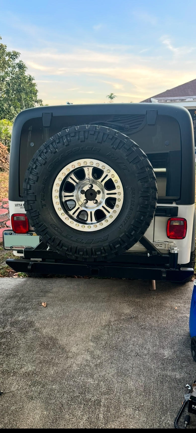

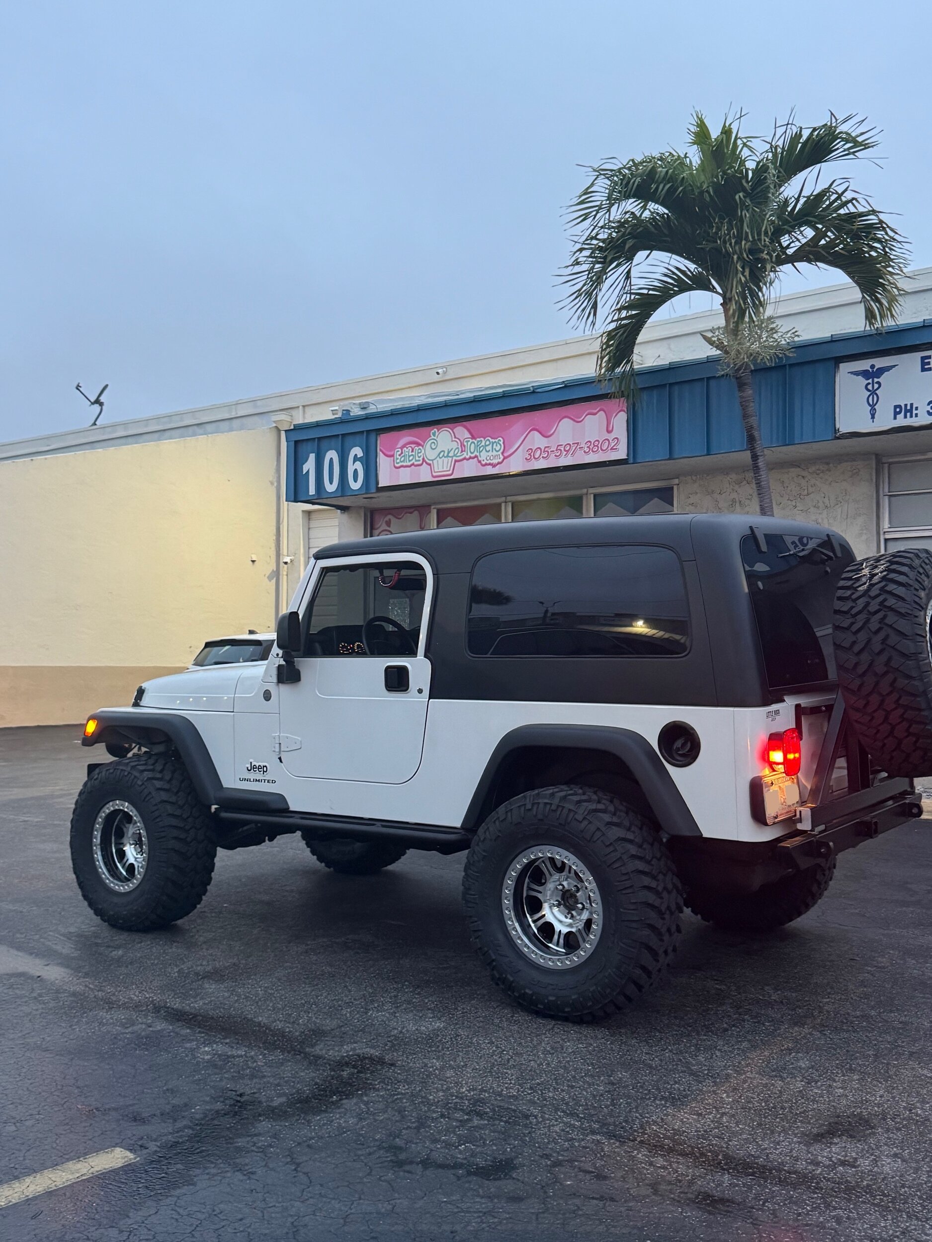

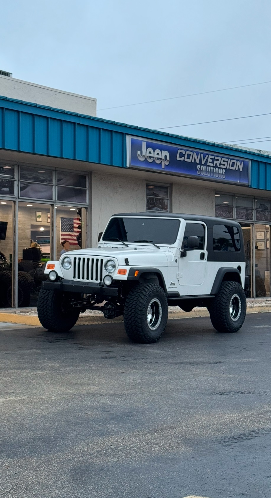

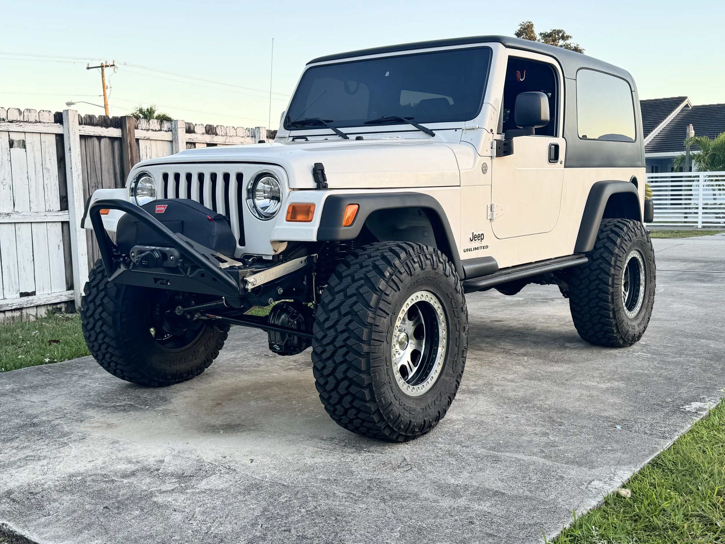

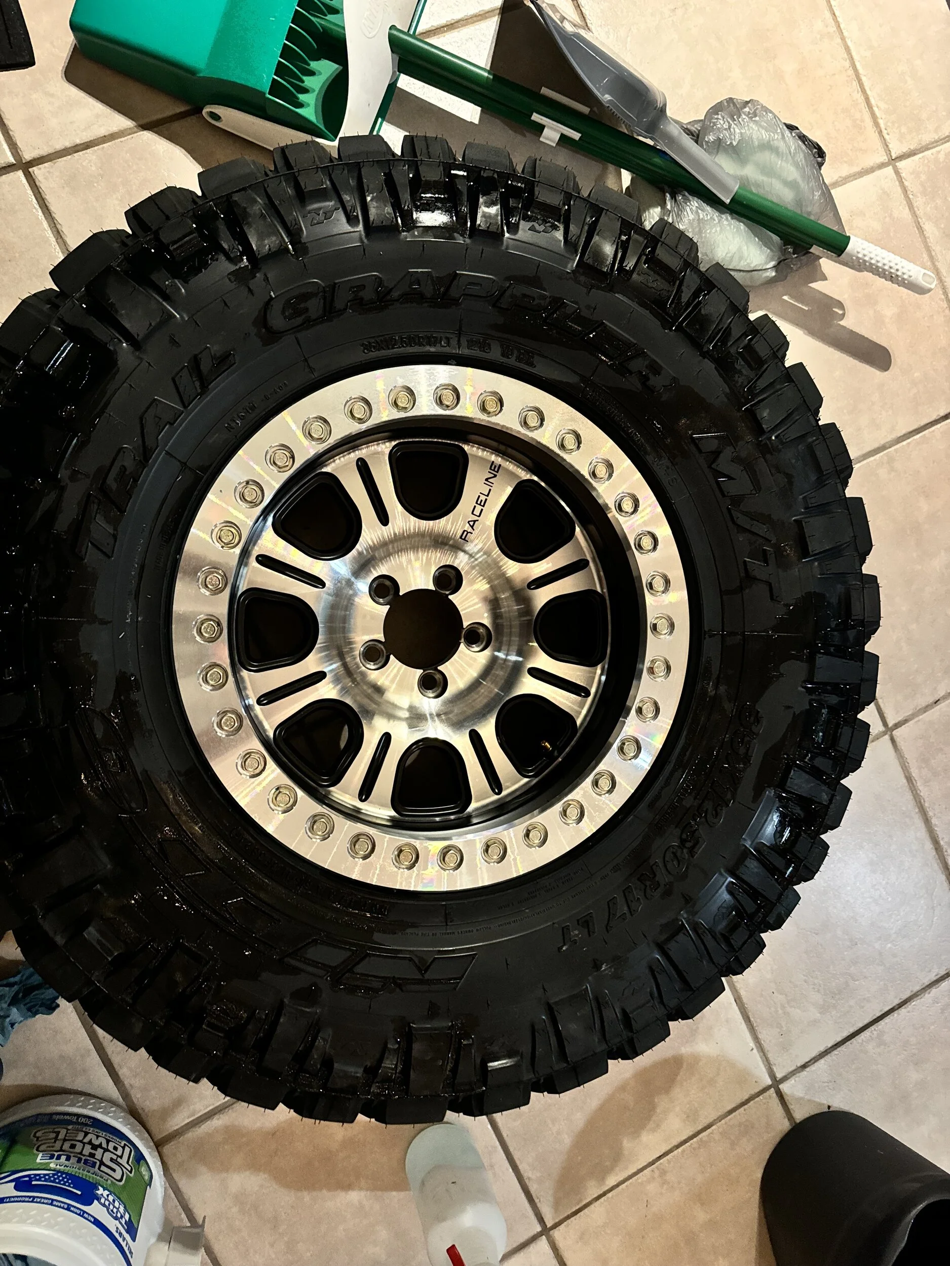

finished up some stuff the day before dropping the jeep off at the shop for the lift and regear.
I know i should've got some real rock sliders but i just couldn't bring myself to drill holes in the tub, its something I'm gonna have to get over eventually.
Mounting beadlocks for the first time is a true test of one's patience.
Reactions: JMT
Dang that is a good looking rig!
Love those Monster Beadlocks.
Thanks man I appreciate it! Yeah I really think these racelines look great on tjs.
If you don’t mind me asking, did you experience any additional vibrations with the savvy skid?
Right now my jeep is perfectly smooth even at 80 (when it eventually gets there lol) andI’ve read 5.38s and 35s can be problematic for some people. I’m a little worried to throw another factor in the equation and experience the vibration issues others have had.
