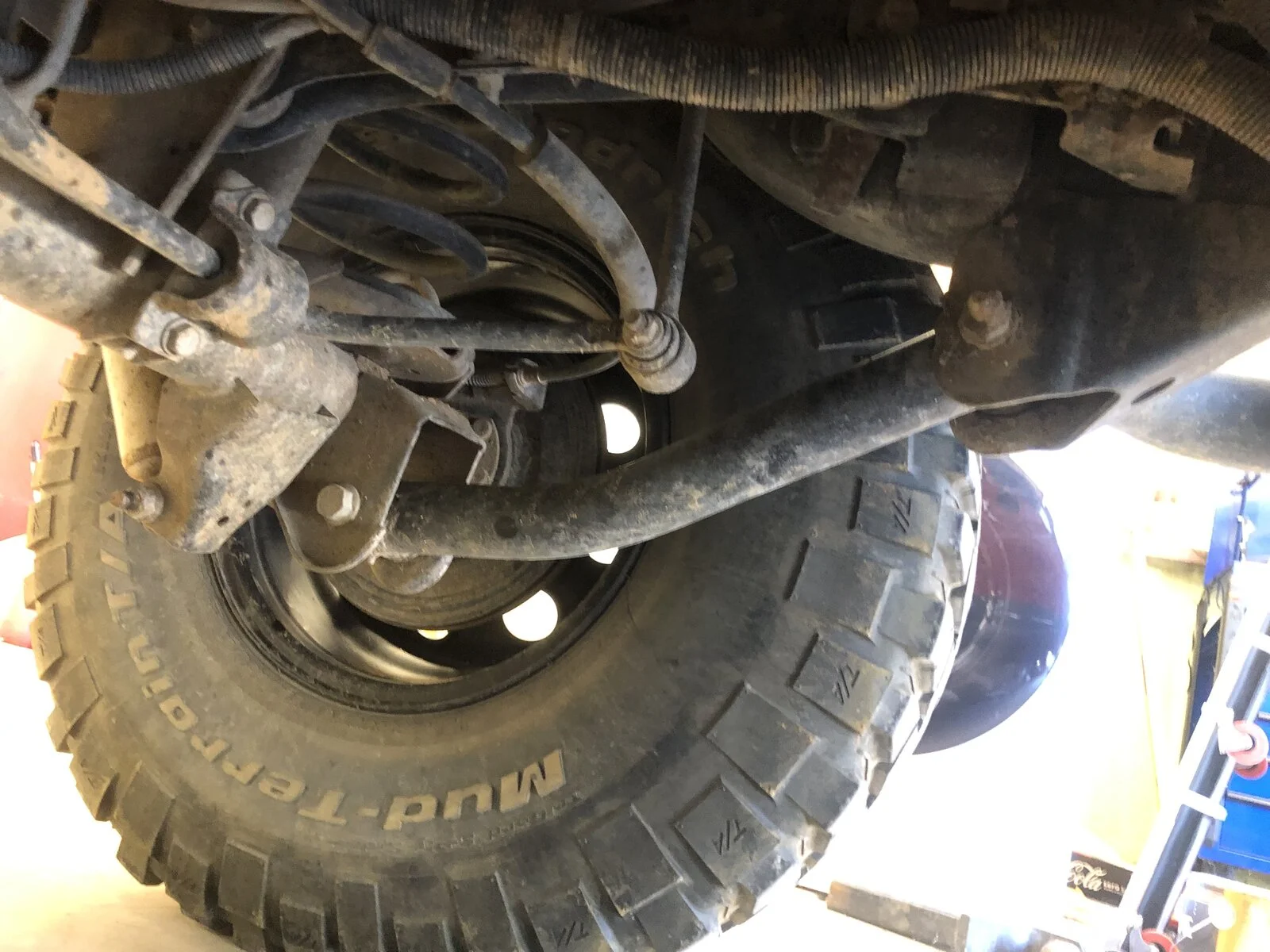

Just bought a '06 Wrangler Rubicon. Primarily for my wife to drive around town, not any serious wheelin'. It already had a suspension lift 4"-ish, and from what I can tell by ready on this site, some wrong parts. It drives awful, rolls into turns, doesn't track well and routinely goes into the famous death wobble deluxe version! The tires are 35x12.50-15 and worn from (and now causing) some of the driving issues.
Suspension as it is:

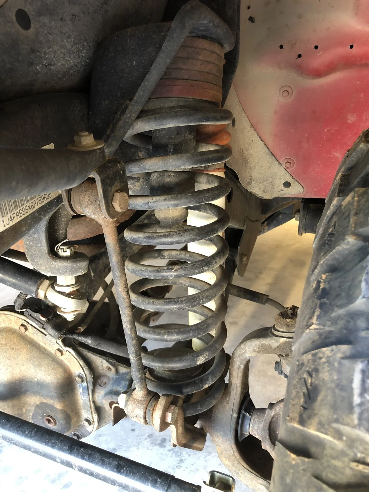

Looks like 4" lift springs and the spacers above the front springs are about 2-1/2" thick.
Shocks are Skyjacker Nitro 8000 which makes me think it's their lift kit too, but the rear lower control arms don't look like what's on their website now.?.?

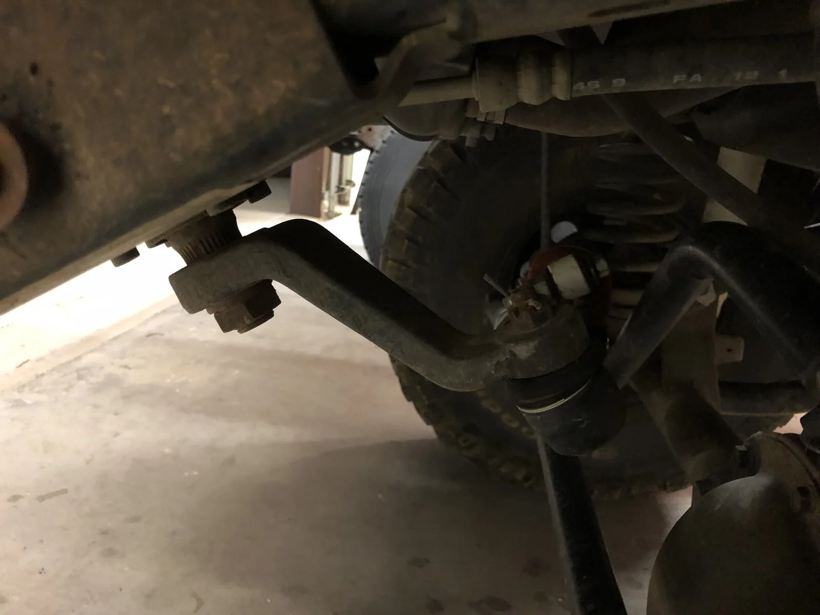

It has the drop pitman arm
The front Track bar appears to be totally wrong, and has a Heim joint that is nearly maxed out to one side.
My thoughts on making this a safe daily driver for my wife (it's parked now until repaired) are as follows:
Replace the track bar with a HD stock type replacement.
Add a front track bar relocation (drop) kit.
Re-bush factory upper control arms & the lower aftermarket control arms
Re-bush the sway bar links
Replace upper & lower ball joints with good quality stock.
Replace steering ends.
Reduce the spacers over the front shocks by an 1" or so
Replace shocks with high quality shocks (Ranchos?)
Finally, once all this is done, back up to 33x12.50-17 tire/wheel combo.
I's a car guy, but just starting to learn Jeeps! I would greatly appreciate your time in reviewing the information, attached pictures, and giving my your thoughts on what I need to do to make this a safe & fun to drive Jeep. Recommendations of parts and brands would be appreciated as well!

I'd ditch the 35s for 33s. Remove the spring spacers. Get stock pitman arm. And throw away that track bar for another brand.
Probably so much more too. Can't tell from the pics

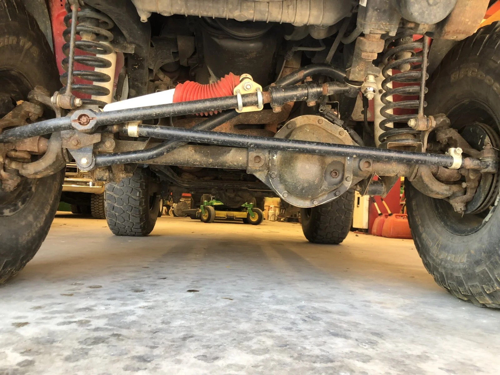

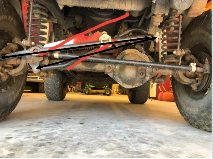

If it were mine I would start over because you have a mess there, no wonder it drives like crap. №1 would be the drop pitman. You can see that your drag link and track bar aren't even close to parallel. № 2 would be all the spring spacers.

Your steering...
Bad
See the lines? They should be parallel
They should be like this...
Going back to a stock pitman arm would help get close to where you want to be
That change alone will feel like a new jeep
Good luck

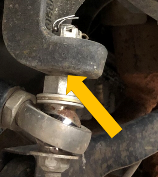

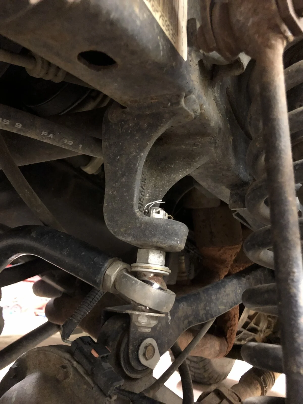

Start here, that's a huge gap.
Thank you. There is a drop mount at the axle side end of the track bar that needs to be dealt with. The trackbar has too much bend going over the diff and the rod end is binding on uptravel. I'm not sure what that mess the arrow is pointing at is but there is nothing good about it.

That track arm is rough for sure.
The fact that the jeep is on the ground the the heim joint looks like its completely tapped out for up travel is suspect,
and the lack of proper misalignment spacers on said heim joint would make it function a little better, and it looks like they used a piece of threaded rod instead of a bolt to mount it. IDK
Like others have said, replace your drop pitman arm for a stock one and that will help get rid of some of your death wobble.

If it wasn't for the gap at the edges where the "bolt" goes through, I'd wonder if that isn't a steering stabilizer bolt with the tapered pin on one end?? If so, it should have a gap before the hex bottoms out.
I'd put a $1 on that being a stabilizer bolt; there's 4 washers on that setup, I'm not an bolt/washer expert, but I would find a better way.
