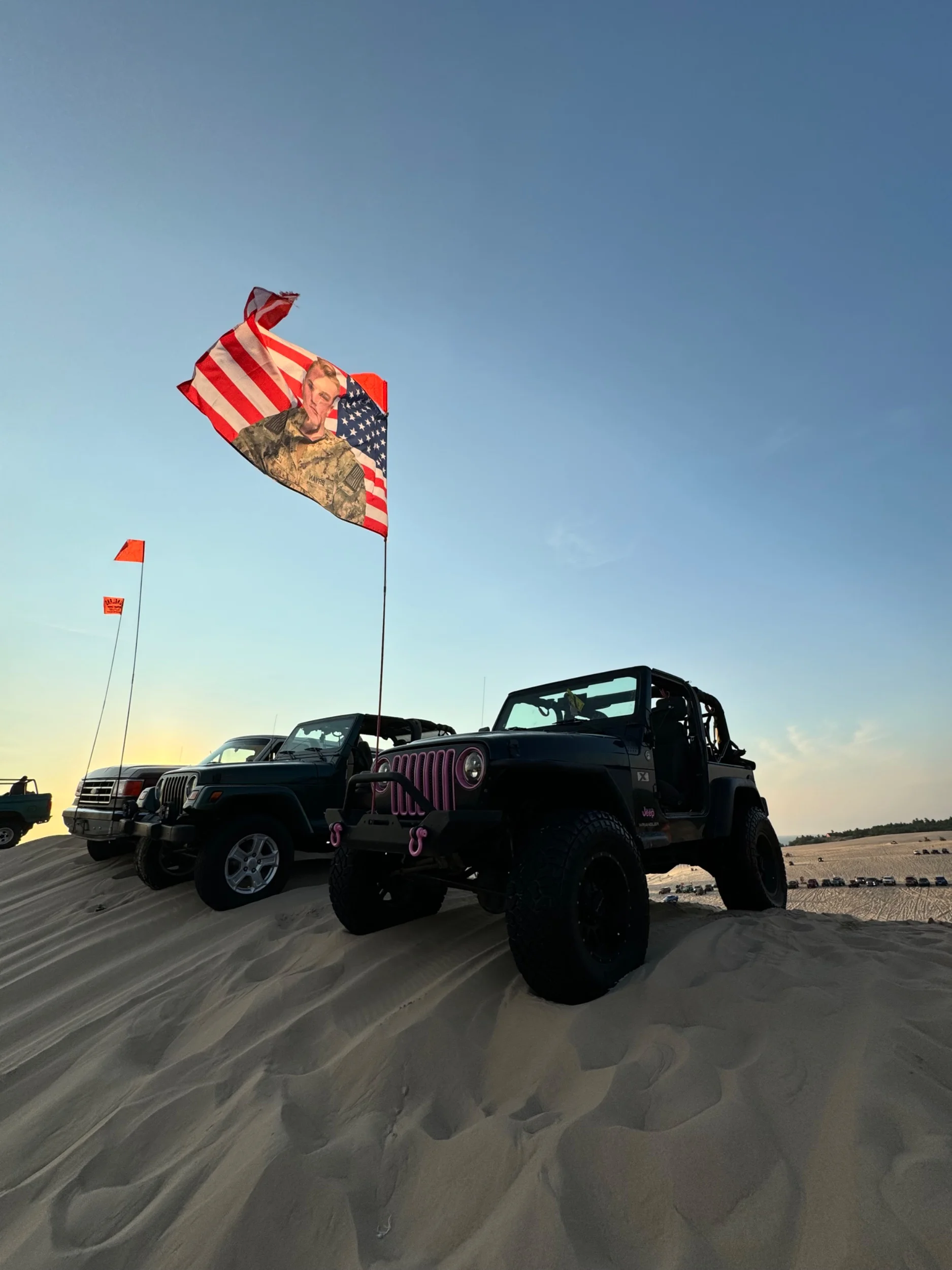

Hi! I have a 2006 TJ and I’m looking to upgrade the suspension. I have a 6in lift with 35s and stock suspension. I use it as a backup daily and an offroad toy for sand dunes. What suspension should I look into for a more smooth dune ride while also still being able to drive highways?

I was wondering the same. How do you have stock suspension and 6” lift?
6" coil spacers with the shocks pulled tight, which might be what keeps the rear driveshaft from locking up. The end result is something closer to a 3.5" lift and getting airborne a lot.

Sorry I’m new to this stuff lol but yes I have stock shocks. I blew the rear ones on the dunes and they were replaced with OEM shocks. It actually isn’t even bad, just gets bumpy over whoops but I still can do any hill. Just looking for a smoother dune ride

Are you just going off of what the PO told you? A few pics and spring measurement might help determine what you actually have.
Yes, I am not knowledgeable with this kind of stuff. I can get pictures and measurements
