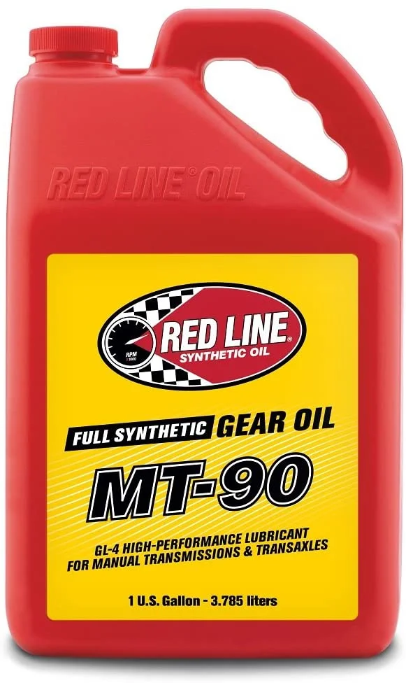

The first thing I noticed when I purchased my 97, was the shifting in the AX15. It was just as you described above. I got several suggestions to change out the fluid, and put in Red Line MT-90. Between that and just getting used to the shifting, I haven't had issues with the transmission. Its worth a shot. AX15 is a pretty good transmission.

I have been reading a lot about MT90 on the forums for the AX15. Thanks for suggesting this, I am going to drain out the syncromesh and fill with this to see if there are improvements before committing to a new AX15.

With that said, at 80k miles I doubt your trans is worn, and the Redline MT-90 improved the shifting in mine by a lot, even after it had the wrong fluid in it for however many years before my ownership.

Jeep and Aisin now recommend you run syn 10w-30 in the AX-15 if you can't get GL4 lube. So if you want to do a cheap flush of the trans, this is a lot cheaper than using MT90.
Chrysler recommended 10W30 after they incorrectly filled with and recommended GL5 to from the start of using the AX15 in 1989. Aisin Warner still recommends 75W90 GL3/4 as they have all along.
I bought my ‘97 with an AX-15 at 150K and it had pretty much what OP describes going on. The rec redline fluid improved it a lot, though still notchy 1-2, and 2-3, especially when cold. I’ve daily driven it for 10k mi and it’s no worse. Although I may get the Novak unit someday (if things get worse), my bet is it’s fine for a while and the $ could be better spent.
My AX15 has 206K and I bought my 1999 new. I ve changed gear lube every 60k and shifts great. I m using RL MTL rather than MT as my research showed it helped more especially in cold weather.
It’s not cheap but I d drain it and give the MTL a try. Unless the PO /s abused that AX15 it should have lots of life left!!

Ran great w Pennzoil synchromesh, but not as awesome with the Redline everyone recomments. So damn odd, but true. Even getting slightly notchy in 3rd now. That said, Im planning on going back to Pennzoil.

I replaced the clutch with a Luk, filled the transmission with 10w30 for a few miles, then MT-90. It still whined in every gear but 4th. The local transmission shop said 4th gear uses none of the other gears, it's a straight shot to the output shaft...hence, no noise. All my other syncros were gone.

Thanks to everyone for the opinions. I am going to spend my time and money focusing on my suspension right now and this weekend I will drain out the synchromesh and put in RLMT90 to see if I notice any improvements. I have no grinding at all currently, I drove it a bit yesterday paying close attention to shifting and noises and my biggest issue right now is downshifting from 3rd or 4th to 1st, it's impossible to get it into first from those gears if I am moving, when I try I hear a slight whine from the trans the harder I push the louder the whine.
