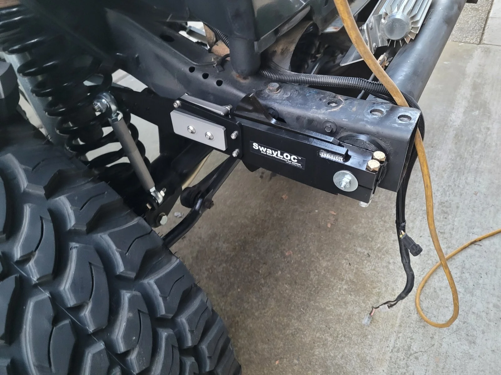

Swapped out the Anti-rock for the Sway-loc. Just have to clearance the PS bumper a bit.
As some may remember I swapped out my Anti-Rock for a Sway-Loc. It has made a night and day difference in on road handling.
I had an annoying handling thing going on when running down the highway at about 65-70. As I would slightly correct the wheel it wanted to wander in that direction of the correction and I would wind up wandering back and forth, it was unnerving. I could not get over the feeling I was about to flip on my side when getting on the freeway due to the body roll.
Well in comes the Sway-Loc, It has completely removed the wandering and now it drives like it did when stock.
I've come to realize the Anti-Rock was great when off road and if I only trailered I would probably still be running it, but I hated it on road.

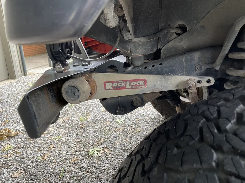

I ran the Skyjackers Rock Lock and loved it. I did have to clearance my homemade bumper for it (see the notch in the top) and the hub make it super easy to lock and unlock.
