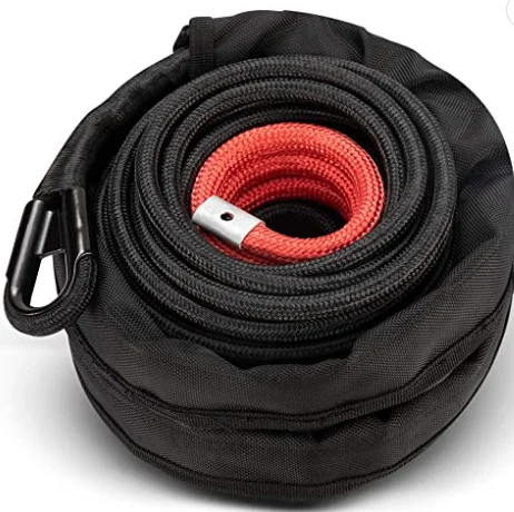

So if I choose to replace the steel cable with 85' of 3/8" synthetic, I need to make sure it has a steel eye on the attachment end like this?
Not necessarily needed. Duct tape works well if you secure the end to the drum. A crimped lock with set screw, duct tape, whatever can get it to hold initially. The first 3-5 layers of rope are what really secures it to the drum when in use.
You can use that flattened piece of aluminum tube with the hole drilled in it to attach to the drum side. If the line under load goes down the side of the drum though, it will wipe the line right out of that connection. Far better to cut that off and duct tape the tail across the drum and over wrap it with the layers of line.
