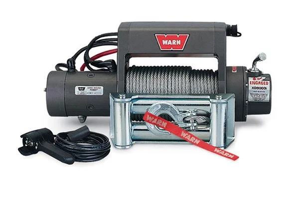

New winch owner here. I picked up a lightly used Warn XD9000i with 125' of 5/16 steel cable.
First thing I did was unravel and inspect the cable to which I discovered a massive flat spot/kink. I was already on the fence about running steel, so I'm using this as an opportunity to convert to synthetic.

I am not running a Hawse. I am running a brand new Warn roller fairlead. Synthetic rope requiring a Hawse fairlead has long since been debunked. Deburred (or new) roller fairleads work fine and my bumper requires the additional clearance of the rollers (ARB style bull bar with a recessed fairlead mount).
I've already deburred the spool and repainted with engine paint. That's good to go as well.
The XD9000i has larger clearance due to the integrated solenoid than the more common Warn winches (M8000, XD9000, etc). So while your 80' rule holds true for those winches, the XD9000i can accommodate 100' ft of synthetic 3/8. Remember - it came with 125' of 5/16 cable from the factory. I can always shorten if need be.
In winching, less is more, but good anchor points are scarce out in the desert. Having the extra 20' is worth my peace of mind :)

The XD9000i has larger clearance due to the integrated solenoid...
I have a 9.5XP-S but I'm not familiar with the XD9000i. Does it sit higher off the deck?
Exactly. The integrated solenoid sits higher above the drum than other Warn winches.

First, regardless of how much higher the integrated solenoid pack is, how far is the drum up off of the mounting plate? The shortest dimension is the problem, not the tallest.
Elaborate how? The line is stiff, very difficult to splice and has none of the attributes we like in synthetic lines except strength.
Fair point! Regardless, the XD9000i has plenty of clearence for 100' of 3/8. Masterpull put together a nice chart of popular winches and their rope specifications (scroll down a bit). I'll drop this here for anyone else looking to research:

I would be interested in knowing if the XD9000i drum is different than the one on my plain old XD9000.
Cross referencing Warn's parts sheet, the part numbers are identical for the drum.
Without having the full specs in front of me, my assumption is the additional clearance from the integrated solenoid makes it possible.
TRE's data also confirms 100' of 3/8 is ideal for the XD9000i where as only 85' fits the standard XD9000:
