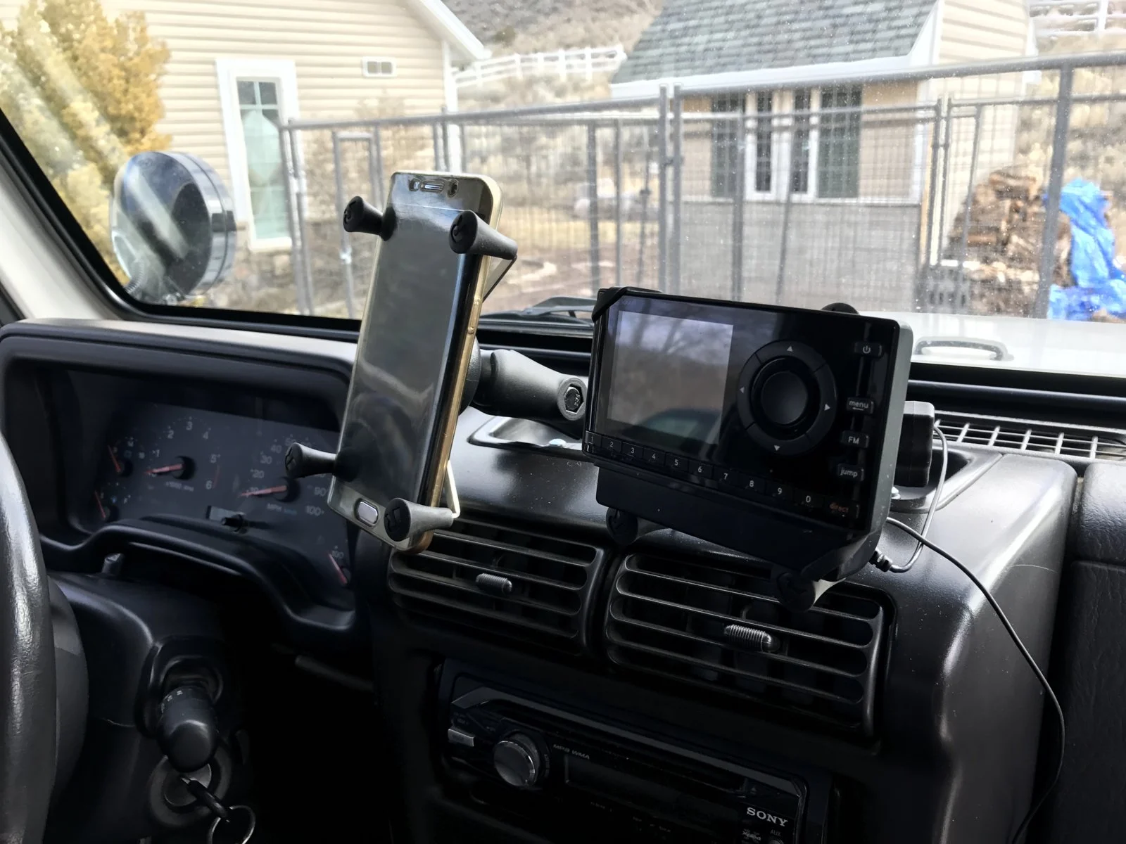

I've been tinkering with TJ. My son had some extra LED interior lights so he installed them in the Jeep. I'll post a pic when it gets dark. I installed XM radio and 2 X-Grip mounts to hold the XM radio and my cellphone or GPS. I love these, have one in my work vehicle as well. I installed the rear window bottom seal. It came with the hardtop when I bought it.

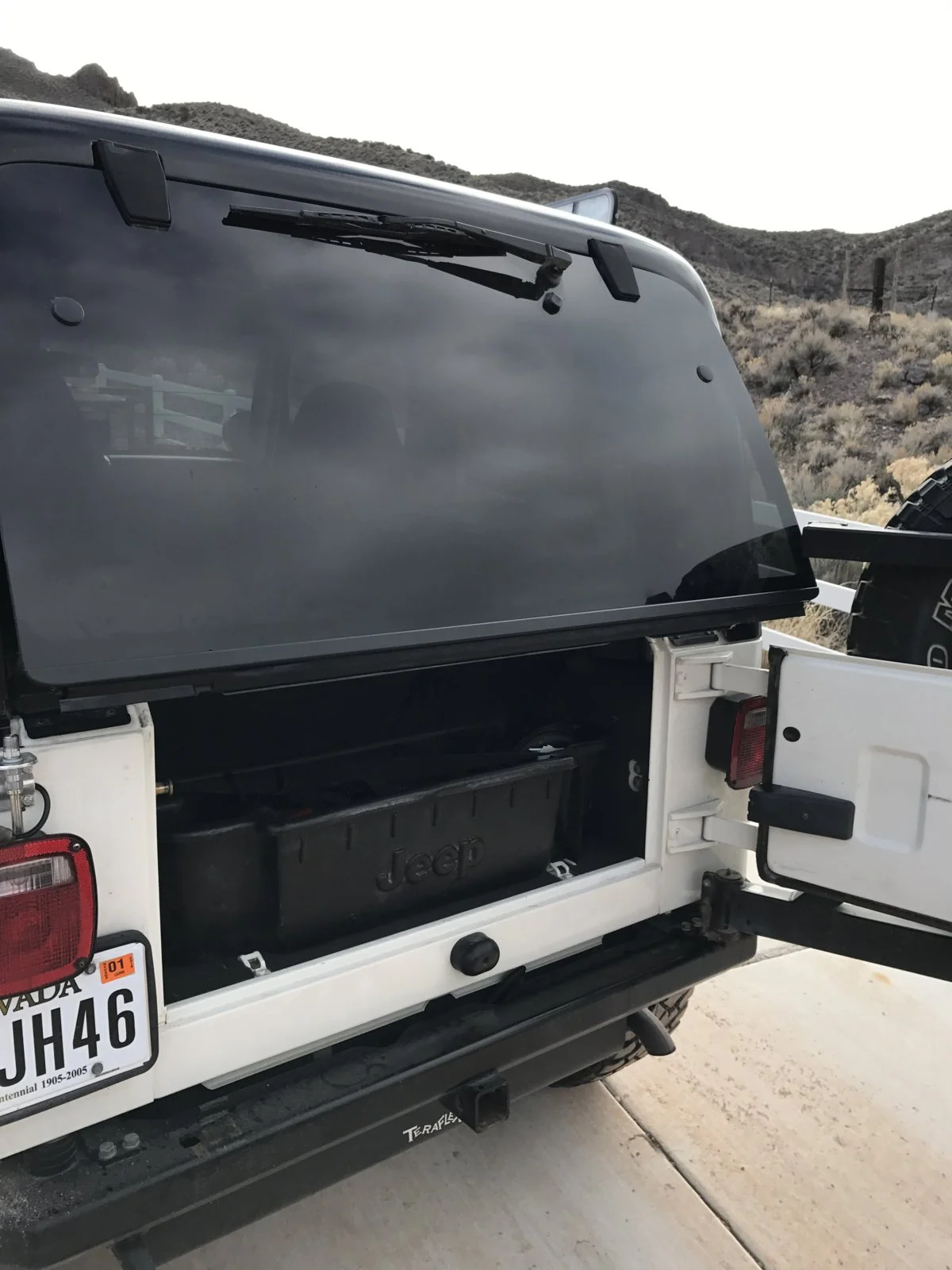

So I need to get a new rear bumper with a tire carrier. The current one is a Currie with a hi-jack mount on it. The problem is the frame on the tire carrier is not allowing the rear window to lift up in the new hardtop. I would like to buy a new front bumper as well What do you guys suggest?

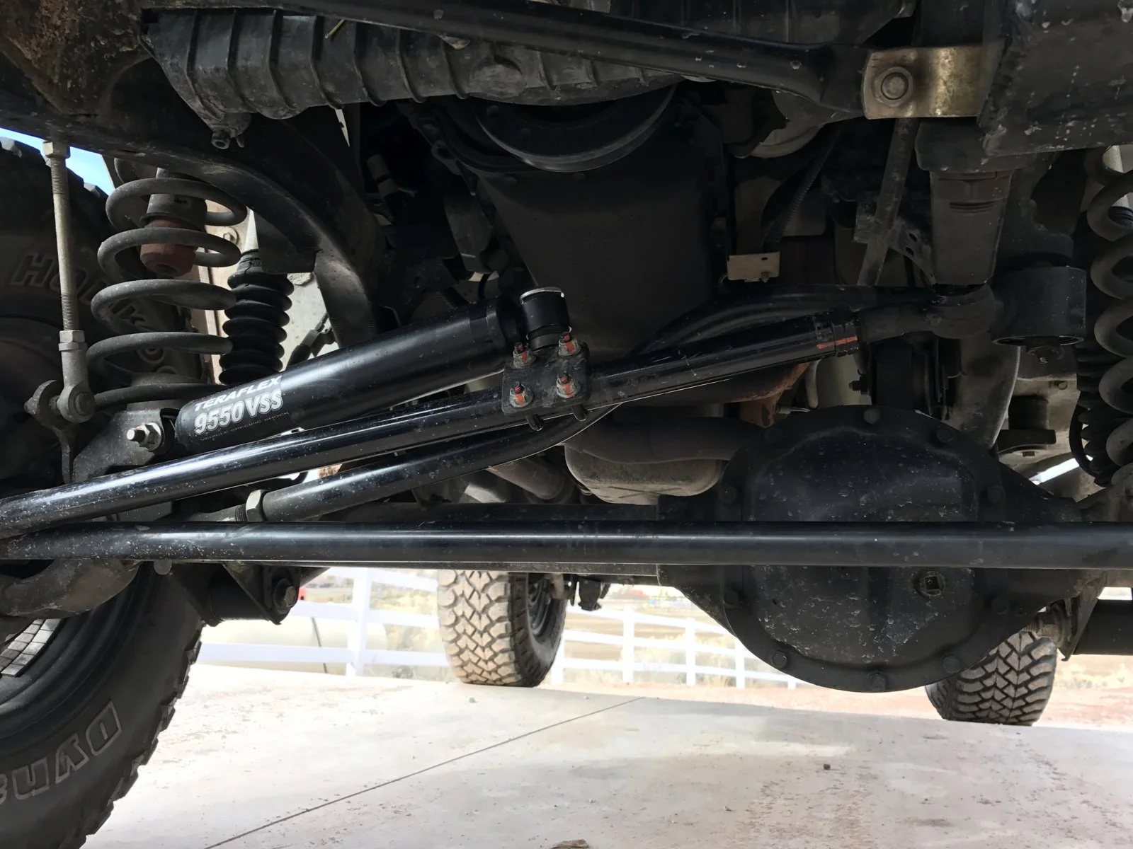

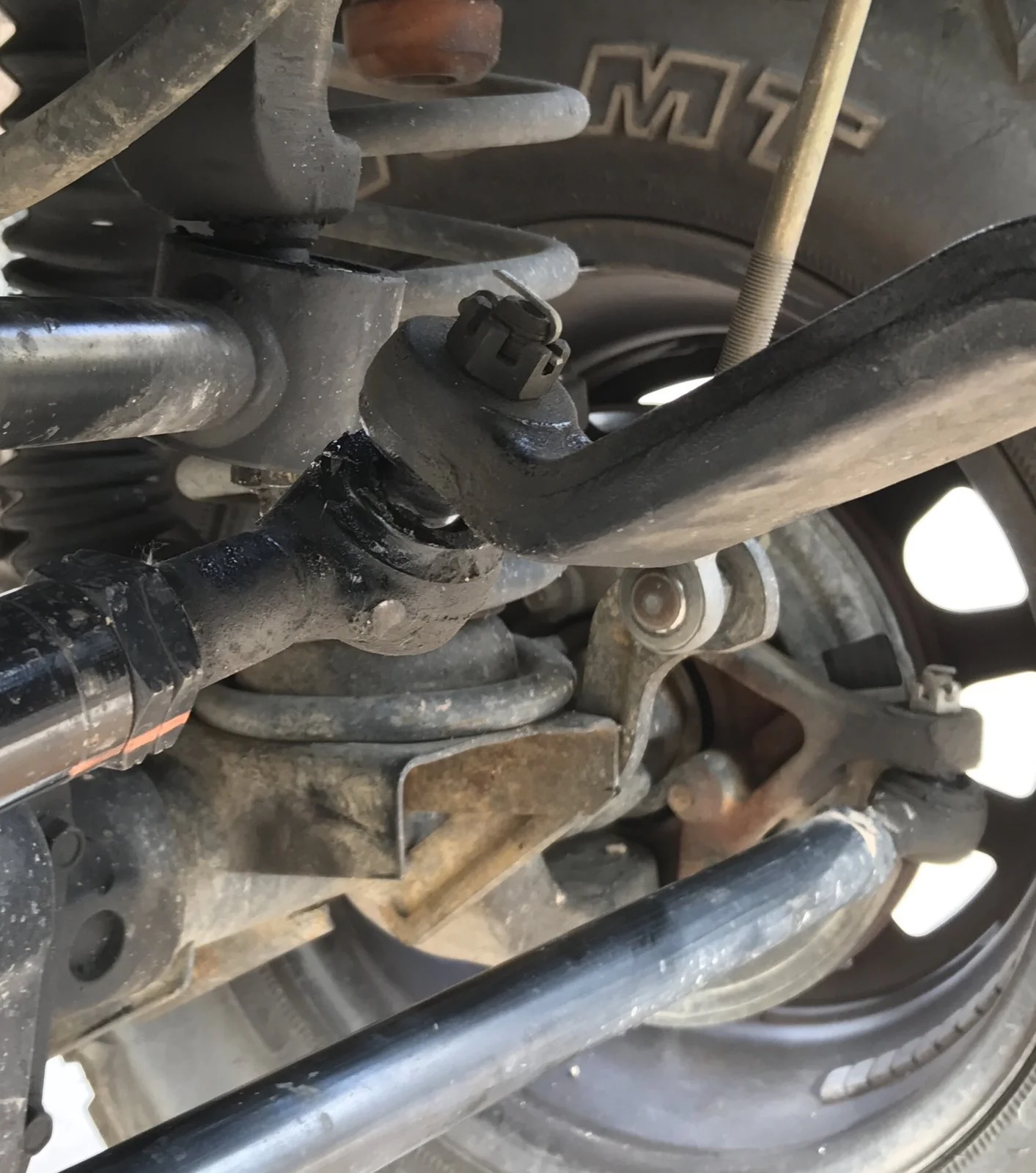

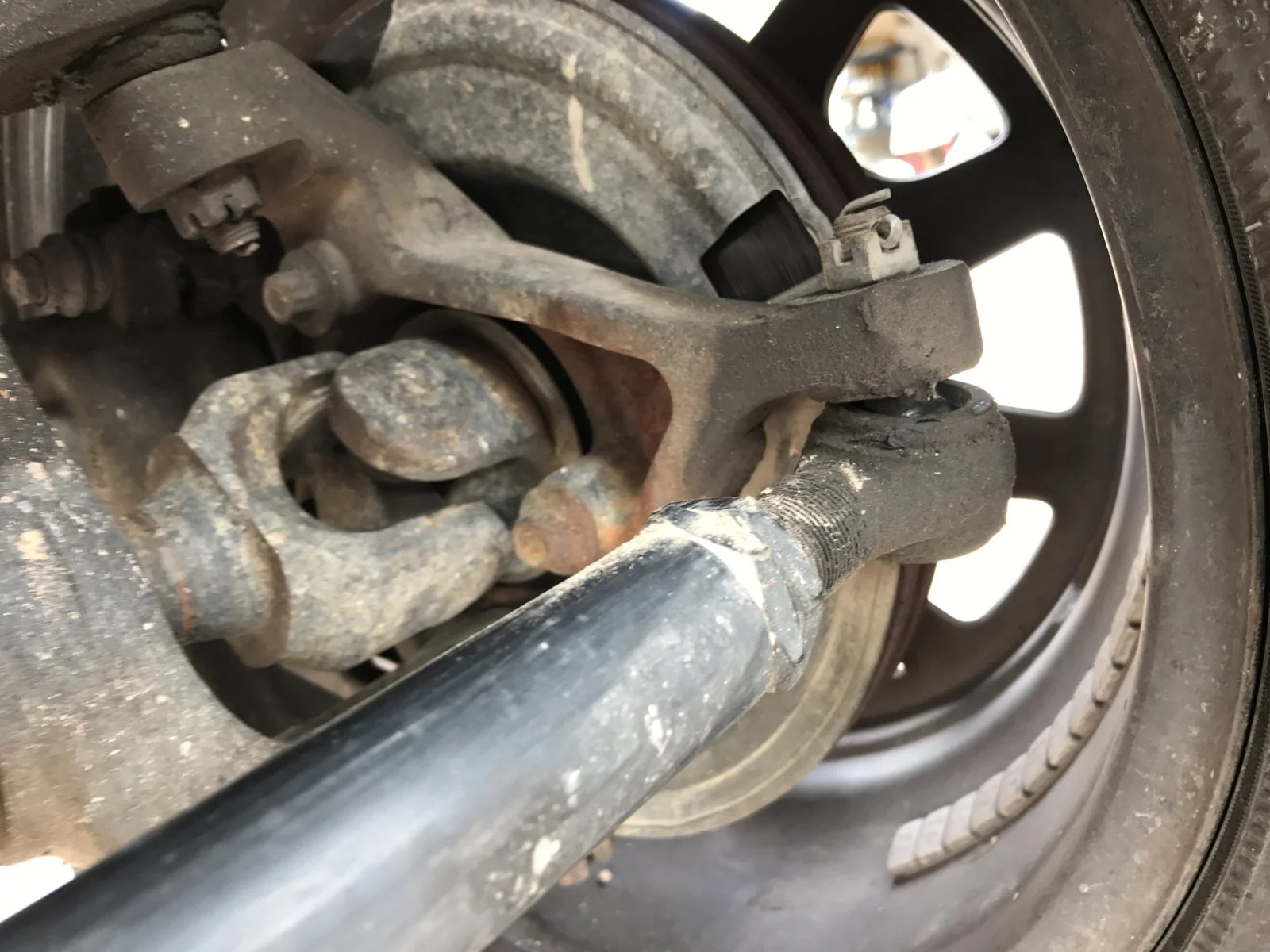

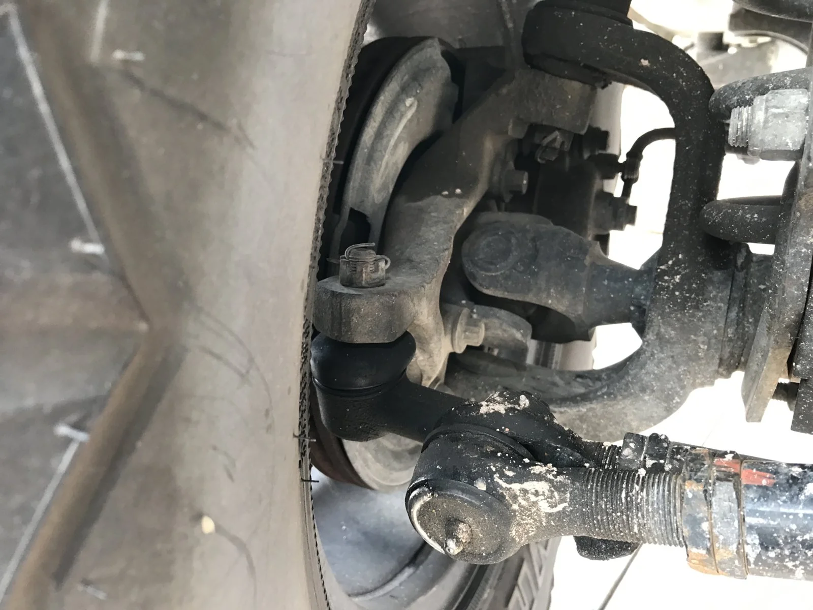

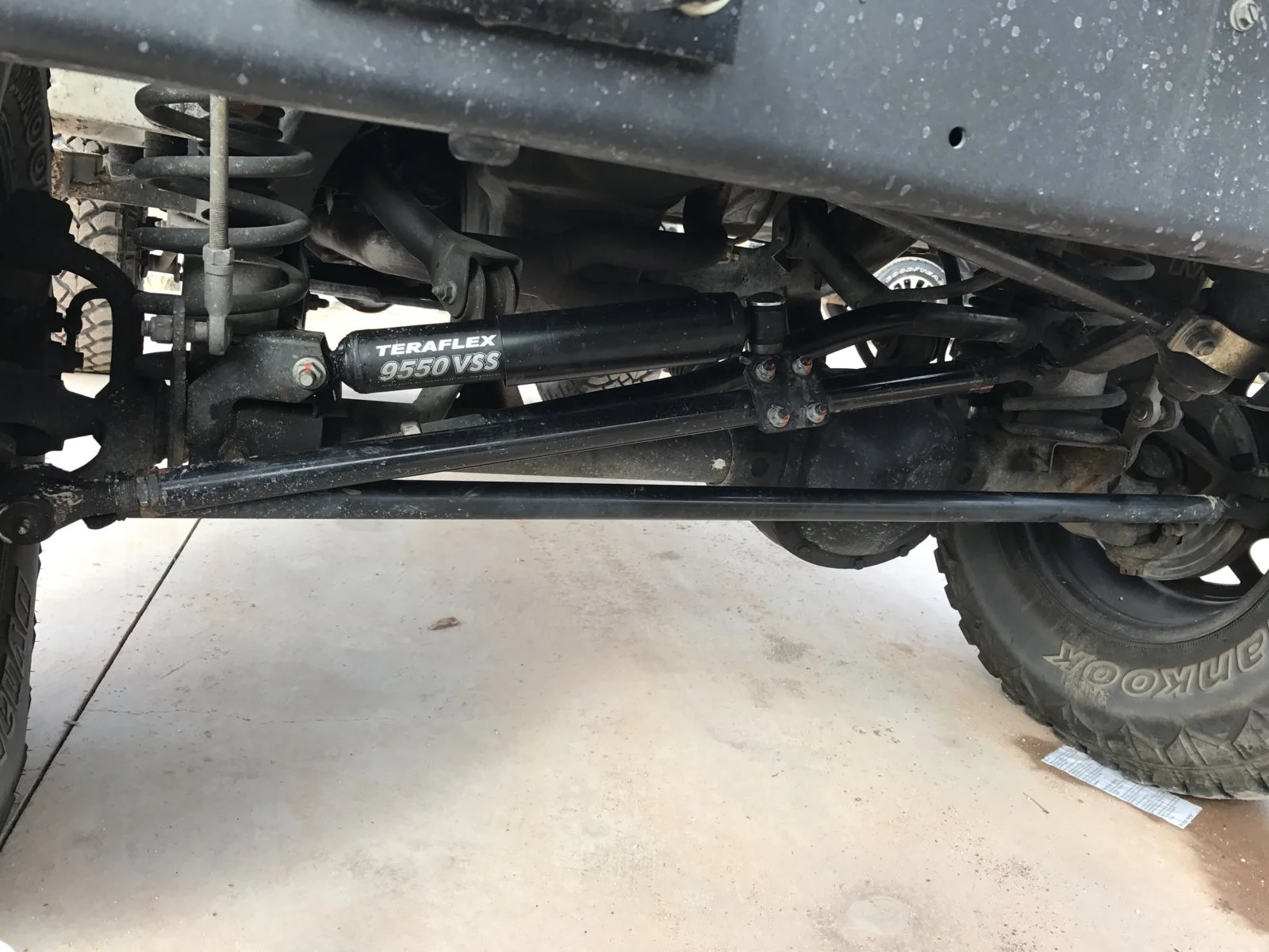

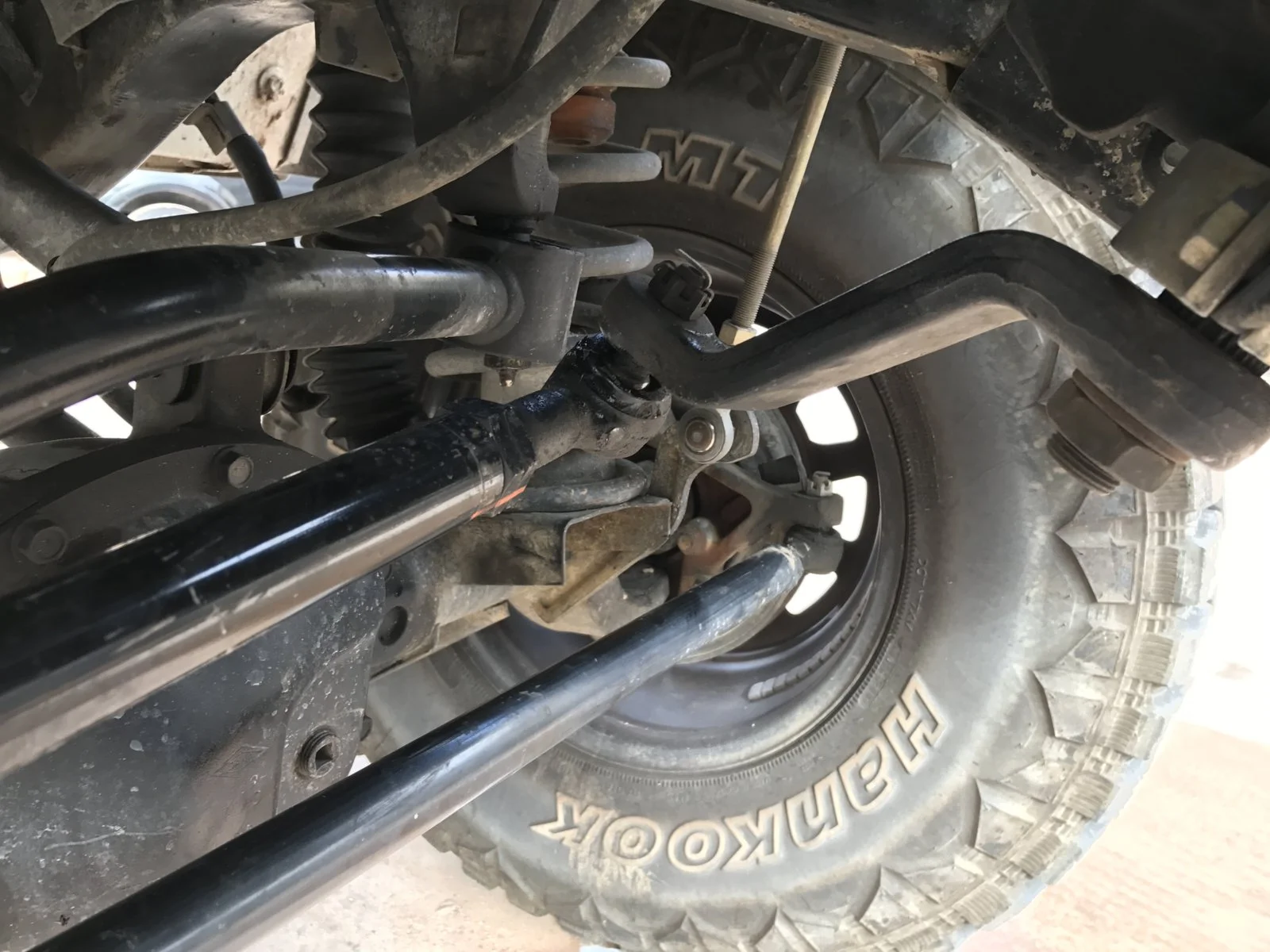

Next issue is the steering. So when I picked up the hardtop, I had drive a couple hours in the Jeep to get it. While cruising at 60-65mph, it was wandering all over the road. When I accelerated or let off the gas, it was really bad and left turns, super scary!!!

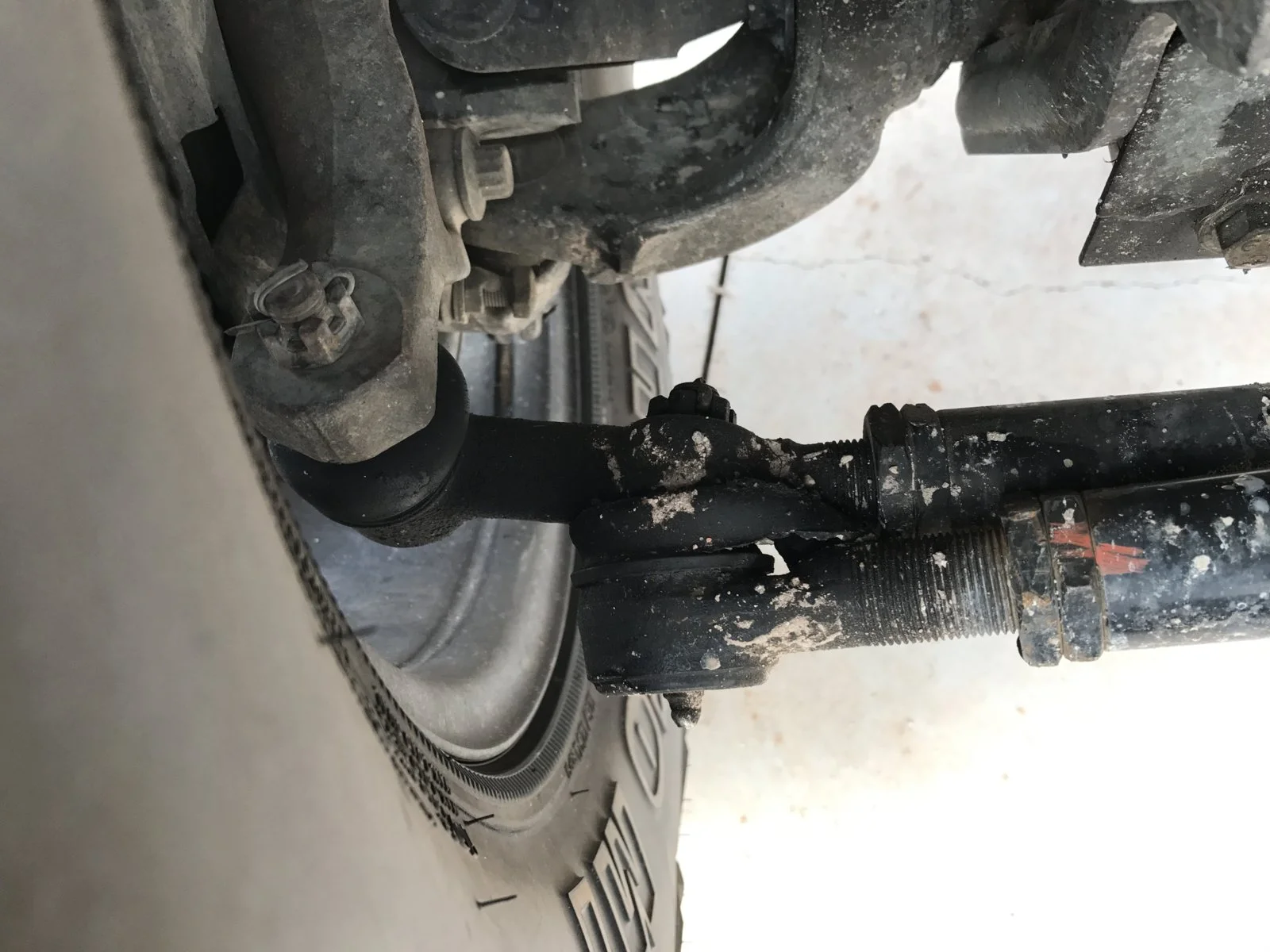

I checked the steering and everything appeara to be right. I found that one of the tie rod ends is missing the boot as well as one end of the drag link. I also noticed that the draglink and tierod are actually touching each when then wheels are straight.
I noticed that I have a long pitman arm. I read that this could cause some of my wandering steering at high speeds.
Take a look at pics I posted and let me know what you guys think. If there's a steering kit or bumpers you recommend please post up.
Okay, first things first... GET RID OF THE DROPPED PITMAN ARM! You are correct in your thought process, that is going to cause all sorts of issues. You can read more about it here: Should I install a dropped pitman arm?
Secondly, someone put an under the knuckle crossover steering on there. I would ditch that for either the stock steering, Crown HD steering kit (which is the stock steering, just with a beefier ZJ tie rod), or if you have the money and want the best of the best, get the Currie Currectlync (which I have and LOVE).
This is also a good post worth checking out with commentary from Blaine: What is the best steering system for my Jeep Wrangler TJ?
@mrblaine and @Jerry Bransford can tell you more about the negatives of crossover steering on a TJ than I can, but I would be willing to bet that your TJ being all over the road is probably a mixture of a lot of things such as incorrect alignment / toe-in (see here: how to align your Jeep Wrangler TJ), the dropped pitman arm, and possibly the crossover steering system as a whole.

To cut to the chase, or to be more blunt, your steering problem is caused by that Rube Goldberg steering system together with its dropped Pitman arm. Whoever recommended that steering kit be installed was either incompetent, inexperienced, or drunk. Sorry to be so blunt but steering systems like that never help do anything but cause problems. Despite the cool advertisements that make them sound like they're worthy of being placed on an altar and worshipped.
You'd be better off getting rid of that dropped Pitman arm and replacing your tie rod/drag link with Currie's Currectlync HD steering kit which will correct the geometry back to the way it should be for good steering. Not to mention Currie's steering kit is pretty much bulletproof and is what most experienced wheelers install and run.

Currie steering bought and on its way. What about pitman arm? What do you guys suggest?
You're going to love that Currie steering, just wait and see. It's so well designed!
The stock pitman arm. That's the one you need to work properly with the Currie steering.

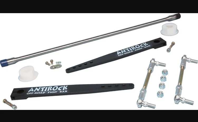

What's your guys opinion on aftermarket sway bar kits. I was looking at the Currie CE-9900 Antirock front sway bar kit.
The Currie Currectlync and stock pitman arm came in this week. I was hoping to install it this weekend but it's suppose to snow all weekend. We'll see....
That is undoubtedly the BEST sway bar solution you can get for these vehicles, hands down. So much better than the simple disconnects everyone runs.
I have the Currie Antirock myself and absolutely love it. Like I said, it is undisputedly the best solution for our TJs.
