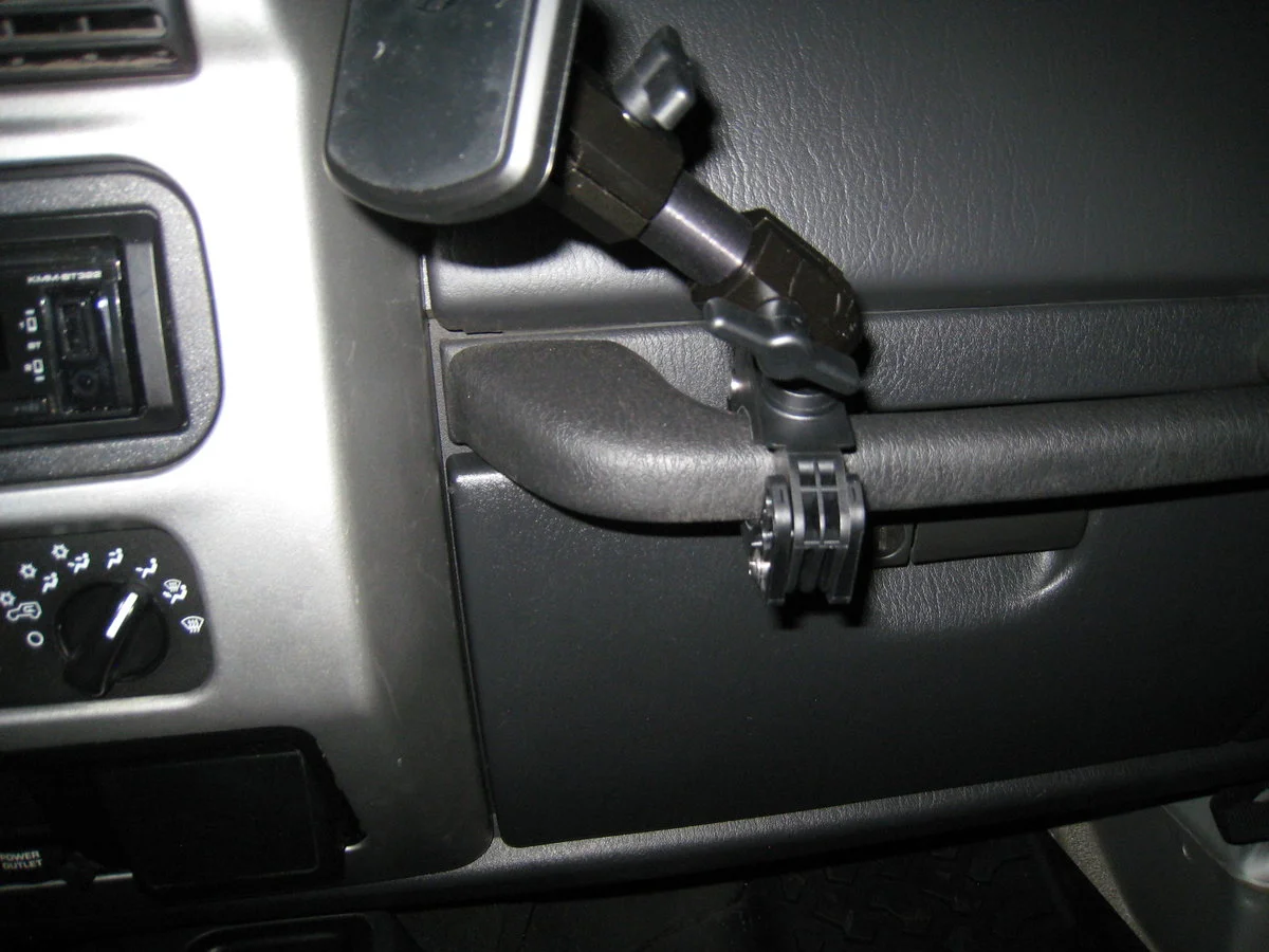

That long arm length sure makes me think it'd shake and move around too much on a rough bumpy trail. A friend has a short very rigid aluminum design that clamps to the glove box grab bar with no movement/bounce at all on bumpy trails. If I ever get a tablet that's how I'll mount mine.

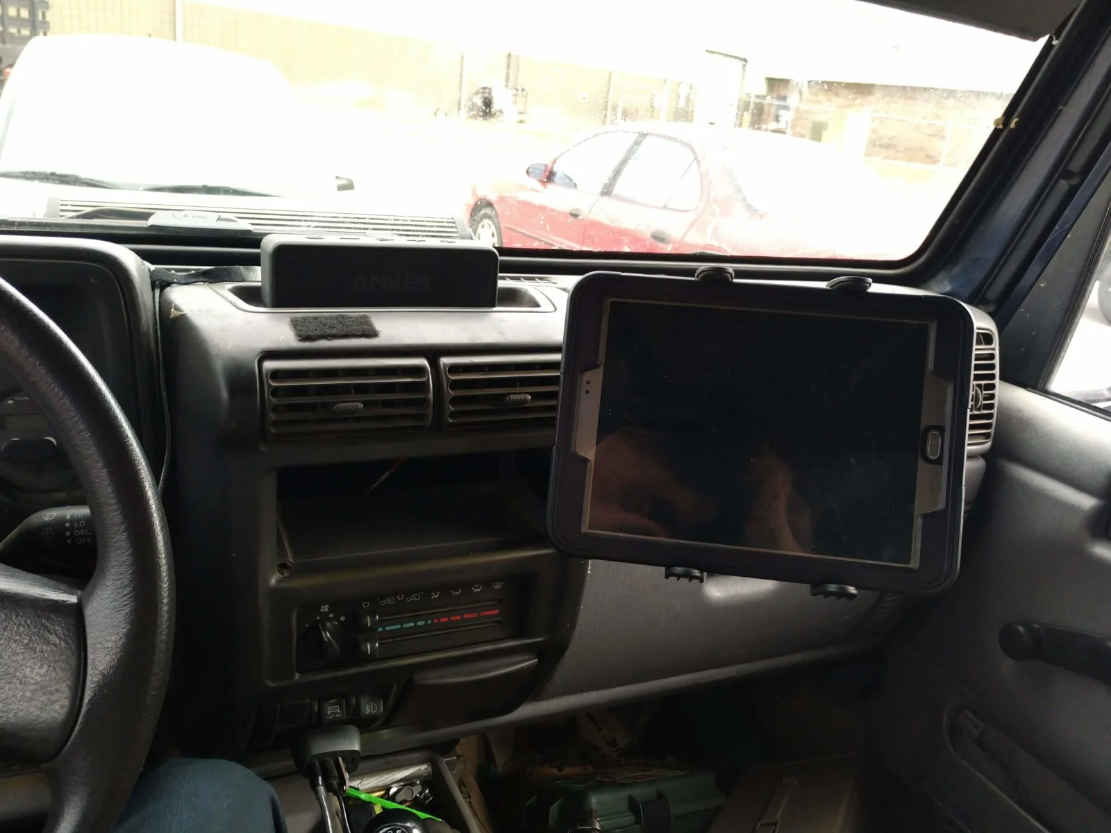

Right now I'm more worried about where the base plate is attached. I sticky taped it to the side of the center stack. That's much flimsier than expected. If the arm works as expected, I'll fab up a bracket to tie into the sheet metal under the dash. The mount itself is pretty stable. No movement on the street so far.
Picked up a tablet mount. I like it. I might add that I don't have a passenger airbag. It's the Takform one that we were talking about on here.

I've only driven with it for like 7 minutes. I installed it over my lunch break, but I used 3 screws in the opposite you did. I do like it quite a bit. I do think I'd like to get some different of these ball mounts for some other options. It was a hard choice between my truck and Jeep. Ultimately I'll probably get one for the truck and one for the gf car or something. I need to go off-road some, but when I'm off-road I go slow so it shouldn't be too bad.

I keep moving the base around to try different mount points. It seems to make a difference in how solid the mount is. I might even give them a call and order up some different arm lengths to play with. So far this is working out well.

Mine is still holding up, but I haven't tested it much. The mount feels strong, but where I mounted mine on the dash, it will vibrate and bounce a lot. I'm not sure what else to compare it to, because everything bounces and vibrates in the Jeep when off-road. On road I'm still just using my phone to navigate, which seems pretty good.

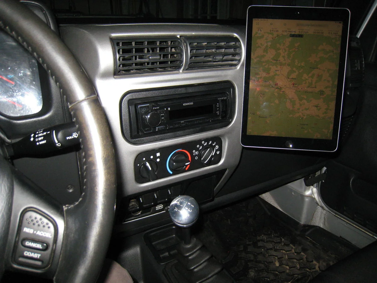

I think I would prefer where @StG58 mounted his, although it's hard to picture what it would look like.
It needs to mount to some place more substantial than I've got it mounted, but even as is, it's not horrible, just not a good long term solution. The mount itself is a well made unit. I've got more stuff to mount on my dash so I'll try to think of this more when I'm integrating my SP-9100 HD switches.
The double sided tape was a long term fail because of dust intrusion, but a set of small bolts and washers fixed the issue. Still works well. Minimal vibration. The mount is a keeper.

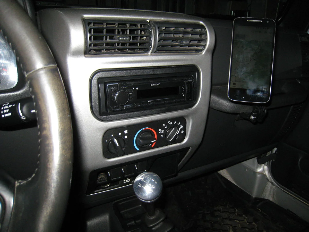

I wanted to follow up with what I went with: Schosche SBMM (Spin Bike Magic Mount). I didn't want to block the vents or head unit. If you rotate the clamp a little, the glove compartment still opens fine. It is blocking the passenger air bag, but I would only be using the mapping app at lower speeds on the trail. I haven't had it on rough roads yet, but the magnet seems very strong. In fact, I had to really pull on it to remove it from the mount. It comes with 2 metal plates, 1 smaller for a phone and a larger one that I used on the tablet. I already had a metal plate behind my phone's back cover and it worked great as-is.
