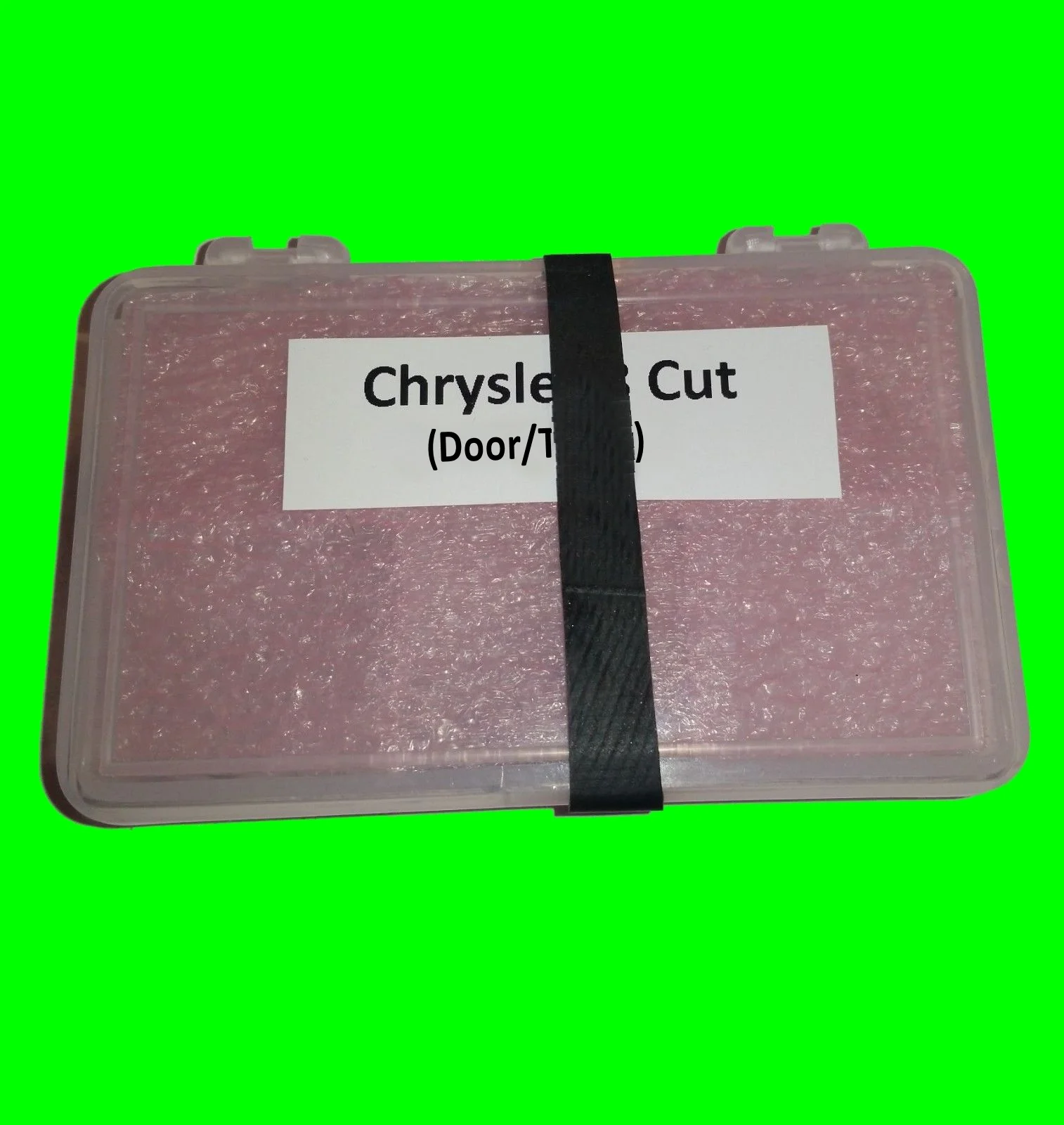

Well, thanks a lot. I saw some video of guys resetting they key cylinder to their key with new pin set (see picture)
However, it was quite expensive (60$CAD) so I called some locksmith and for 50$CAD one did it and it works like a charm.
Thanks guys. Finally something repaired that works perfectly once done.
