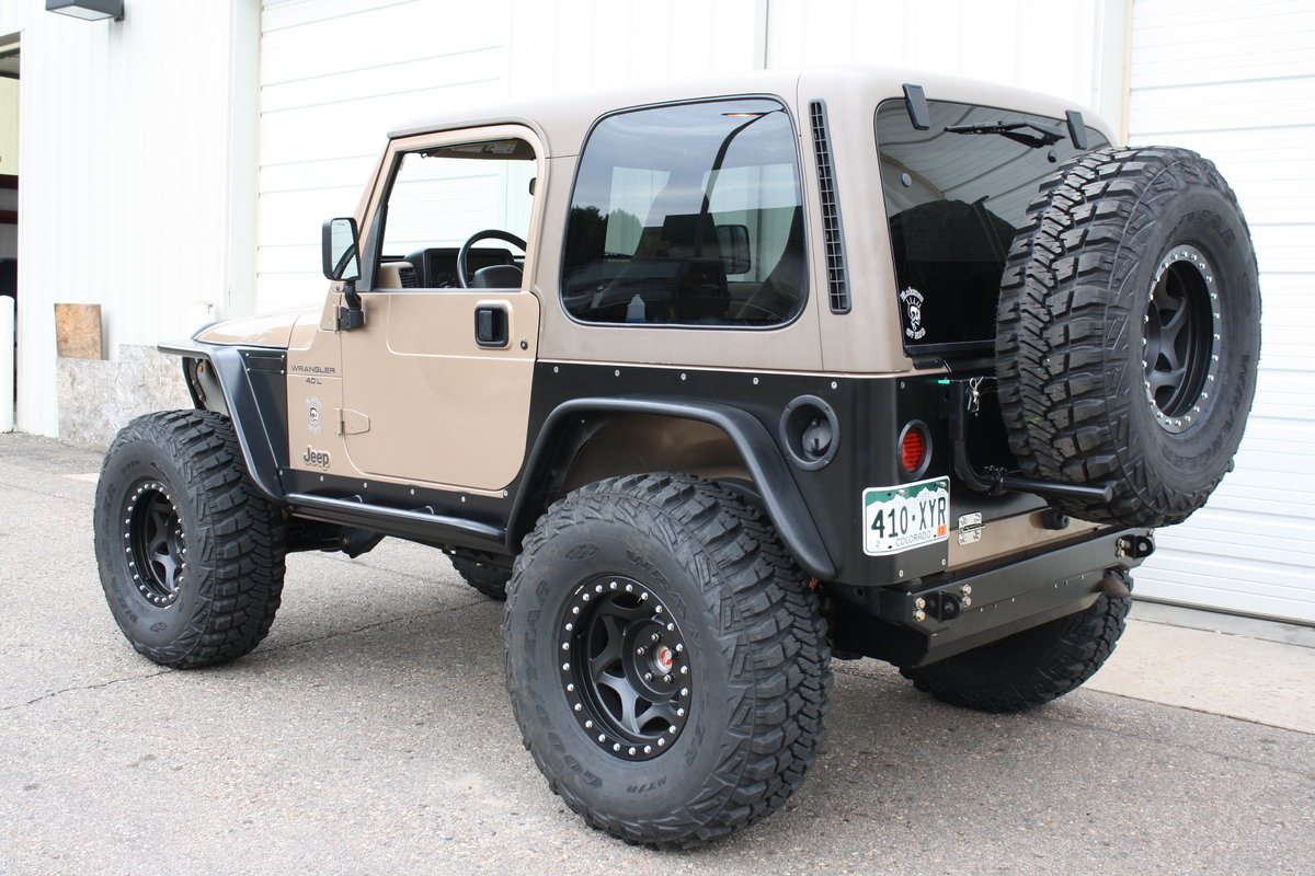

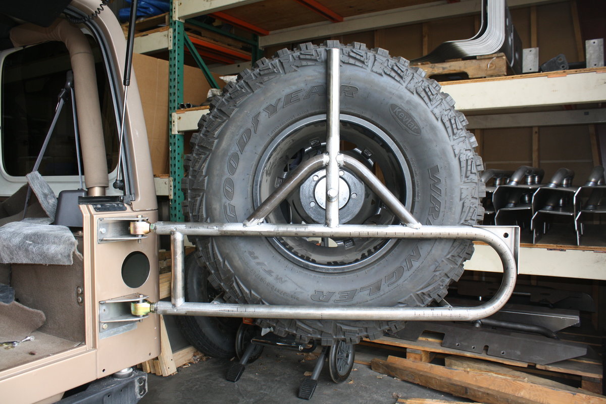

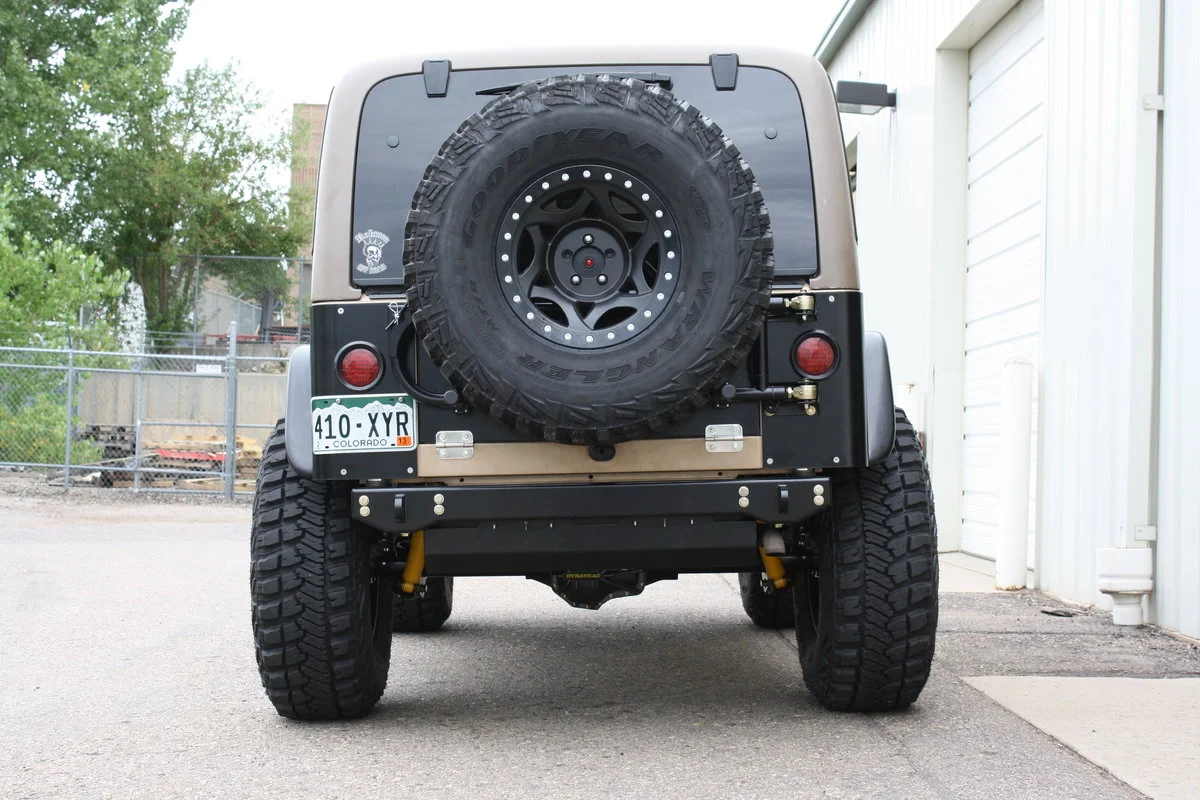

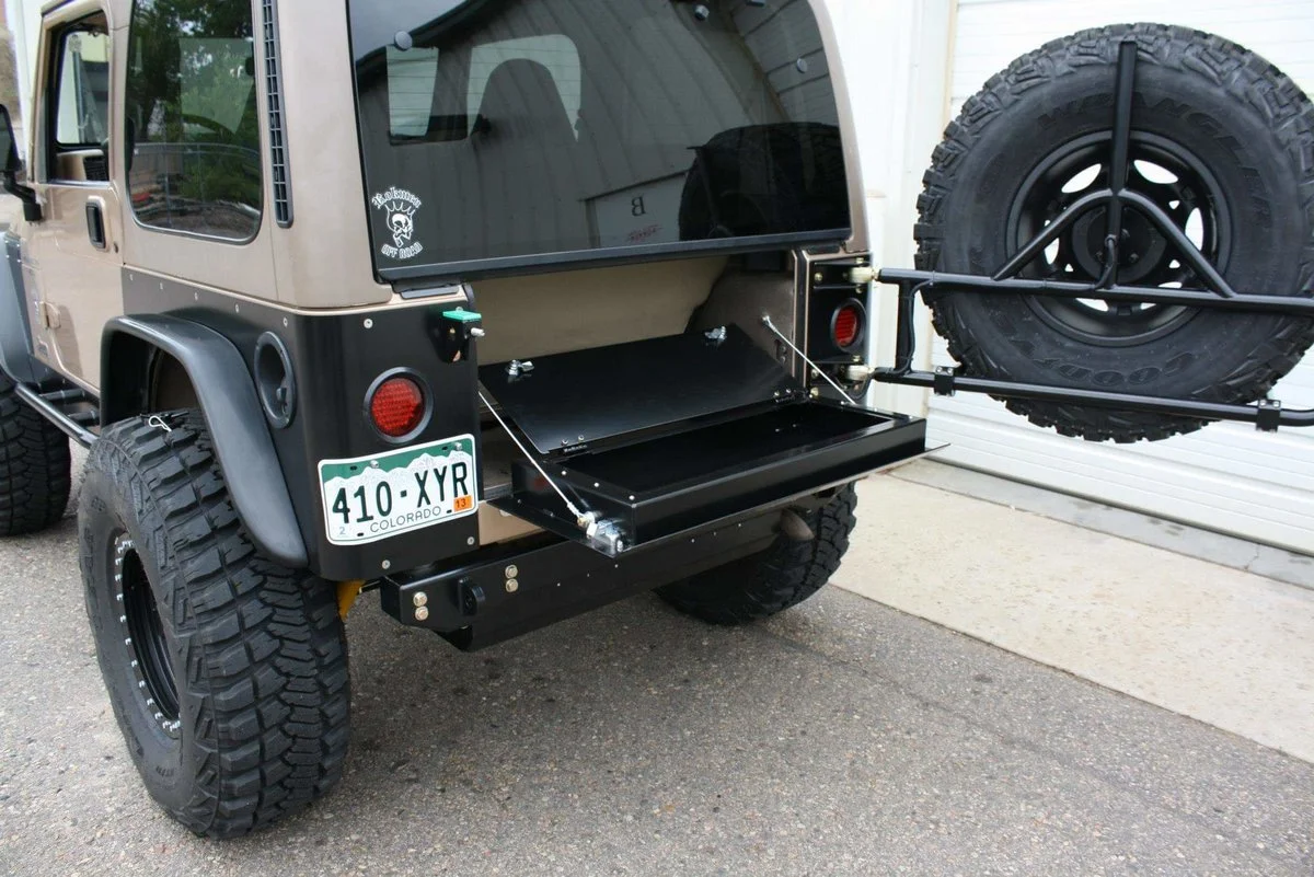

Looks like the MorRyde setup. Rebadged & with the price jacked up. I'd be surprised if you could carry a 37 on that. I have it on my Jeep & a 32 is sitting right on the bumper. You'd have to notch the bumper or something I imagine.
Reactions: MikekiM

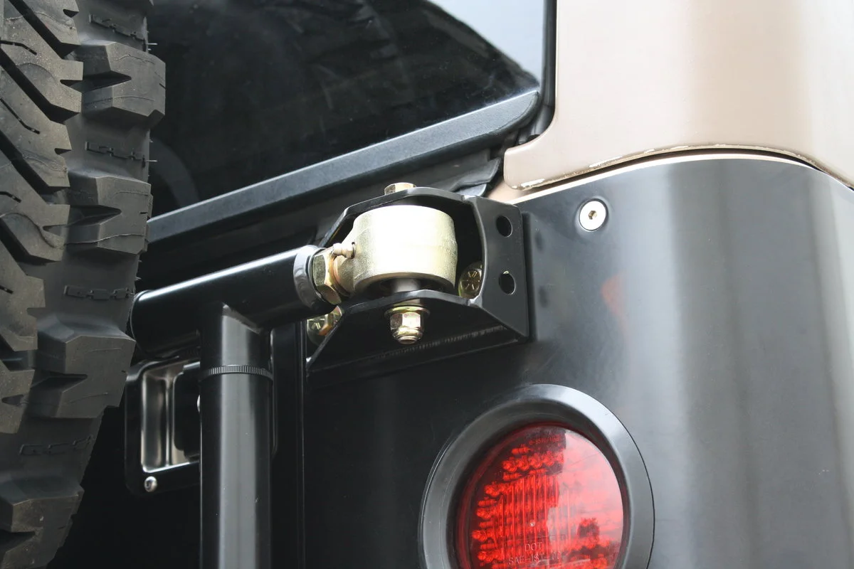

Rusty's is a poor copy of the ExoGate/MorRyde. For 37s, use a stronger tire mount and set it high enough to clear the bumper and also pull it into the tub as far as your can. Make sure the snubbers are doing their job.
I have been running a 35 on the Exogate carrier for 4+yrs with no issues. With plenty of room above the bumper. With a 37 I don't know. I don't plan on one though.

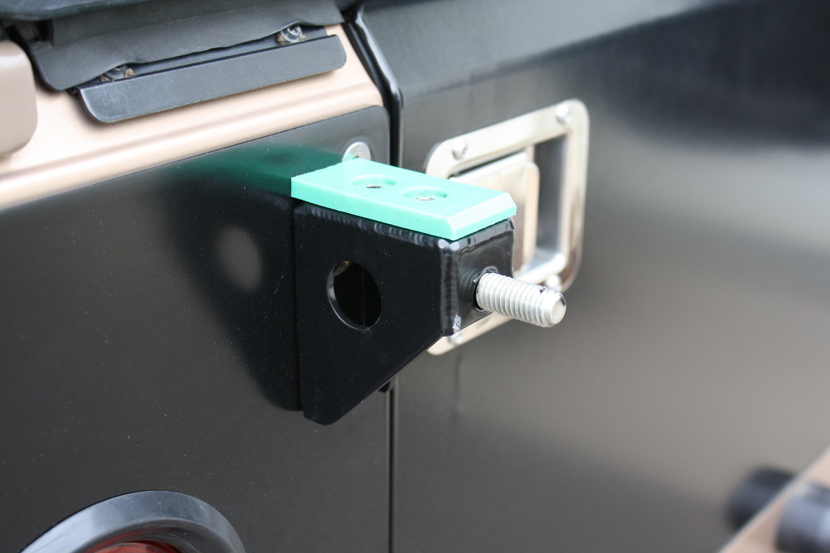

Personally I hate the look of the GR or PS bumper mounted carriers; but love the look of the body mounted ones; which can still realistically be manipulated with one hand. However at least with genright they recommend their aluminum corner armor plates (the ones that cover the body) to reinforce the mounting for the carrier.
The tailgate mounted ones will probably not hold up well with a 37 (a 35 would probably function in the long-term).
The swing-out bumper types tend to sag depending on the quality of the construction; look into the RockHard 4x4 rear setup if this is the route you want to go.
However, probably the best choice for holding a 37 would be from Genright or Posion Spyder with their swing out or swing down (bumper mounted) carriers. These are designed to carry up to a 42.

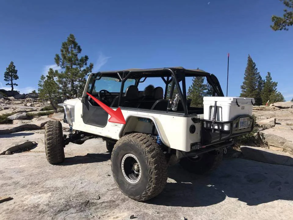

The options are endless. Not a tire carrier, its something a little different to show that you dont have to be cookie cutter with a tire carrier build. Build it to your specs.

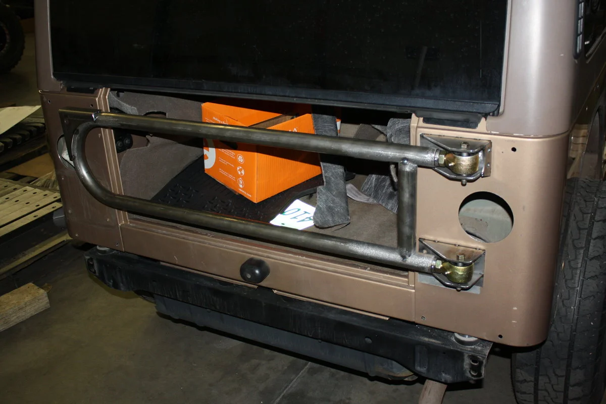

I've been thinking about making the move to a body mounted tire carrier lately. MORryde is definitely my fall back, but I cam across this one today.
http://crawlerconceptz.com/index.php/tj-body-mounted-tire-carrier.html
Didn't know if anyone has had any experience or thoughts on it? If it has all the tie in brackets, it could work well. All I want to carry on the back is a spare tire (33") a shovel, axe, and my trasharoo.
