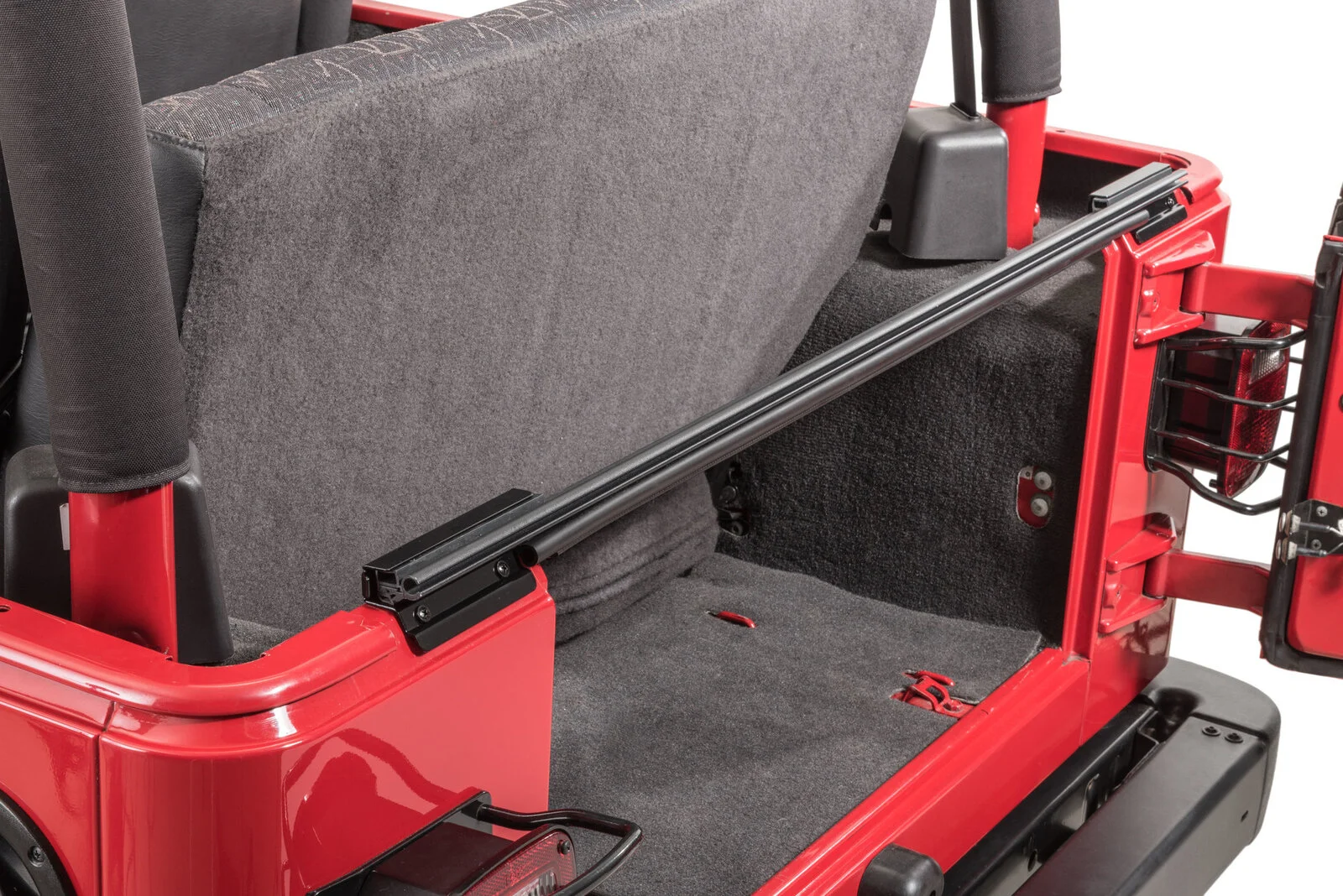

Did you order the tailgate bar (1 piece) or just some stick-on seal? Sounds like you need a new bar.
https://www.amazon.com/dp/B000VLF990/?tag=wranglerorg-20

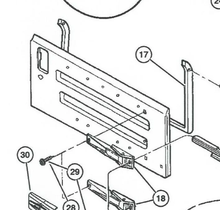

That's not the part I'm talking about. I'm talking about the rubber seal around the three sides of the actual tailgate. #17 in this diagram.
