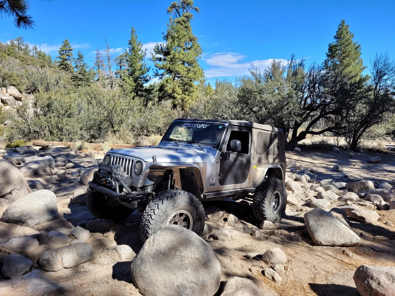

Mine is similar to your build, except I went with aftermarket axles. I have a Currie 60 rear, 44 front, 5.38. So not sure if the JL axles will be up to the task. Other than that, with the mid arm and 4" springs, there was a bit of trimming to do. I went with hi lines in the front.
I went with the 12.5" wide tires figuring I may already be pushing my luck with the Currie 44 in front. I was also having issues with losing a bead. The hi lines helped some, but ended up going with beadlocks.

Love your rig man! That is scary close to how I would like to set mine up. How's it do on city/highway with that setup?
