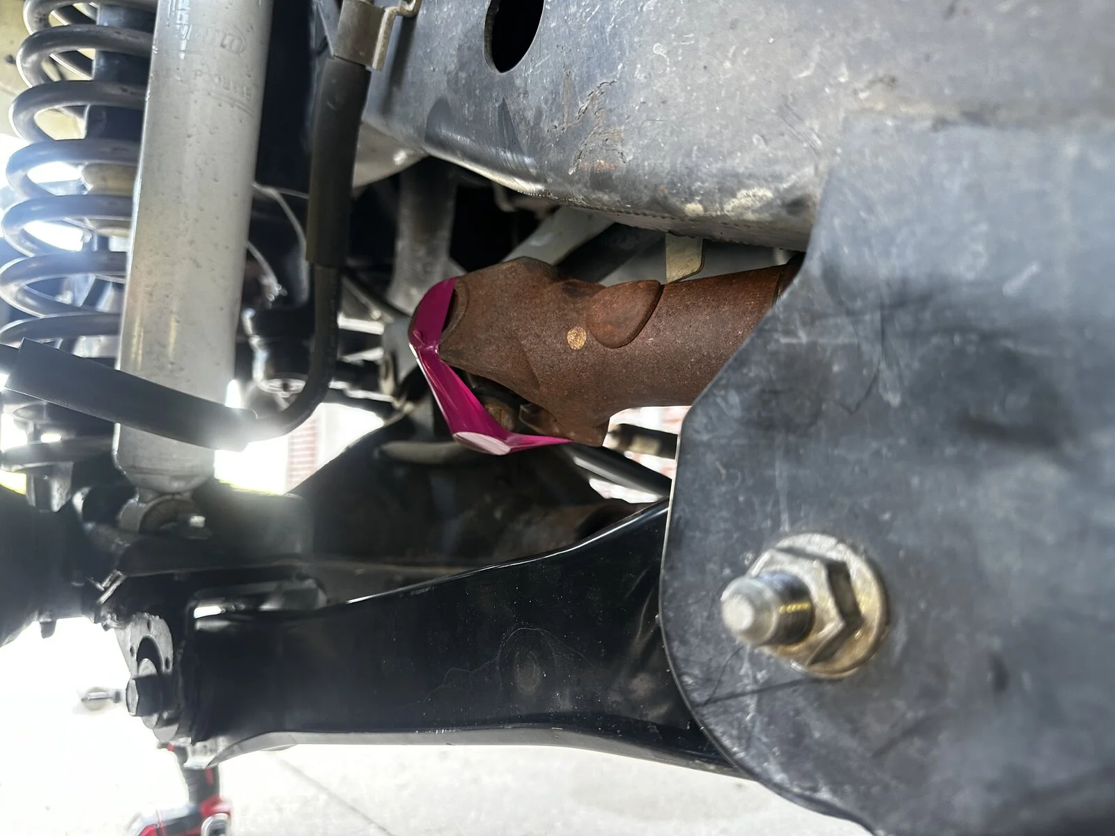

2000 TJ Sahara. My daughter had an encounter between the front left wheel and a concrete barrier. The other issues have been fixed but the front driveshaft got a small dent in it from contact with the exhaust. I’ve got a vibration above 55 mph regardless of engine speed, gear, or clutch state. New wheel and balanced tire and I feel it in the body/chassis, not the steering wheel.
I’d like to disconnect the front driveshaft temporarily. Assuming I keep it in 2wd is it safe to just disconnect at the differential yoke a strap the shaft up to the frame (or something)? It sure would be a lot easier to just do that vs. take off the rear to remove the whole shaft.

If you suspect the front shaft is the cause of the vibration due to damage, I'd just remove the whole thing. It's not that much more work.
Success! Sorry, I’m very mechanically inclined and this is my third TJ but I really didn’t want to overlook some mundane detail (obligatory Office Space reference). I ran her up to 70 mph with no vibrations. I’ll remove it completely now and get a new driveshaft.
To answer some other questions. Yes, she bent the control arm and mangled an axle bracket. I had my son (2 semester community college pipe welder) cut off and weld on a new bracket. I replaced the control arm with a fresh Chinesium knock off and it’s been driving great except for the vibration. The vibration was the last remaining known issue.

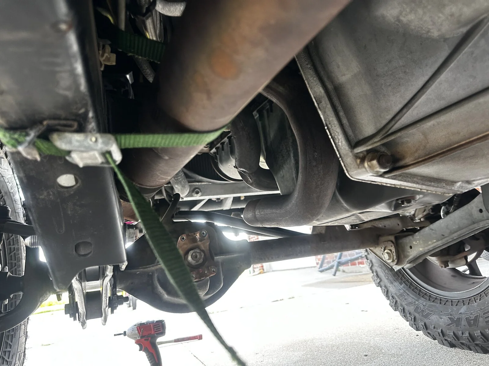

Have to drop the front drive shaft to get at the upper nut on the Cable Transfer Case linkage bracket. Do you pull the small hex head bolts to disconnect the shaft. Looks like that will leave the Cardan universal hanging free and possibly fall out. If that's the case should I take precautions to keep the u-joint from falling apart like taping it??
Yes, I taped the bearing caps on with purple electrical tape in the above photo. It went fine. I’ll proceed with removing the whole shaft now.
