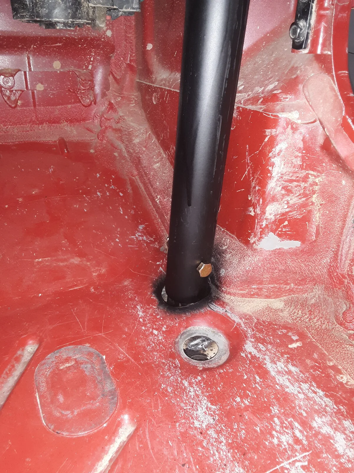

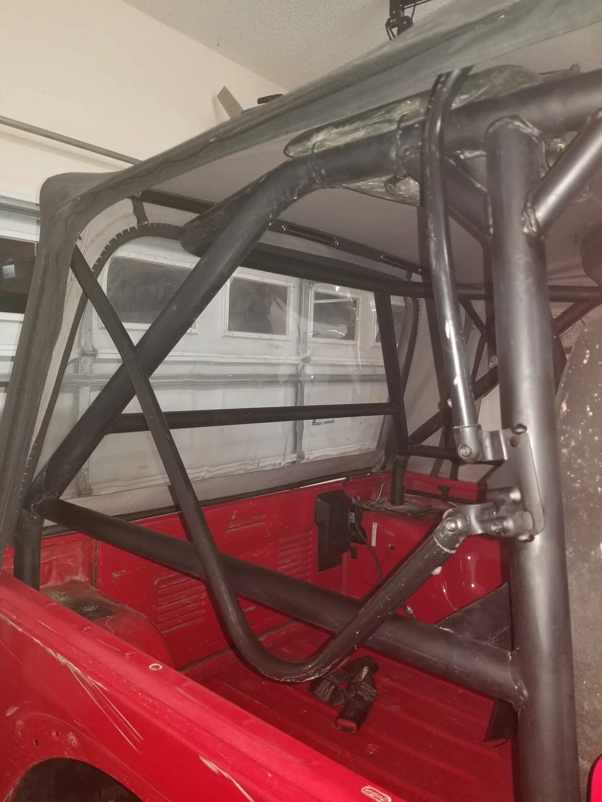

Pretty much got the cage finished. Now I am just waiting on PRP seats that I ordered back in October and they are now saying won't be shipped to Jan.

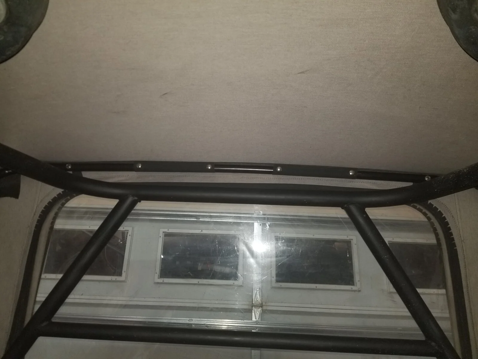

I like the way my A pilar's tied in.

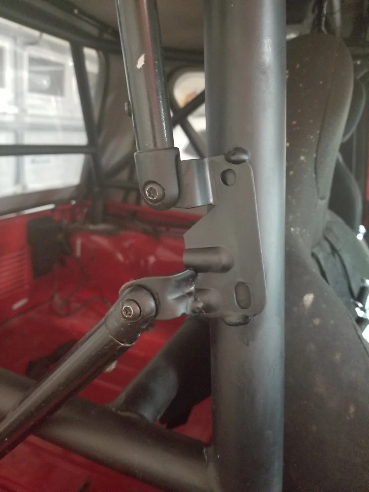

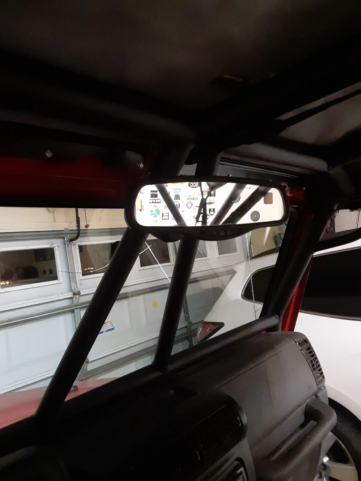

And I added a little plate to mount my mirror.

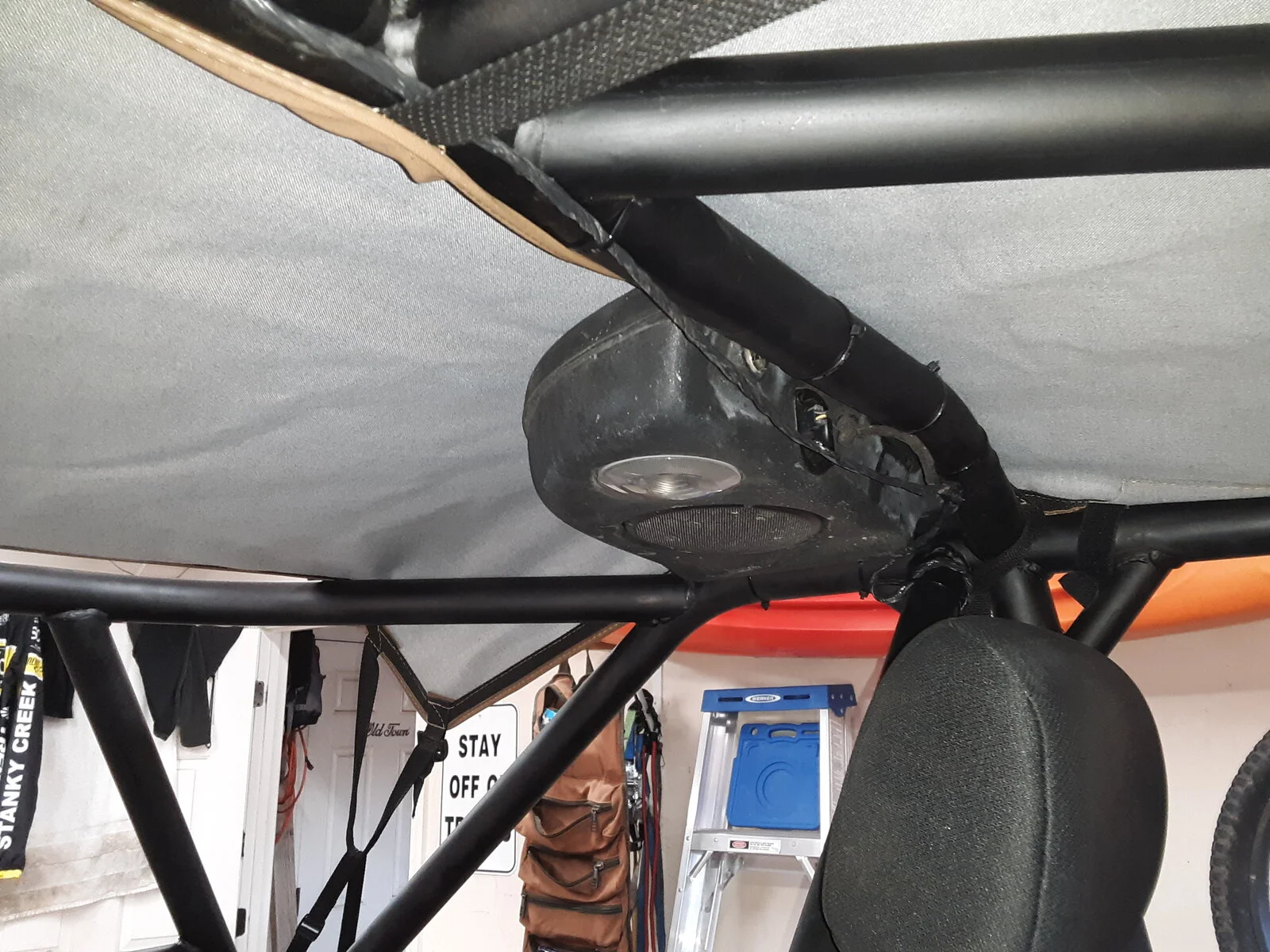

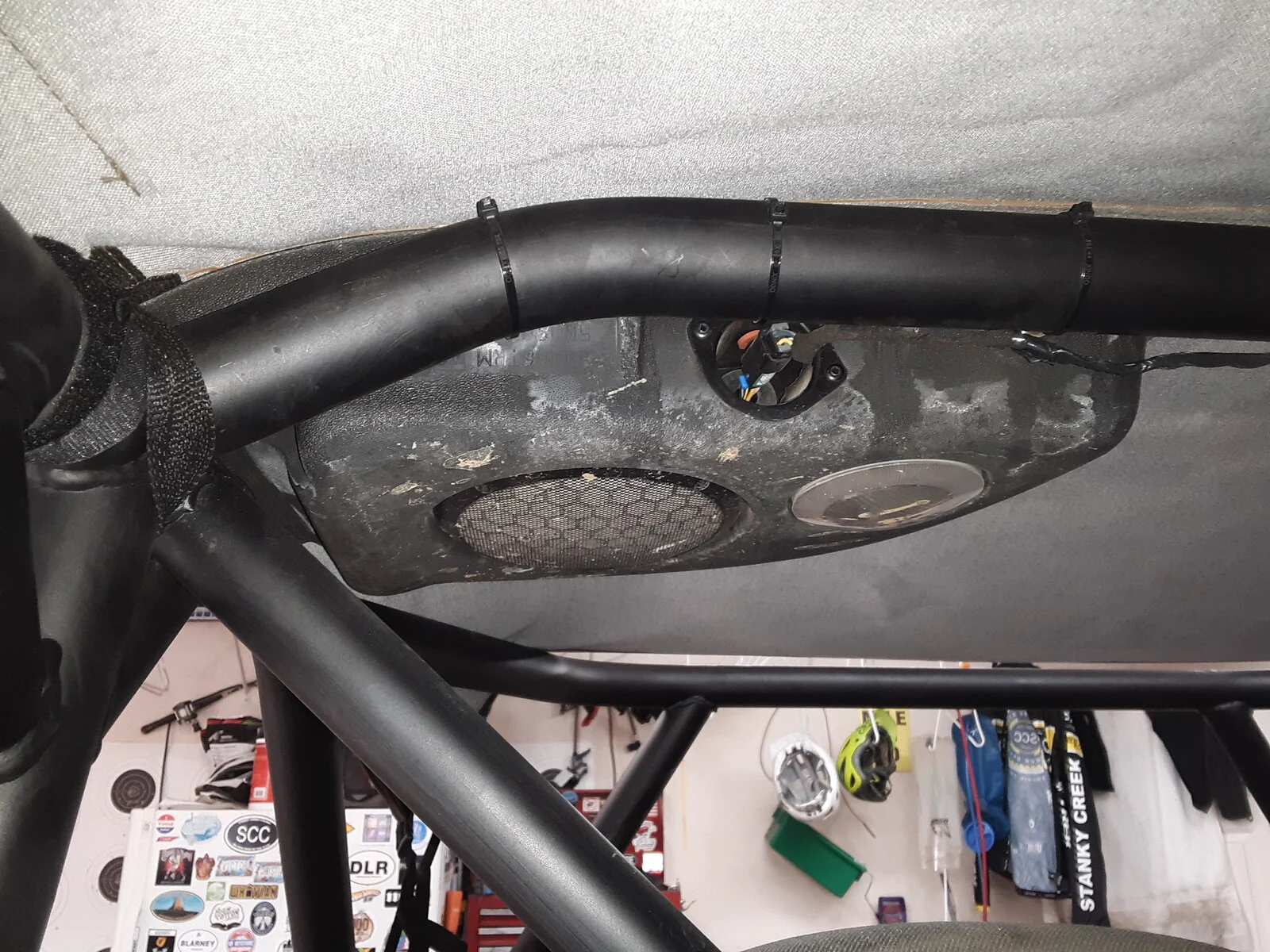

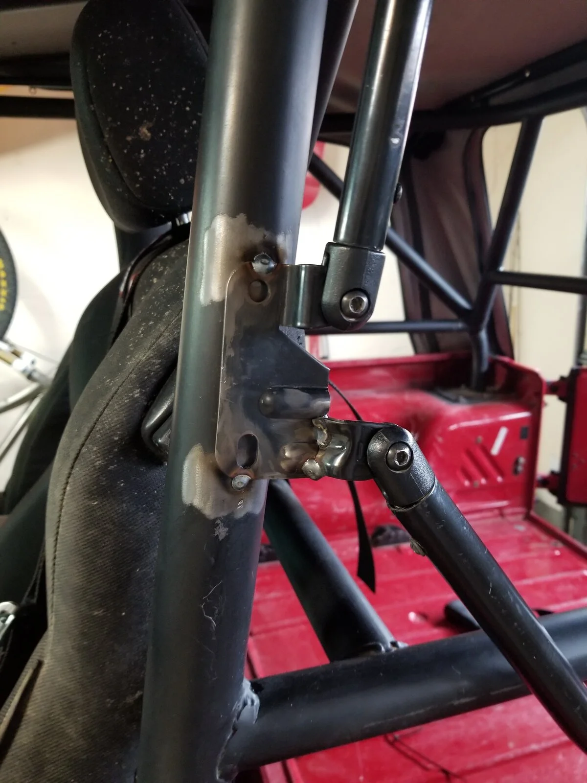

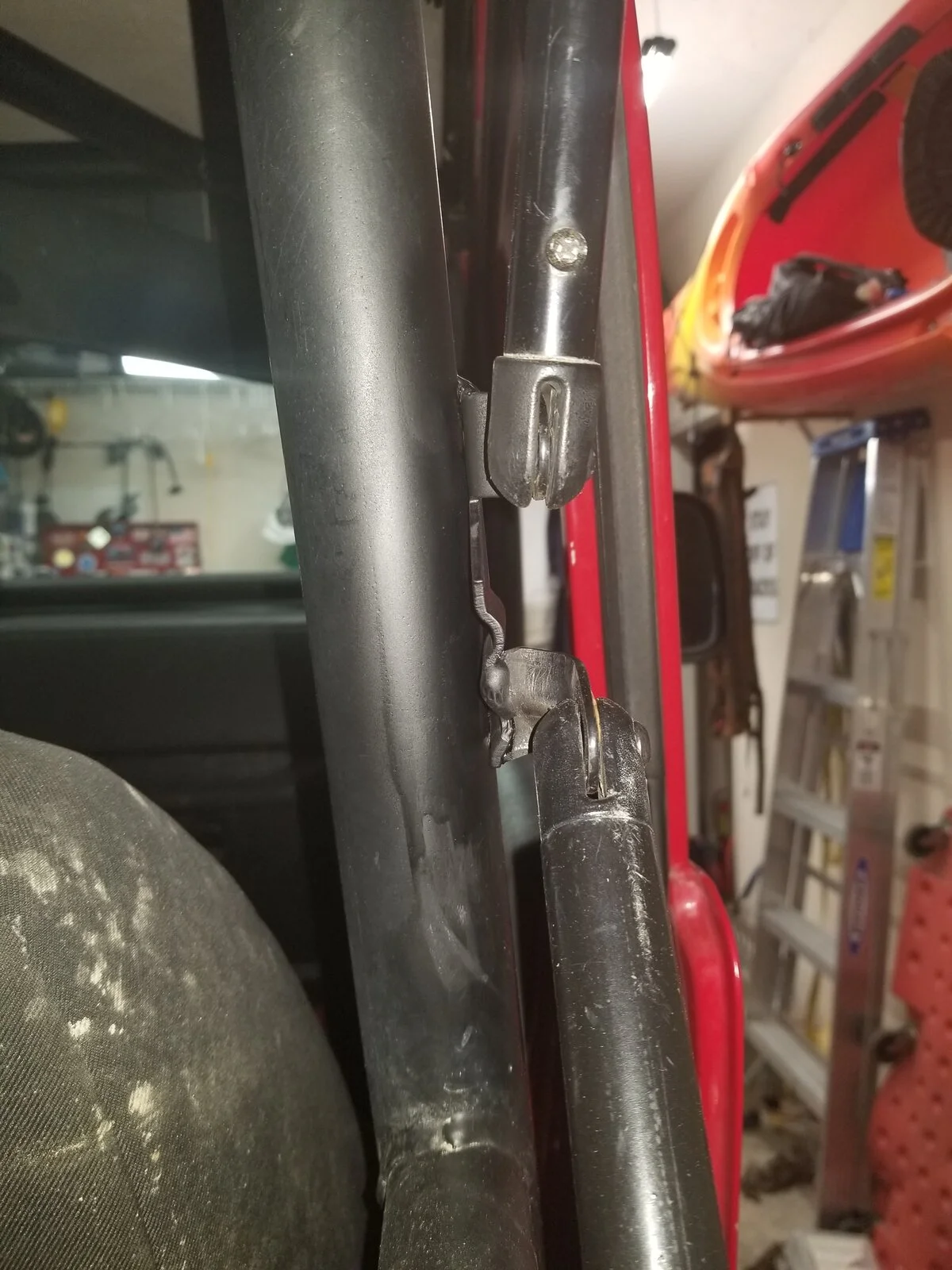

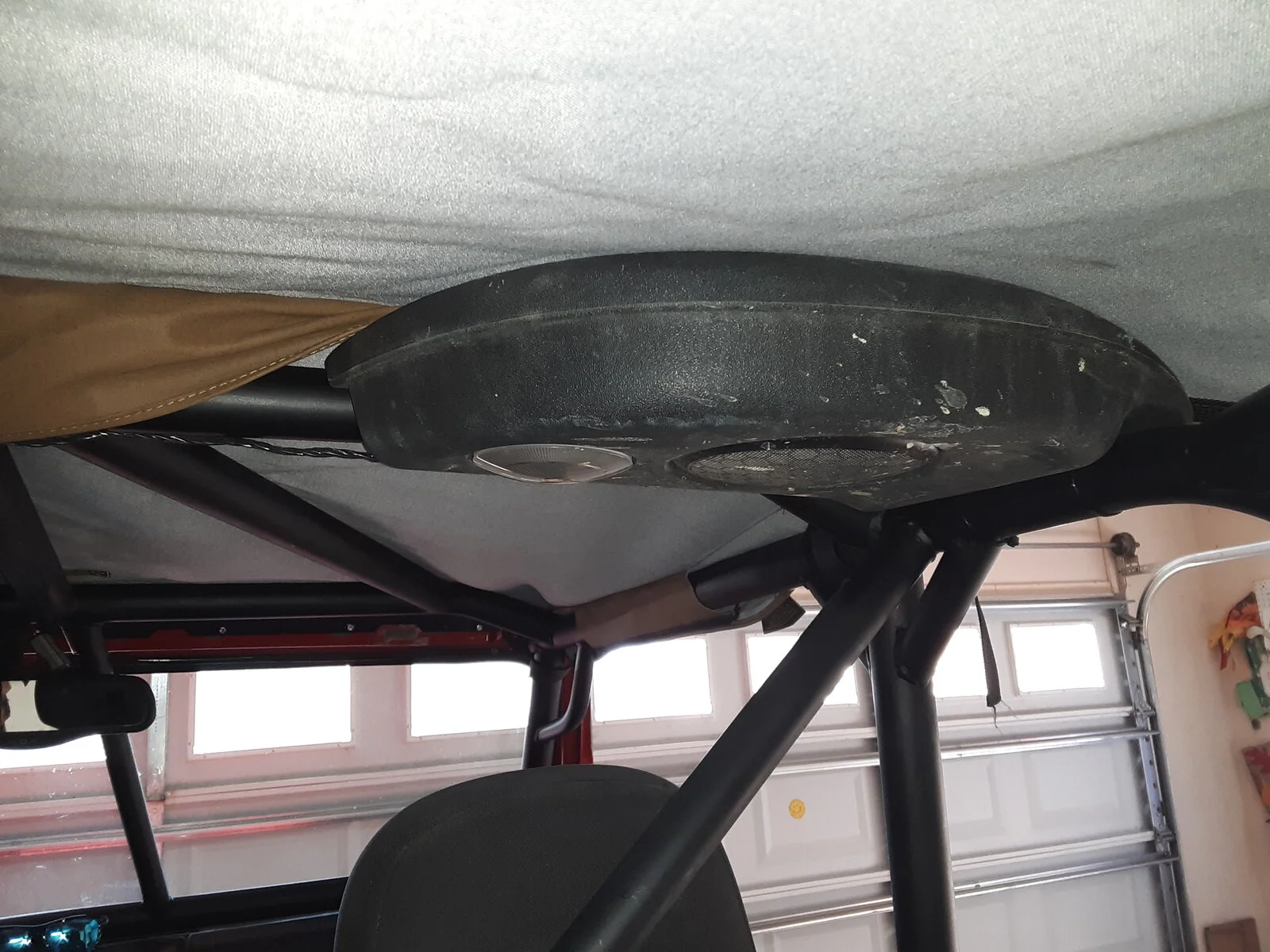

@mattcogdell I got a call last night from a friend about going wheeling this weekend, so I quickly came up with a solution to install the sound pods (I like some tunes when I am wheeling, also the overhead lights come in handy sometimes). anyway with slight modification I was able to get the stock sound pods installed using zip ties. In the future I may drill and tap the tubes to install them permanently, but then again I may just leave them zip tied. Sorry for the not so great pics, I also threw the safari top on in case it rains this weekend.
Anyway, definitely going to be able to use the OEM sound pods. I am not going back with OEM seat belts but I believe it would not be too hard to install them with the kits that are readily available.

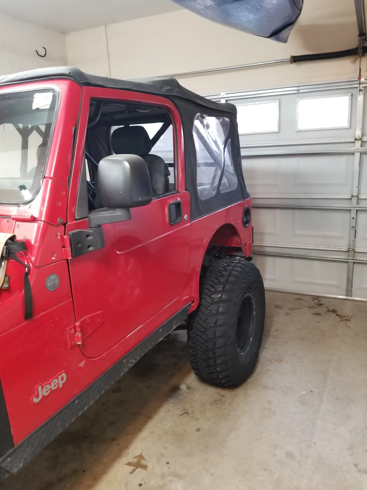

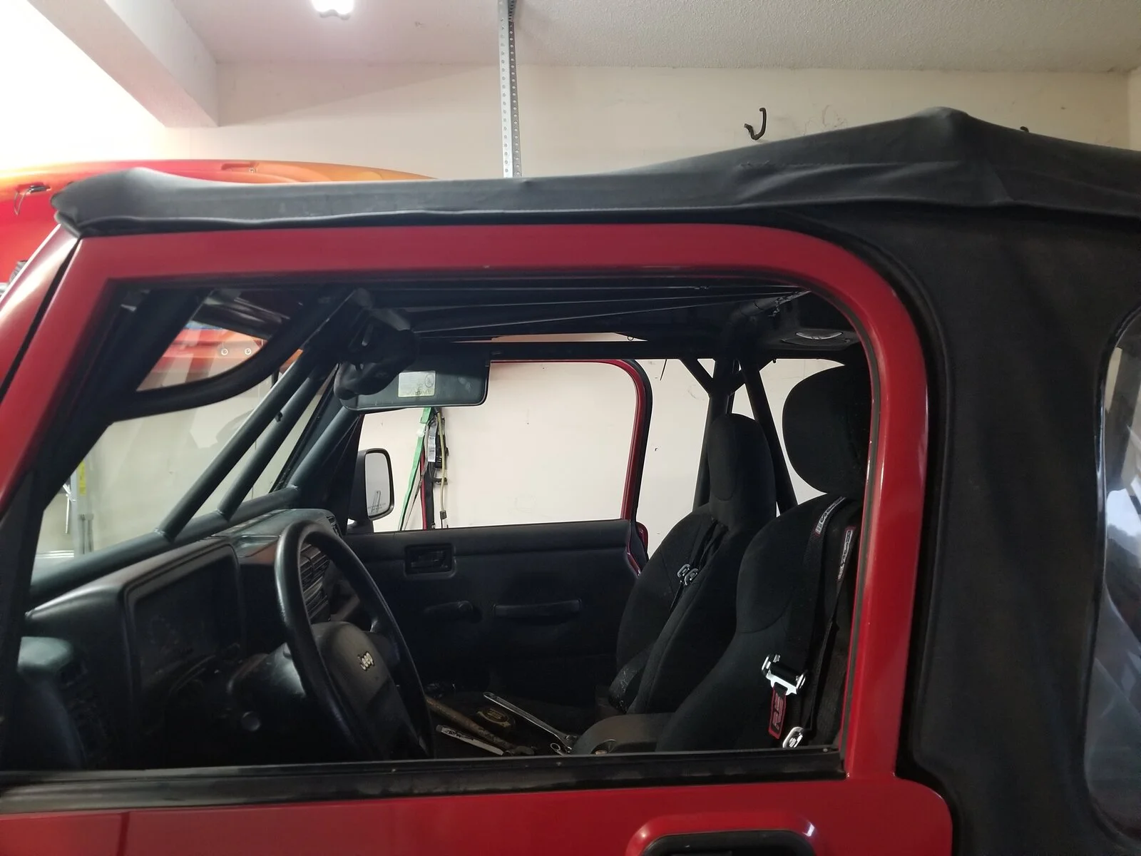

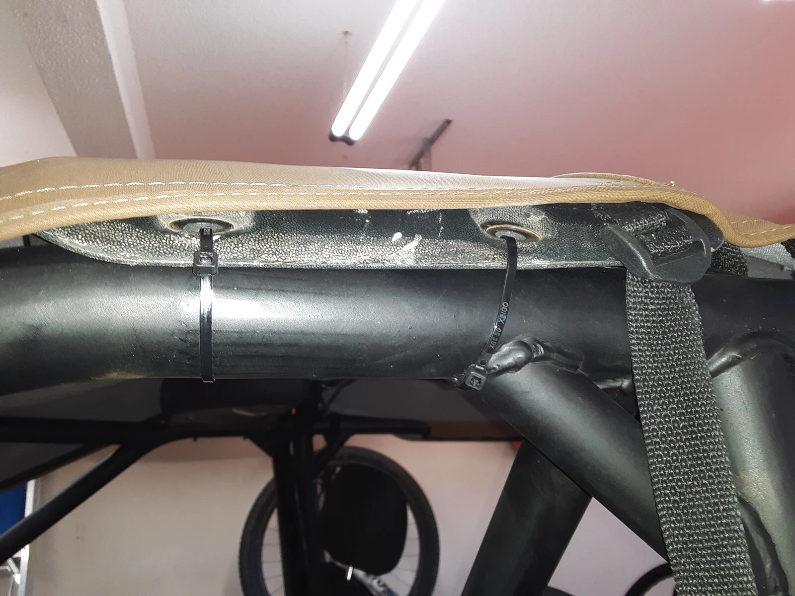

I was originally not planning on installing a top after installing the roll cage. However, after wheeling in the rain and 35 deg this past Sunday, I have changed my mind. Installing a top is not so much for me, but for my passengers.
I knew that any type of trektop or top that rode against the factory roll bar would not work with the new cage, but that a factory type top that uses bows may work. I still had the bows, header, and door surrounds from the factory soft top and I found a used bestop replace a top on craigslist.
I modified the rear bow and the bow brackets to allow for the bow to clear the new roll cage.
I had to modify the upper part of the door surrounds to allow for them to fit. I just trimmed off the flanges that surround the roll bar, haven't figure out how to permanently attach them yet, right now I just have zip ties. The top is on and good and tight.

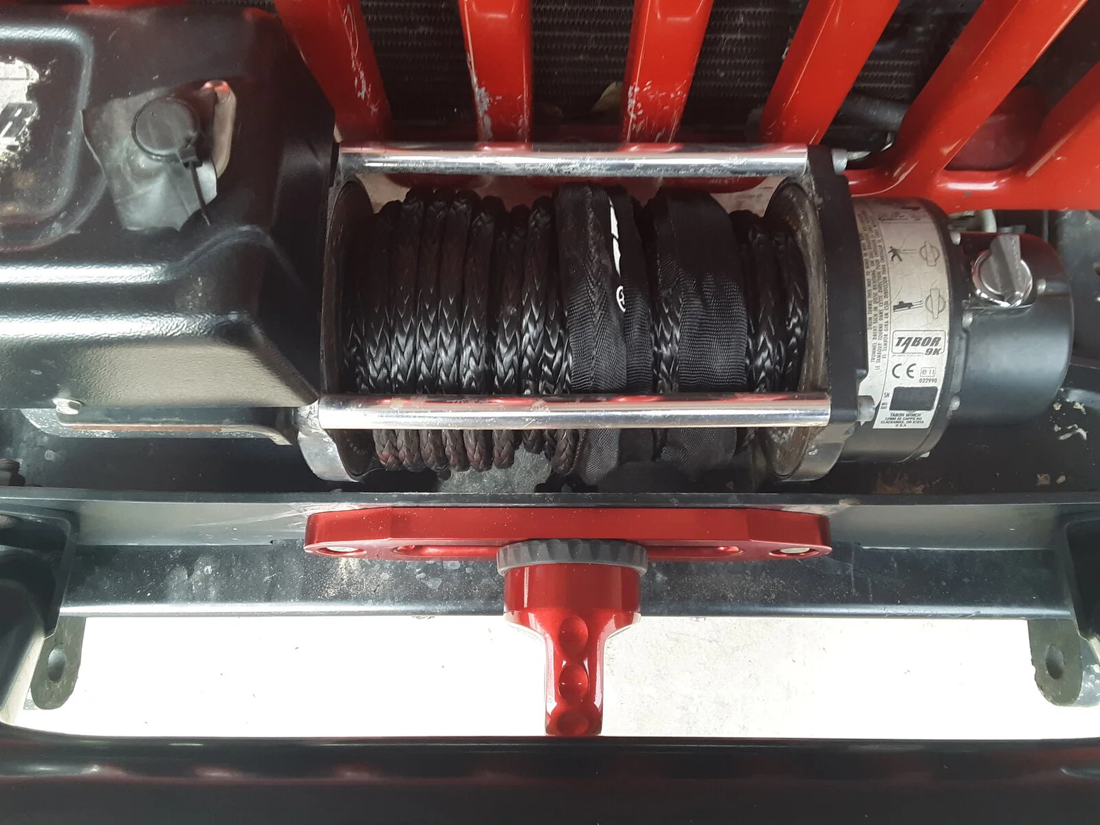

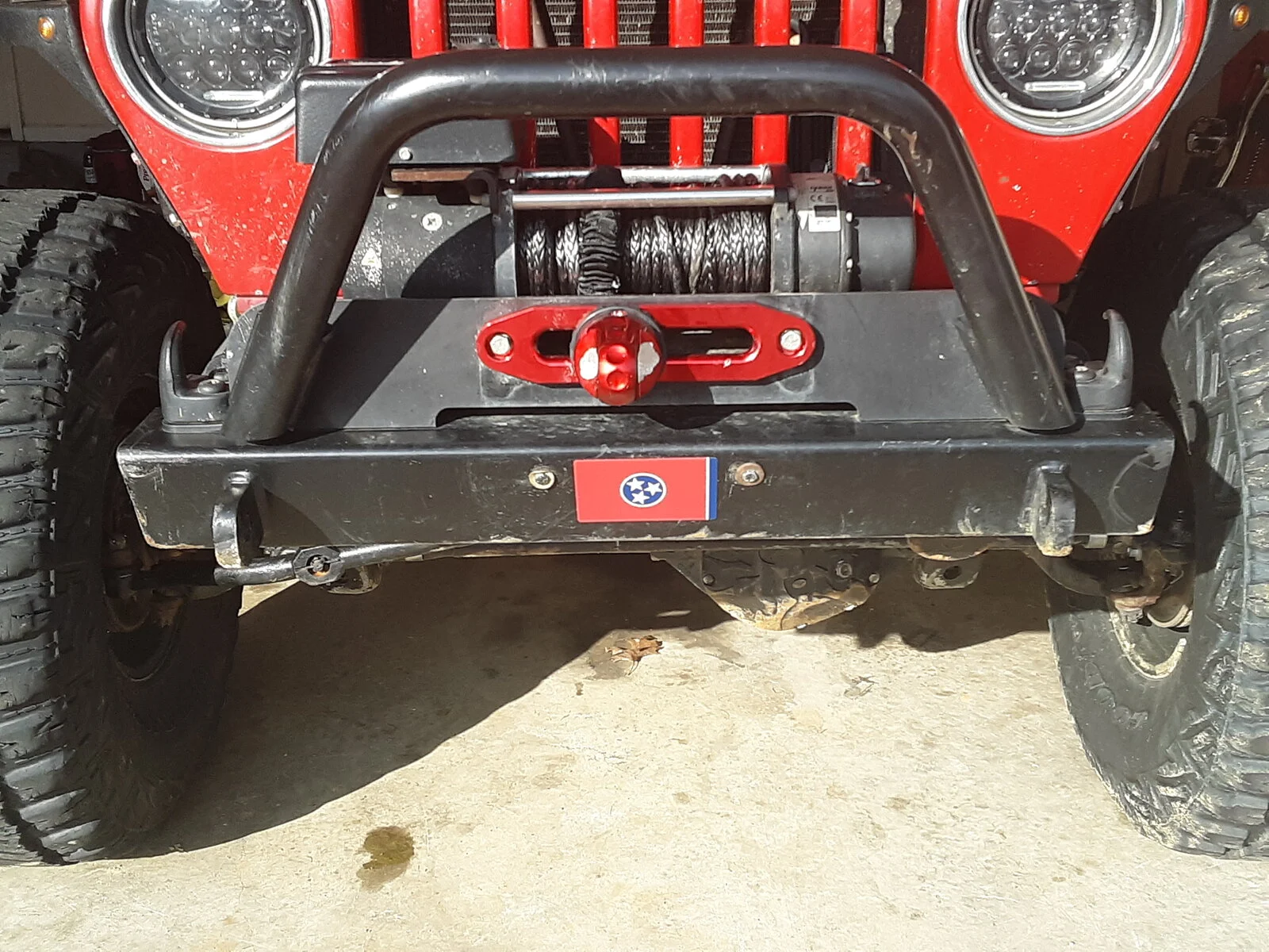

The cable was getting pretty old on my winch so I decided to replace it with a synthetic rope. Since the rollers were no longer smooth due to cable use I replaced it with a cheap aluminum fairlead. I debated on just reinstalling the hook since it has worked trouble free for years but I figured I would try one of the safety shackles. I just bought a cheap shackle to see if I like it before investing in a more expensive shackle or switch back to hook. I never thought I would go synthetic I pulled cable a few weeks ago for a guy who had synthetic and I was amazed at how much lighter and easier to pull.

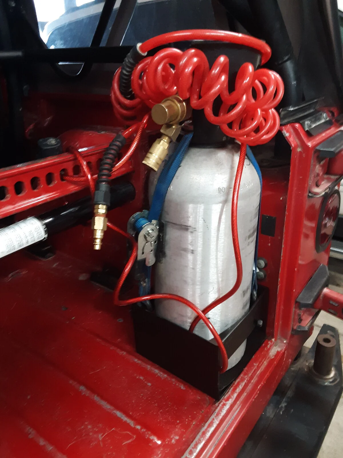

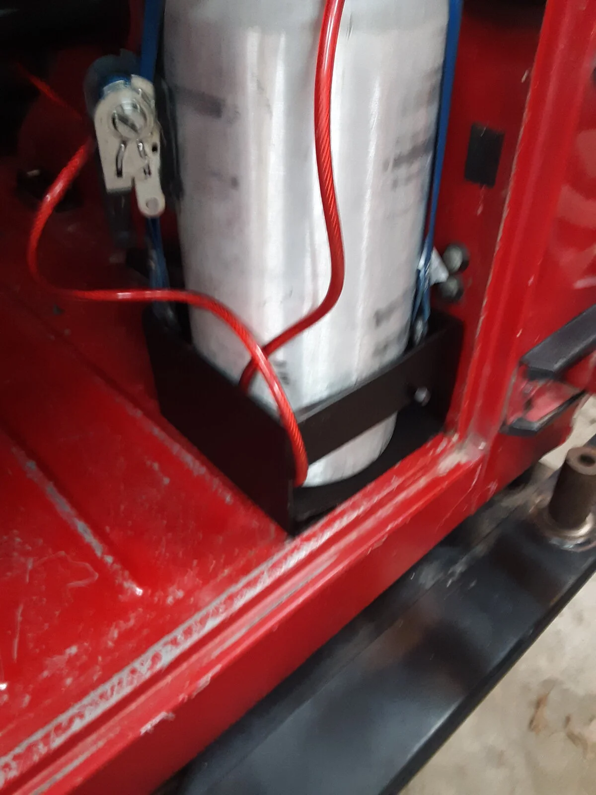

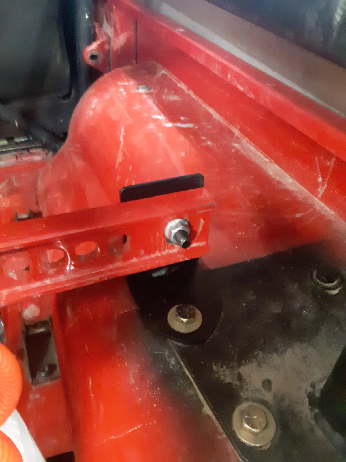

I used some scrap that I had laying around to build some brackets to mount my hilift and air tank. I run a rear seat half the time so I wanted the jack and air tank to fit behind the seat when installed.
I picked up an existing fastener in the floor and in the fender wall for the air tank mount.
I picked up the roll bar attach fasteners for the jack mounts.
Not bad for some scrap.

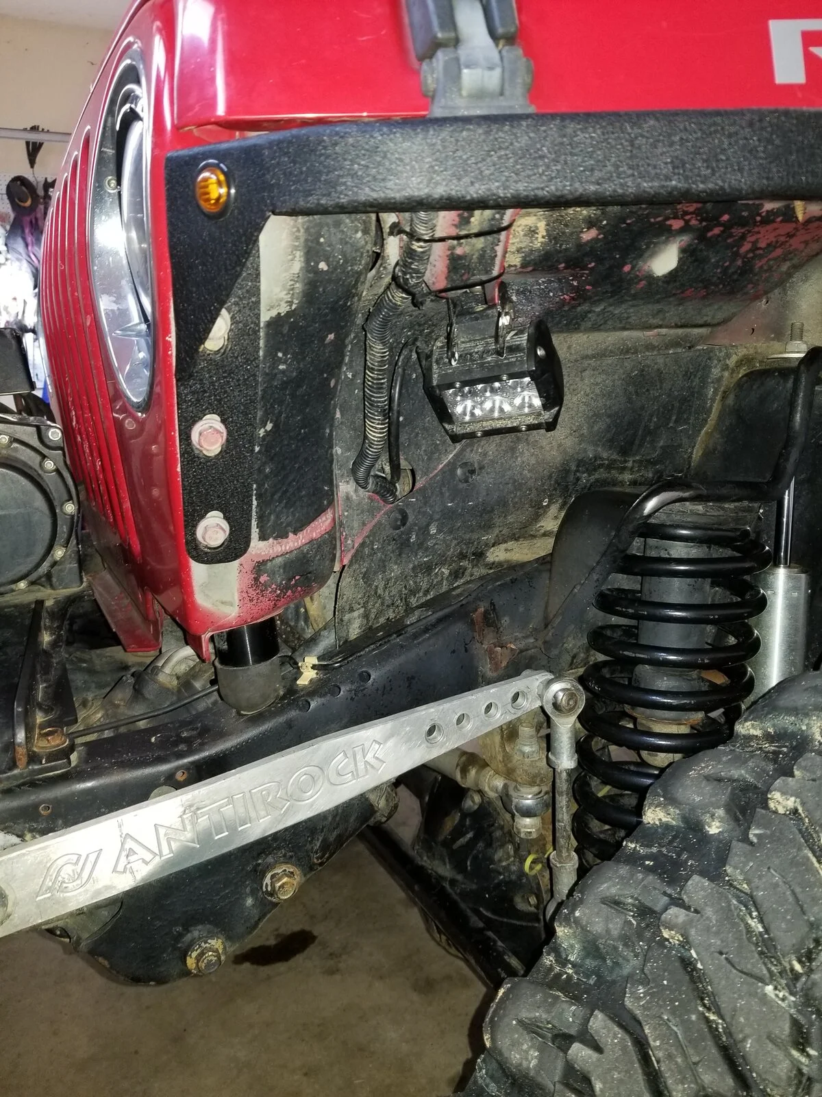

Went to Hawk Pride in Alabama on New Year's day. Great day on the trails, the access roads were a muddy mess but once we got in the actual trail, the trails were good. I did suffer little body damage on the driver's side when exiting Merlin, but other than that the jeep faired well. We did some night wheeling and I could not see, I only had headlights so after struggling on a few trails I called it a day and let the younger guys continue on through the night. Our next trip will require some night riding (going to depart Friday evening to get to base camp around midnight, then wheel from there sat morning). So I added some lights up under my front fenders to hopefully aid my sight. Don't think these will last long where they are located, but someone gave them to me a while back and i had them laying in a box, so i am not worried if they get destroyed by debris or water. Just need to get through this trip in a few weeks.

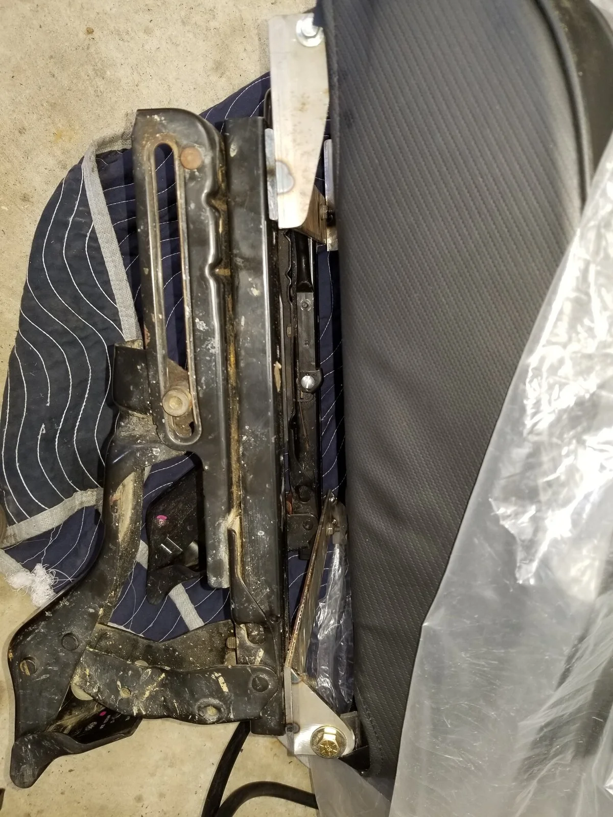

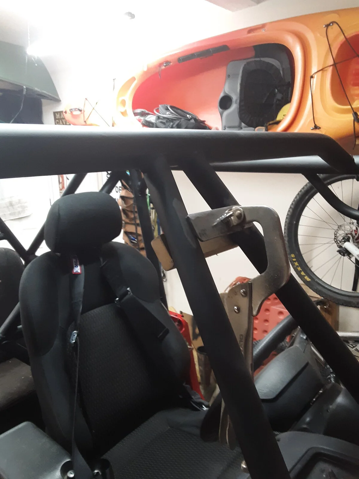

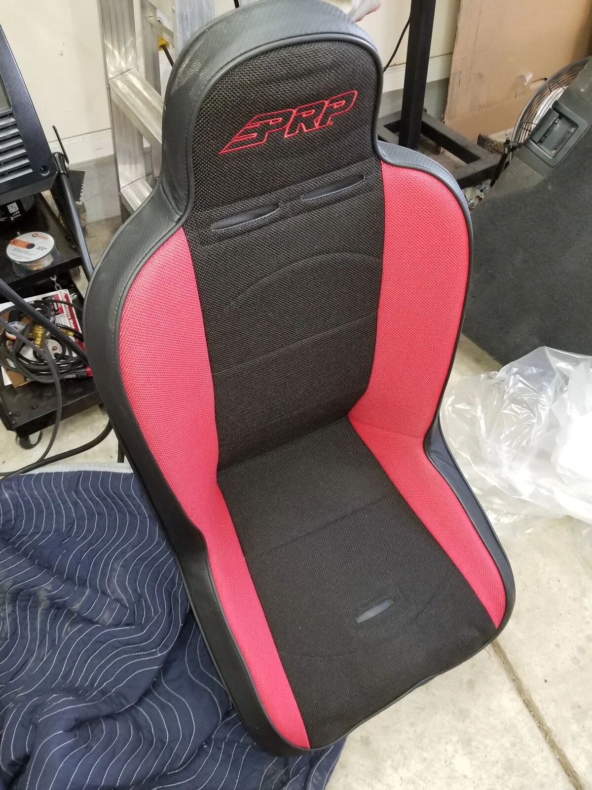

Also, the PRP seats that I ordered back in October finally came in. Started mocking up some brackets. This first set, the front is a little high for me, so I am going to drop it a 1/8-1/4" to see if I like it better. Overall height is good just need it down a little in the front.
