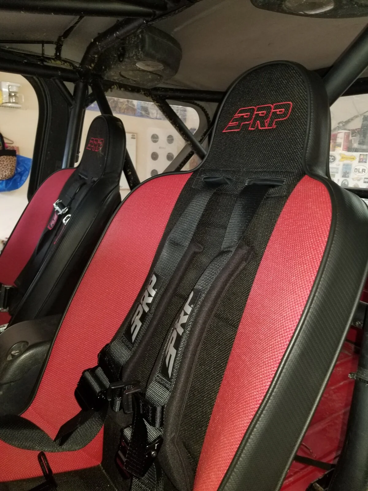

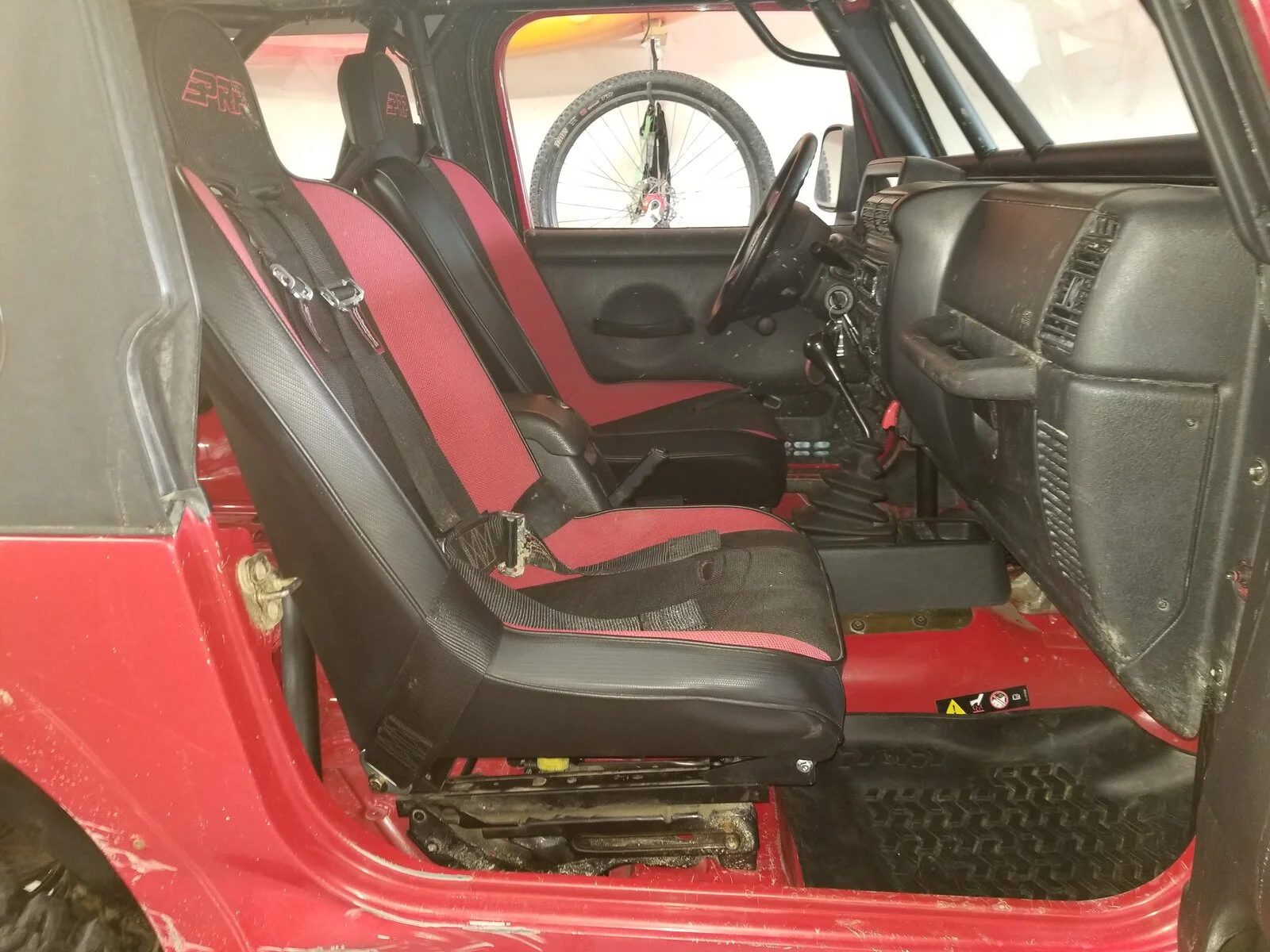

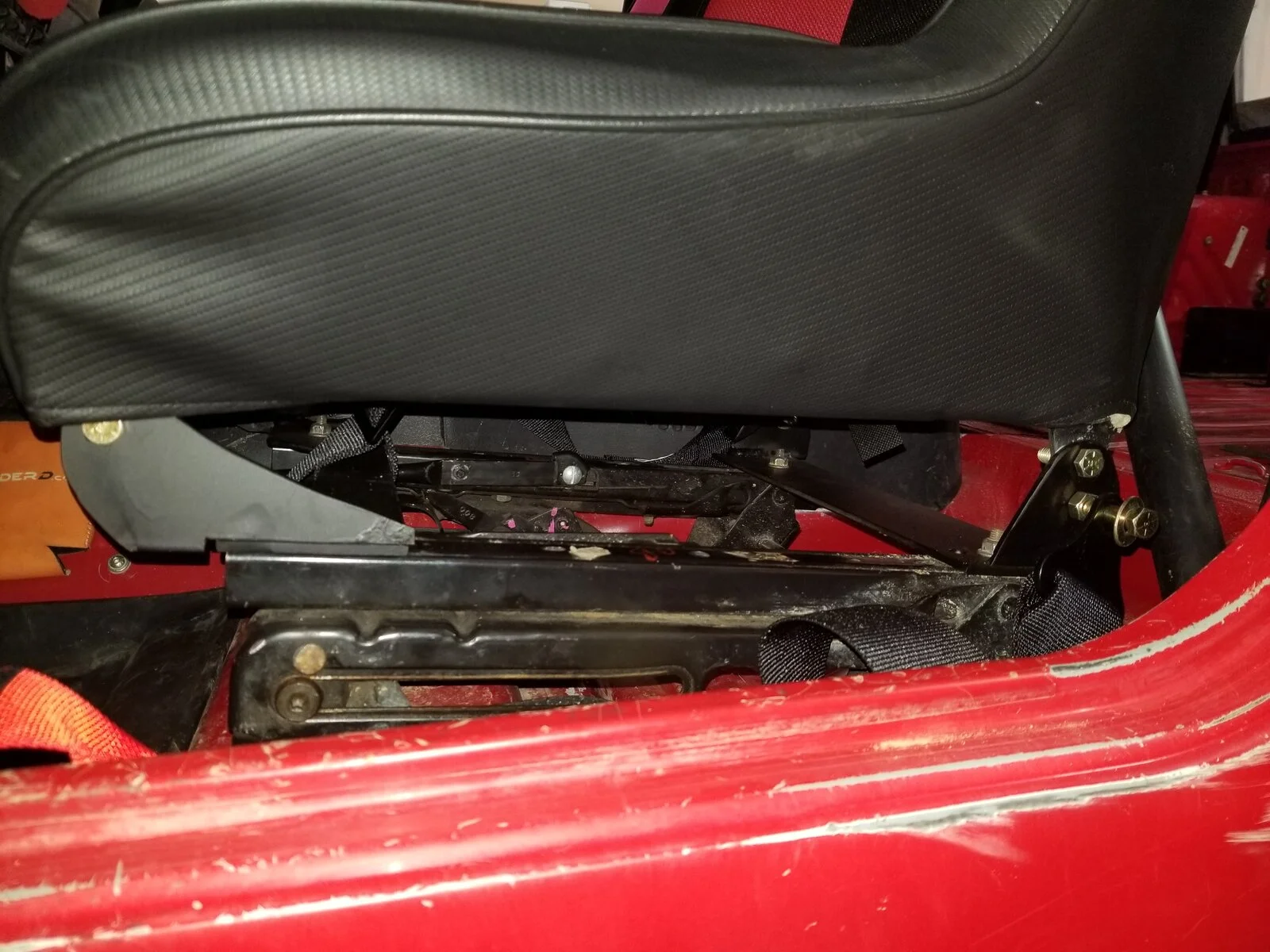

I got my PRP seats installed. If you go back and see while I was building my roll cage, the seats were delayed in shipping so I built the cage around the stock seats hoping that the PRP would be similar. Well, unfortunately the PRP seats are not the same profile as the original seats and thus I have my cross-bars mounted a little too far forward. The seats are installed and in good location for me and my son, but if anyone taller jumps in, the seats are going to be too far forward. I decided to leave it this way for now because I still want to have the cross-bar as far fwd as possible so I can have someone in the back seat if needed. Once my son(s) are moved out and it is just primarily my wife and I, I will most likely redo this cross bar moving it back so the seats are free to move back further.

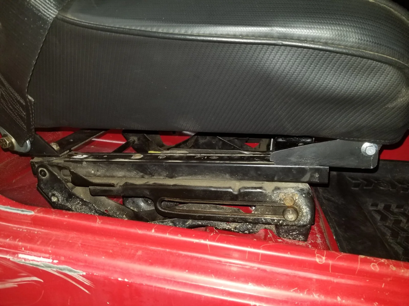

I made the passenger seat brackets to put the seat at approx stock height. I made the drivers side brackets to put the drivers seat approx 1.25" higher in order to help my son (who is 5'5") see better over the hood when his is wheeling it. It is slightly too high for me, but my fist still fits between my head and roll cage, so I think that is good. I think I will quickly get used to the higher seat as well. the visibility is definitely better.
For the pax seat, I installed RJS 4 point harness. For the drivers seat, I wanted a harness that I could disconnect the shoulder straps and run lap belt ONLY. Most 4 points the shoulder straps are sewn into the lap belts, but I did find a few 5 points where the shoulder straps disconnected, so I got a 5 point PRP harness for the drivers side.
Passenger side bracket which puts passenger seat at just over OEM height.
Driver's side bracket which puts drivers seat approx 1.25" higher than the passenger seat to give my son better visibility.
Seats installed showing them hitting the cross-bars. Going to live with this for now, but once I don't have a need for back seat, I am going to move cross bars back.
I do have one wheeling trip with the PRP seat (just installed on drivers side) and both my son and I liked the PRP Daily Driver. it is a little more difficult to jump in and out of when spotting others, but the comfort over the worn out OEM seats is well worth it.
NOTE: The OEM brackets used were the early model TJ brackets out of a 98 jeep so they both provide the flip forward and they are slightly higher than the later model TJ brackets. I swapped the seats between the 04 and 98 to give my son better seats in the 98 (installed the 04 seats in the 98 with 1" spacers to make them stock height).

PRP seats and raised driver seat:
Even though I raised the drivers seat for my son, I actually liked the seat being a little higher while wheeling; however, I was the ride leader and was constantly getting in and out all day and the higher seat with the higher bolster side on the PRP (over stock) really gave me a workout. The PRP daily driver was great, really liked it while wheeling; however, as mentioned getting in an out all day, the higher bolster makes it more difficult, it is doable and I am happy with the seats but I was definetly reaching up, grabbing roll cage and pulling myself up and over the bolster, same thing with exit, I was having to grab roll bar and pull my butt up and over the bolster. To be fair, when my stock OEM seats were in good shape, I probably liked them better, but replacing the worn out seats with the PRP was a very nice upgrade that I am happy with.
The 5 point harness with the detachable shoulder harnesses really worked great; it allowed me to just use the lap belt when I was getting in and out, had plenty of freedom to look around and keep eye on others, and then when I felt it was needed to throw on the shoulder harnesses. My stock seat belts were constantly locking up on me when in the hills, so being able to throw on the harness even when the jeep was sitting off camber, etc... was very nice.

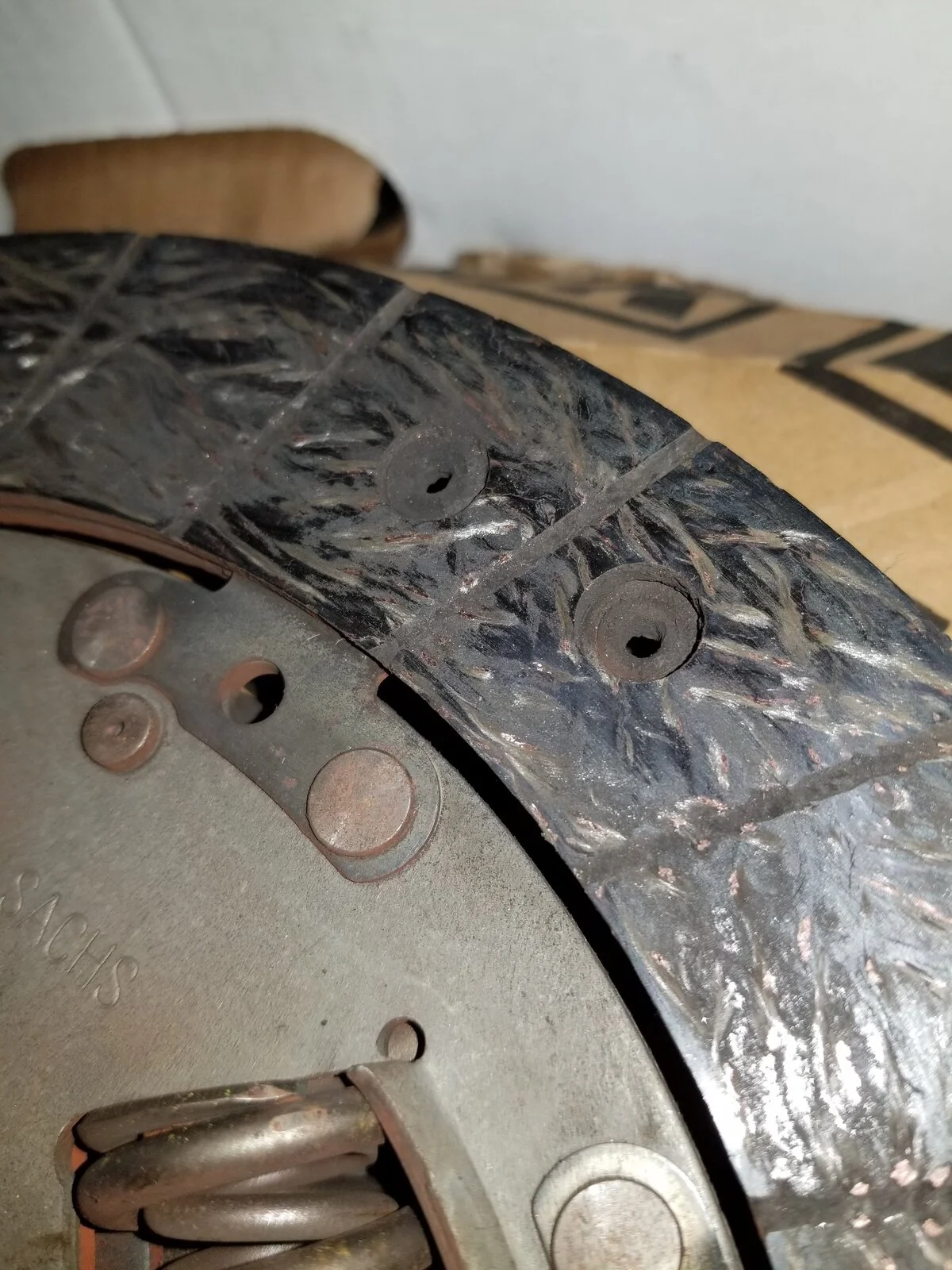

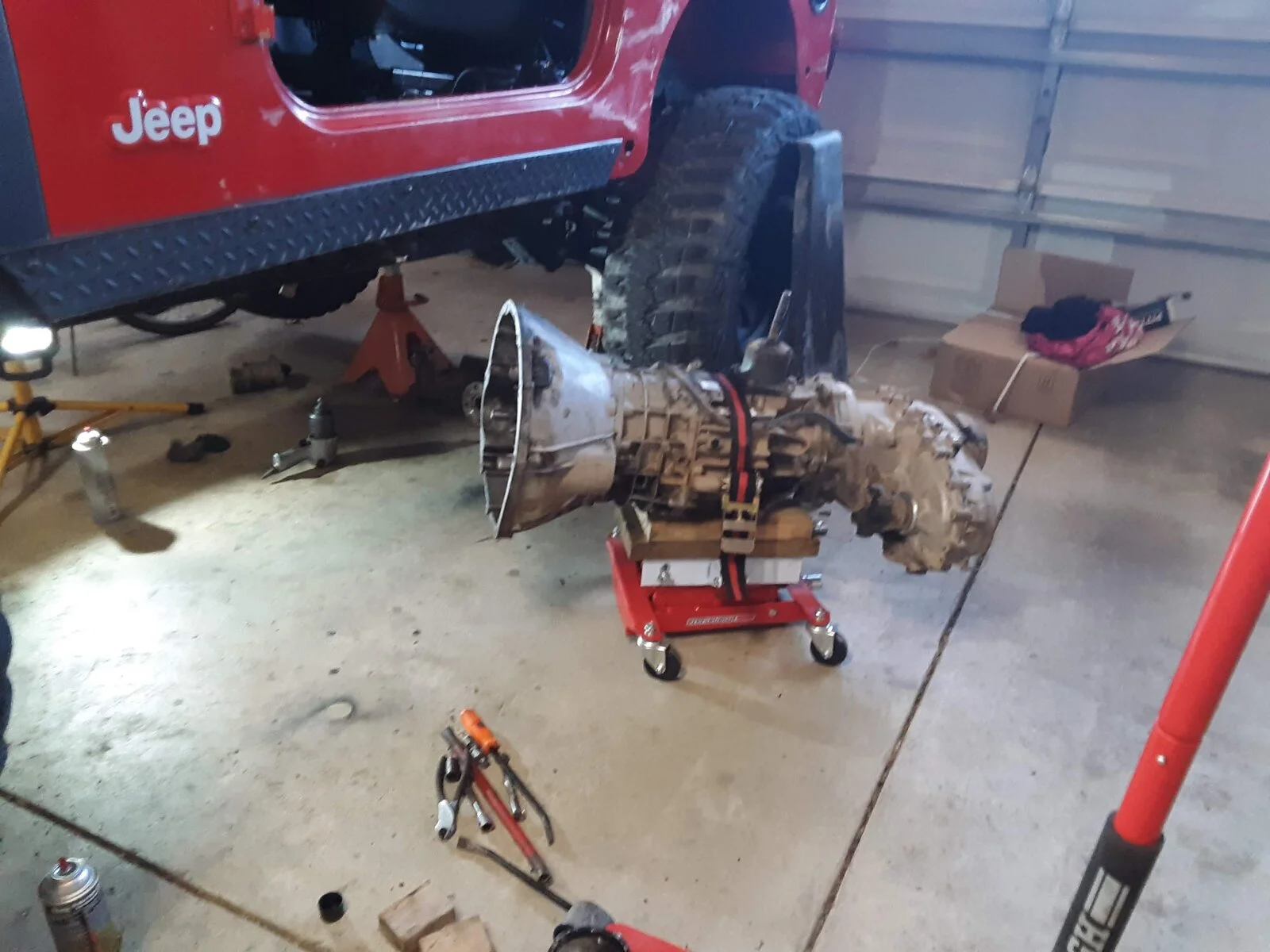

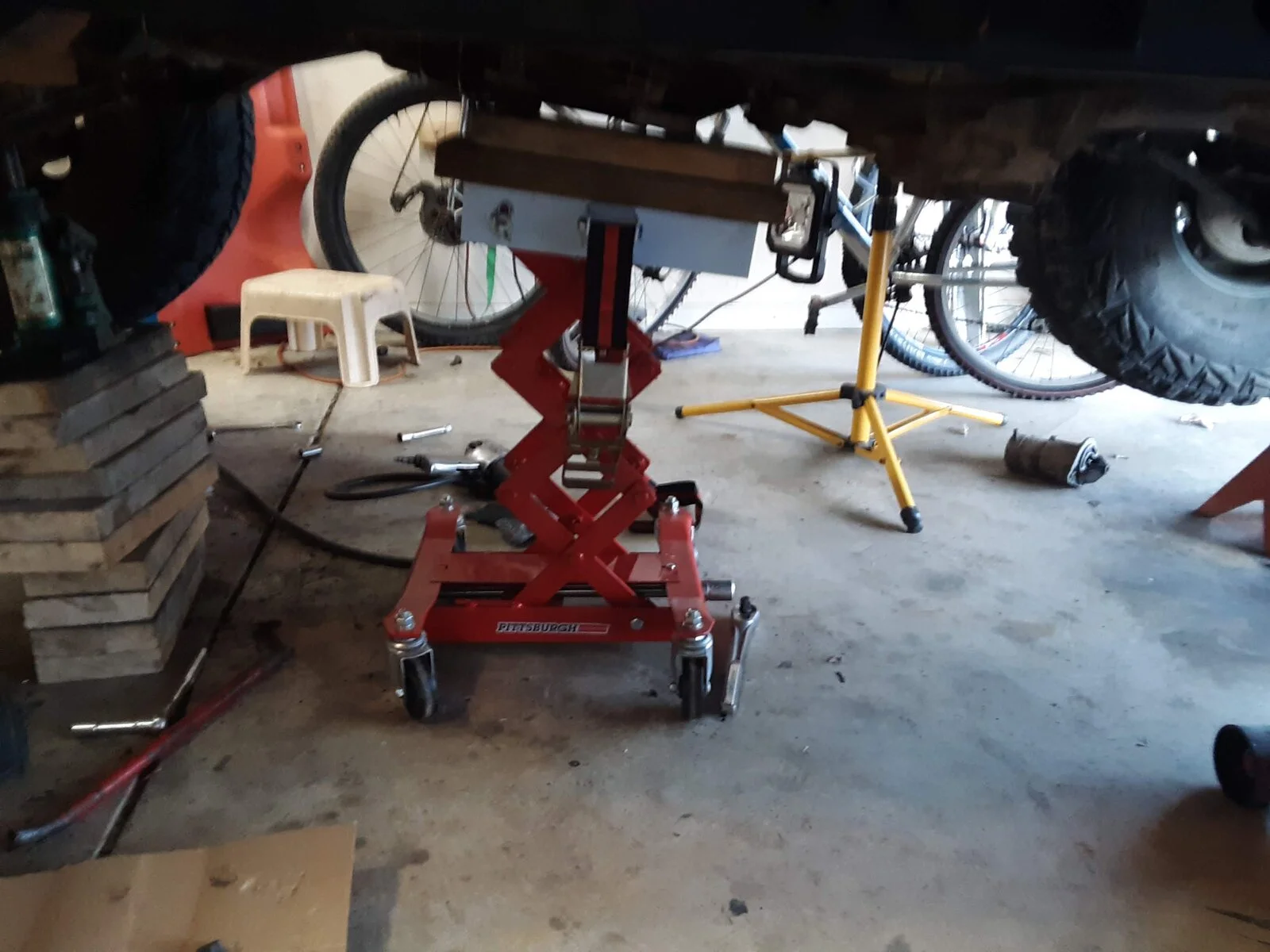

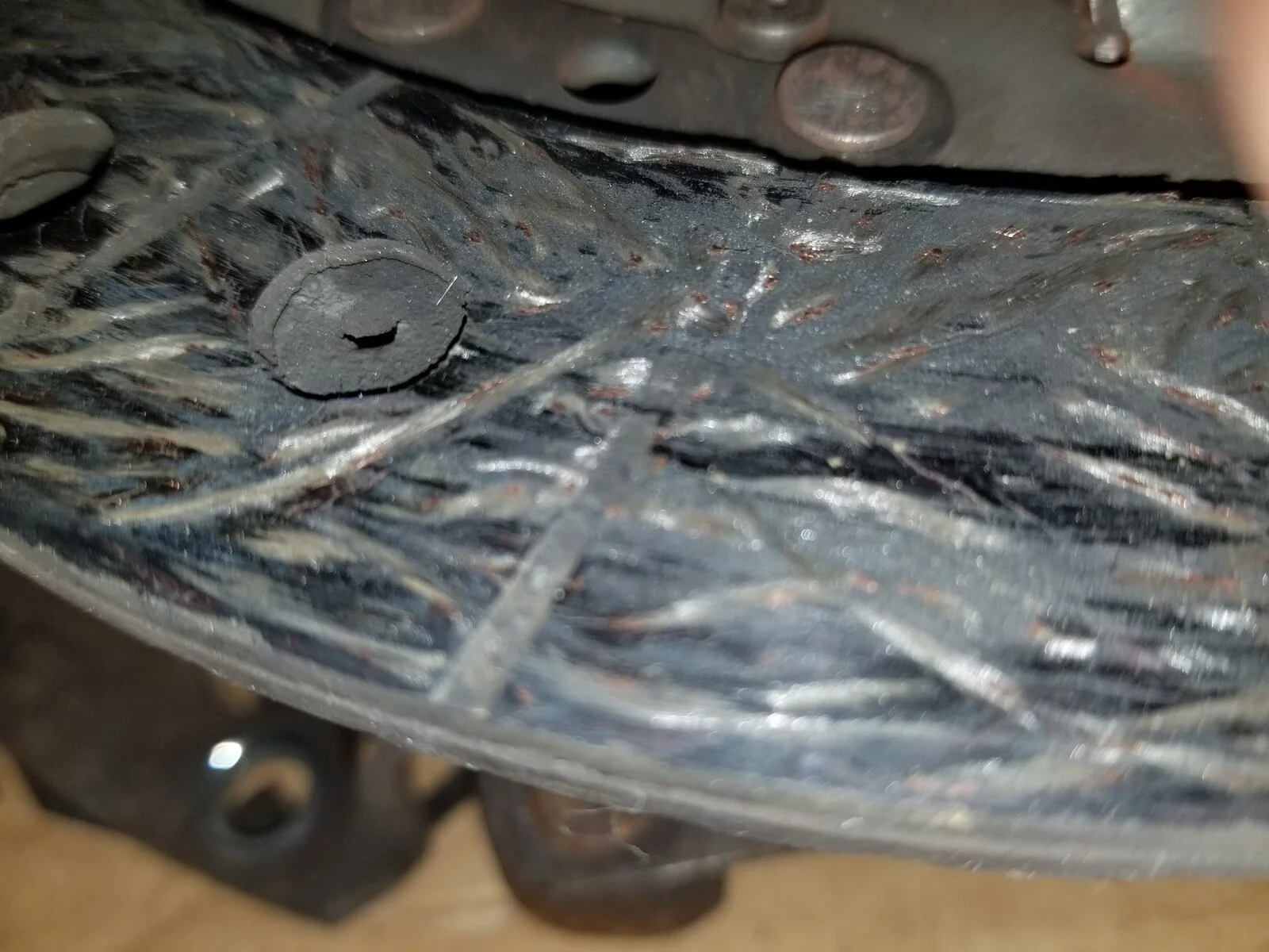

Harbor Freight has there low end transmission jack on sale for $79, so I ran down and bought one yesterday morning. Dropped tranny, installed new clutch, and got tranny back up with two bolts in, not bad for a days work but I am a little sore this morning (especially in arms and shoulders from man handling that tranny/transfer around under the jeep). I guess that is the result of the easy life behind the computer all day.
I think I could have gotten away with not changing the clutch for a while, but it is worth it to me for piece of mind. Now just to get everything bolted to make sure I didn't "induce" something else wrong. I did note that what I thought was a rear main oil leak is actually coming from my valve cover, so I will take care of that next.
