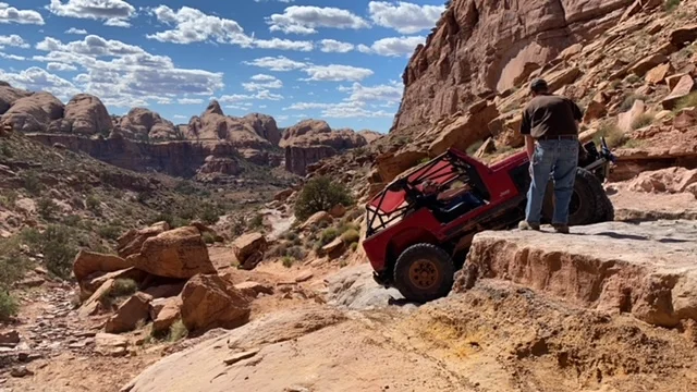

@Brianj5600 the trails in Moab are completely different than Alabama, Tennessee, and Arkansas. For one, there is traction! The steepness and lengths of the climbs were a little unsettling when looking at them, but the jeeps just walked right up them. We would never attempt similar climbs around here because there would be no traction. The other big difference is that the trails are wide open and it is mostly just steps (steep and large) or v notches and not the boulder fields of large rocks that we are used to picking our way through. Very rarely was the front and rear diff an issue because it was not constant rock gardens, it was just steps so having belly clearance and traction was key.
Another thing to keep in mind is that since it is so wide open there is not a readily available winch point everywhere.
No trees = Nothing to wrap a tree saver around.

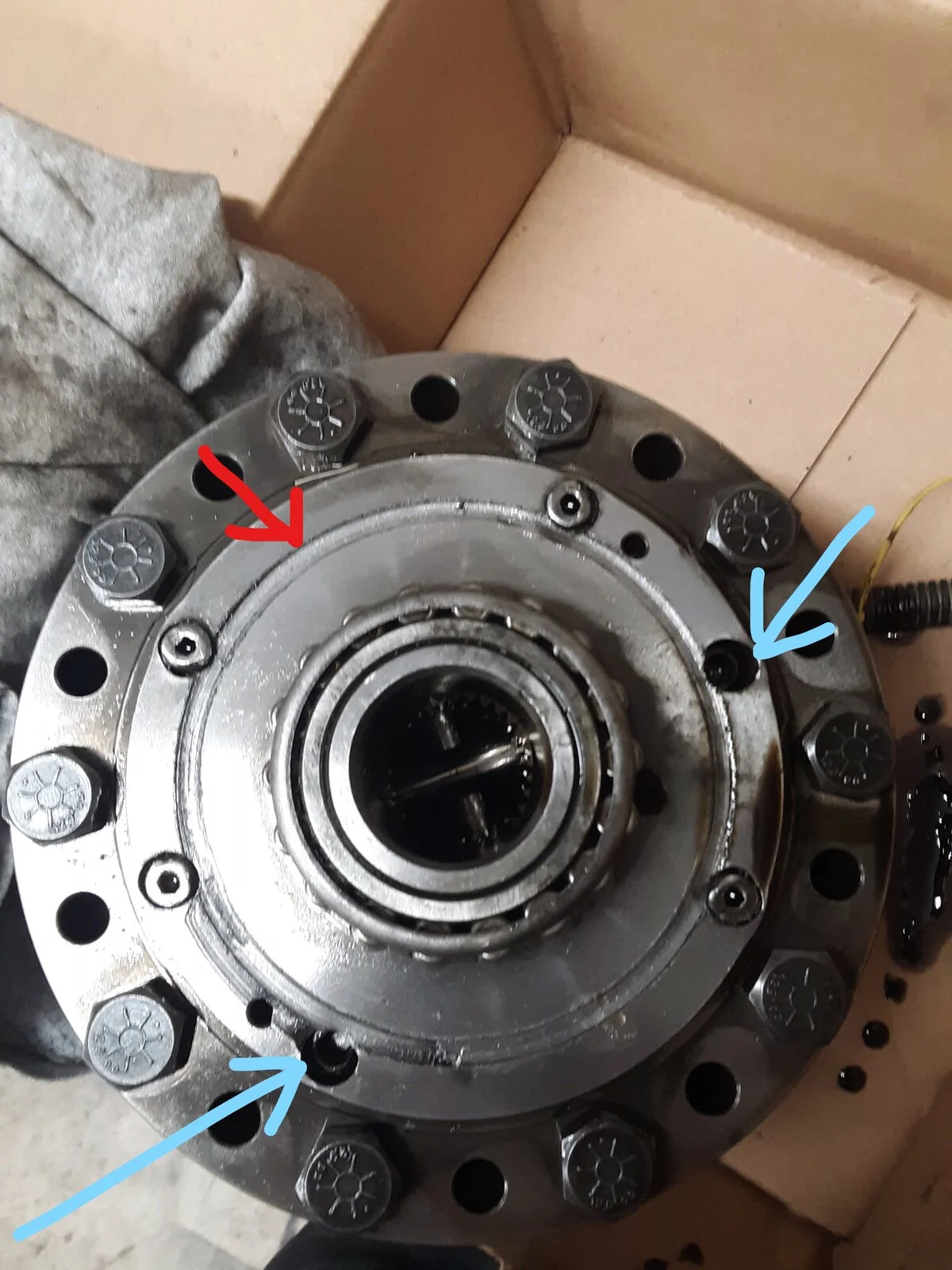

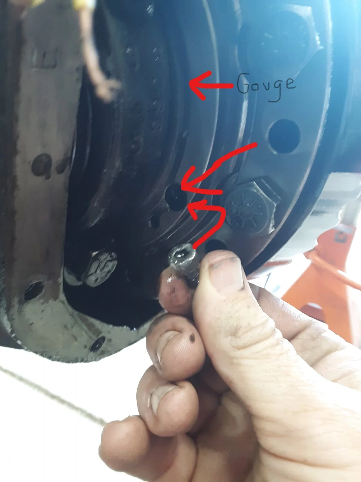

While I was pulling the axle shafts out of my rear axle, I felt a clunk, so i opened it up to take a look. I found two screws laying in the bottom of the housing, they were both a little mangled but luckily no damage to the R&P or any bearings. The screws come out of the elocker and I found all the screws (for a spring plate?) to be loose and a gouge in the plate from where it was hitting from the loose screws allowing it to back out.
I have searched online for some sort of parts diagram for the elocker but can't find it, I will try to call eaton tomorrow to see if they can get me the screws or at least tell me thread and pitch and hopefully torque values.
I also got the cracked UCA bracket cut off and ground down, now just have to align the new bracket and burn it in.
Two screws are missing, but all screws are loose, if I push on the plate it moves in and out like it is spring loaded so I don't want to remove the other screws without first tightening a few down, knowing my luck it will spring open and very small parts will go everywhere never to be seen again.

Called Eaton and they were not able to get me the bolts, but he did give me the thread size and pitch and the torque spec. M6x1.0, 17-20 N-M. I asked him if they should have locktite and he said yes, but there is no evidence of locktite on the existing bolts? I will run to my local hardware store to see if they have cap bolts that will work, if not I will see if mcmaster or grainger has them.

Rear locker is fixed and back together, rear axle is buttoned up and back under the jeep. Test drive shows that everything is functional.
